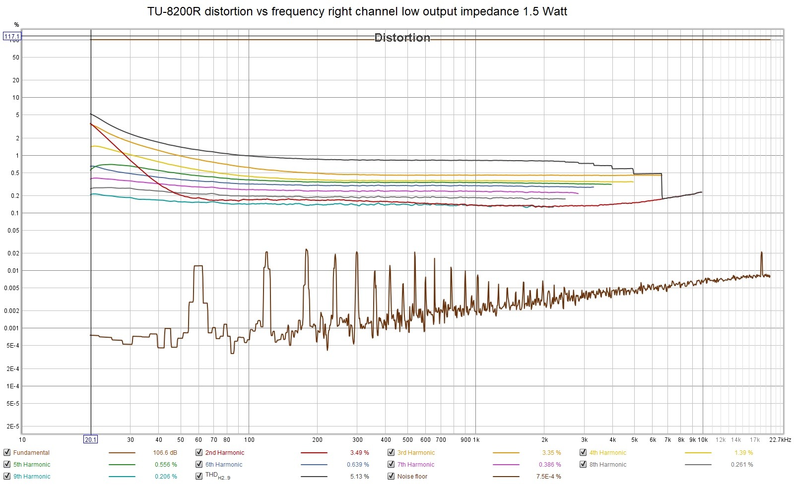

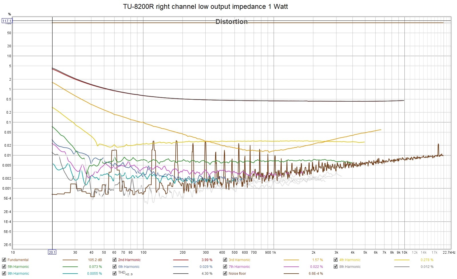

The 2nd harmonic suppression is present over the whole frequency range. 'Normal'/expected behavior at 1 Watt output power; the 2nd harmonic dominates THD:
At 1.5 Watt, the 2nd is suppressed:

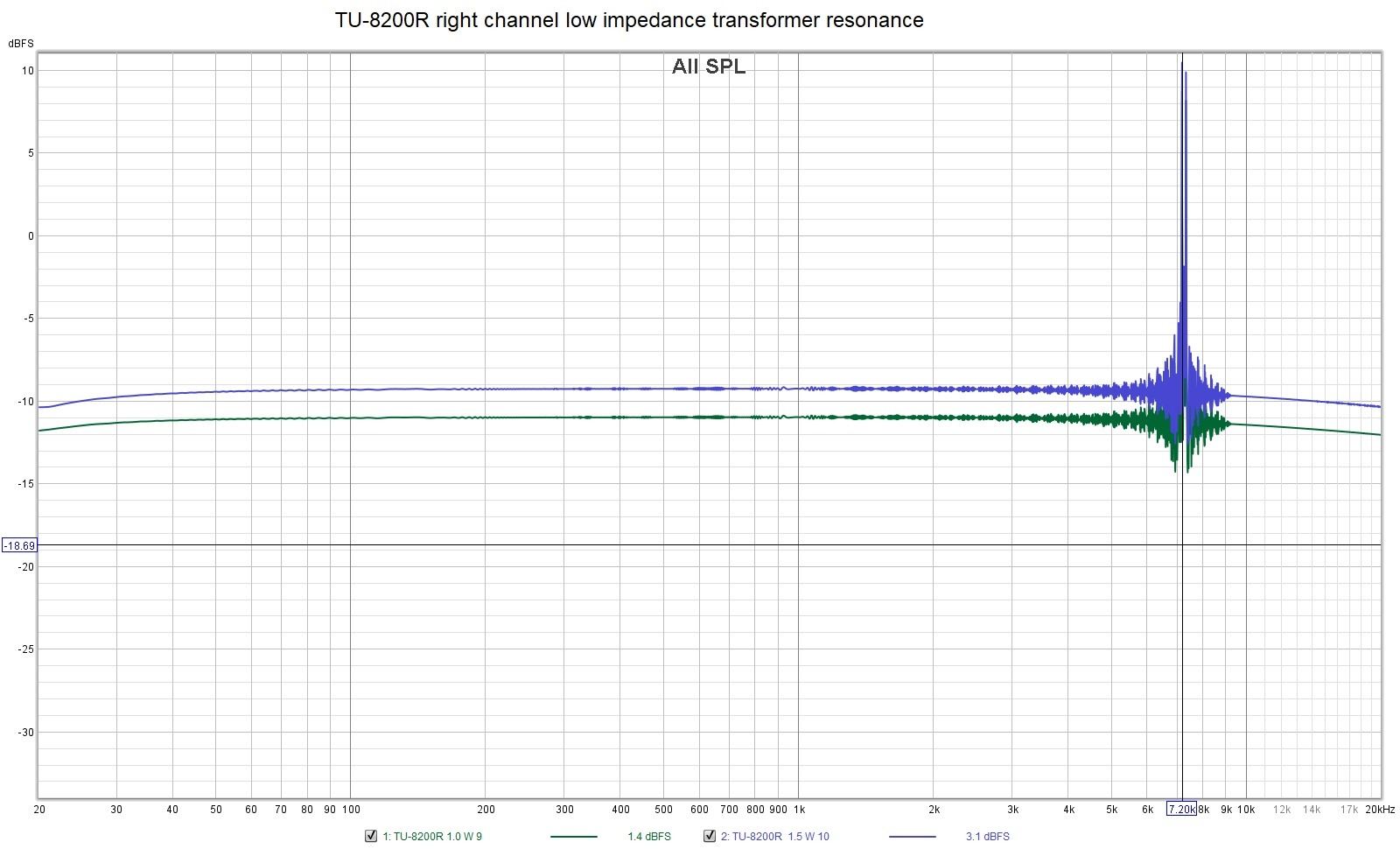

And here is the output level (voltage) as function of frequency; the resonant behavior is pretty obvious:

At 1.5W, the output transformer shouldn't be stressed in any way, should it? I can't find the data sheet for the 2777B, but it's supposedly similar to the 2783C (OPT for the TU-8800), which is supposedly similar to the 2785C (OPT for the TU-8900), and that has a data sheet up at https://www.lundahltransformers.com/wp-content/uploads/datasheets/2785C.pdf .
The PTC1/PTC2 thermistors before the mode selector have a value of 120 Ohm. Changing this value can affect the effect that I find in about half of my 807 tubes, i.e. that they are "noisy like a ground loop" in Triode mode (typically, but not exclusively, Eastern European ones make noise in triode and work perfectly in the other two modes). I mean that increasing this "resistance" if I jumper to Triode mode, does the resistance between G2 and the Anode change, does the operation change?
