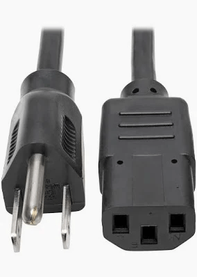

2a) Should I swap out the kit AC cable for a standard US three prong AC cable?
There is a flying ground connection on the cable that came with my kit, but the outlets at our place do not have an extra grounding screw. From both the schematic and the PC board layout it looks like the grounding conductor is connected to the chassis, and expects a safety ground connection.
I assume the TU-8200R must be operated with a chassis ground connection, since the chassis is metal.

And it works! Victor, there is an extra yellow wire with a connector already crimped on coming from the primary side of the power transformer. The instructions do mot seem to mention it. Is that a shield or grounding connection that should go to board ground or the chassis? For now I coiled it up, and left it on top of the transformer.
As I remember my European version (230V) do not have this "extra"/standalone wire.

Thanks for the info about your power transformer. Maybe there was an update to the transformer; my understanding is that the kit should be the same for 240V and 120V AC countries, since the 'unit-8' circuit board has socket positions labeled 230V and 115V.

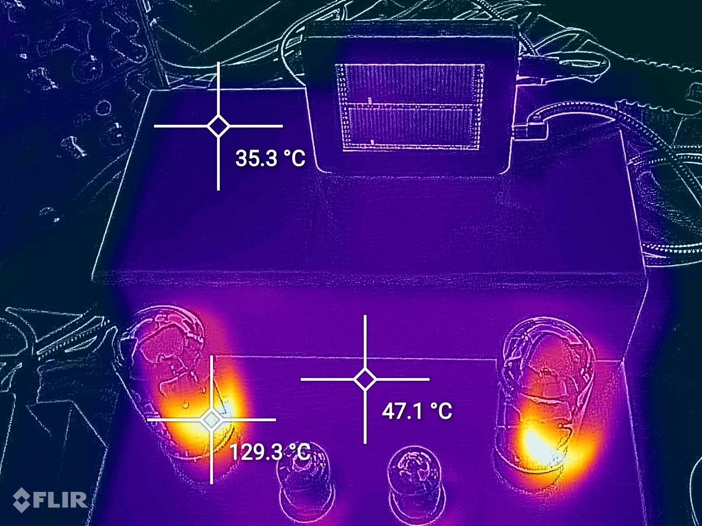

My amp seems to be running at about 50C (120F) chassis temperature, i.e. it's pretty warm but not too hot to touch. Is that expected? What do other owners observe?
When I used 6L6GC and 6550 tubes the chassis was warm, bit not too warm, I think as by you.
I think the main heat came from tubes and the tubes warming up the chassis (not the transformer or inner parts).
Since I use 807 tubes the chassis is just "light" warm. Adapters+the height of 807 tubes give the situation where the tubes are over the chassis so they don't warm up the cover.

Actually, I was wrong with my temperature estimate. I now measured the temperature, and it is only 35C, 10C above ambient, so nothing to worry about. This is while the amp is drawing 63W from the 120V mains.
A thermal picture after a few hours of running. The case above the main PC board is at 47C, still not excessive:
So, turns out that wire is really needed. Something must have hit the connector housing, and on closer inspection one can see that half of the 7th pin position broke away (*). That's where that yellow wire is supposed to go.And it works! Victor, there is an extra yellow wire with a connector already crimped on coming from the primary side of the power transformer. The instructions do mot seem to mention it. Is that a shield or grounding connection that should go to board ground or the chassis? For now I coiled it up, and left it on top of the transformer.

(*):And I just checked the box the amp kit came in: the broken off part of the connector housing was still in there below all the packaging I kept. Victor says this is the first time this has happened. Good thing nothing burned up. I was a bit worried when I saw the low heater voltages, since supposedly that is not good for tubes.
And I'm really glad that I didn't follow through on my idea of grounding that extra wire. Best case, it would have blown the fuse or circuit breaker. Worst case, it could have fried anything in the amp connected to ground (which is pretty much everything), or the person touching the 'on' switch.
