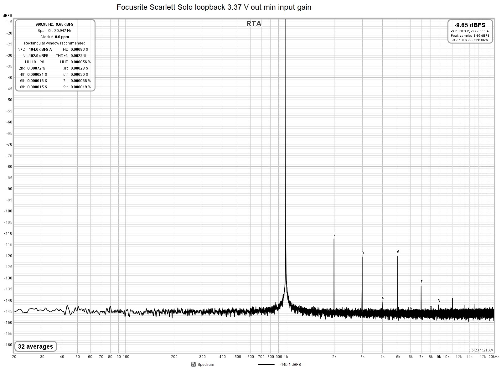

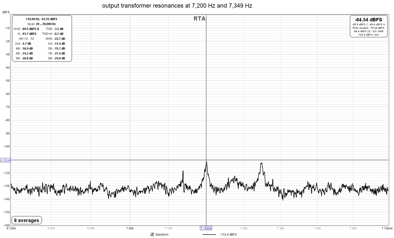

Here are some of my attempts at measuring noise and distortion of my TU-8200R, using REW with a Focusrite Scarlett Solo as DAC and ADC.
Solo loopback at 1 kHz:
Signal to noise and SINAD are at about 93 to 94 dB, not great, but sufficient for these purposes.

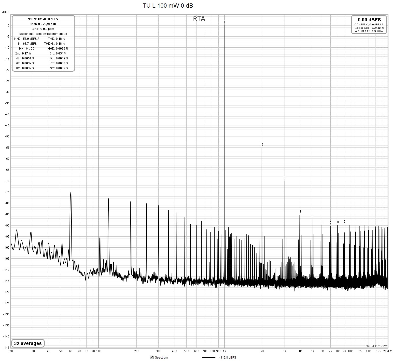

With the TU-8200R in the loop, first a typical distortion plot at 1 kHz, this one for 100 mW output into 8 Ohm. 100 mW is a bit higher than my typical listening volume:
There is quite some mains noise; I can't exclude that some of it is due to my measurement setup. The Solo DAC-to-ADC loopback does not show that noise (see plot above).
Below is a summary table showing signal-to-noise ratio SNR, signal to noise and distortion SINAD, and total harmonics THD and the 2nd and 3rd contribution to it, as function of amplifier output power. I believe REW quotes SNR unweighted, whereas SINAD is A-weighted, which means the elevated noise we see at low frequencies in the plot above is de-weighted in the SINAD computation relative to SNR.

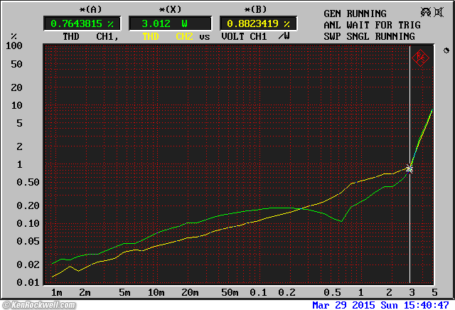

I think the THD numbers are generally in line with Ken Rockwell's measurement of the TU-8200 (without the Lundahl output transformers) up to about 1 W. Above 1 W my amplifier seems to have relatively lower (but still high, of course) distortion.
If we can believe the above numbers, 10 to 100 mW seems to be the sweet spot of this amplifier. Noise and distortion are at the 1-2 permille level, and the second harmonic dominates. At 1 to 2 W distortion approaches the percent level, and the third harmonic creeps up on the second. Beyond that the third harmonic dominates.

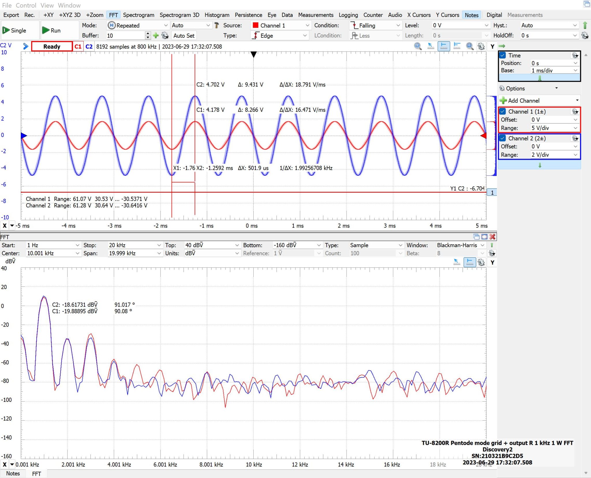

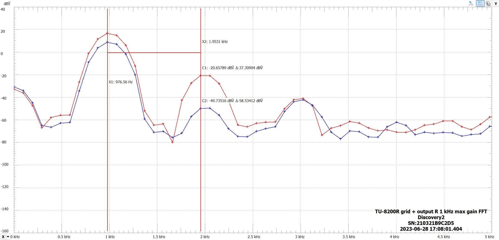

I tried to compare distortion at the speaker output and at the 6L6GC grid of the TU-8200R. I posted the same odd (to me) finding also at ASR, but I think the DIYaudio forum might be a better place to get feedback.
Victor, moderators, if you think this content is better homed in another subforum, please move it there. It is about the TU-8200R though.

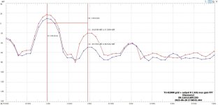

So, it seems the 2nd harmonic is higher at the grid than out the output, or, saying it differently, there seems to be 2nd harmonic compensation between the driver and the output tube. I hooked up my Analog Discovery 2 USB scope & signal generator to my Elekit TU-8200R, and I find the harmonics at the speaker output to be more or less in line with what I had seen earlier using REW and the Focusrite Scarlett Solo as DAC and ADC, namely that from a few Watt onwards the third harmonic overtakes the second. But to my surprise the situation at the grid of the output/power tube (the 6L6GC) is different: the second harmonic is higher than the third at 6.25 W output.
Here is the FFT derived from the AD2 scope observation; ch.1 is the grid, ch.2 the speaker output:

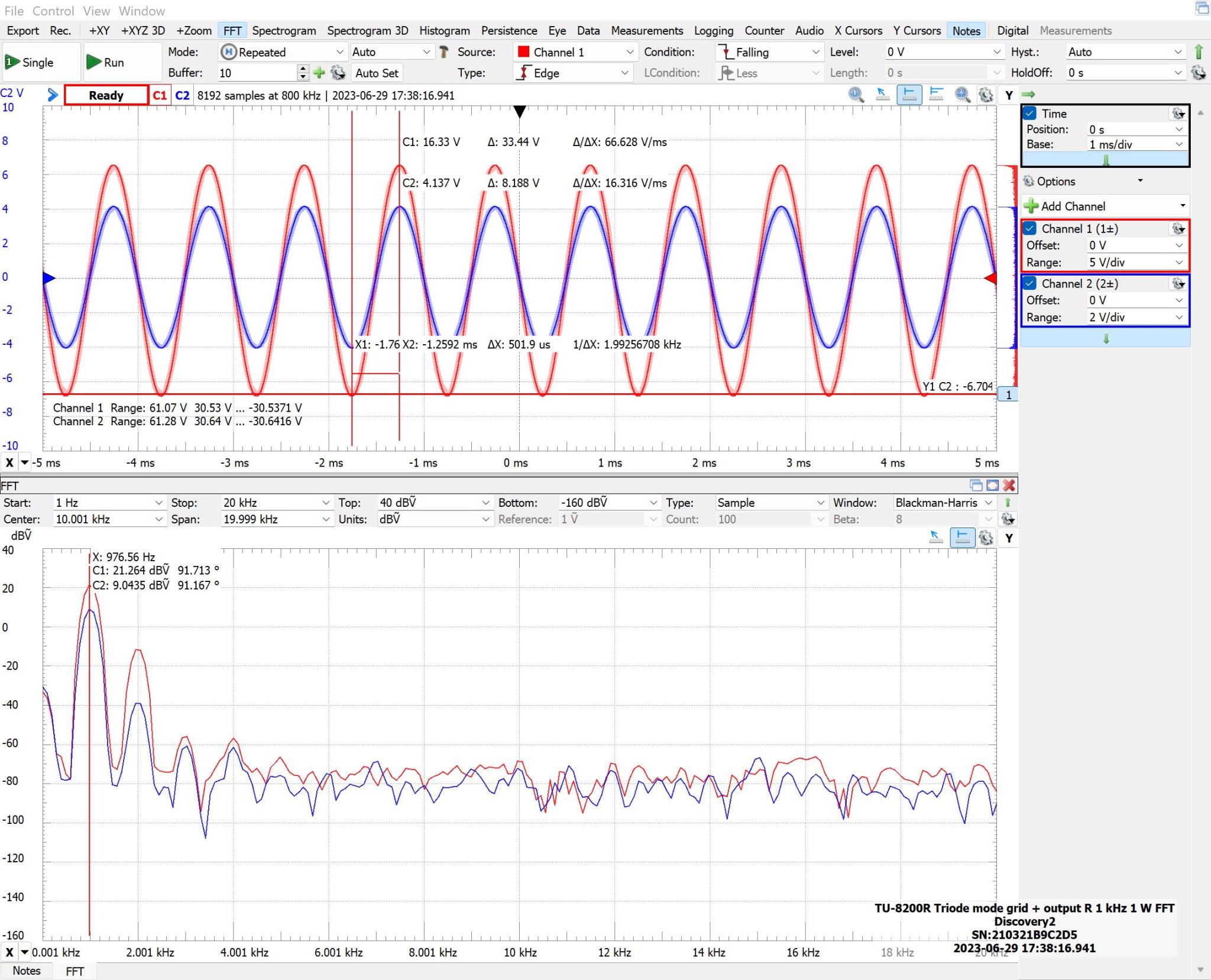

Settings:
Settings:
- 1 kHz 100 mV amplitude in
- 10 V amplitude out at speaker terminals, with TU-8200R volume turned all the way up
- 4 V amplitude at grid
- Gain = 20 dB
- Amp set to ultralinear mode
- Output impedance switch to low (at high setting, gain is 0.5 dB higher)
- Speaker output terminated into 8 Ohm 50 W resistor
- Output power is 6.25 W (10 V ^2 / 2 / 8 Ohm)
I promptly confused the two scope channels (but not the FFT channels). The amplitudes and the gain number in the post above are wrong.
The grid amplitude was 10 V, and the output amplitude 4.0 V. So the gain is 32 dB, and the output power is 1 W in ultralinear mode for 100 mV input amplitude, and maximum gain.

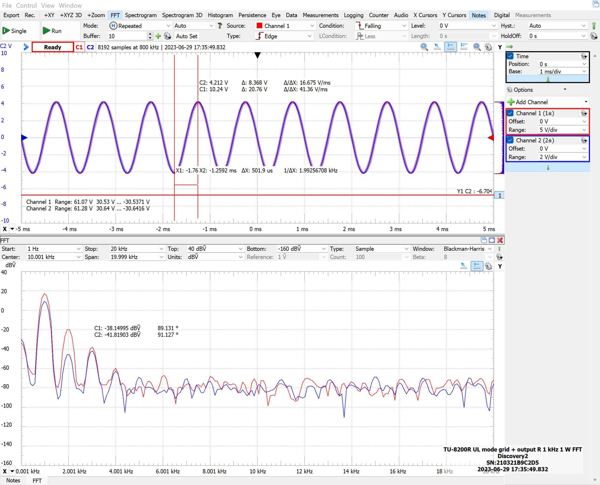

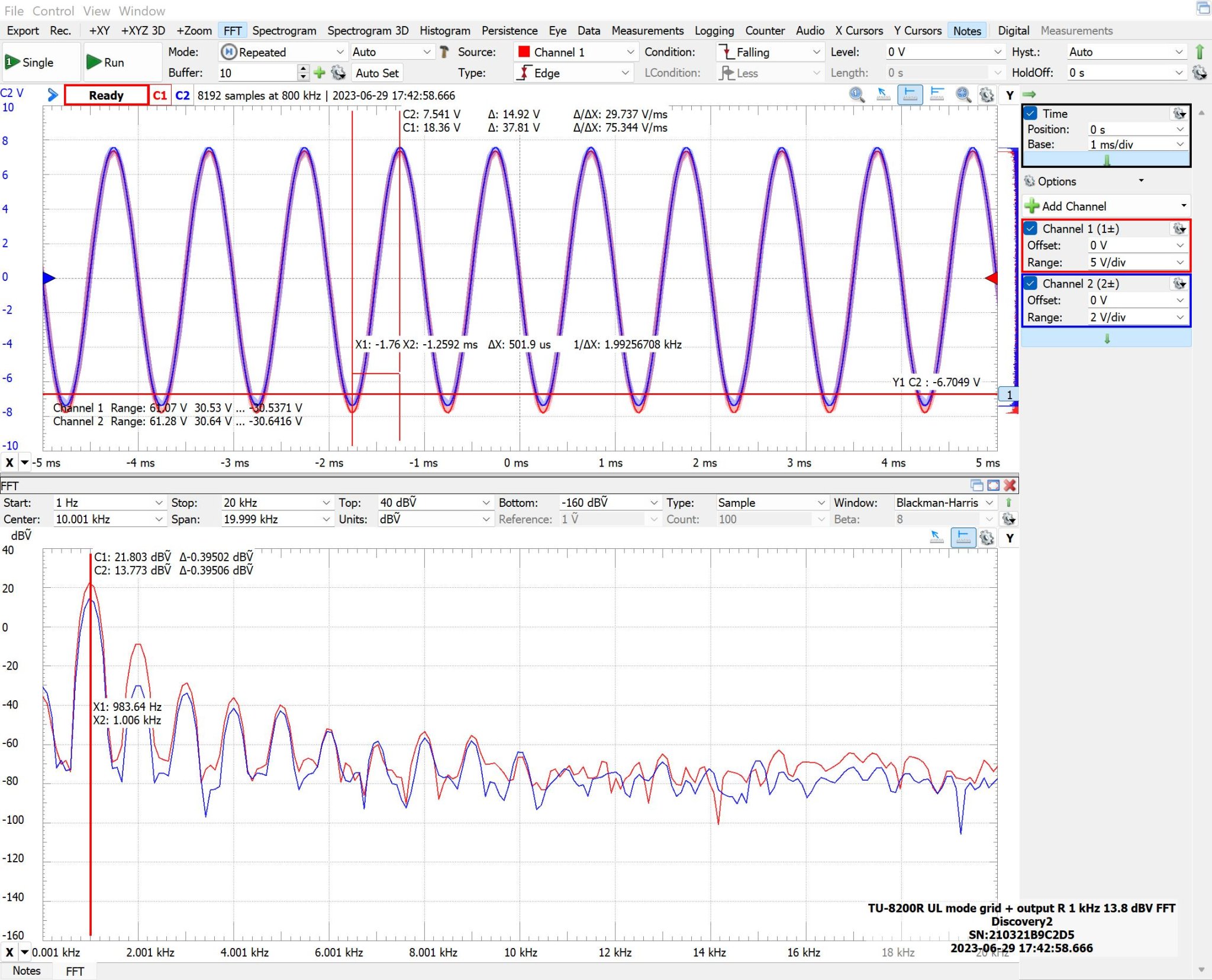

Here are some graphs and tables comparing triode, pentode and ultralinear mode at 1 Watt output power.
If I'm not mistaken, the conclusion is that you want to use this amplifier in triode mode at this power level for minimum distortion.
Also, while using the high impedance setting for the output transformer buys a bit (0.5 dB) of power into 8 Ohm,
you get a few dB lower distortion by keeping the switch set to low impedance.
In the graphs below, the speaker output is in blue, on channel 2. Channel 1 shows the grid of the 6L6GC output vacuum tube.
While the tables are a bit uneven in that output levels are not exactly the same (which doesn't change the relative distortion levels and the conclusion), to produce the graphs I adjusted the gain so that the fundamental at the speaker output was at 9.03+/- 0.03 dBV for each mode.
Pentode mode at 1 W; 2nd and 3rd are equal, and you can see some higher harmonics already creeping up above the noise on the grid:
Ultralinear mode at 1 W; third harmonic is higher than second (on the speaker output, not on the grid):
Triode mode at 1 W:
I'm a bit surprised, but that's what it is.
Triode mode at 1 W:

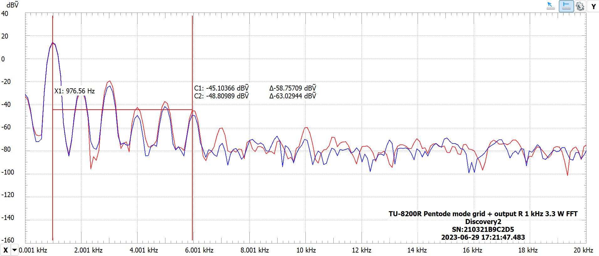

I will have to repeat the measurement with the REW + Focusrite DAC/ADC setup. Maybe also with the KEF R3's and the microphone.
I'm just a bit baffled that pentode and UL mode at the same low power show more distortion than triode mode.
I expected these modes to surpass triode mode in useable power. That does not seem to be the case.
It's true that I can squeeze another two Watt out of both UL and pentode mode, but the higher modes looks truly awful at 3.3 W in pentode mode:
Ditto for UL mode at 3W:
Both these power levels were picked as the maximum before the higher harmonics jump up to a constant level independent of order.
With the REW & Focusrite Solo setup I was measuring a few percent of THD up to 5 W power in UL mode, so these USB scope results need cross checking.

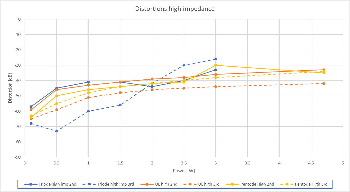

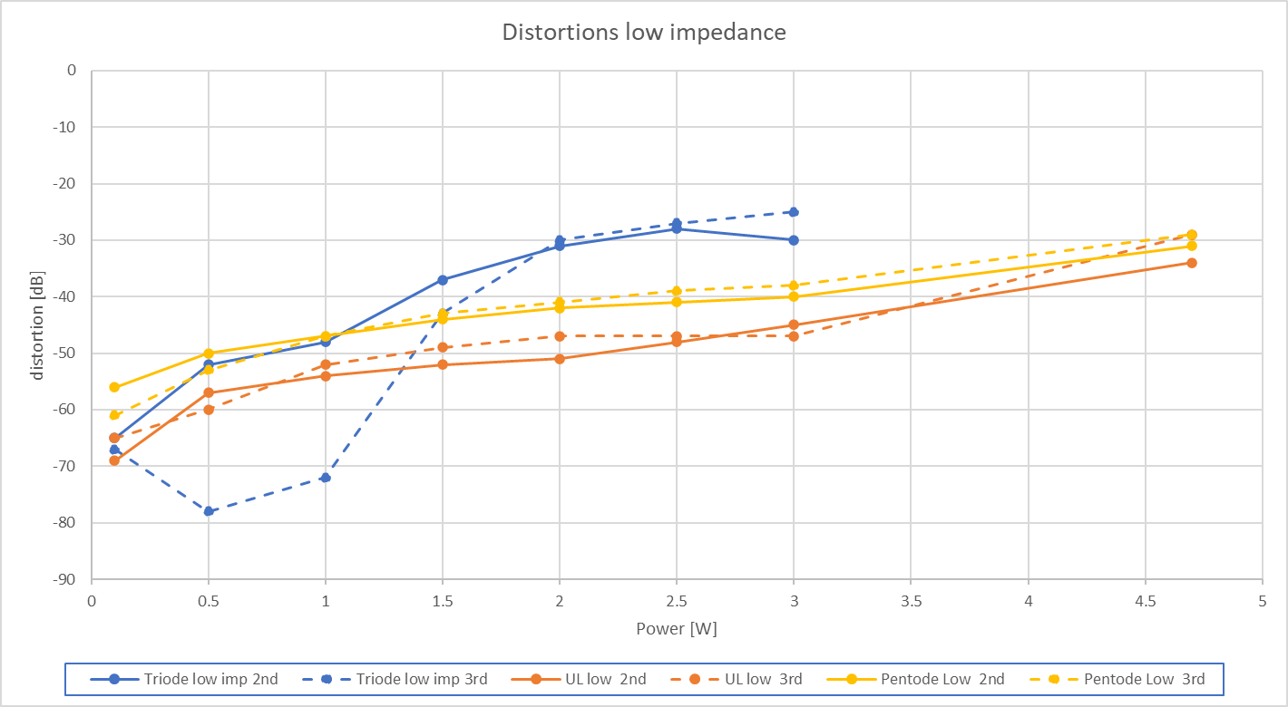

I think it's easier to compare the 1 kHz distortion measurements in graphical form. First the data taken with the low impedance output setting (into an 8 Ohm resistor):
Triode mode is blue, Ultralinear orange and Pentode mode yellow. The 3rd harmonics have the same colors with dashed lines.
The lowest power setting is 0.1 Watt.
Up to 1.5 Watt, Triode mode has lower 3rd harmonic than both Pentode and Ultralinear mode.
The distortions measured with the output impedance switch set to high (again, into the same 8 Ohm resistor):
In the high impedance setting as well, Triode mode has lower 3rd harmonic than Pentode mode and Ultralinear mode up to 1.5 Watt. At 1.5 Watt, Triode mode in the high impedance setting has lower harmonic distortions than in the low impedance setting. At 1 W and below, the distortions are lower at the low impedance setting.
Ultralinear mode has lower 3rd harmonics relative to 2nd in the high impedance setting.
For Pentode mode at both output impedance settings, and for Ultralinear mode at the low impedance setting, the 3rd harmonic is disappointingly high compared to the 2nd harmonic.
So far I have cross checked only one data point with REW, Triode high impedance setting at 1 W output power. I am getting the same numbers for 2nd and 3rd harmonic, -41 dB and -60 dB respectively. THD is -41 dB (same as 2nd).

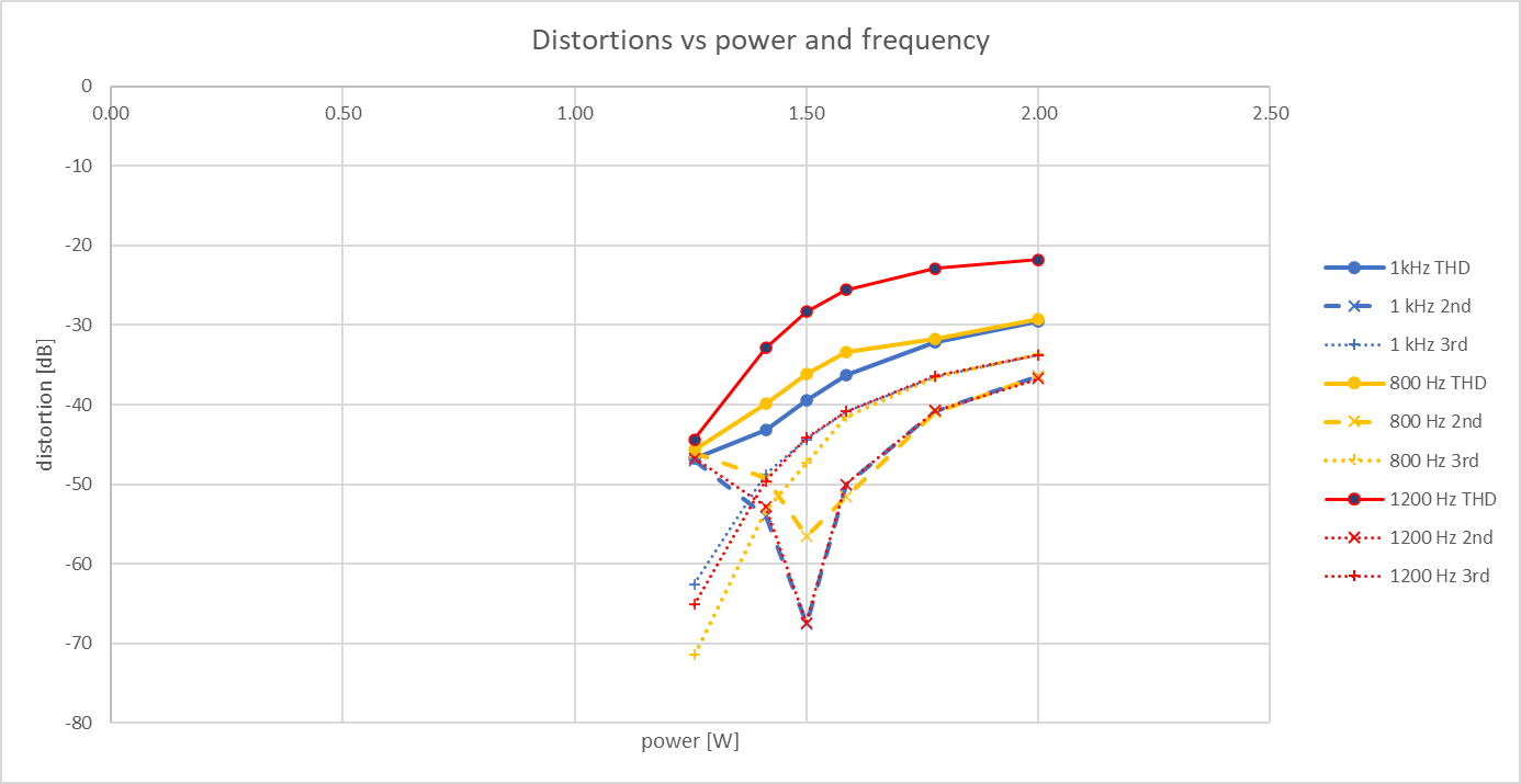

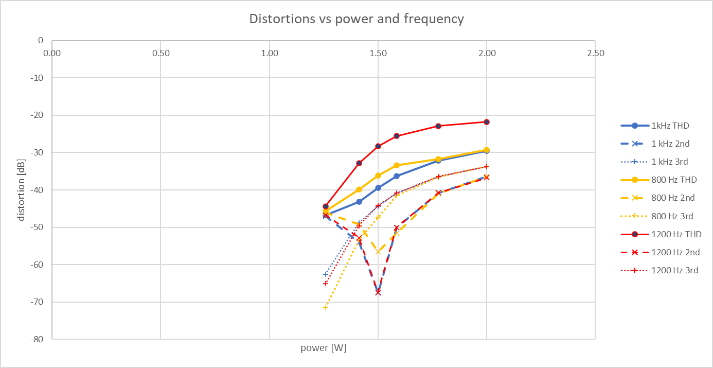

The 2nd harmonics data point at 1.5 W in the low impedance plot is wrong; I thought I had a typo in my data table where it said '-67 dB', and corrected it to -37 dB, but upon cross checking my results with REW and the Focusrite Solo DAC/ADC, there is indeed an odd structure in the harmonic distortions around 1.5 W output power. I thought it might be related to an audible output transformer resonance near 7 kHz, but that seems to be a different issue.
Here is a plot of THD, 2nd and 3rd harmonics levels at 800 Hz, 1000 Hz and 1200 Hz. The 2nd harmonics at 1,000 Hz and 1,200 Hz are almost on top of each other. All three frequencies show the dip in 2nd harmonic at the same power of 1.5 W:

Here is the structure in the (right channel) TU-8200R noise near 7 kHz; there are actually four peaks, at 7,138 Hz, 7,200 Hz, 7,272 Hz and 7,348 Hz, and all of them can be excited, either directly or as a harmonic, and lead to audible output transformer noise:
Is there a way to get rid of these electromechanical transformer resonances? I tried pushing on the coils and also on the core laminations with a (plastic) pen, but did not observe any change in sound. Would one have to embed the whole transformer in resin? Or (re)paint the coils? I do not really want to take the transformers apart.
What is not shown, but contributes significantly to the THD, are the strong excitations of the 7.2 kHz transformer resonance by the 9th harmonic at 800 Hz and 6th harmonic at 1,200 Hz.
