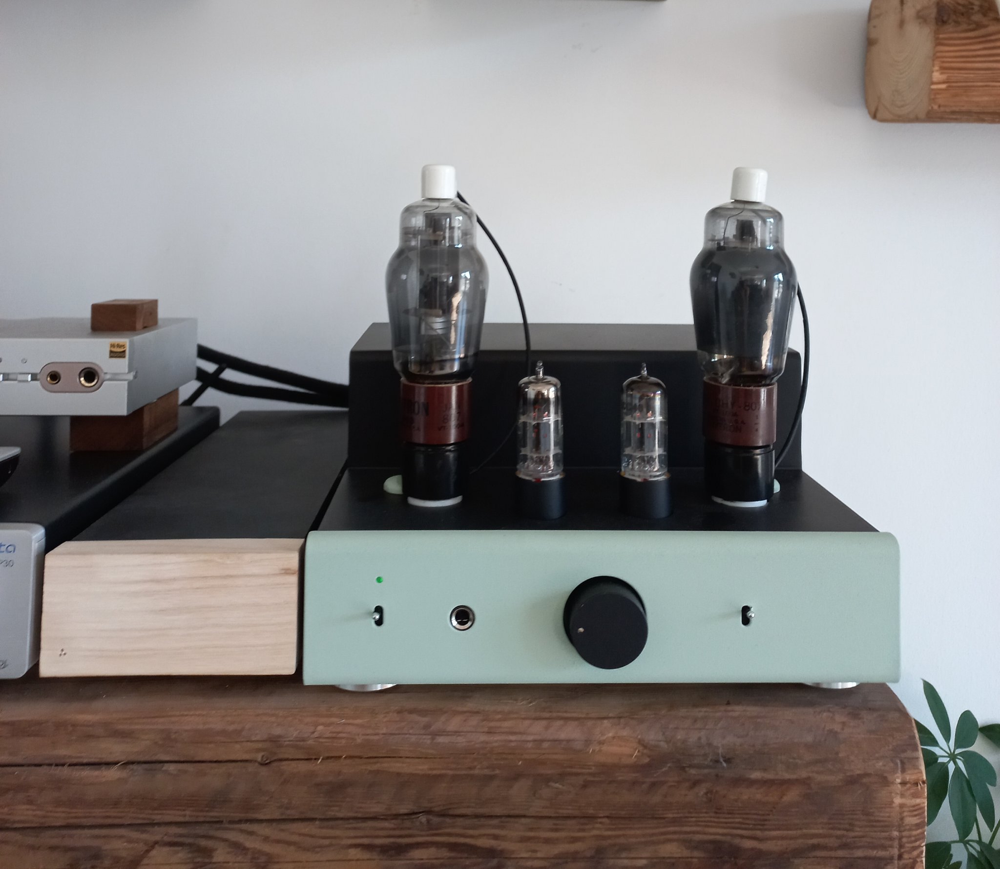

I also built the tu8500 as something of an experiment. If you're interested in continuing with building these kits just for fun, it might be worth a look - i.e., instead of the recommended schitt audio phono. It's a simpler build - but also, in at least one place, quite fragile. While trying to solder in one of two toggle switches, I ended up overheating one pin to the point that it melted its way out of the switch, rendering the switch useless. I was very fortunate that Victor Kung could quickly came to the rescue (again ...) and was able to send me a replacement. Happy with the results - but on balance, have to agree with the assessment of NotReally: The 8200 is a pleasure, but the 8900 utterly blows me away. In the right setup (e.g., in my case, requiring some simple baffles on the room wall ca. 10 feet from and 90 degrees to the right speaker), the soundstage, as a start, is unbelievable. It extends across the entire room. On some old recordings, at least 5 or so of the different tracks composing the whole can be heard in different locations spread out across the soundstage. And so on. I never would have believed that music could sound this rich, complex, detailed, etc. outside of a recording studio or a very high-end and specialized installation running into the many 10s or 100s of thousands of dollars.
