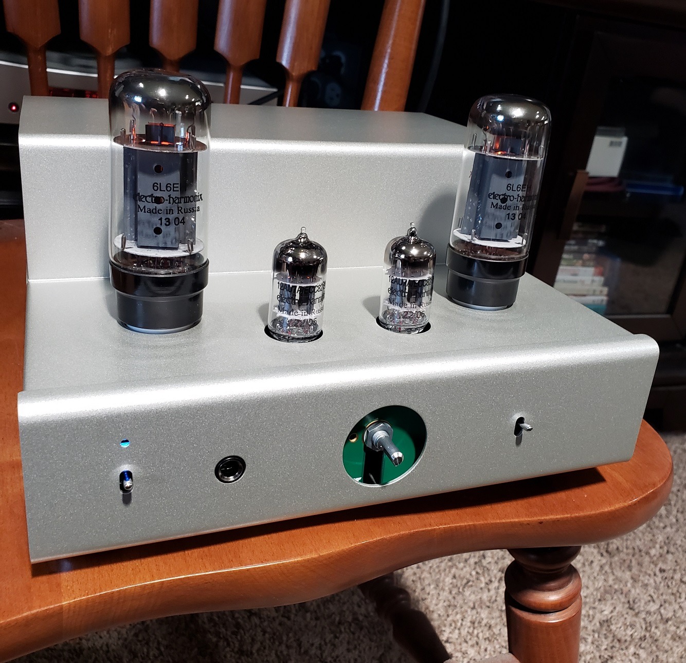

Just finished my 8200R kit today. It was like a divine sign. USPS delivered my capacitors I was waiting on 5 minutes before my lunch break. Fired up first time, absolutely no build issues. Letting it run in now with some Larry Carlton on the high-end amp stand. Lol. It already sounds fantastic. Thanks, Victor, for getting the Lundahls out so quick.

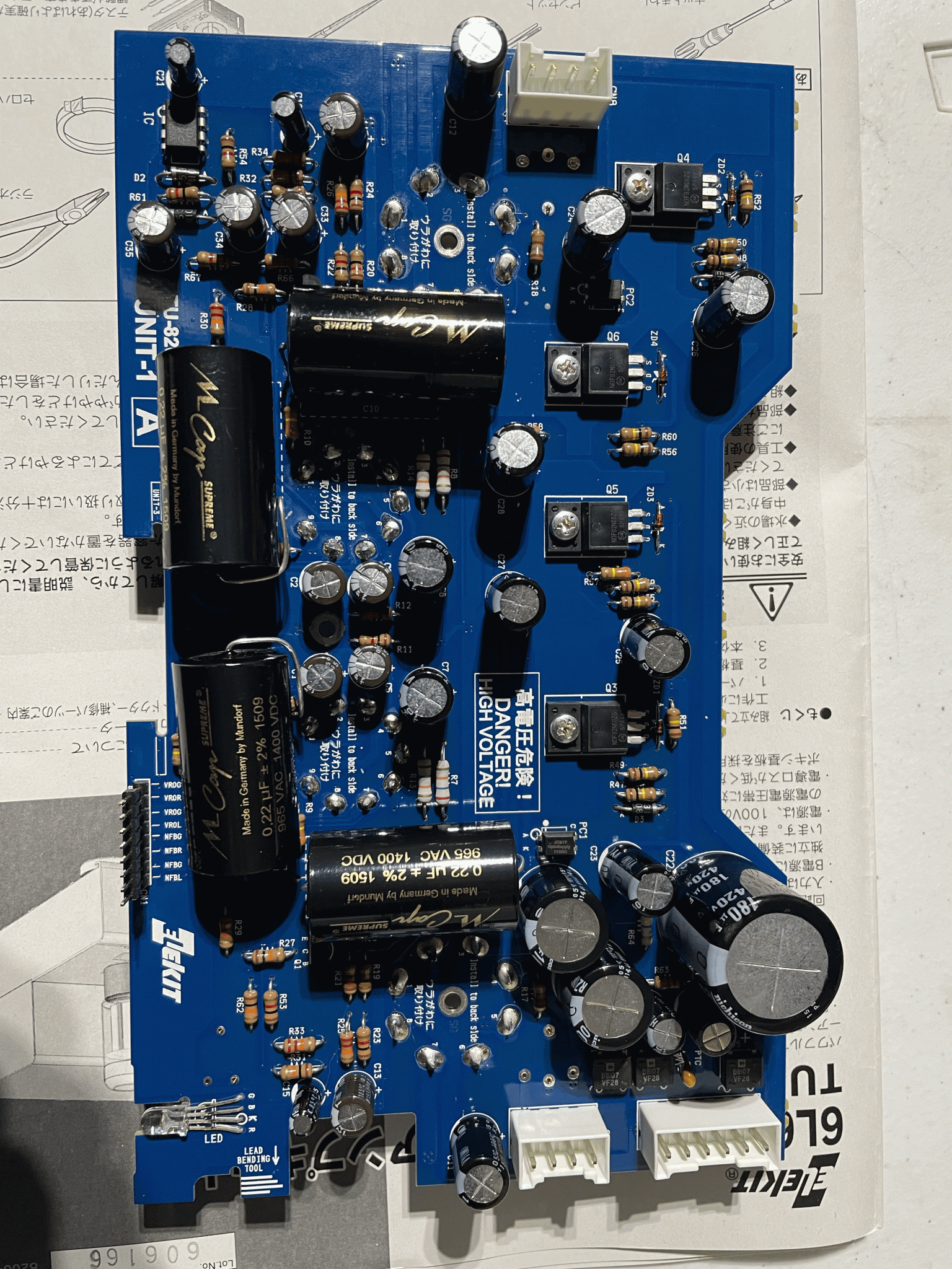

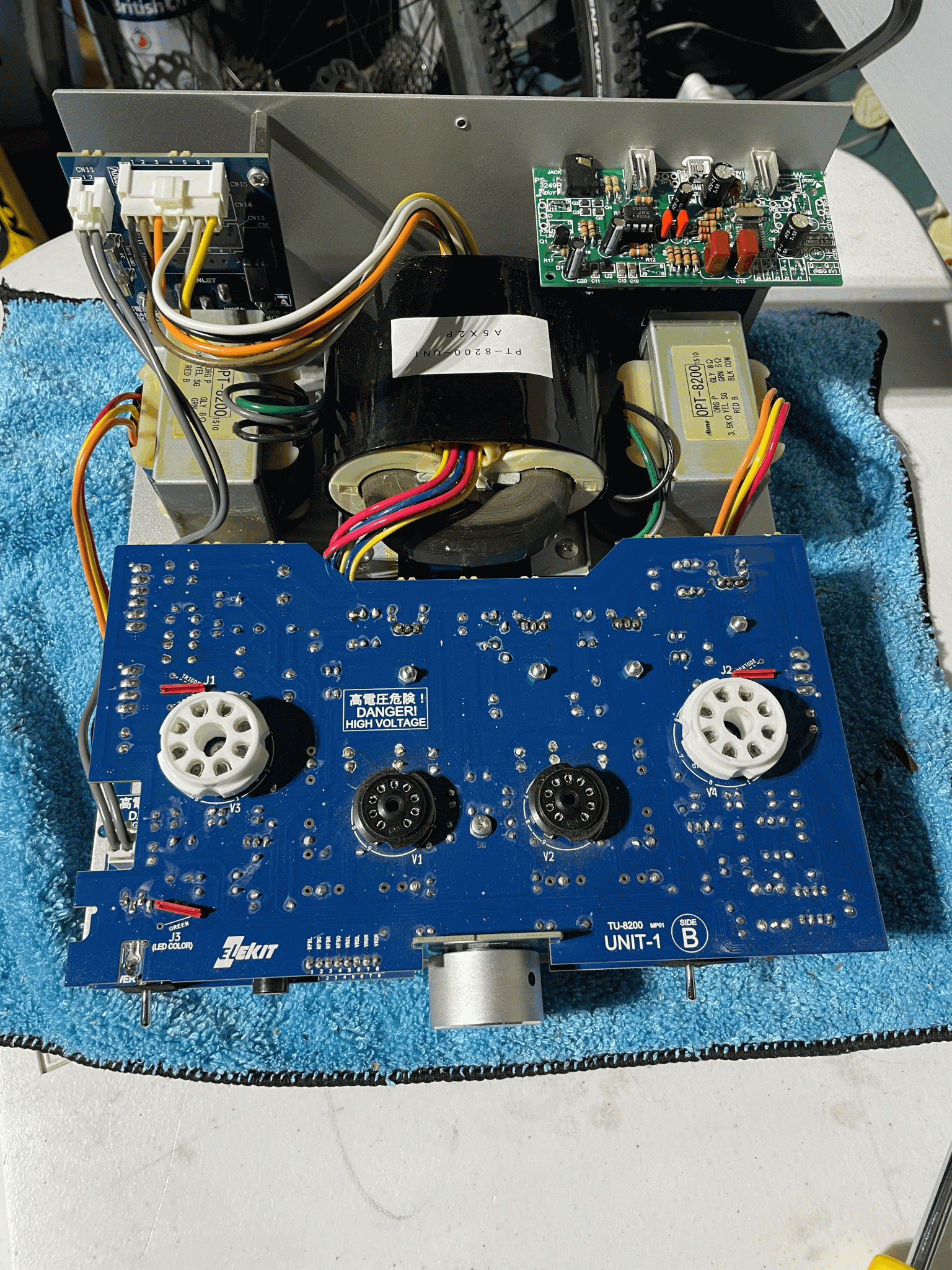

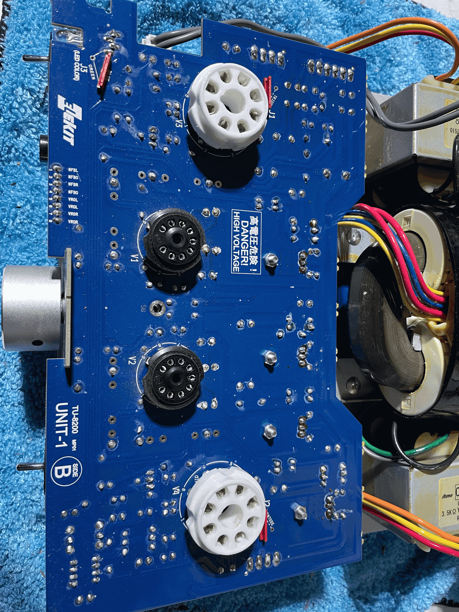

Hello
I purchased the TU-8200 (not R) in 2016 from the Australian distributor. Built up with no issues at that time.
About 3 years ago I replaced the FETs as there was hum in both channels. The amp was good again for a few years.
Recently I have had the hum re-appear in left channel only. I am thinking I will need to replace FET's (Q3 and Q5?) again, as this seems to be the solution per the troubleshooting guide.
I am wondering why the FET's would blow multiple times in this amp? Is there anything else I should look at replacing or upgrading to avoid re-occurring issues?
I use Gold Lion KT88s and the stock 12AU7.
I have attached a couple of photos in case there is anything obvious to others.
Keeping in mind I am not technical so layman's language please!
Thankyou
Peter

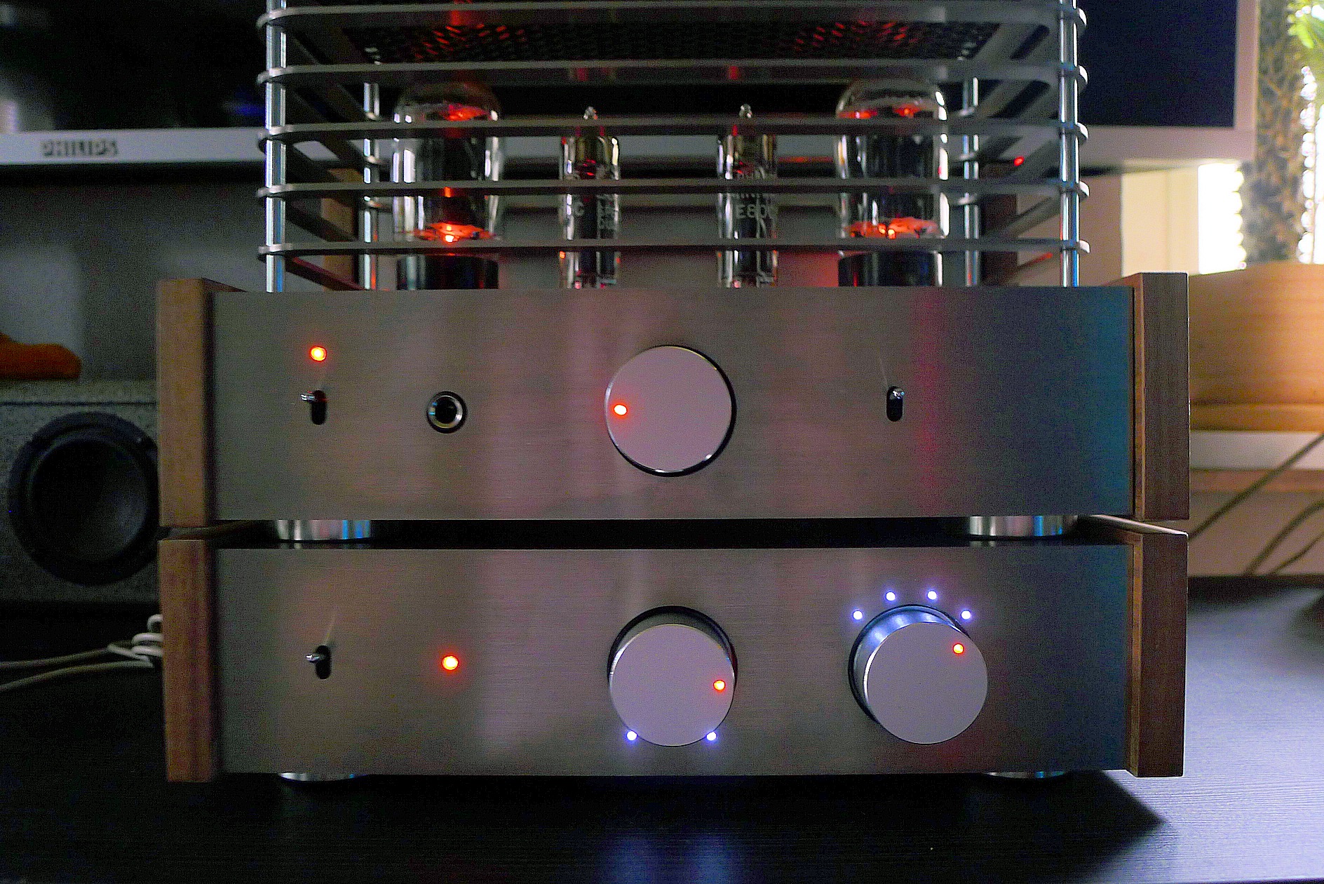

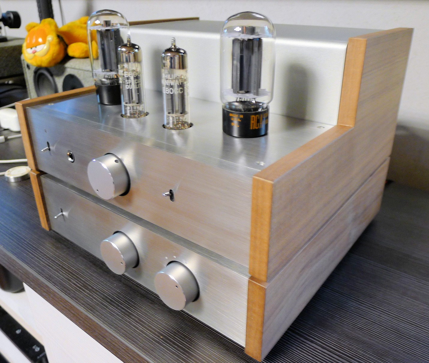

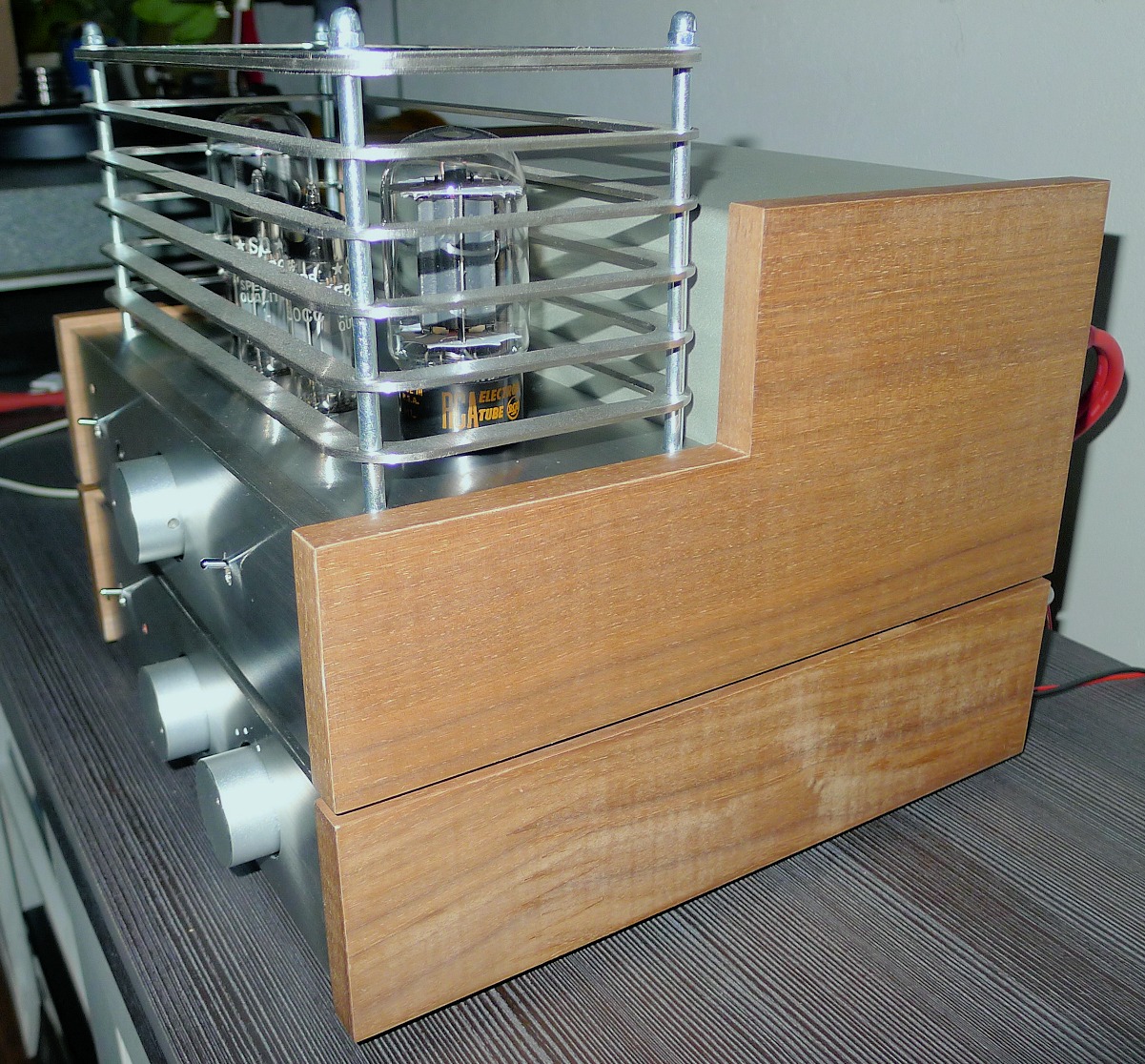

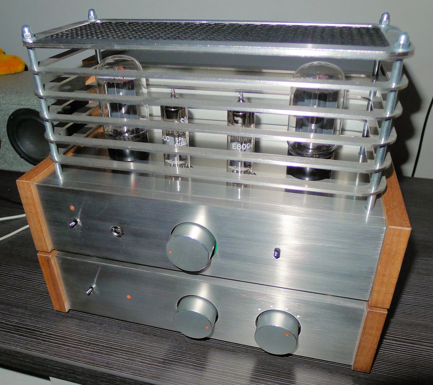

Hi folks! Finally after three months of cutting, drilling, welding, soldering, tweaking I have finished my set including all possible mods and I feel a need to brag 😎
TU8500 - visual tuning (new stainless front, walnut veneer side panels, LED lights), coupling caps, opamps MUSES01, voltage regulators from Sparkos, RCA 12AU7 black plates inserted
TU8200R - visual tuning like TU8500 and tube cage, coupling caps, full upgrade by paczeltf (great many thanks for help once again), Lundahl onboard, Holy Grail 6L6GC RCA black plates side O getter 1950's and E80CC Philips Miniwatt SQ.
Guys, holy s**t - how it sounds now! The only drawback is the final cost. In Poland Elekit is more expensive than anywhere (bloody taxes) and set costs 1 600 USD. With full upgrade it reaches 2 850 USD 😢

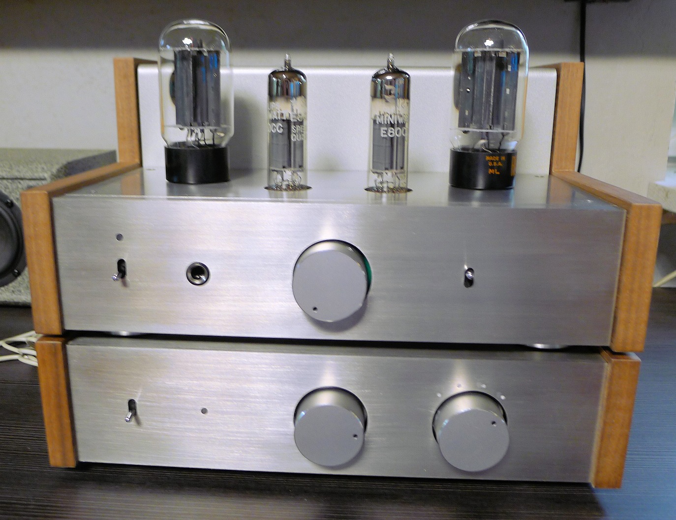

And not only sounds, now it has the look 😁 I am rather miserable photographer, but, well, something is visible at least...

Congratulation!
Take my credit! I have already watched the conversion before, read how it was made. It must have been a lot of work, but the customization turned out to be brilliant.
