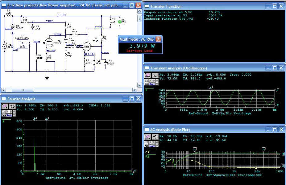

EL84 RH SE SIM
Let me remind all those who are familiar with the RH amps series... this is a sim of the original RH84 with ECC81 driver and EL84 output tube.
I believe no comments are necessary. If the sim is wrong, so are many diyers who built it and enjoyed it, emphasizing its qualities as undistorted power output and good well defined bass... at least.
Alex
Alex

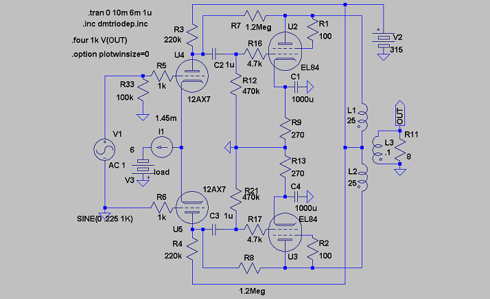

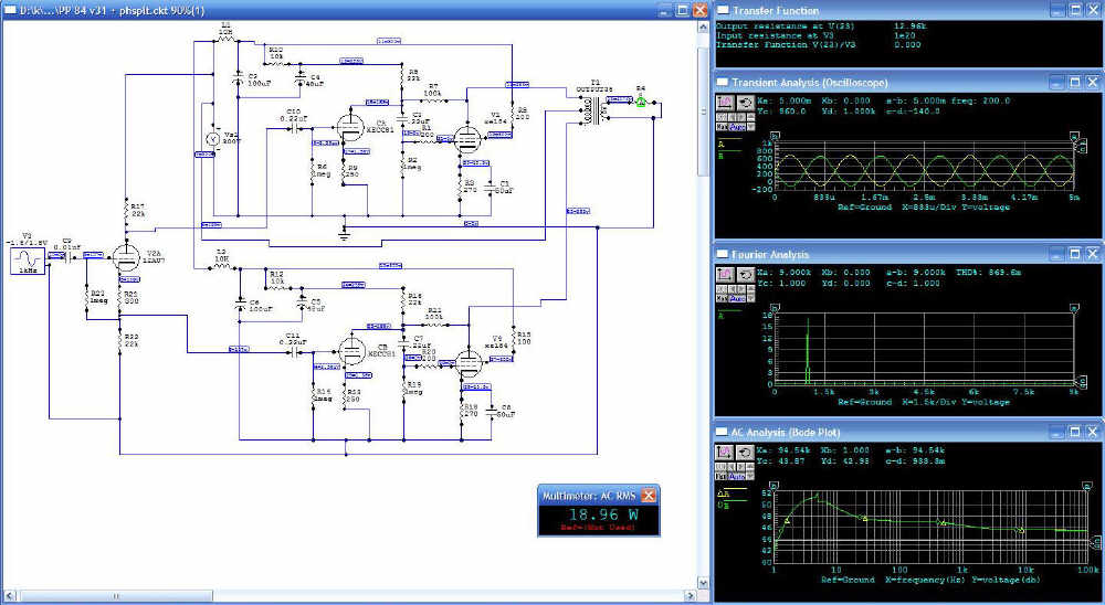

RH84 in PP mode SIM
No comment needed, except for an apoligy if the jpg is not readable enough: I had to squeeze it quite a bit to be able to upload.
I would never produced this jpg if I had not already simulated this amp a long time ago. I just do not have the time to do it right now. Do not pay attention at the simpleton concertina splitter, it's there just to make a point. If I were to build that one, I would use an input transformer (provided I had a good one) or made a long tail phase splitter.
Anyway, the SIM results are staggering... but maybe they are wrong... just maybe 😉
Regards to all believers!
2ND HARMONICS
I really do not know where did you get that?!?!?! It is not like that at all!!!
Please do not mystify things that are straightforward, and do not dismiss what you have not tried as the urban myth of good sounding 2nd harmonics 🙁
I use the old Circuit Maker... with spice 3 models, approximately. When I cannot get a generally accepted model, I write one, based on the curves... not easy, but it pays off with correct results.
Alex

As expected, the mainly 2nd Harmonic cancels out perfectly in a P-P sim. But we have no idea here what models are being used for the tubes in the Sim. The usual simple 3/2 power law models produce mainly 2nd harmonic. Real tubes make higher harmonics when loaded down. How does the real RH84 measure with a soundcard FFT? Particularly for 3rd harmonic and above.
With 1% 2nd Harmonic (or maybe more for real hardware), this is quite hearable.

BEFORE I GET TO SLEEP
Please take a look at the schematics and the various simulation diagrams. You will find all the analysis necessary there, showing you the various 2nd, 3rd and higher order distortions, if there are any.
Yes, the simulation of a PP amp can subtract nicely, better than in real life, the 2nd and even order harmonics -- but because those are subtracted in theory by the PP circuit itself. In the SE amps there is no such subtraction per se. When it comes to the remaining distortions, those are mainly odd order distortions for PP amps. The sim says something like 0.7%... I do not have the reason to doubt.
Of course, you can always build an output stage for testing and test on "real life" analysers 🙂 But it will not do you any good for guitar amps where particular sound and distortion are welcome...

Simulations are notoriously inaccurate for higher order distortions, especially with simplistic 3/2 power tube models. Surely you have tested the real thing with a sound card FFT? Every PC can do this.
I'm not trying to attack the RH84, It probably does sound very nice. But the claim was made above that loading the driver triode down does not make worse distortion. Even novice designers know this to be the case. For SE, a bit of 2nd Harmonic can sound quite nice to some.
One can of course also shift the operating points of the two tubes to program the level of 2nd Harmonic somewhat, since they are of opposite phase. Loading down the driver will likely cause some cancellation of the usually higher 2nd H distortion of the output. So the RH84 may actually have lower 2nd H than usual for SE. But, in general, loading down a triode's plate will cause higher odd harmonics, which cannot usually be nulled out by the 2nd stage op. point.
