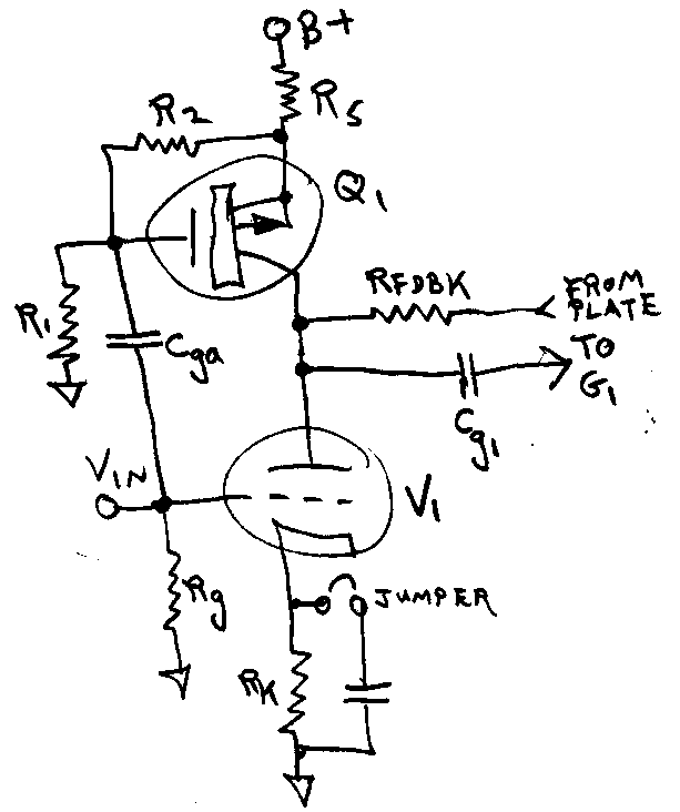

It occurs to me that the shunt plate feedback to a triode driver configuration could be patched up, if it could be run at constant current. Then its plate Z would be constant, eliminating driver distortion (well, most), and loading on the triode.
This scheme (among others) came up earlier in another thread when Rich Walters mentioned mods to the dePalma splitter. Not everyone will be happy with SS in the circuit, but its function here is to act as a "near" high Z current source load for the triode driver below. The triode still sets the voltage output and Zout.
The active CCS is adjusted so as to maintain as near as possible a constant current thru the triode AFTER all other effects are combined (feedback, output tube g1 load). The cathode resistor could be used to sense current thru the tube (remove jumper) while one of the gain affecting resistors around the Mosfet "CCS" are adjusted for a constant current or best null condition. If the null turns out to be darn close to constant current, then maybe the cathode bypass cap can just be eliminated.
Can think of this approach as relieving the triode of linear currents, but still generating error correction currents when its plate gets tugged off linear by feedback errors. These small reactions have next to no effect on plate Zout compared to the linear current holding constant Zout.
Don

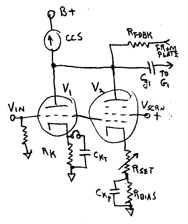

Here is an all tube re-work of the triode shunt driver idea presented in post 751. The pentode would be a hi Zout tube. It's gain is adjusted (Rset) until the current thru the triode remains constant or as near as possible to constant (with shunt feedback and output tube g1 loading present). The triode then maintains a constant Zout and operates linearly under near constant current.
The triode controls the voltage output, since the pentode appears as a high Z current source. Any error feedback thru Rfdbk is seen by the triode as deviation from its required plate voltage, allowing the triode to correct by adjusting its current. The triode therefore only varies its current a tiny amount in response to detected errors, maintaining an essentially constant Zout.
Don
Don
