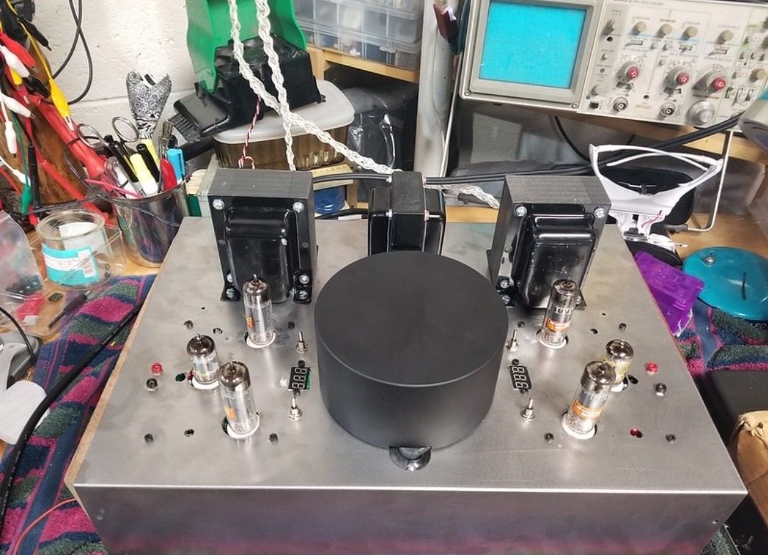

I called Antek. They were very responsive and easy to deal with. Francois, you are correct. They told me that the cover sits above the top plate and does not touch it. He also said that the cover is powder coated so there would be no connection even if it touched. I asked him if I could use a nylon bolt to give myself a little more confidence. He said I could, but that it was not necessary.
Francois, do you or anyone else have any further thoughts?
I used an antek cover on mine, no shorting, works perfectly.
Thank you, dBell84. The covers that Antek is currently selling are slightly different from yours. Now they connect to the chassis through a bolt in the center of the transformer.

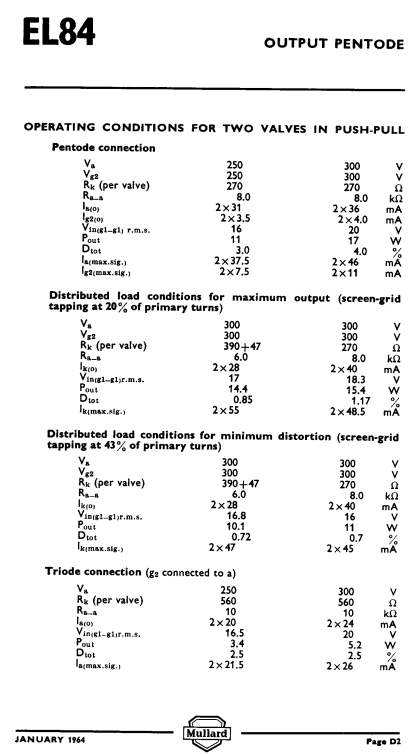

In terms of output it kinda depends at which THD you consider the max output, but its likely somewhere in the 12W
For EL84 push-pull, the datasheet has it at around 15W for 20% taps and 11W for 43% taps

With a B+ around 330-340V and 30 mA you’ll get around 20 Wrms. Don’t expect them to be at 1% THD, but that amp is pleasant even at high volumes.Does anybody know the output wattage of the EL84 BH with the 23% taps
That’s with a B+ of 300V and UL only. I considered 340V with a stronger Schade feedback. With a 13% increase in voltage there’s circa a 39% increase in power, that’s the 20 Wrms I mentioned.For EL84 push-pull, the datasheet has it at around 15W for 20% taps

The other numbers are comes from simulation I think, not from real test.
In class A p-p, pentode connection I got 10 wrms

All data you have got in this page, with different configurations, are right and confirmed by the datasheet linked above:
There will then be some variations due to the fact that:
- this amp is fixed biased vs cathode biased on the datasheet (means more power)
- this amp adds a-g1 feedback and the datasheet data don't (means lower THD)
- different voltage supply give different working conditions and so different power and THD.

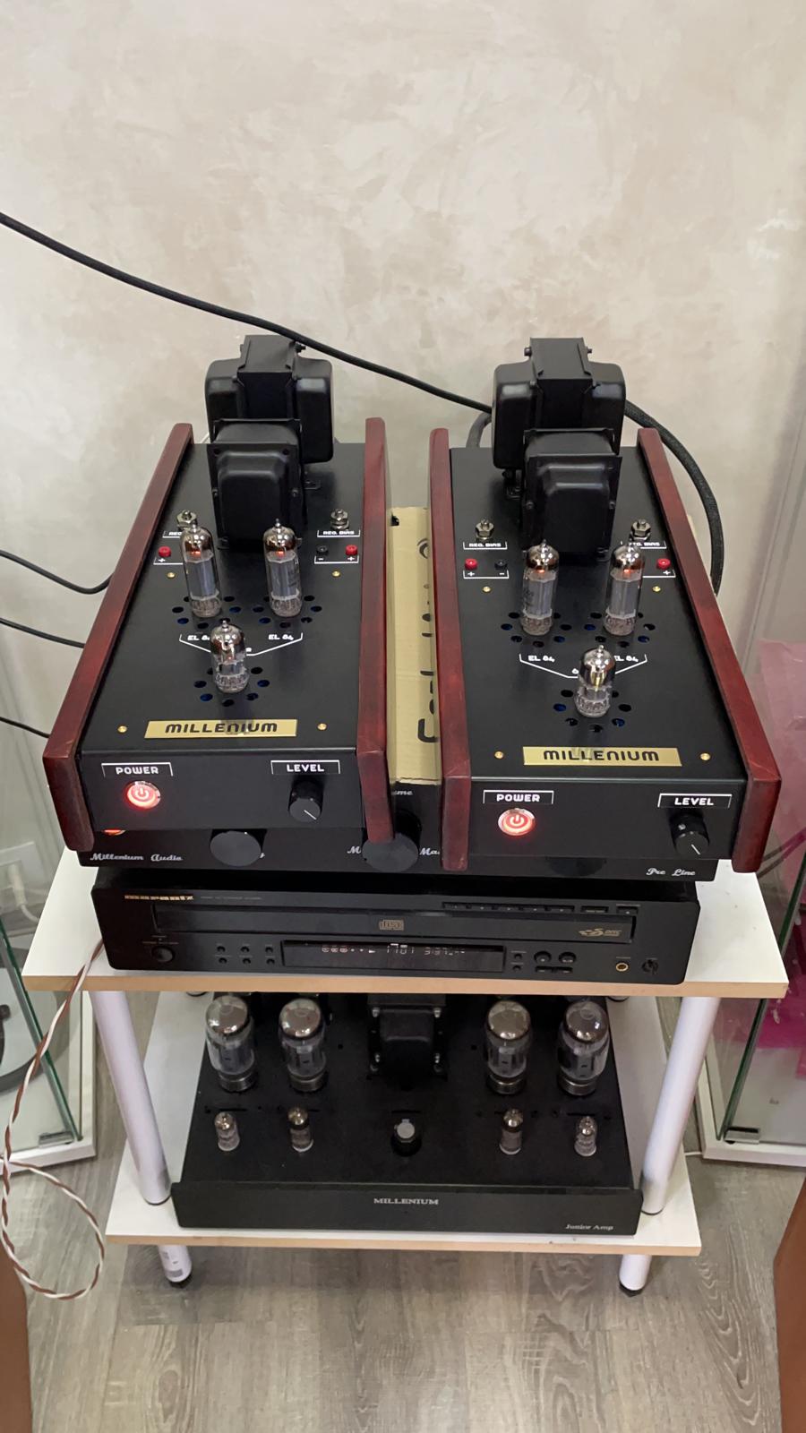

I've been conservative with my monoblocks (each trafo is indeed enough for both channels), because I installed them inside the chassis and I wanted them to run cool. In any case, those are the specs I've used:
TS 100VA
PRI: 230V
SEC I: 235V (250mA)
SEC II: 6,3V (5A) CT
SEC III: 55V (50mA)
