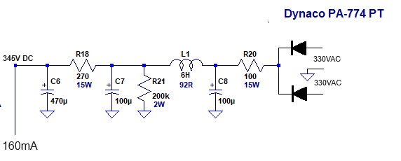

I'm finally (FINALLY!) getting started on a minimalist Baby Huey EL84 build. I was going to try EL86s, but since I have the iron from a Dynaco ST35, I figured I should use it. The problem is, its power transformer (PA-774) has a secondary rated at 330V-0-330V at 180mA. Full-wave rectification using a couple of UF4007 silicon diodes will probably yield 420V DC. That's an awfully high voltage for EL84s, even with cathode bias.
My question is, has anyone used this PA-774 transformer in a Baby Huey (or similar) build, using today's EL84 tubes? Did you get it to work without burning up your EL84s? If so, how did you do it?
I'm thinking of fitting a CLC after the UF4007s, then a second RC stage consisting of a 270R 15W resistor and 470uF 450V capacitor. But it sure is wasteful. Seriously wasteful.

Use an LC filter. That will give you a little less than 300 Volts.

If the cathodes of the rectifiers are at 420 volts and anode is -466v then thats 886 volts reverse breakdown.
This means you need diodes with a higher reverse breakdown voltage.
Seeing as how you have a choke, you can use a low value capacitor in front of it (~1 uF?) to adjust the voltage to what you need, followed by a higher value capacitor for energy storage. Play around with PSUD to see how much capacitance you need.

You might also consider using a less efficient rectifier like a 5u4g. Run a few options through psud2 to get it optimized. Besides are tubes not better to look at than diodes.

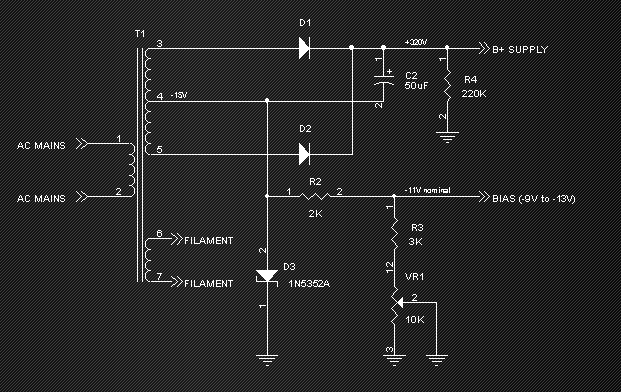

Could you put the choke on the ground side of the supply, in a back bias type of solution, then you could end up with a negative rail for the CCS supply.
Interesting idea! I found a description of using the DC resistance of a power supply choke to derive a negative bias voltage in MerlinB's power supplies book. The questions I have about that are:
1) Will the choke still be passing the full plate current of the four EL84s and two 12AX7s? If so, that's going to be about 160mA at quiescence, and more on signal peaks. If so, the bias voltage at quiescent operation would be 92R(0.16A) = -14.7V. But that voltage will go more negative under peak demands, e.g., -16.6V if the EL84s draw 180mA. It looks like that could be an issue if it causes the cathode voltage of the LTP to vary with changes in signal output from the amplifier.
2) Will that voltage dropped across the choke's DC resistance subtract from the rectified DC voltage? If I put a power resistor in series with the choke to increase the apparent DCR, thus dropping more volts there, will that also decrease the B+ voltage referenced to 0V ground? Or does that not affect the B+ voltage since the first filter capacitor will be referenced to 0V?

I found an Aiken Amps article on back biasing that looks promising:
https://www.aikenamps.com/index.php/what-is-back-biasing
The following looks like it could be a good way to derive a -20V bias supply for the tail of the 12AX7 LTP (I'd use a 24V Zener instead of the 15V Zener pictured):
However, if I increase the value of C2 way up to 100uF or more, would the inrush current at turn on burn out D3?
Hmmm, there might be a fly in the ointment/ The B+ supply will be drawing 160mA or so at quiescence, and more during peak demand. If 24V is dropped across the zener with 0.16A, that's 3.84 watts of dissipation. Now I'm looking at a zener string that may need a heat sink. Complications...

I was just going to go with a brute force solution of deriving a B- supply using silicon diodes with a couple of decoupling stages to knock the voltage down to something reasonable, then using a large value resistor as the tail load. Like this (270k 2W in the schematic below):
That's basically what I'm planning to build using the Edcor 500VCT power transformer, but the B+ and B- voltages may be more like +/- 310V after filtering stages. The downside is the need for the very large value resistor in the LTP tail, which will exceed the 12AX7 cathode to heater voltage until the tubes warm up. That's why the 1N4148 diode is connected from 12AX7 cathodes to 0V. I'm pretty sure that will work well enough.

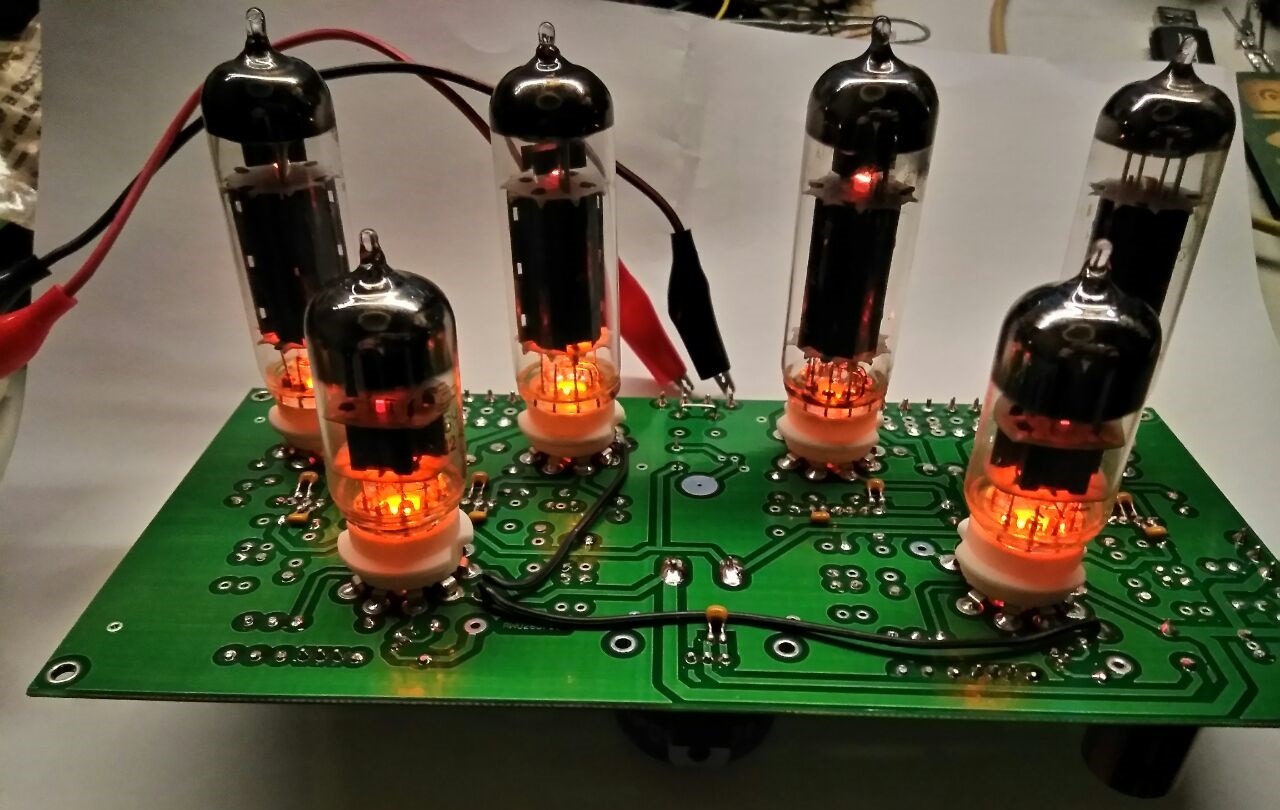

Wonder why @rongon wants to build a simplified Baby Huey? Similar to the first iteration @gingertube stated out with, before adding on all the “improvements”. Let’s see. 🤔 Wonder if simpler is better?
You have the Baby Huey PC’s (I thought), you have great Dynaco Z565 UL output transformers, you have a suitable 500Vac CT power transformer. All you need to get is a small 30-50 Vac transformer (~$15) for the bias supply and you can build you very own “full-fledged” Baby Huey.
It's an experiment.
Also, the PCBs won't fit in this chassis without surgery, since this chassis has already been punched and drilled for six 9-pini mini tube sockets, with mounting holes and space for two OPTs and a single power transformer.
I also like the idea that this simplified version has fewer active parts, so should be easier to troubleshoot should problems arise.
For the Baby Huey PCBs, I'd like to start from scratch, punching the holes in the right places the first time.

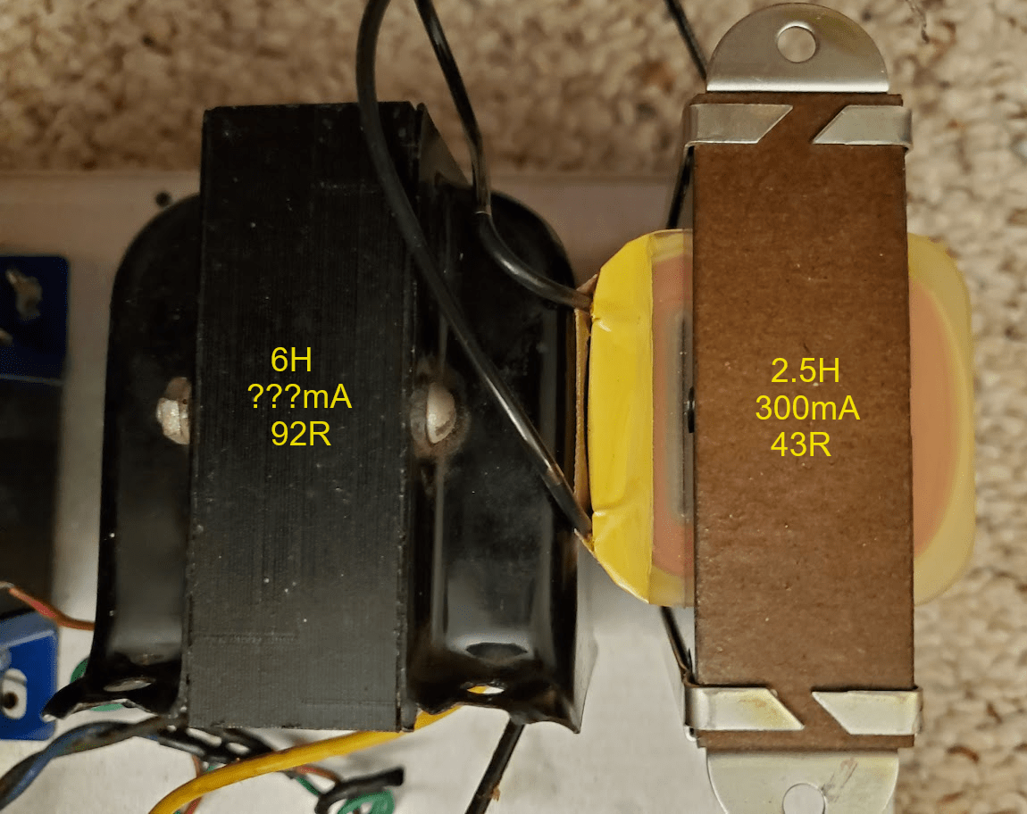

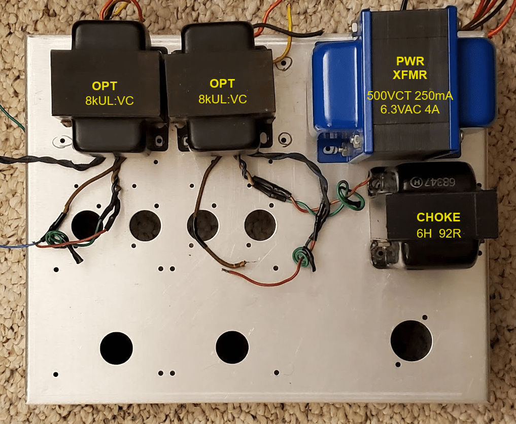

Layout decisions first. Here's what the transformers look like on this hand-me-down chassis I have:
Is the orientation of the power transformer OK in relation to the output tubes?
Does that 6H choke look capable of handling two channels of push-pull EL84s?
I'll have to drill some new holes for the OPTs and the LTP tube sockets, and it looks like I'll have to punch holes to fit a couple of large 800uF 330V radial capacitors I have in stock.
I'm thinking the power supply will consist of a simple full-wave rectifier (power transformer CT secondary) into a 100uF 450V reservoir cap, a choke, and a 470uF 450V filter cap. A bleeder resistor would go there too. From there, each channel gets its own 150 ohm 5W resistor and 800uF 330V capacitor decoupling for its plate supply (B+), I'm pretty sure that will be enough ripple filtering.
I have two chokes I can use for this. The 6H 92R one pictured above, or a Hammond 159T 'reactor' (swinging choke), rated for 2.5H at 300mA. I know that one will work. Here's a photo of the 6H mystery choke and the Hammond 159T, side by side:
Going by size alone:
Can one infer the continuous current capacity of the chokes from their core size?
If so, I'd guess the 6H choke is rated for about 150mA continuous, and so is just marginal for use in this circuit. Or am I wrong about that?
- Both have the same size core at 3.5" x 2".
- the 6H choke's laminations stack is ever-so-slightly fatter at 1-1/16" thick.
- The Hammond 159T (2.5H 300mA) choke has a slightly thinner lam stack at 1" thick.
