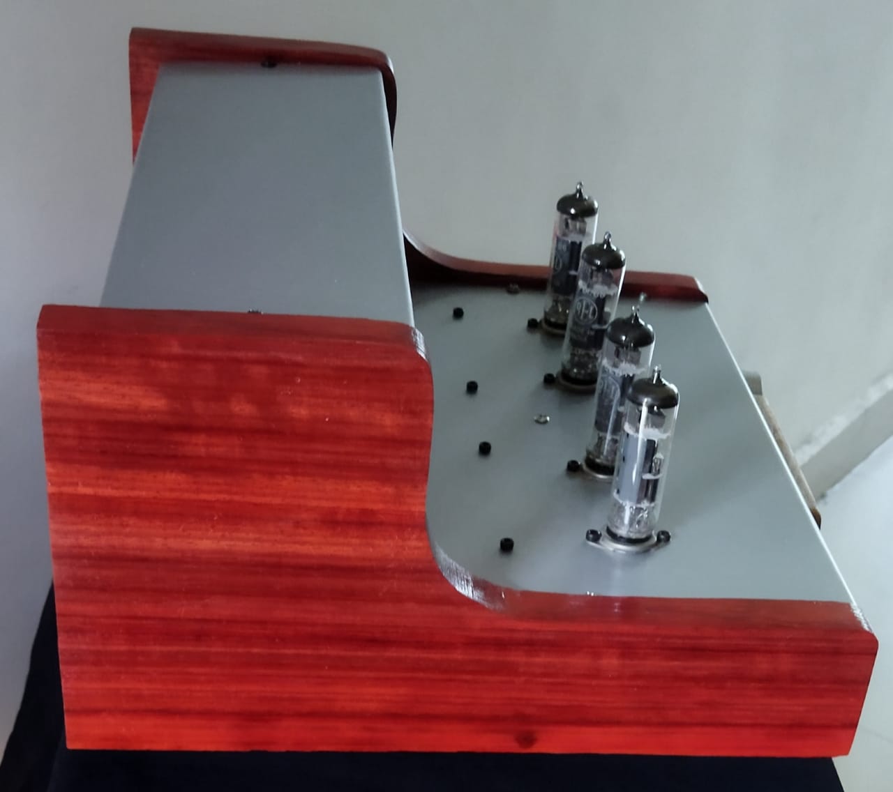

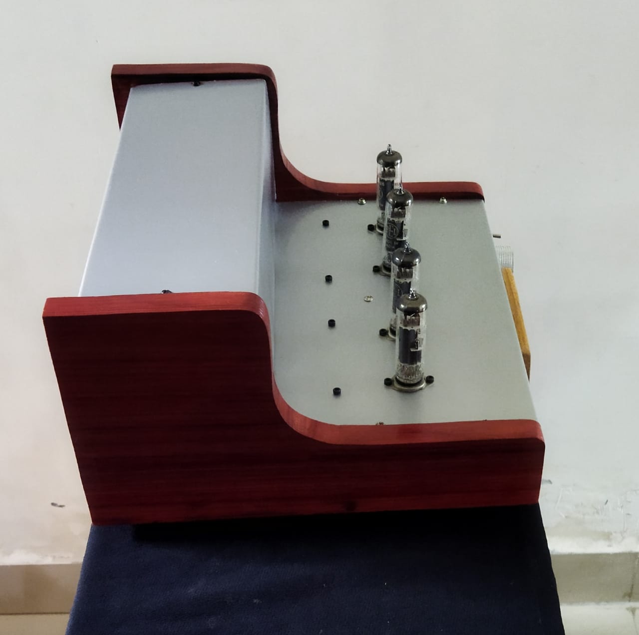

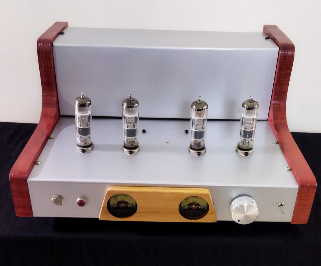

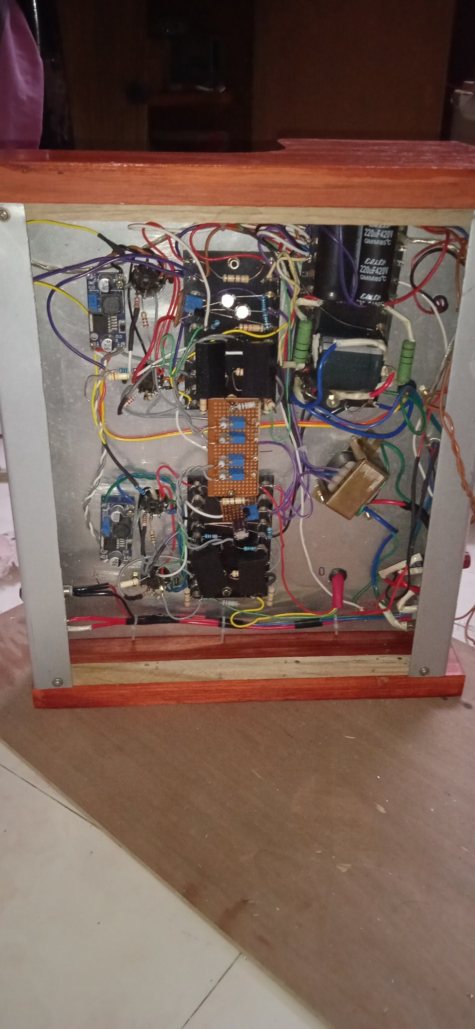

The amplifier has been completed and it works extremely well.. Changes from the original schematic includes Individual bias pot provided for all tubes ( to get equal current draw). The coupling cap was changed to 400 v ,0.43 MFD, metalised polypropylene..

I did the Yvesm original schematic with Pcl86, no PCB,But point to point.. Individual bias pots and the current draw resistor in the Cathode are the differences from the original schema, and not to forget, Potentiometer is 22k linear.. ( log pot not suitable for my liking)

Jazzman, Thanks! I got these VU meters from theaudiocrafts.com,an online electronic spare shop from India. It is the Nissei TR 35 VU Meter and it is widely available across many online sources

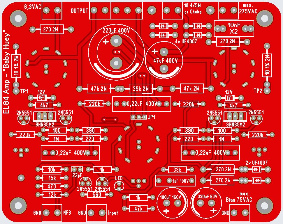

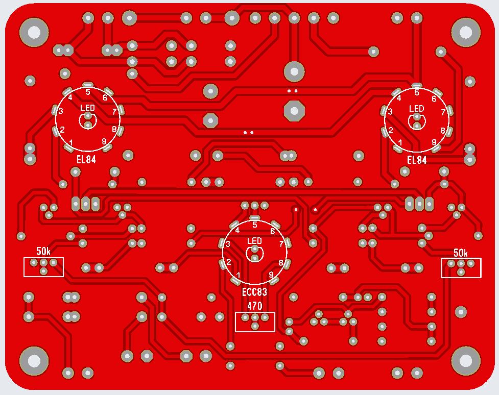

Ilorev wrote:
“It could be the heat, but I have to put a lot of patience. Here's a lay6 of BW.
An inspection is required on your part to look for mistakes, as the work is currently untested.
Gerbers will be available as a keepsake to the great Marc... RIP”

It will be the heat I'll put a lot of patience and here's a lay6 of BW.
An inspection is required on your part. Tell me mistakes then the gerberas will be available as a keepsake to the great Marc... RIP
