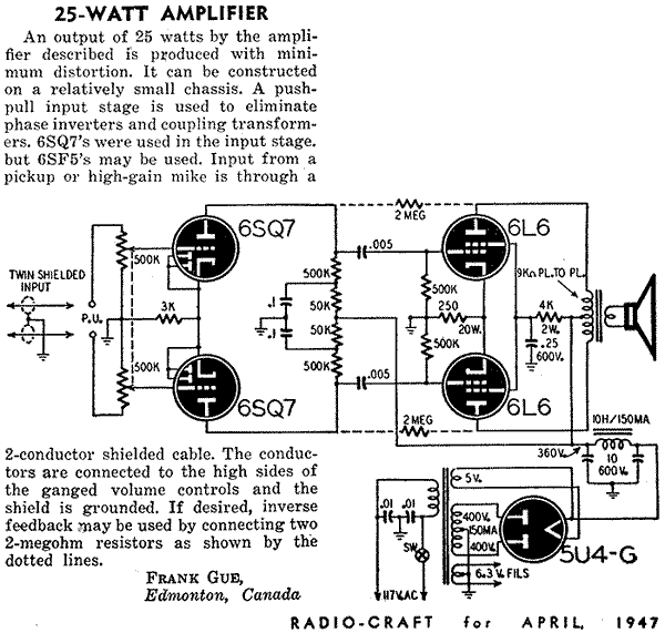

Tubes4e4 said:
.... a published real world design dating back about 8 years or something.
There hardly is something really new under the sun regarding tube tech 🙂
Here is a published schematic from over 60 years ago.
dave
I am sorry the RH84 sneaked in, but is has some relevance as the discussion is about plate to plate NFB. Think it started when Alex dissed my suggestion of another kind of plate NFB of the Huey.
Sorry again, shouldn´t have replied to the accusations. that obviously poured more gasoline on the fire 😉!
So back to the original subject with PP with local NFB! I am sure the Huey can get even better with tweaking of the NFB.
