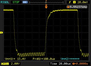

UL-feedback instability
Gingertube,
I'm building my 2nd BabyHuey using James JS-6228H transformers.
First, I tested the fixed bias variant with feedback from the EL84-anodes.
The scope-trace on a square-wave showed no instability and a quick listening test confirmed that everything sounded ok.
Then, I converted to feedback from the UL-tap and modified the resistors to the 10k-9k1-10k scheme.
Here I'm having excessive ringing on square-waves I can't get rid of.
The shown scope trace is at medium power level, turning up the wick worsens the oscillation. The probe is attached to an 8R resistor
connected to the OPT's 8 ohm tap. The oscillation is independant
of the square-wave frequency.
Things I tried and checked:
- Grid-stoppers are right at the EL84 socket, a variation in value up to 1k had no effect on the oscillation.
- 100uF+220nF are soldered right at the OPT B+ tap, this addition had no effect.
- Swapped the EL84 tubes, this has no effect
- Increased/Decreased the value of the 9k1 feedback resistor, this had no effect.
I also tried your later 6k8-22k-6k8 settings to no avail.
- Suppression of the 10R common cathode resistor of the EL84. This has had the most notable effect so far:
- The suppression of the 10R provoked an oscillation of the upper *and* lower part of the square-wave
- The addition of the 10R made the oscillation on the *upper* part disappear
- An increase to 22R had no effect.
Gingertube, did you encounter similar issues during testing you UL-feedback variant ? Any more checks/tweaks come to mind?
I remember having had a similar issue a while back when testing the cheap Hammond 125E OPT in my 1st BabyHuey.
When the 125E was replaced by a better Hammond 1650E everything was ok then.
A test I've still on my list is to swap out the James for a known good Reinhöfer-OPT of german manufacture.
If the problem still persists, my wiring is perhaps at fault. If not, the James JS-6228 though having a good reputation, doesn't like
operating in this topology with UL-feedback.
Kind regards,
Yves

Yves,
Traditionally zobel networks were used with Ultralinear, wired on each side between anode and screen tap. Additionally g2 stoppers in the screen grid connection were often required and counter intuitively it seemed that the better the output transformer the more the g2 stoppers (higher value resistor) were required. Insufficient g2 stoppers usually shows up as "squegging", burst of RF just after the turn overs on +ve and/or -ve peaks, so that does not sound like the problem you have observed.
In the unit I am running at the moment I found that taking the feedback from the UL taps meant that the speaker impedance curve was more critical than when feedback was taken from the anodes. I fitted 10R + 1uF zobels across the 4 Ohm speaker taps. This helps linearise the speaker impedance with frequency BUT also its reflected impedance did at least part of the job the zobels from anode to screen would normally do. You could try this. You can also try increasing the g2 resistors.
You could also try zobels from anode to screen tap, I'd try a resistor value of 1K and capacitor of 1nF as a start point and then just change the cap value trying 470pF or 2n2 as required.
The other thing I've done in the unit I'm running right now is an interim thing. I added a Maida reg from B+ and then added 390K from the Maida Reg Output to each anode of the diff amp and doubled the diff amp current. That was just to get the diff amp triodes running in a more linear part of their Ia curve so that it did'nt "grunge up" as much when pushed hard. Eventually those 390K will be replaced with current sources or I may try to see if a can implement current mirror loads on the diff amp.
I have been a bit quiet while I built a new electronics workshop. That is now complete and I should get back to more work shortly.
