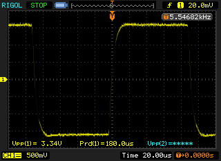

Yves,
"No worries mate" as we say in Oz.
For teh anode screen tap zobels - these should go direct across the transformer wires.
anode to screen is 0.3 of total pimary or 0.09 of impedance - so with 8K total primary that gives 720 Ohms impedance of one anode to screen winding.
Zobel traditionally use a resistor value of 1.4 to 2 times the impedance they are in parallel with so 1K to 1K5 for the resistor. 2W Metal Film resistors. They can dump a lot of HF power.
With 1K then 1nF will have roll off above 159kHz, probably too high.
That suggests to me that 2n2 would be better, then roll off is above 72kHz.
I know that the little Hammond 1608 had resonances at about 68kHz
Ian

Success
Ian : Feedback about zobels
The 2n2-1k zobels across anode and screen tap took care
of the oscillations completely. See attached trace measured under
the same circumstances.
Even the one channel which was only marginally stable is cured completely.
The signal now drops in a linear way at 20kHz way down to
60kHz. Without the zobels there were several rises/drops in the 30kHz..60kHz band, although according to the spec. sheet the resonance of the James 6228 is at around 100kHz.
Time for a listening session... 😀

Ian (Gingertube),
>The amp seems to be much more susceptible to speaker impedance changes with frequency when using the UL taps so in general
>I think sticking with the anode connections makes sense, especially with speakers with complex impedance profiles
This seems to confirm the experiences I made with my Fullrange speakers, they don't have a linear impedance over 40Hz..20kHz.
The anode connection seemsto be the more universal & easy setup. To setup the UL-connection correctly, you need
an oscilloscope to check the signal, moreover it responds more critically to the type of OPT and speaker at the end.
>P.S. I greatly appreciate your testing, suggestions and insights into the Baby Huey. Thank You. I hope you are enjoying your BH Amps.
Yves
Is the amount of feedback the same with both, anode and UL connections?
Could it be that the UL FB connection is giving you less feedback and lower
damping factor? The Zout must be higher for you to observer the greater
dependence on load impedance.
Are the g2 connected the same way in both cases?
Michael
