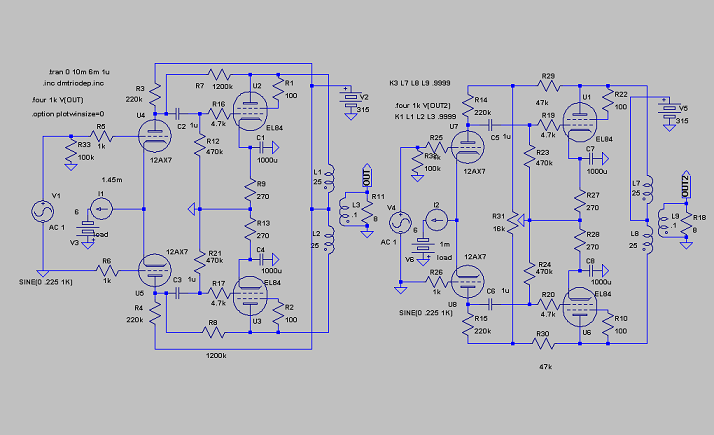

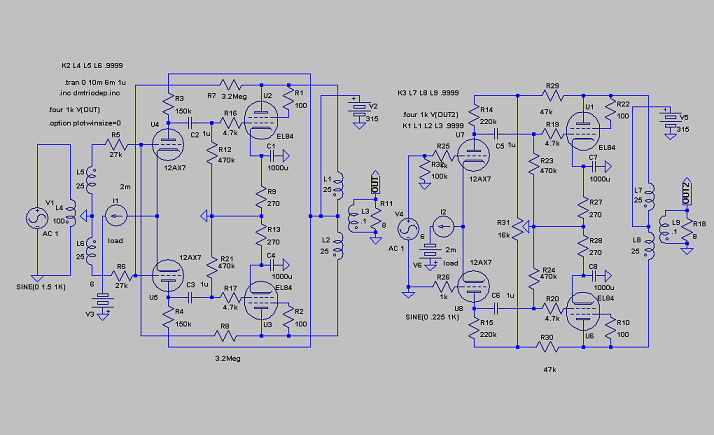

Did a quick sim with the two types of feedback. Made use of the possibilty to DC-couple of the feedback.
Anyway tested them as they are. The Huey version distorts and also clips earlier. Have not made a deeper analysis af feedback degree etc. Will adust to the same local NFB later.....
A big BUT though: The Huey is feedbacked over one stage, the X-coupled over two.........

This is as expected. The feedback anode-anode presents a much lower impedance load to othe driver tube resulting in a steeper load-line. This will limit possible feedback that can be applied before driver distortion becomes excessive.

Never occured to you that your sims could be wrong 😉 ? Please show your sims if you don´t agree! If you use LTSpice we could exchange *.asc . Makes it easier to discuss then.
Maybe your sims are not correct, maybe the models are off, maybe there are mistakes in the basics of the simulation?
Plate to plate feedback for SE with a triode driver will lower the output Z (better damping) but cause more driver distortion unless buffered. For SE, this would just mean more 2nd Harmonic, which many like the sound of. Lower distortion does not necessarily translate to better sounding to some (or to many).
One would expect the higher loop gain of NFDBK around two stages to give lower distortion than just one stage (at least up until hard limiting). One caveat with the crossed feedbacks, back to the driver grids, is that when leaving class A operation of the outputs, the feedbacks to have to pass thru the xfmr. This can lead to instability problems. This is also an issue with the crossed feedbacks to the driver screens scheme. This problem can be avoided with an Elliptron-like CFB setup on the outputs, where each tube uses both sections of the CFB winding.
On Jaap's design in post 700, there is no feedback to the output grids (or P-P), so the driver buffering is really an option.
