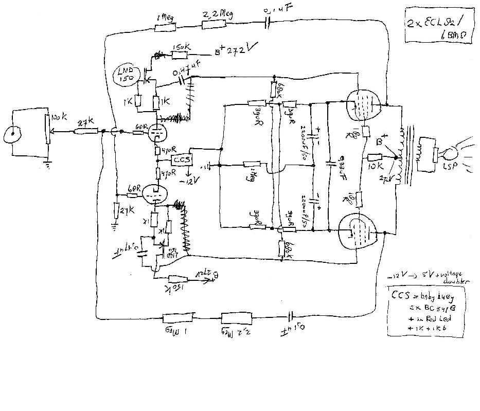

I tried a version of the original BH, with ecl82 (not for a special reason, I will try ecl86 in the future).
For some unexplainable reason I always try to do things a bit different, perhaps because I am rather curious
I put a LND150 mosfet on top of the triodes and used the mu-output to drive the pentode. I bypassed the top CCS with a 2meg resistor: forgot to draw that on the sketch. I read on the forum that this prevents "fighting" between the two ccs's.
Under the pentode I used the garter bias scheme as used by Shoog for his ecl82 headphoneamp.
I used a different feedback construction but perhaps it can be combined with the original (gingertube did this).
I have only a mono-version as a try-out.
Perhaps if someone wants to try this or a variation of it (LND150 cascoded ?/ 10M45S ?), it would be very interesting to hear if it sounds different/better than the original setup. I suppose you can also put the original Kimmel Mu-stage with a pentode on top at the front of the amp.
