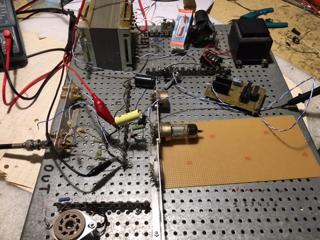

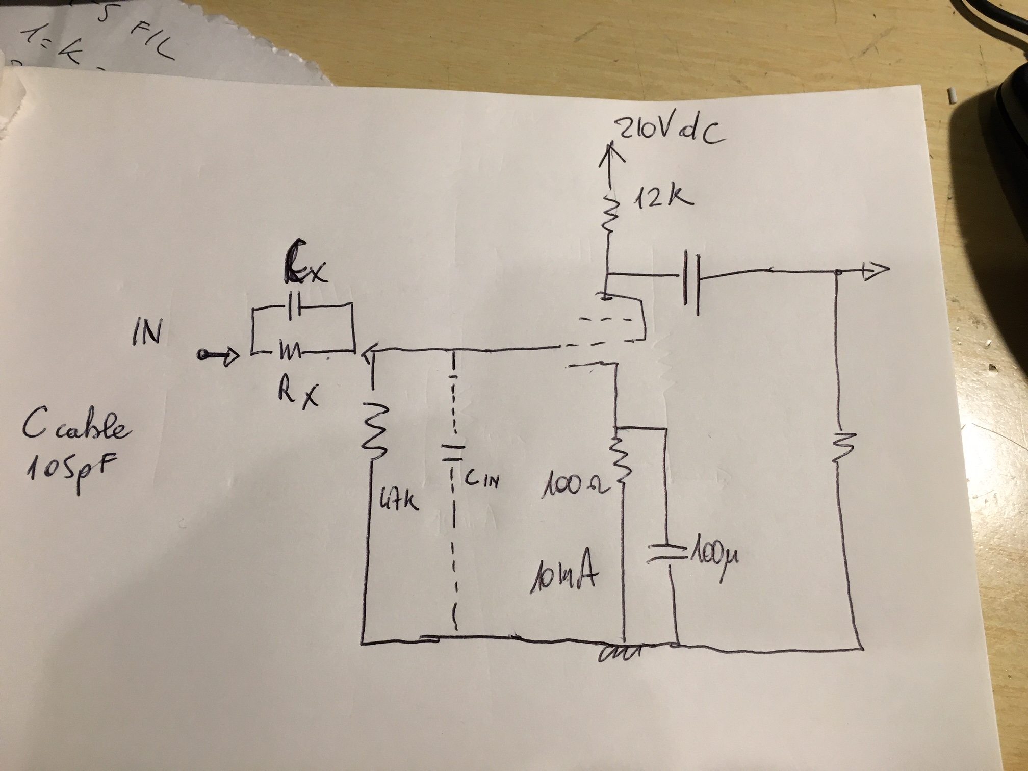

In attach the schematic about test on lab of EF184 in triode.
I made a quick circuit as photo.
The 184 is a new Telefunken
The method is to put a R kohm in series with input and a cap in parrallel with R.
This is normally done in the Audioreview lab with a little box with two rotary switches, one for resistors and one for caps
In this way we can check the real Rin and Cin of each electronics under test.
In my case I put the 47kohm ( standard value) as Rx and no Cx .
I sent a 100mV in input to the circuit.
I measured the V at the out at 100 Hz and 1000 Hz with just a minor changes . The Zout of AP SYS Two is 20 ohm .
Then I move to 20 kHz and insert some Cx unitil the read the same value at 100 hz; the value found is the Cin real of 184 in triode mode.
It is around 210 pF +/- 10 pF
I consider +/-10 pf as some parasitic and tolerances.
Walter

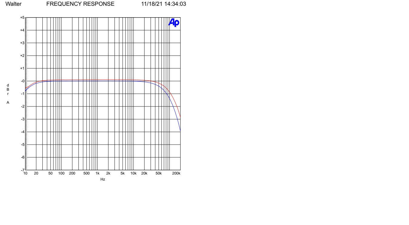

In attach the schematic about test on lab of EF184 in triode...
...the value found is the Cin real of 184 in triode mode.
Walter

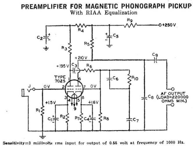

I don't think active RIAA is sensitive as you say ... first of all small tubes like 12AX7 are still good from 60's amps , second , negative feedback by definition makes a circuit much less likely to be affected by small changes or mismatches . A passive RIAA is much more affected by this issues .
Actually, it's more vacuum tubes vs. solid state.
If using tubes, the open loop gain isn't much, so it's not easy to get great performance from an RIAA EQ implemented within the NFB loop.

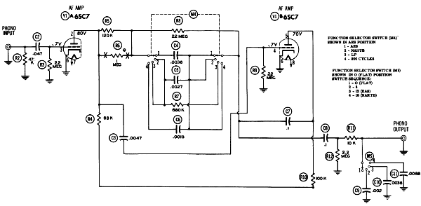

Depends on how many tubes you put in the loop and whether you split the gain over two amplifiers in cascade or try to do it all at once. The attachment has a RIAA conformity of +0.1 dB/-0.2 dB at 1 Mohm load, +0 dB/-0.3 dB at 10 kohm load, 20 Hz to 20 kHz, measured values of the worst of two channels. Because the first stage works in open loop (R5A and R5B are only meant to get a low-noise 47 kohm input resistance), it has maximal Miller effect, resulting in an input capacitance of about 90 pF.
2 stages with 12AX7 have an open loop gain of about 4000 or more and can be made to match perfectly RIAA curve .
If we consider 3mV input and 150mV rms out , the gain needs to be just 50 at 1KHz . Plenty of headroom .
Closed-loop gain of about 500 at 20 Hz, so a loop gain of -8. If you don't correct the RIAA network values for finite loop gain, that will give you a response error of about -1 dB at 20 Hz.

Remember 210pF includes miller. So with 10pF+200pF/28 = 10pF + 7pF.
My setup indicates a bit lower Cin, not so sure his method is more accurate, not enough difference between 100Hz and 1kHz...
The test circuit is simply and efficent
Of course some tolerancs are considered.
Also if you change the brand of the tubes you can have a little differences, just few pF.
The total Cin is the effective value considering a little wire connection, the sockets , etc..
The value found must be added to the cable capaciity so we can reach around 300 pF, less or more.

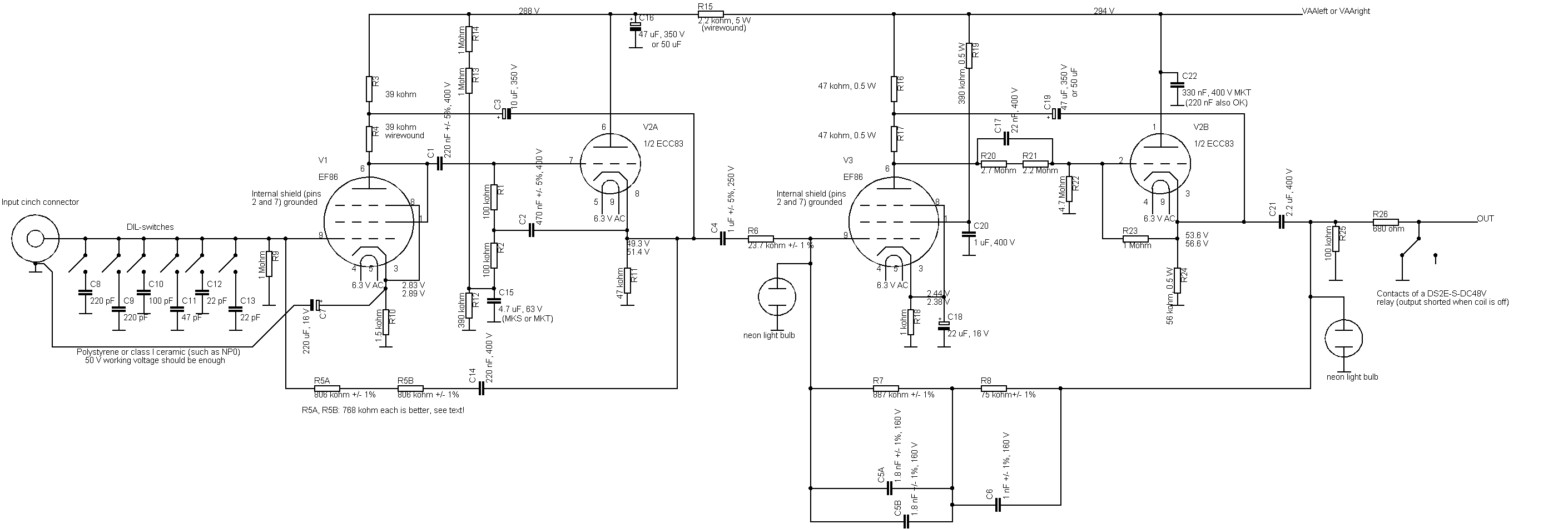

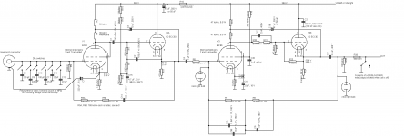

MarcelvdG, that circuit has some nice tricks! I like the bootstrapped pair configuration with EF86 and ECC83 cathode follower. Why an ECC83 as the cathode follower, though? Anode current of 1mA is enough to drive the feedback loop without loading down? V2A is driving V3 with a 23.7k ohm series resistor, which defines the input impedance of V3 once the NFB loop is closed. Isn't that a heavy load for an ECC83 cathode follower? Or is there something else compensating for that?

An excellent point. Input stage dynamic capacitance has only become an issue since the current fashion of lossy RIAA between two stages became popular. Old fashioned long loop feedback around two (or two plus a follower) stages to the cathode of the first stage doesn't suffer from this problem....

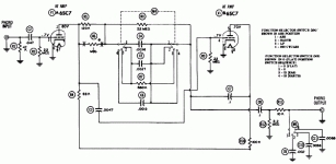

If you go back enough, NFB was not used, it was all passive between stages. See earliest RCA New Orthophonic suggested implementation. (There's an older plan with 6SC7 common-cathode tube, but the basics were the same.)
An intermediate step was NFB from 2nd plate to 1st plate (leaving 1st G-P wide open), such as Fisher 50-PR. (In fact this form does not do the HF EQ until after the 2nd stage, so no effect on the cartridge.)
That shunt feedback in the second stage reduces the impedance that loads the first stage, so that should reduce Miller effect. An AC grounded first stage cathode also helps to minimize hum due to heater emission or heater to cathode capacitance or leakage resistance ( assuming an AC heater supply).
