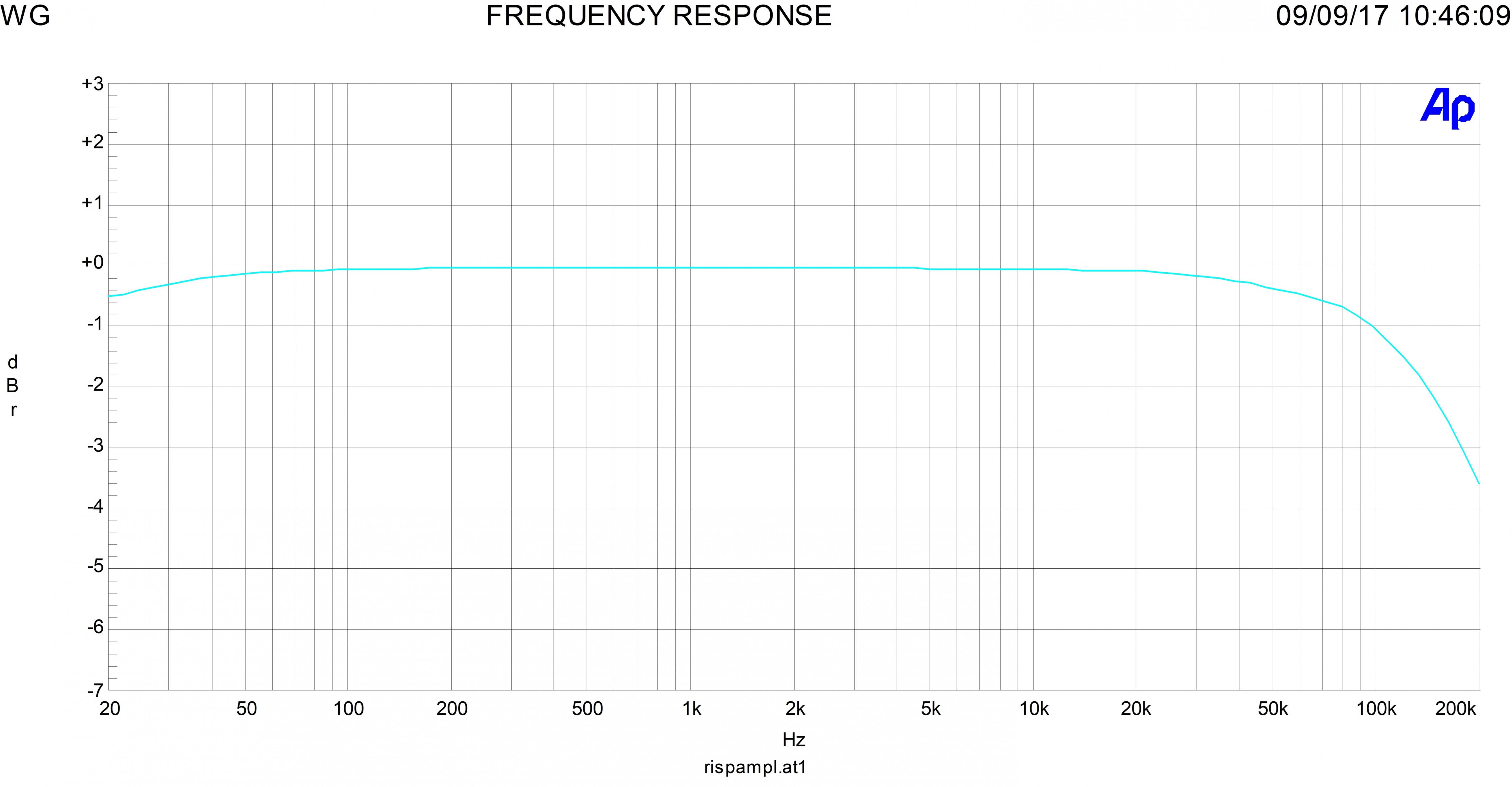

Just fo info
I used the E88C Siemens gold pin, nib/nos in Srpp to drive a s.e. with KT150
This is the freq answer of the input circuit; good resuslts.
The gain is around 42 dB with 0,2 % of THD
Walter
