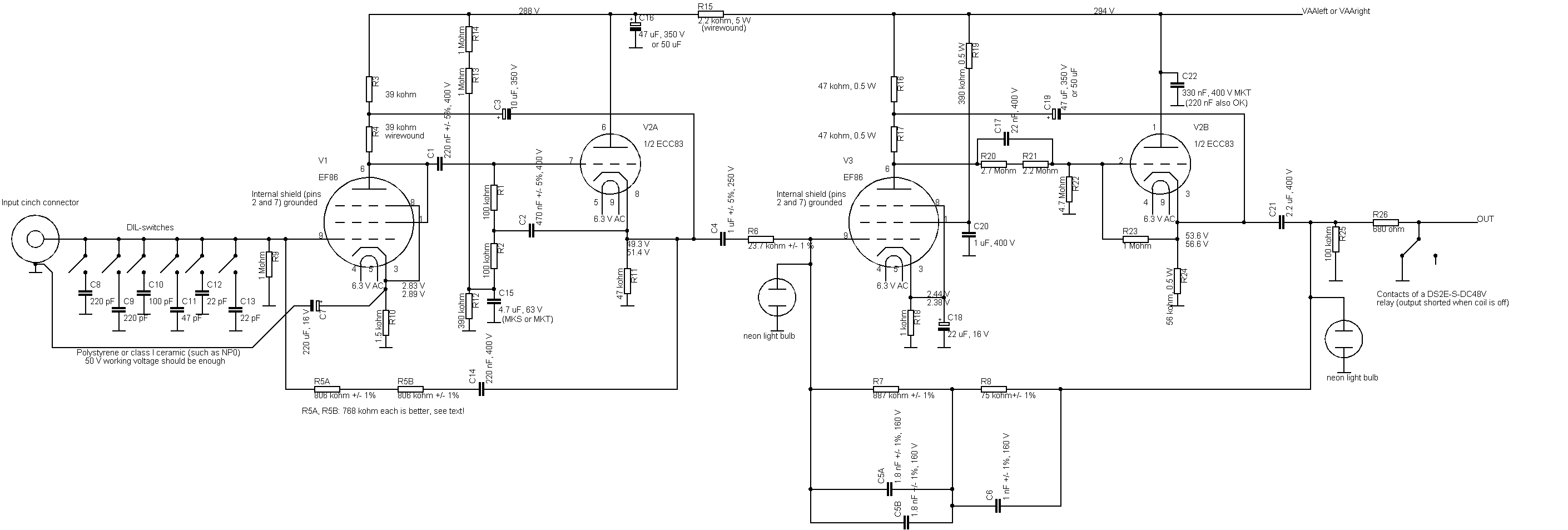

MarcelvdG, that circuit has some nice tricks! I like the bootstrapped pair configuration with EF86 and ECC83 cathode follower. Why an ECC83 as the cathode follower, though? Anode current of 1mA is enough to drive the feedback loop without loading down? V2A is driving V3 with a 23.7k ohm series resistor, which defines the input impedance of V3 once the NFB loop is closed. Isn't that a heavy load for an ECC83 cathode follower? Or is there something else compensating for that?
It's ten years ago, but I think I looked in a shoebox full of second-hand tubes that I had bought and picked the ones that had a high enough cathode-to-heater voltage rating and the highest gm*(ri Zload/(ri + Zload)). I think the ECC81's in the same box had a too low heater-to-cathode voltage rating and E88CC's a too low mu (=gm ri).
A triode with high mu, high gm and high cathode to heater voltage rating would have been better.
MarcelvdG: Yes, but only by squashing down its gain. Could be achieved better by degeneration. That old Fisher design is just too primitive now. For example, the 75uS pole could be better implemented as part of the anode follower second stage, like the one you posted. Better in every way.

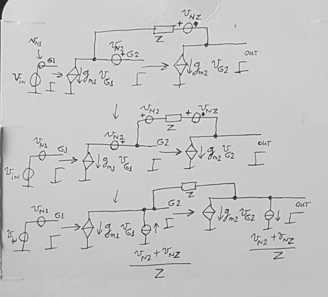

If the second tube had an infinite transconductance, the shunt feedback network would have exactly the same effect on the equivalent input noise as when it had been connected from the anode of the first tube to ground. The same approximately holds with a finite transconductance when it is much greater than 1/feedback impedance.
In the attachment, both tubes are modeled as voltage controlled current sources with a noise voltage source at their input. Shifting the second tube's noise through the feedback node results in two equal noise voltage sources, one in series with the first controlled source (which has no effect) and one in series with the feedback impedance Z. That one can be converted into a noise current source, together with the feedback impedance's noise (Thevenin-Norton transformation). This current source can be split into two sources to ground.
With just an impedance to ground, you get the same result except for the noise current source shunted across the output.

Yes, and in most any practical circuit the second stage's noise contribution can be ignored.

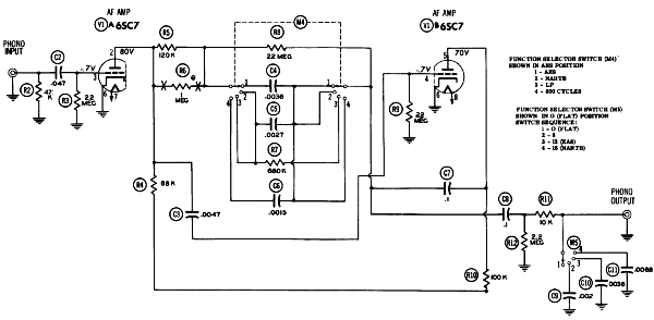

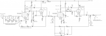

I agree that putting a big resistor in series with the signal source is not the way to achieve low noise, but neither my circuit (first attachment) nor the Fisher circuit that PRR posted (second attachment) does that. In both cases, the cartridge is connected straight to a common-cathode stage (triode-connected EF86 in my case, 6SC7 or something like that in the Fisher circuit). Like I wrote, with AC heater supply, an advantage of AC grounding the cathode is the reduced sensitivity to hum currents that get from the heater into the cathode, for example via heater emission, capacitive coupling or leakage resistance.
In my case, the first common-cathode stage and first cathode follower together form an inverting amplifier with a gain of about -30. The shunt feedback is only used to realize a 47 kohm input resistance with less than thermal noise. The frequency-dependent voltage division between the cartridge and the input impedance is no different than if I had used a 47 kohm resistor to ground instead of the trick with the shunt feedback. Because of the large voltage gain, there is a lot of Miller effect, giving an input capacitance of about 90 pF. The second part is an inverting RIAA-equalized negative-feedback amplifier. The 23.7 kohm resistor generates some noise, but because it is after an amplifier that amplifies by -30, it hardly has any impact on the overall noise.

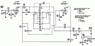

In the Fisher circuit, the common-cathode stage directly drives the virtual ground input of an equalized transimpedance amplifier (current to voltage converter, anode follower, whatever you want to call it). That reduces the signal swing at the first anode and hence the Miller effect without much of a noise penalty, see post #84. I think it is conceptually a really nice circuit, even though there may be details that are not so nice.
I don't like the way Fisher biased the first triode much. The bias current is not very predictable and the AC coupling capacitor makes the circuit extra sensitive to hum currents that couple into the grid.
I don't know why they realized one of the poles with an extra low-pass at the output rather than in the feedback of the second stage; maybe related to the switching of time constants depending on the desired correction curve? When you only want to have RIAA correction, I don't see any reason not to put it all in the second stage's feedback network.

The input capacitance of my circuit is about as bad as it gets when using a triode-connected EF86, about 90 pF.
The equivalent input noise current is lower than that of any amplifier with a 47 kohm resistor across the input. I measured 14.38 pA RIAA- and A-weighted, which corresponds to a noise current density of 0.2534 pA/√Hz. A 47 kohm resistor at room temperature produces 0.5869 pA/√Hz.
The equivalent input noise voltage was 582.3 nV RIAA- and A-weighted, corresponding to 10.26 nV/√Hz. Not very good, but as good as it gets with a triode-connected EF86. I chose an EF86 because of its small capacitance from heater to grid, to get low hum with a plain old AC heater supply.
As it's a hobby circuit, I measured all that at home and not in a fancy test lab. I mainly used an HM-1505 oscilloscope and an antique BKF6d distortion meter / true RMS (milli-)volt meter.
Whether the low equivalent input noise current is useful depends on whether you care about the noise level between records. As soon as you play a record, record surface noise dominates anyway.
I have no idea what was measured for the Fisher circuit, maybe PRR does.
