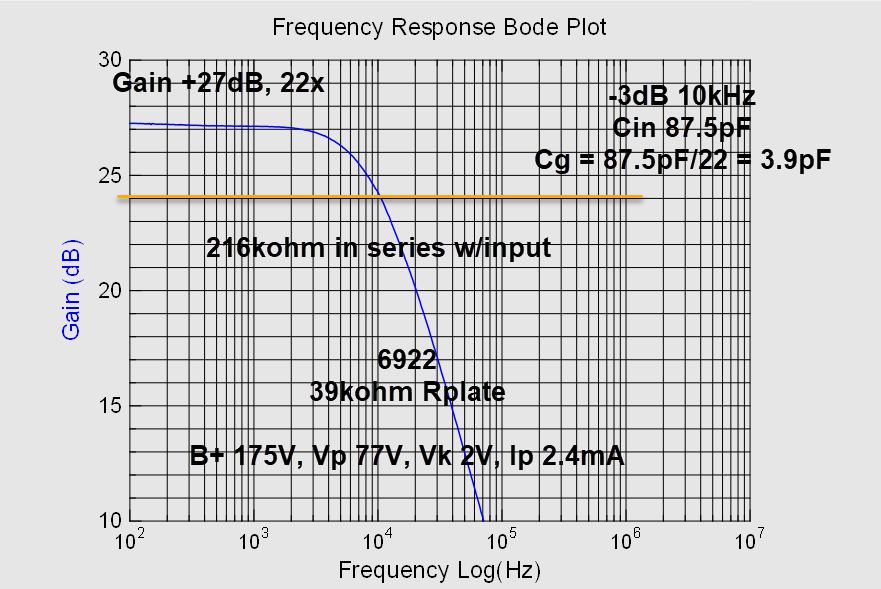

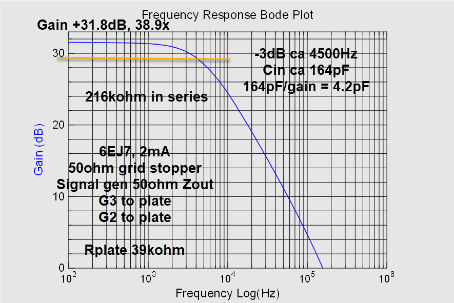

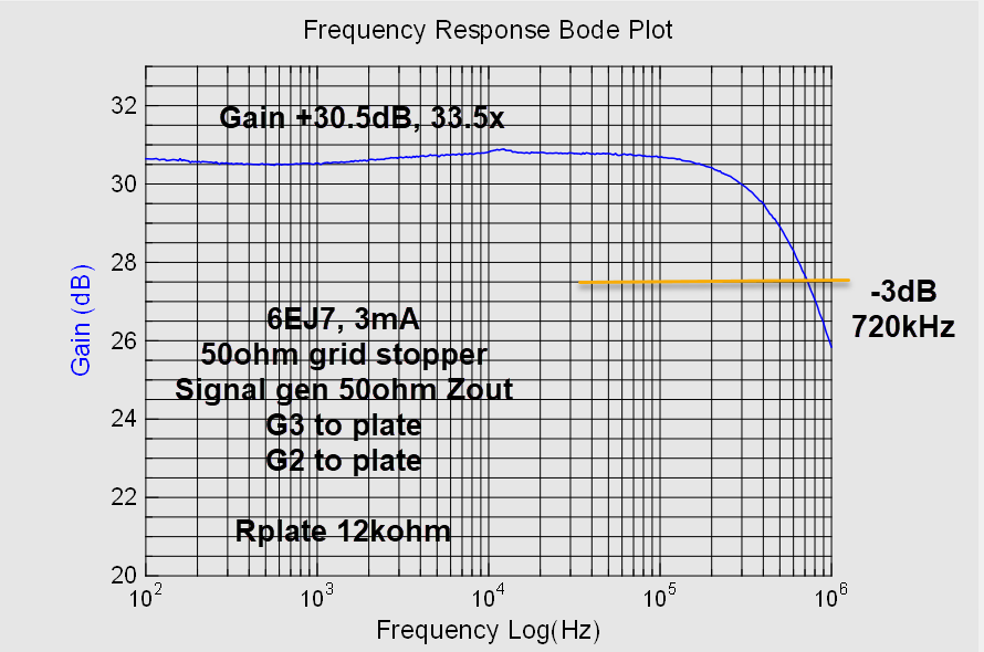

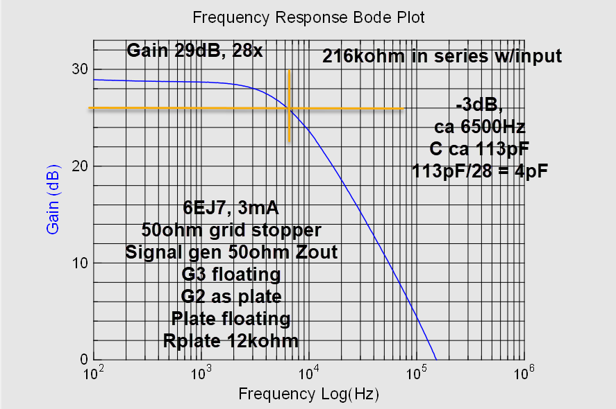

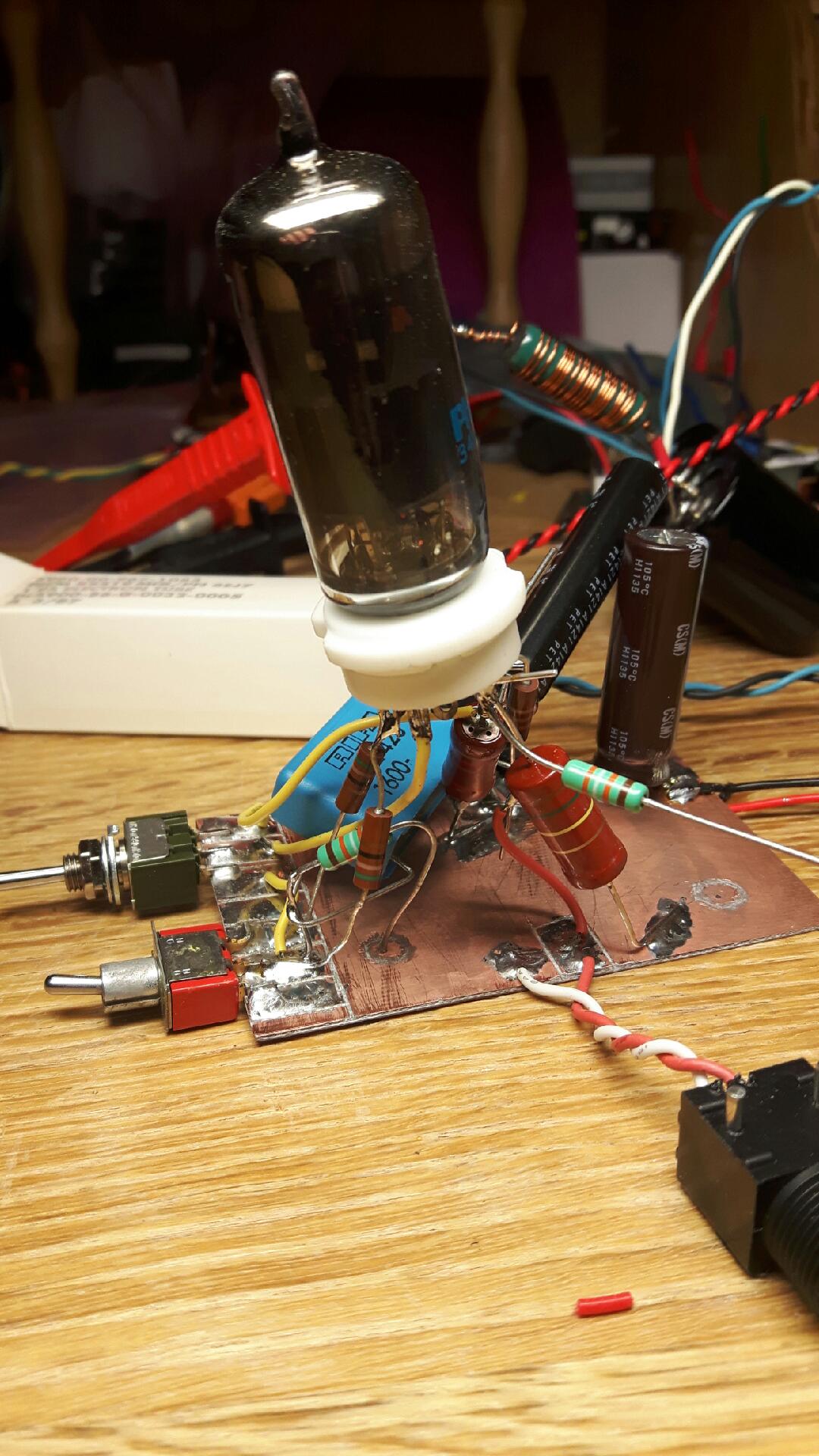

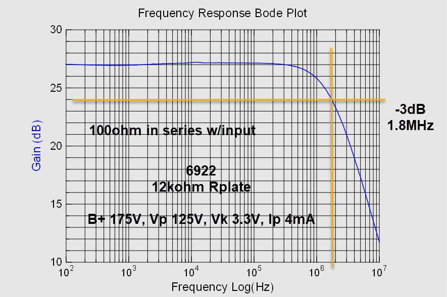

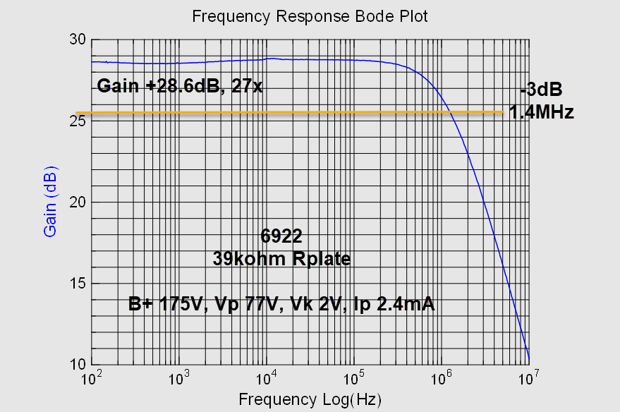

I made a quick circuit and did some measurements. I tried both 39kohm and 12kohm as plate resistors. I tried both normal trioded with G2 to plate, and using just G2 as the plate. I saw no real difference. I also tried G3 to cathode and plate and saw practically no difference.
Rp 12kohm with only 100ohm in series with the input, the gain and -3dB are:
Gain 33.5x and -3dB ca 720kHz.
Added 216kohms in series w input:
Gain dropped to 28x (gatebleed 1.15megohm) and -3dB 6500Hz. 216kohms and 6500Hz indicates capacitance of 113pF, and dividing by gain the input capacitance looks like 4pF.

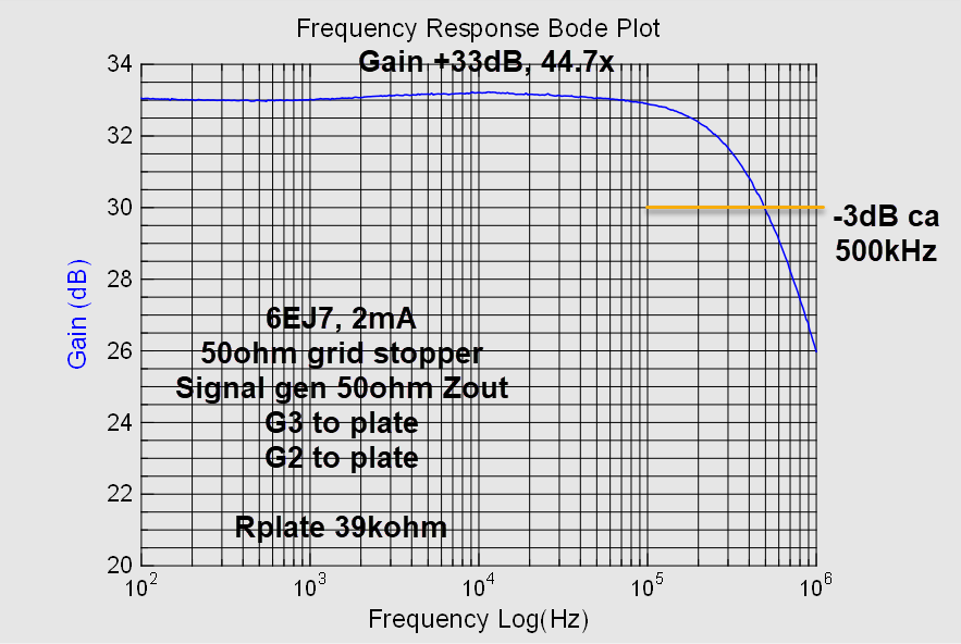

Rp 39kohm with only 100ohm in series with the input, the gain and -3dB are:
Gain 44.7x and -3dB ca 500kHz.
Gain dropped to 39x (gatebleed 1.15megohm) and -3dB 4500Hz. 216kohms and 4500Hz indicates capacitance of 164pF, and dividing by gain the input capacitance again looks like 4pF.
So I am not sure how accurate this type of testing for input C is, the output C is also playing tricks. But I think I am using high enough series resistance so the input is dominating the -3dB point.
EDIT: I think I need to use the series resistor in parallel with the grid leak for the calculations... 216kohm in parallel with 1.15megohm...182kohm.
That means Cin is 5pF.

First off, thank you for doing this!
By Cin, do you mean Cga? If so...
Cga of 4pF or 5pF for a high mu/frame grid RF triode looks plausible.
Check out the data sheets for 6J4 or 8532. That's a high mu/frame grid RF triode. Its Cga is listed as 4pF, Cgk,h listed as 5.5pF.
6J4 mu is listed at 55, so I figure an in-circuit gain of 40X is reasonable.
6.2pF + 4.7pF(41) = 198.9pF for the total input C after accounting for Cmiller.
A total input capacitance of about 150pF could be accurate for EF184-triode.

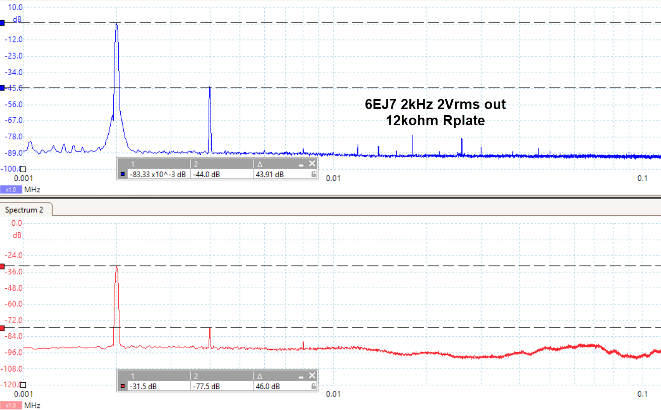

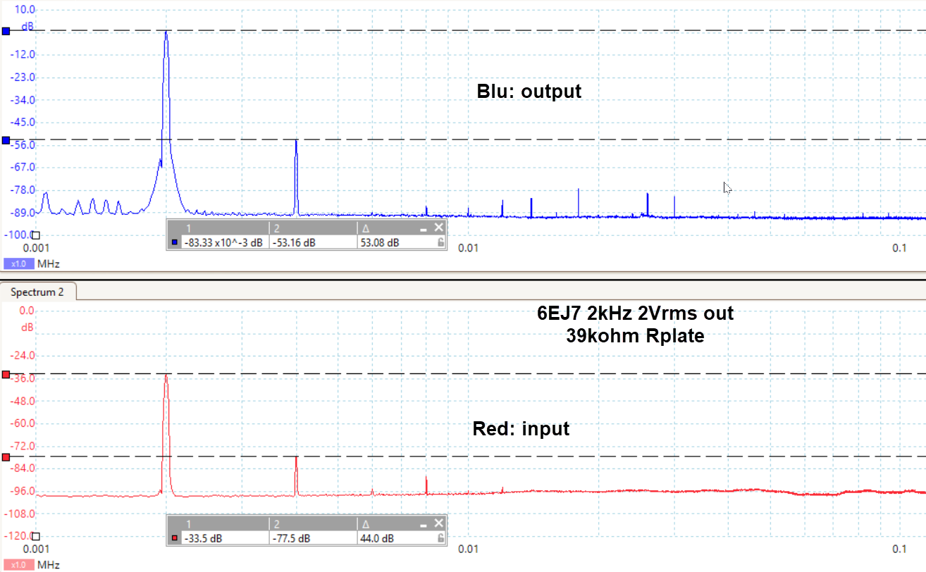

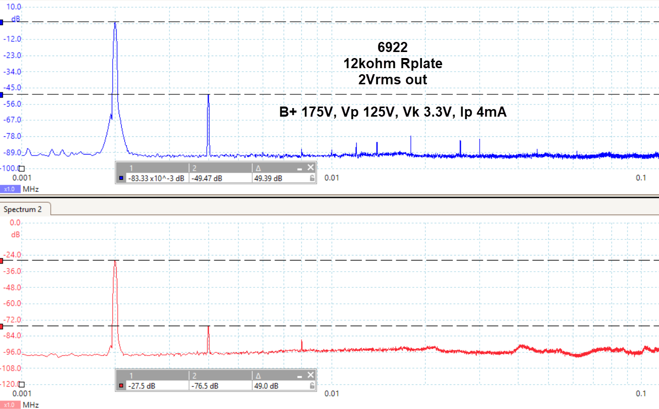

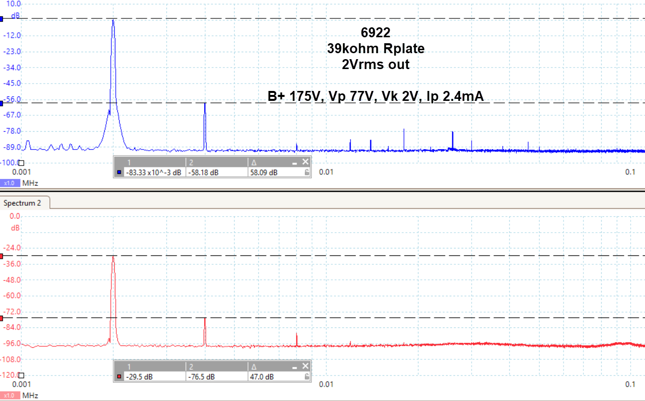

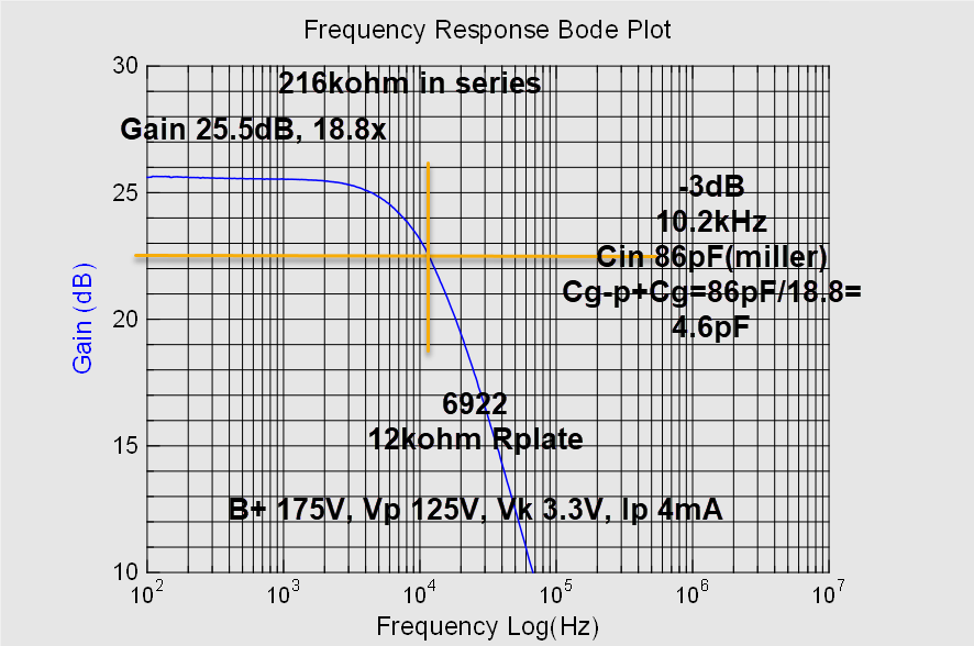

I did some distortion measurements as well, and I had to test a 6922 I had laying on my desk... Mostly for comparisons, but also testing my setup.
Looks like 4-5pF for 6922.
I guess my setup introduces slightly more capacitance than indicated on datasheets. But as has been mentioned, datasheets show the tube out of circuit, in other words unlikely conditions. My circuit is point to point with lots of space between resistors and the gnd plane. I do not think my circuit is very capacitive.
4-5pF is actually not so bad, at least compared to SS, I think it is something to live with, or use cascodes or other means to lower the effective input C.
The FFT shows some 2H on the input test signal, I do not what is causing that. Perhaps the attenuator I am using to adjust the input for 2Vrms output.
