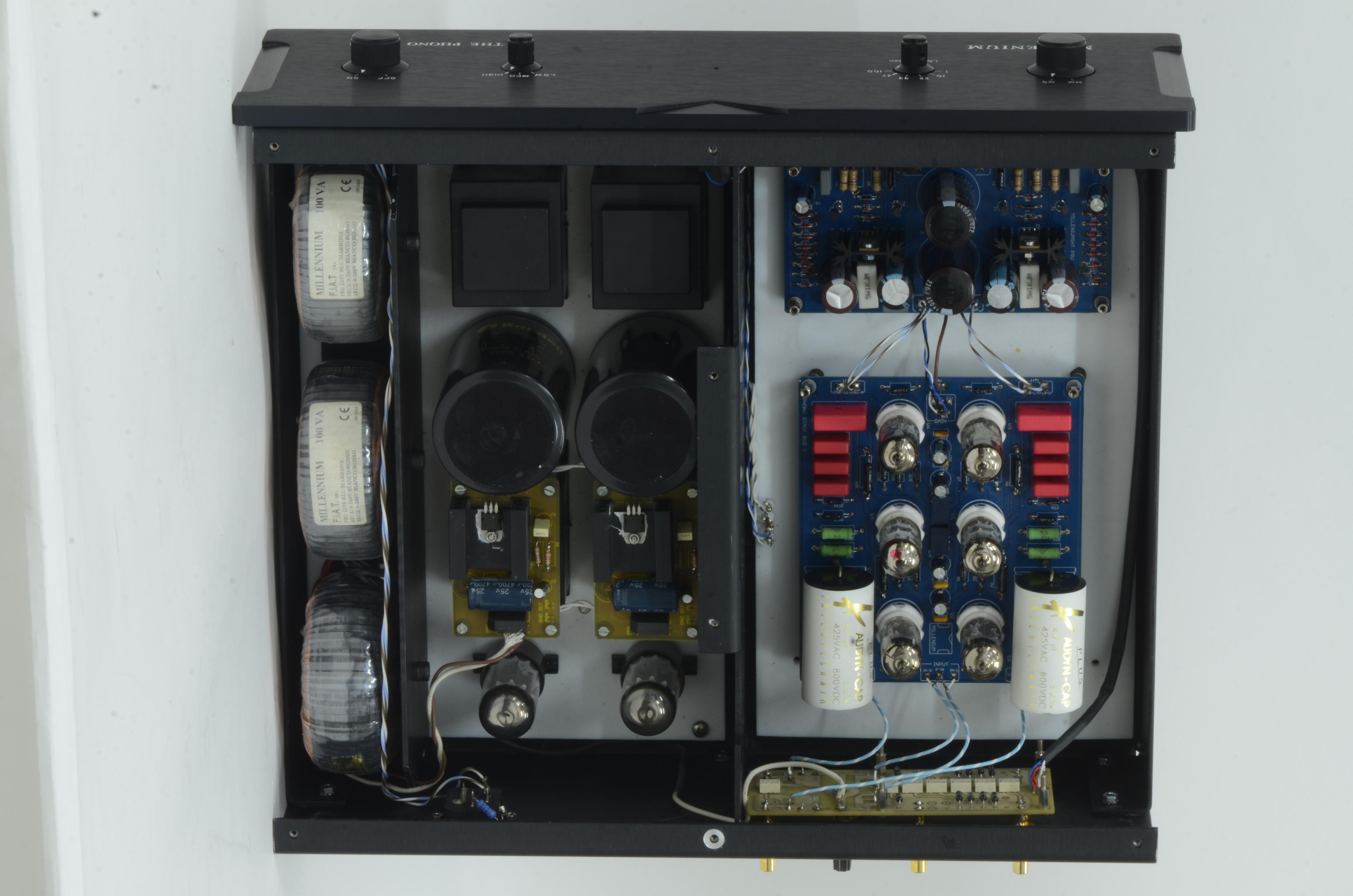

For me, the challenge was to design a circuit without semiconductors and I didn't fancy using mercury vapor rectifiers or accumulators, so I more or less automatically ended up with AC heater supply. It worked just fine, although it did limit the choices for what tubes and topologies to use.

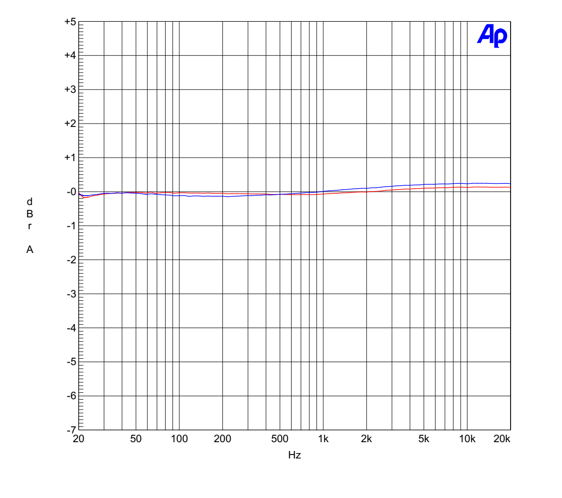

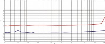

RIAA conformity, as mentioned in post #69:
+0.1 dB/-0.2 dB at 1 Mohm load, +0 dB/-0.3 dB at 10 kohm load, 20 Hz to 20 kHz, measured values of the worst of two channels

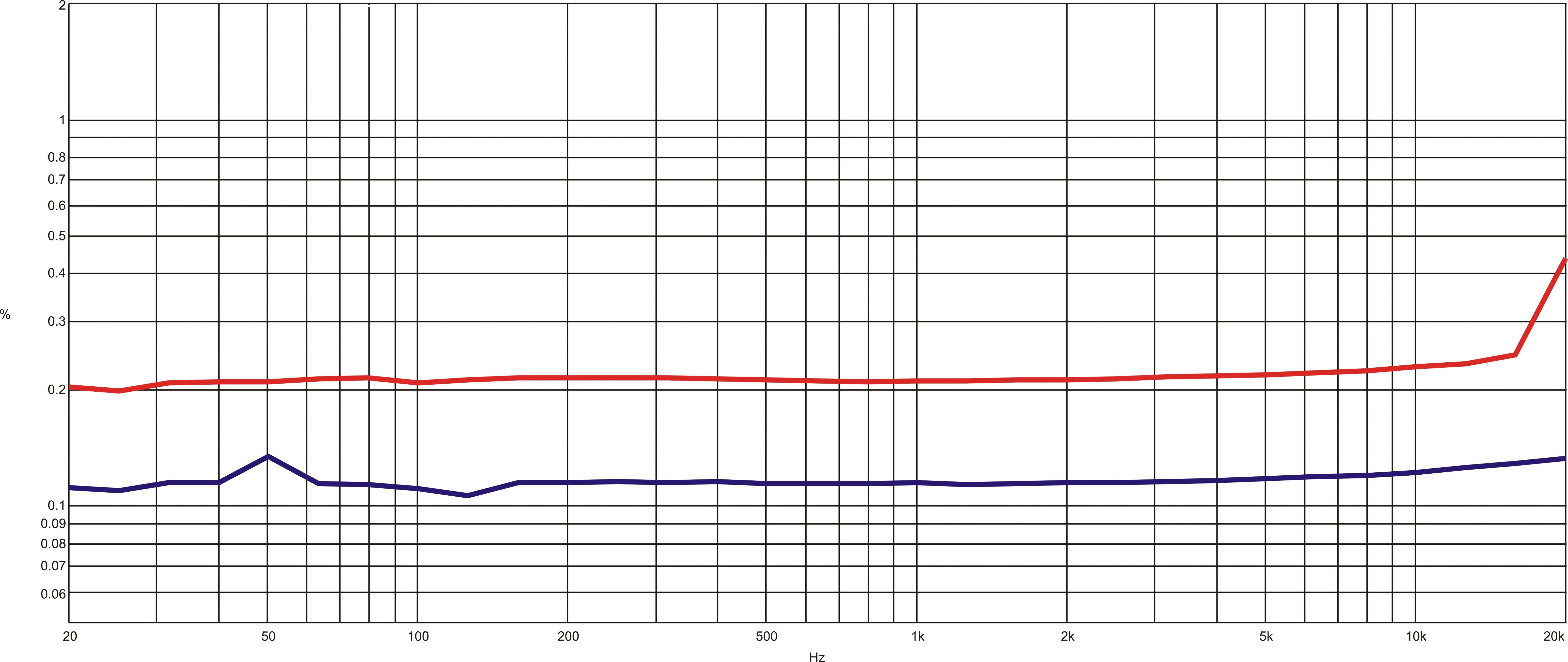

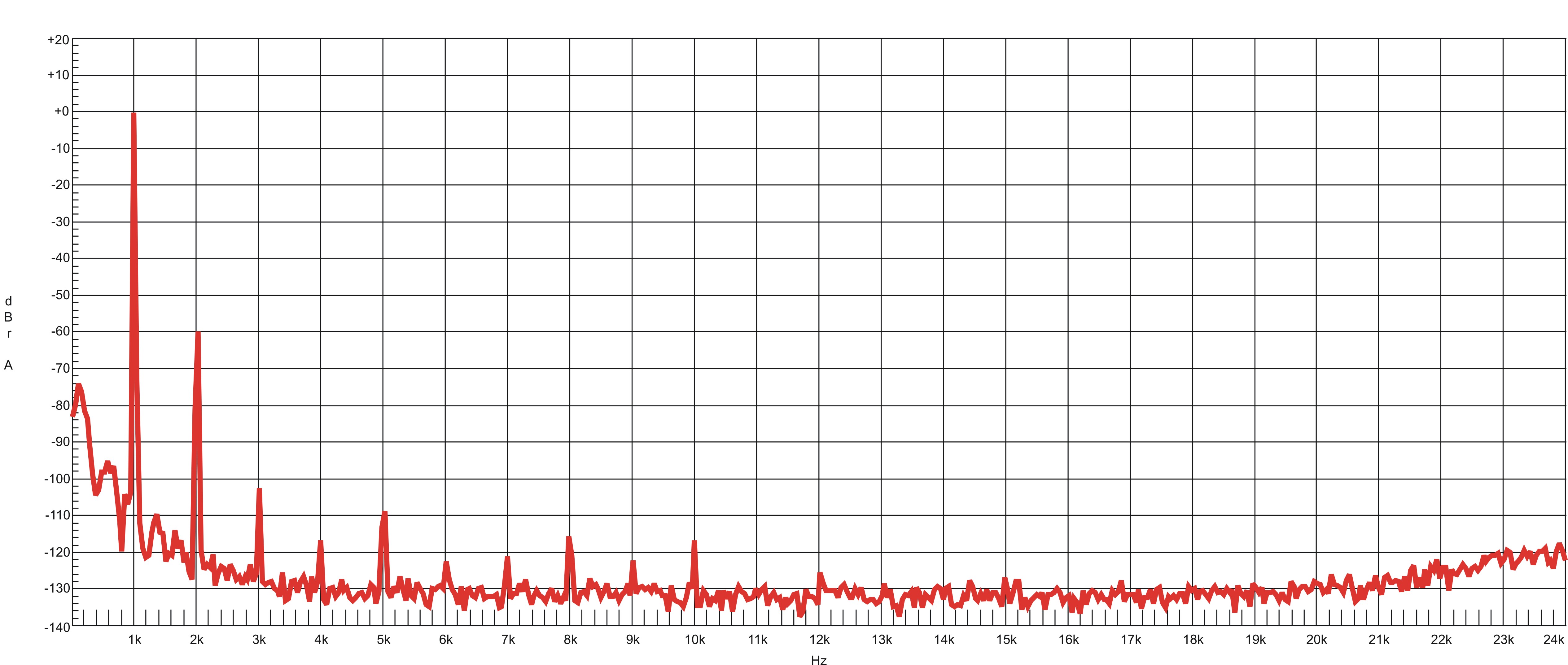

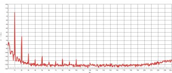

Distortion at 1 V RMS output level:
100 Hz, 47.6 kohm load: << 0.16 %
400 Hz, 47.6 kohm load: 0.045 %
400 Hz, 8.26 kohm load: 0.062 %
1 kHz, 8.26 kohm load: 0.05 %
10 kHz, 8.26 kohm load: 0.12 %
The gain at 1 kHz is about 42 dB.

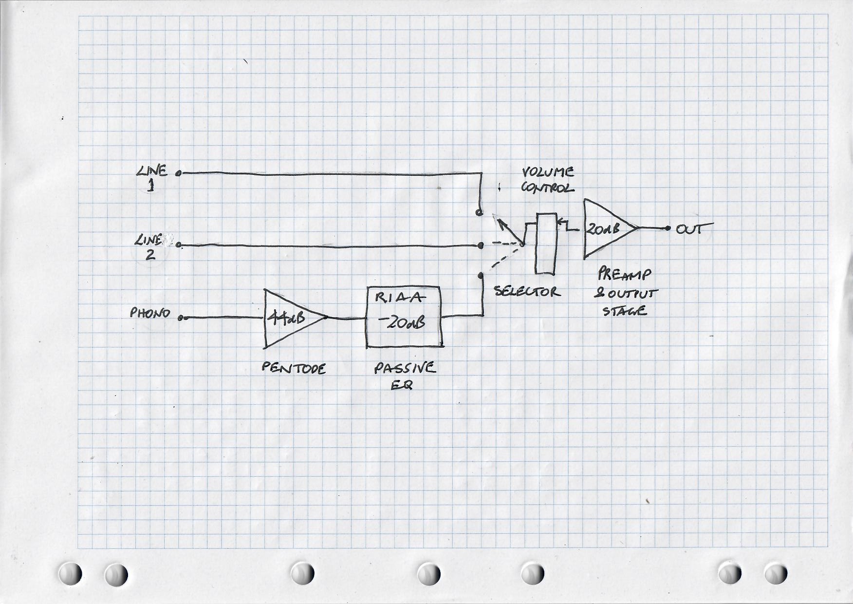

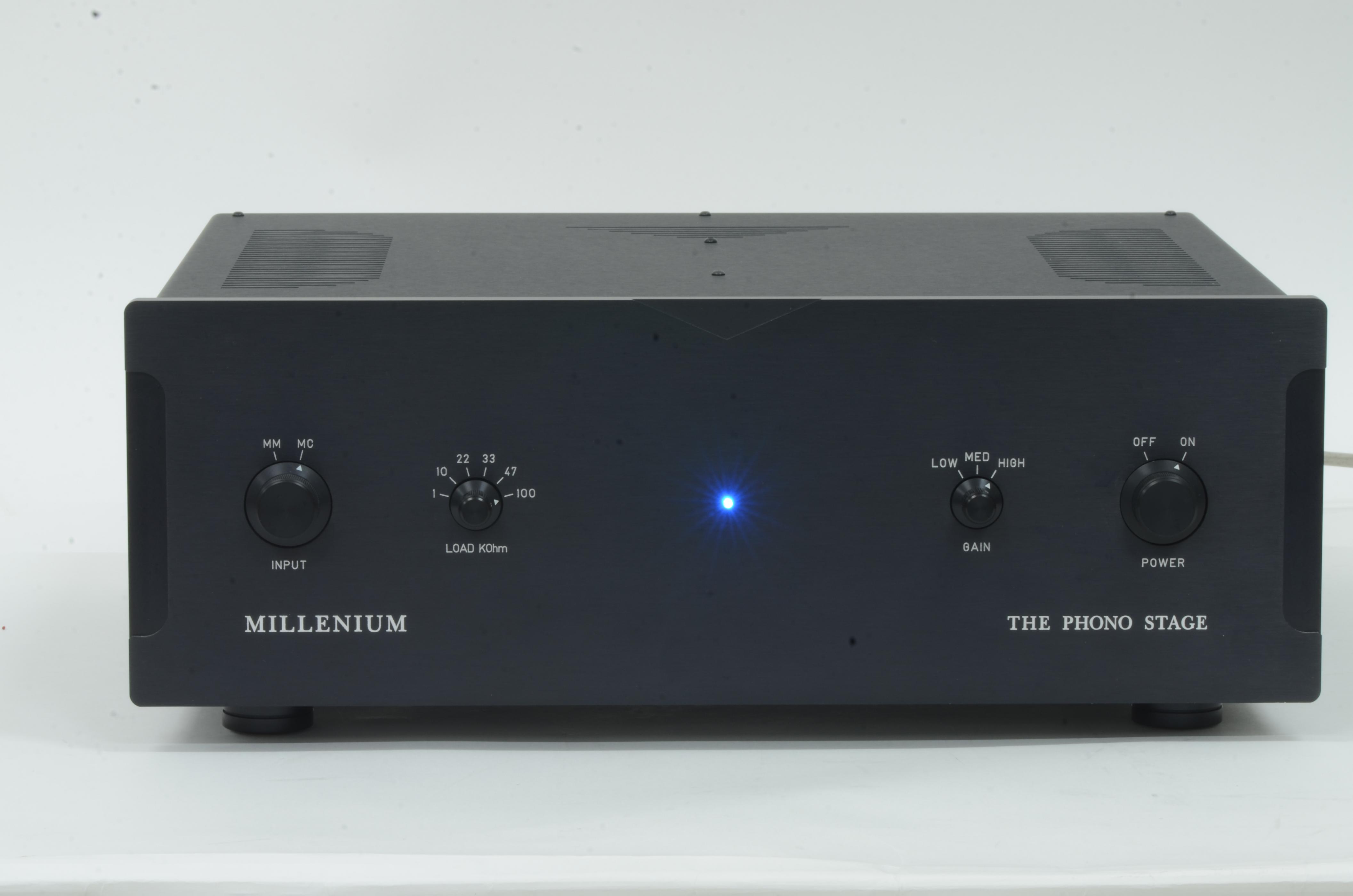

I stumbled onto this old thread and just wanted to wrap things up. A friend and I eventually co-designed/built a phono preamp with a 'hybrid cascode' first stage using an LSK170 in the bottom and any old medium-mu triode on top (could have been 12AU7 but I used 6N6P because I have a bunch of them and heater power wasn't a big deal). The RIAA filter network is the usual passive type. The output stage is a 6DJ8 mu-follower with DN2540 as the plate load. It plays nicely with my Audio Technica MM cartridges, which I think supports the idea that these carts do require low input C. I'm happy with the setup.
