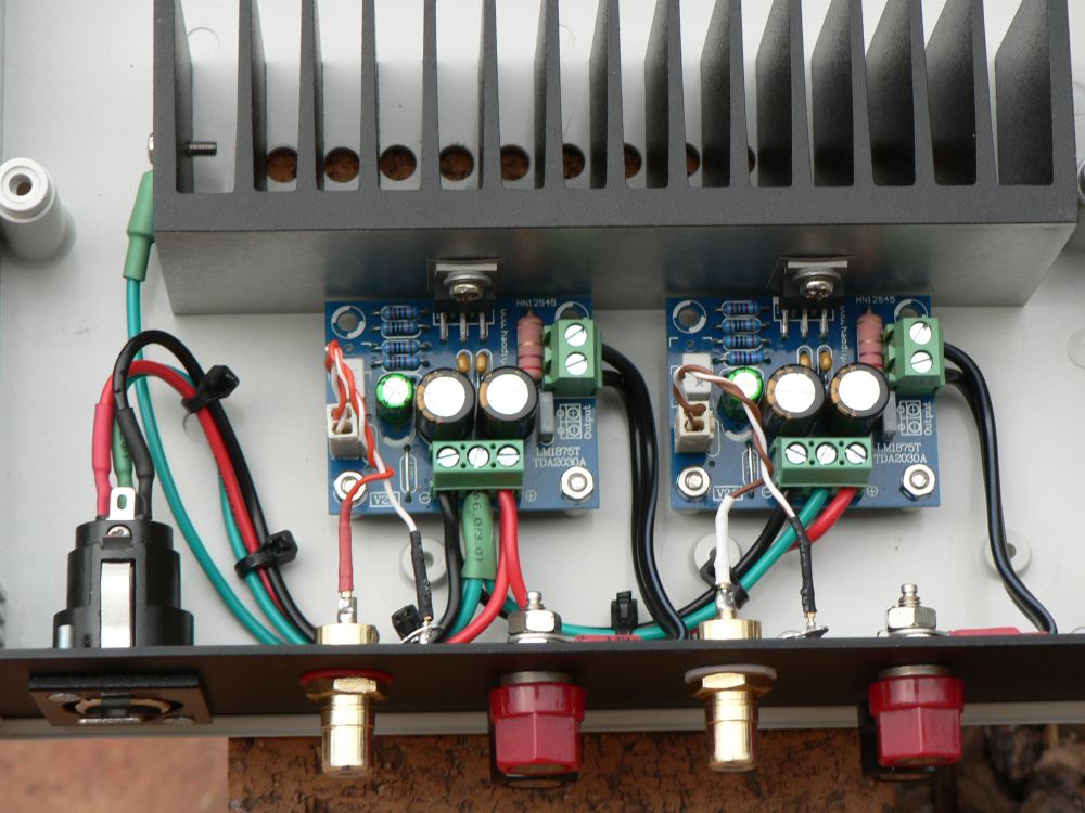

Another beginner post Im affraid.
Could you guys confirm if my grounding is ok?
- All the connectors are insulated from chassis.
- I have the safety earth from the IEC tied to a ground lug that grounds the chassis by a short lenght of wire.
- I have the 0 volt at the output of my power-supply board tied to the same lug by a lenght of wire.
- All my standoffs are made of aluminum thus in contact with the chassis (if that matters).
I was testing from my computer using a USB interface until now, but last night I plugged my computer on a HDMI to VGA converter and it started humming pretty bad in the speakers. I dont have that kind of issues with this converter plugged in and my Technics amp.

Do not connect the audio ground to the chassis ground. This will always lead to hum with other grounded connections, like a PC supply.
It may be necessary to use some kind of modified audio to ground connection, like a 15 ohm resistor in parallel to a .47 uF 400V film foil capacitor.

Could be the Technics doesn't have an earth which is common on a lot of commercial amps. All my Yamaha amps have no earth on the IEC socket.

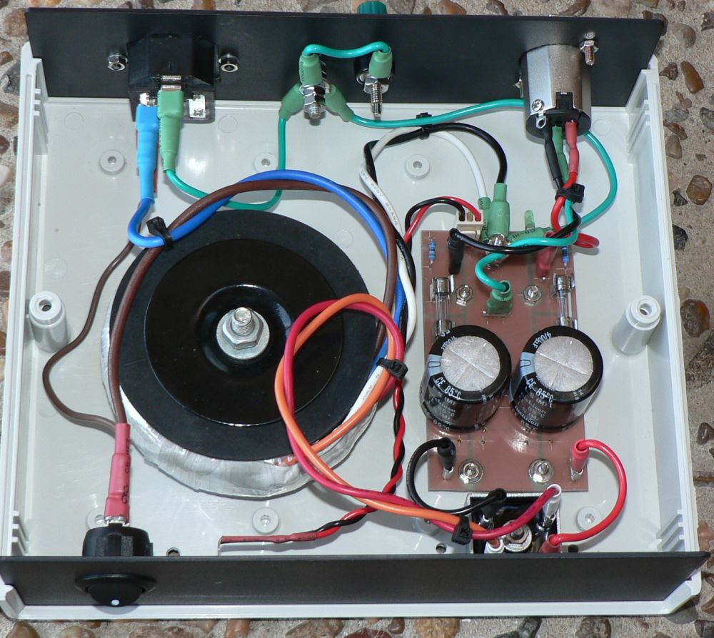

I've added some pics of my power supply and power amp and the grounding can be followed with the green wires.
Earth > chassis
Power supply transformer CT > power supply ground (after caps)
Power supply ground > chassis (earth connection)
Power supply ground > power amp ground (DC in)
Heatsink to power amp ground
Signal and speaker ground all isolated from the chassis
Some builders have the power supply floating with no ground from the power supply going back to earth but I've never used that. Hum can sometimes be cured by using a 10R resistor with parallel reverse diodes in the line from power supply ground to chassis ground (earth). See post #78 in this thread.
Odds are the the video side of things can be causing the issue and it's very common to get hum when running audio from a TV. I suppose it's similar with your HDMI from the computer. Some USBs have a ground lift and on several DACs I've seen has a switch for this.
Usually I find a solution with a cable with alligator clips but it's trial and error but when found it's usually the bleeding obvious.... doh!
Hope you sort it out.

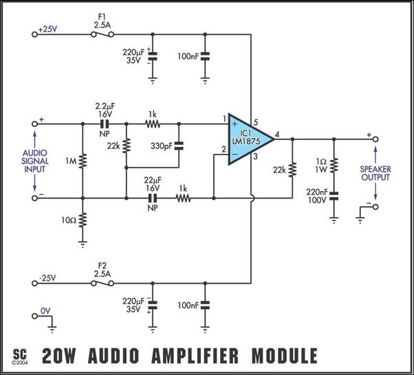

Hmm... i re thinking this GND - earth
Turbo wrote that the audio GND should not be the Earth-GND. but if you look at my way i found then we have it at this board. may i am wrong??
path:
at this board the signal (left side at rabbitz pic) and GND is normally connect via 10R to pcb GND. see picture of the schematic.
we decided to omit this and insert a jumper and we were all happy with this. as rabbitz did this and visible at this picture.
if you check with your DMM between supply GND (+V-GND -V)and the terminal of the input signal GND with your Beep - he will here its connected.
rabbitz pic:
if you follow the GND of the supply terminal - green cable you can see at the left board 3 cables. 1 goes to the right board - ok
second goes to the heat sink - ok
third goes to the XLR connection = the power supply is in a other housing
but there is the earth connected to earth. so singal GND is at earth
metall housing should be earth by safety reasons.
so if you use a metal housing and the Center tab of the transformer should be Supply GND and this GND should be earth connected ---> then we have earth at GND and therefore at signal GND.
may i am wrong???

Thanks Rabbitz for the info, my current grounding scheme is very much like yours. I will try the 10R + diodes trick.
You are correct, none of the amplifiers I own have an earth ground lug, vintage Technics, my modern NAD, but also tuners, cd players, DAC, interfaces, even my laptop.
I tried removing the link between 0v at PS output and chassis, it makes the hum worse. That allowed me to play a bit with the ground and try it elsewhere but I then noticed I had a far worse hum in one speaker than the other.
1 step forward 2 steps back right? Well the changes I had to go into to wire the speaker protection board indeed messed up the layout and made it that the audio outs of the left channel now have to cross some 120v wires....
If it wasnt for the annoying pop off Id just rip that board out, seems like its causing me more trouble than it solves.
Another test for tonight : testing if the power supply board's mouting holes are linked to ground and/or 0v. Its a kit I got off ebay so you never know.

Seems Rabbitz already talked about the 10R :
That post was a long time ago but interesting nonetheless...
The 10R is a ground lift resistor which sits between signal ground and power ground and can help reduce hum but have not seen it used on any of the Chipamps I've build but have on plenty of SS amps.

Good evening
i am not sure ...so should we implement that what Turbo wrote?
instead of the R2 (actually we have a jumper here) a cap and a resistor:
so we can keep that 10R resistor and add a 400V 0,47µF
good night
chris

Ive tried the reversed diodes + 10r trick, it didn't seem to change anything vs the hum or hdmi adapter being plugged in. In fact the protection board shuts off when I plug in the adapter. I rkn I have something weird happening at my bench.
Now I'm pretty convinced the hum I experience is from poor layout, since it comes from the left board only and this one has output wires going near 120v. Interestingly, the hum is only there when I use my audio interface, it's not there when I use the headphone/line out from my laptop.
I have a chassis on order, I will do my best to make a better layout. I never planned for a protection board so it kinda messed with my plans, and I cannot tolerate the pop off, so protection board it is, or I switch to lm3886.
Interesting fact, my regulated supply has 80mv peak to peak ripple on both rails, but as soon as I plug in the protection board it jumps to 140mv... weird eh?
path:
rabbitz pic:
may i am wrong???
chris
pump it up...
