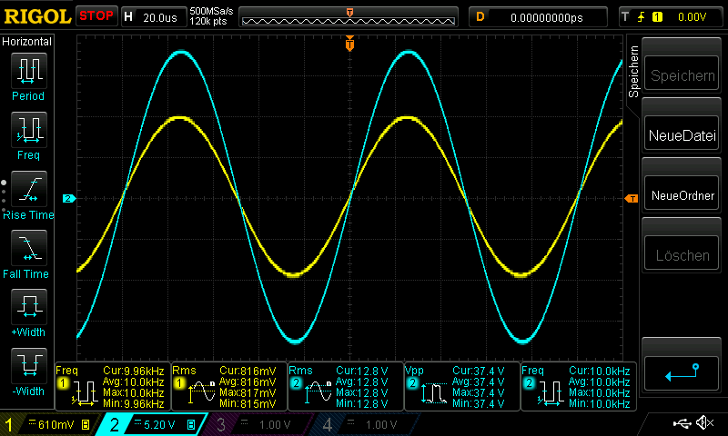

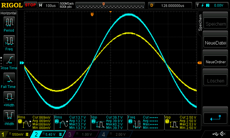

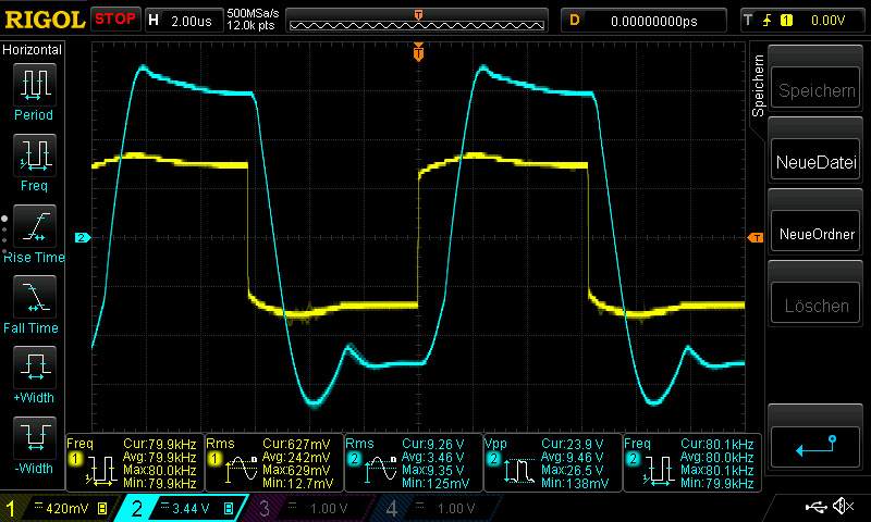

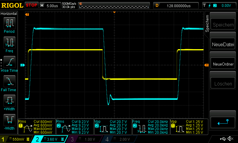

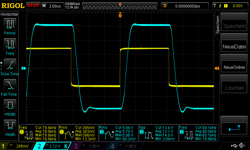

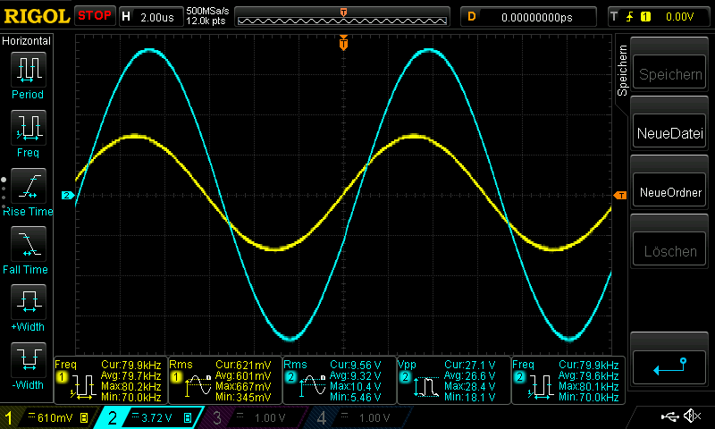

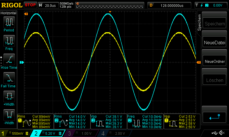

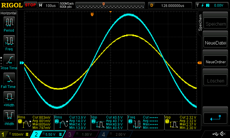

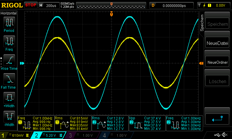

mono board with UTC2050 without feedback cap
Hi
here are the results:
power supply Rigol DP820 +/-22V: 8R2 load
pic 1 22Vsupply no load 1khz 900mVrms in
pic 2 22Vsupply 8R2load 1khz 840mVrms in about 22Watt
pic 3 22Vsupply 8R2load 10khz 840mVrms
pic 4 22Vsupply 8R2load 80khz 600mVrms about 10W
pic 5 22Vsupply 8R2load 20khz square 600mVrms
pic 6 22Vsupply 8R2load 50khz square 600mVrms
pic 7 22Vsupply 8R2load 80khz square 600mVrms
Hi

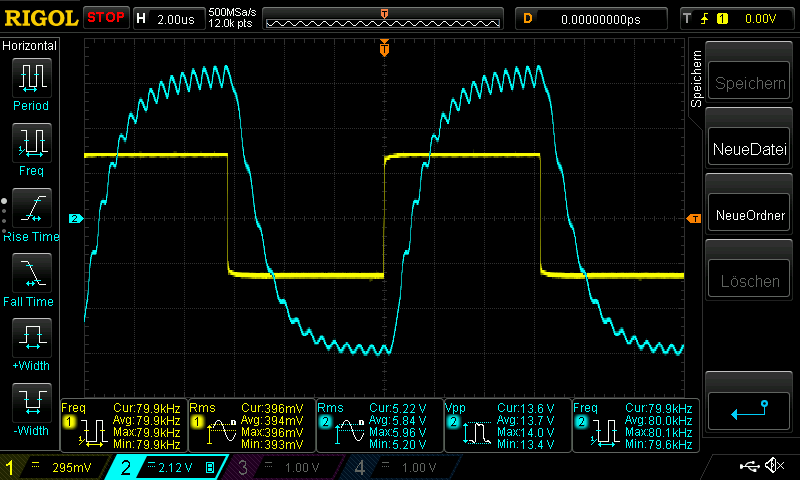

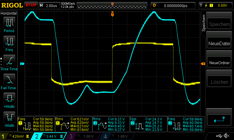

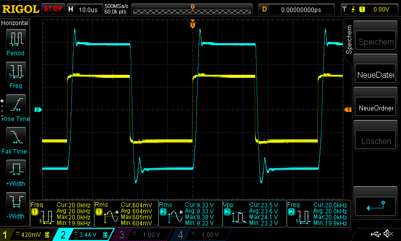

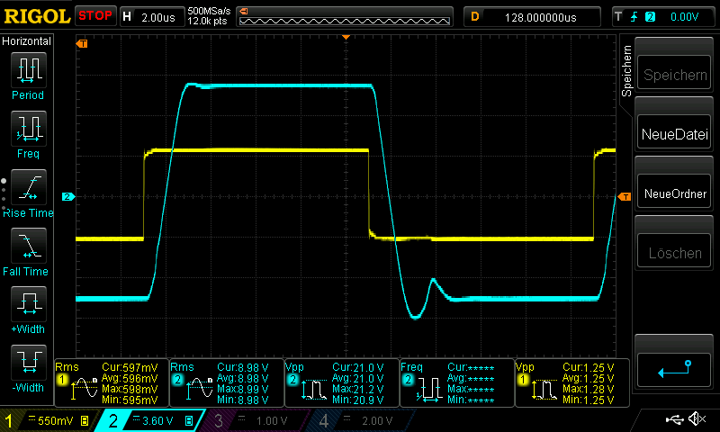

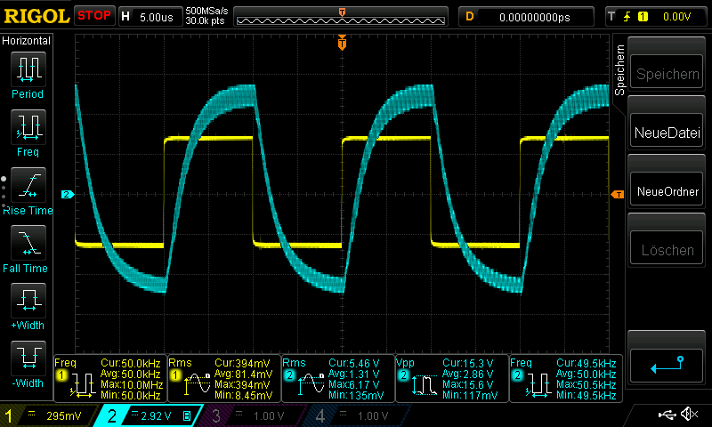

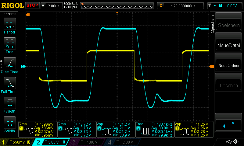

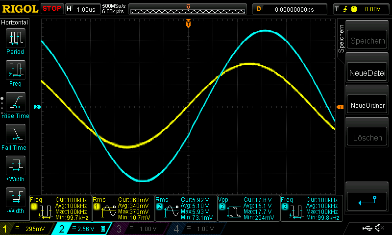

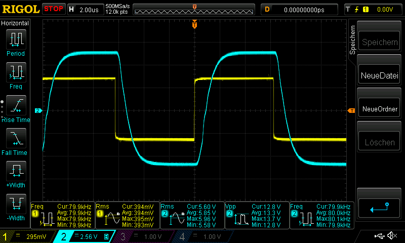

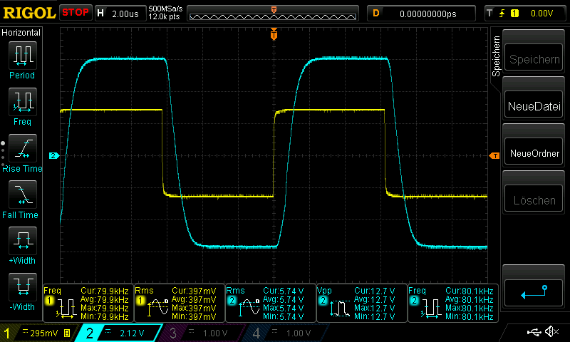

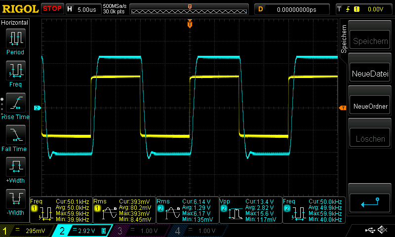

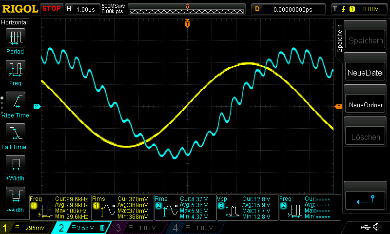

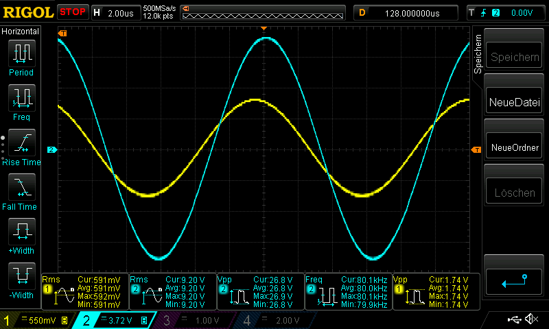

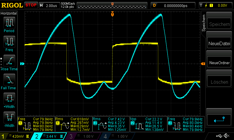

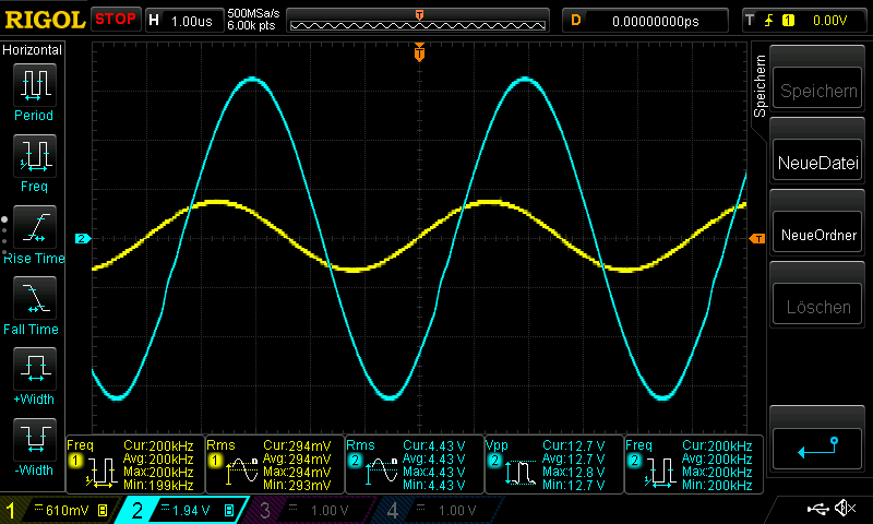

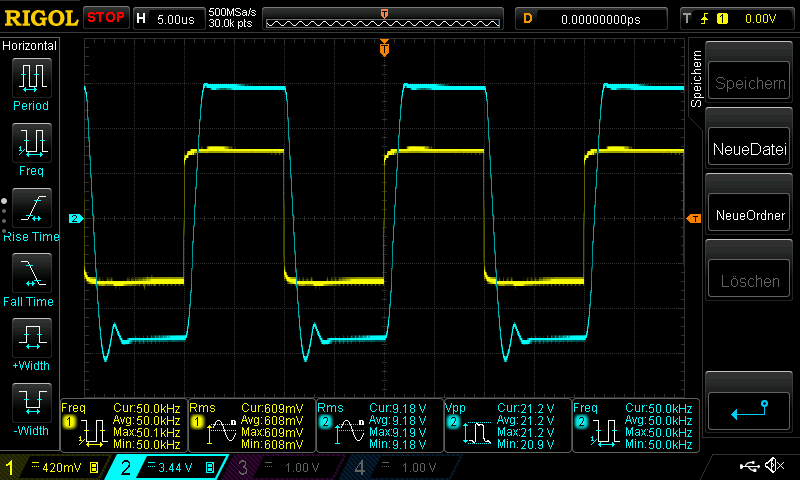

mono board with 4,459R and no feedback cap
now the important measurements because of the better current capability of the utc chip (22V supply, max 25V!)
pic 1 22Vsupply 4,459Rload 1khz 840mVrms about 36,7Watt
pic 2 22Vsupply 4,459Rload 10khz 840mVrms
pic 3 22Vsupply 4,459Rload 80khz 600mVrms
pic 4 22Vsupply 4,459Rload 200khz 300mVrms
pic 5 22Vsupply 4,459Rload square 20khz 600mVrms
pic 6 22Vsupply 4,459Rload square 50khz 600mVrms
pic 7 22Vsupply 4,459Rload square 80khz 600mVrms first 2 seconds stable
pic 8 22Vsupply 4,459Rload square 80khz 600mVrms not stable after 4 seconds
pic 9 22Vsupply 4,459Rload square 60khz 600mVrms
target was to set the gain a little bit down --> Gain is about 15. feedback resistor is changed to 14k814.
i have to try out which feedback cap is working for the UTC at this configuration
chris
Hi Chris,
Congratulations that you sorted out the initial "DIY" troubles!.
First thing i noticed is that i don't see your "familiar" oscillations on the sinus peaks…
It actually looks quite good and well... 37W at 4.5 ohm.. wow!
I am especially looking forward to your (future) listening and comparison tests on the UTC chip!
For sure your ears (and listening experience) are way beyond my capabilities in this respect.
In stead of paralleling and/or bridging Amp techniques i suggest to also consider bi-ampling techniques using these little boards.
For instance one PCB for the low and a second PCB for the mid/treble speaker.
If your speaker already is prepared for bi-amp connection it is an easy alternative to obtain "double" power per channel as well.
And it might very well have a greater impact on the aural perception.
Or use an active or passive crossover.
This little PCB is perfect for this application!

Hi FF
thanks for your kind words.
look here i did a test with different Cf caps..
pic 1 22V supply 4,459R load 400mVrms in square wave 50khz_without Cf
pic 2 22V supply 4,459R load 400mVrms in square wave 50khz_with 100pF
pic 3 22V supply 4,459R load 400mVrms in sine wave 100khz_without Cf
pic 4 22V supply 4,459R load 400mVrms in sine wave 100khz_with 100pF
finally the 10pF 22pF, 47pF ceramic for testing -directly at the pin 2-4
pic 5 22V supply 4,459R load 400mVrms in square wave 80khz_without Cf
pic 6 22V supply 4,459R load 400mVrms in square wave 80khz_with 10pF
pic 7 22V supply 4,459R load 400mVrms in square wave 80khz_with 22pF
pic 8 22V supply 4,459R load 400mVrms in square wave 80khz_with 47pF
10pf or nothing?
chris
22V supply 4,459R load 400mVrms in square wave 80khz_with 22pF.png46.8 KB · Views: 82
22V supply 4,459R load 400mVrms in square wave 80khz_with 10pF.png45.2 KB · Views: 76
22V supply 4,459R load 400mVrms in square wave 80khz_without Cf.png46.9 KB · Views: 82
22V supply 4,459R load 400mVrms in sine wave 100khz_with 100pF.png47.9 KB · Views: 84
22V supply 4,459R load 400mVrms in sine wave 100khz_without Cf.png46.7 KB · Views: 87
22V supply 4,459R load 400mVrms in square wave 50khz_with 100pF.png57 KB · Views: 79
22V supply 4,459R load 400mVrms in square wave 50khz_without Cf.png46.5 KB · Views: 77
22V supply 4,459R load 400mVrms in square wave 80khz_with 47pF.png49.5 KB · Views: 79
10pf or nothing?
chris
Nothing. Try a 1K resistor between the two input pins instead. 1K may not be the best value but see if it has an effect.
