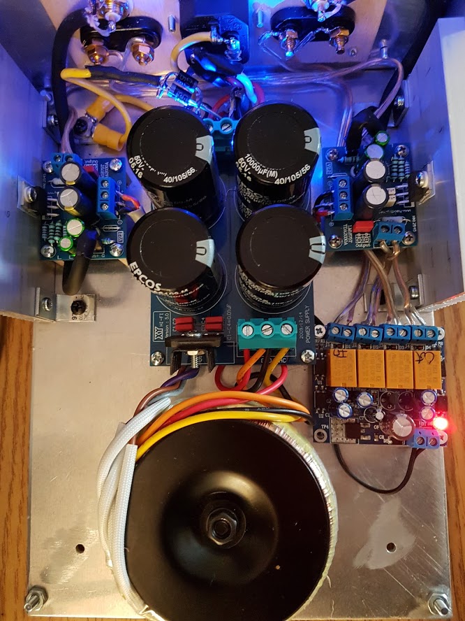

Hi Turbo,
I have no problem accepting im doing something wrong haha.
Here's a few pictures,
Pic 1 : So the original plan without the protection board made it quite neat IMO, short low signal runs, short speaker runs, audio boards as far away as possible from the transformer, etc.
Pic 2 : So you can see how adding the protection board messed the layout/wiring. Now you have the speaker wires from the left board looping all around and going quite newar the 120v.
Signal shields : The screen is linked to the negative signal at the RCA only, im using shielded microphone cable.

The protection board you have is for bridged amps. I think that might be a problem.
It is made to work independent of ground, the relay contacts are separate. So you have speaker + and- , positive supply and ground. I can not predict how this works out with your installation. As it costs only 5$, maybe get a protection board not usable with bridged amps?
The other problem, you have power grid earth connected to your metal case. While this is good for safety, it will give you problems with hum.
I ignore safety ground during build up and connect it as the last thing, only when the amp is 100% hum free. This way I can solve this problem last.
Nothing is worse than multiple causes for the same problem.
I write "hum free", not noise free, as some high frequency hiss is usually in the tweeter and some induced noise, like mobile phones and DECT stuff can not always be kept out. As long as it is an open installation such noises is no problem.
There is one thing I would instantly remove: You use wire that has two lines in parallel. Absolut no go inside an amp! Even as you can build silent amps with it, there might arise problems you do not see or hear and suddenly lead to a "burning chip" from oscillation.
The best you can do is to get some solid core wire for electric installation, the stuff you find a mile in every house. Best is the 5-core, so you get the different colors. Remove the outer insulation and use a drill to make nice twists with 2 lines for speaker and 3 for power connection.
This stuff is a bit tough to bend and it might take some time to make a force free installation to the contacts. Do not let it run in parallel with other wires, a 90° crossing is OK.
You can make the same from soft wire, but it might be harder to get and much more expensive.
Your over all installation should be OK, even as it is a bit on the narrow side. The bulky power connector might be worse than a fixed wire, even as this does not look professional.

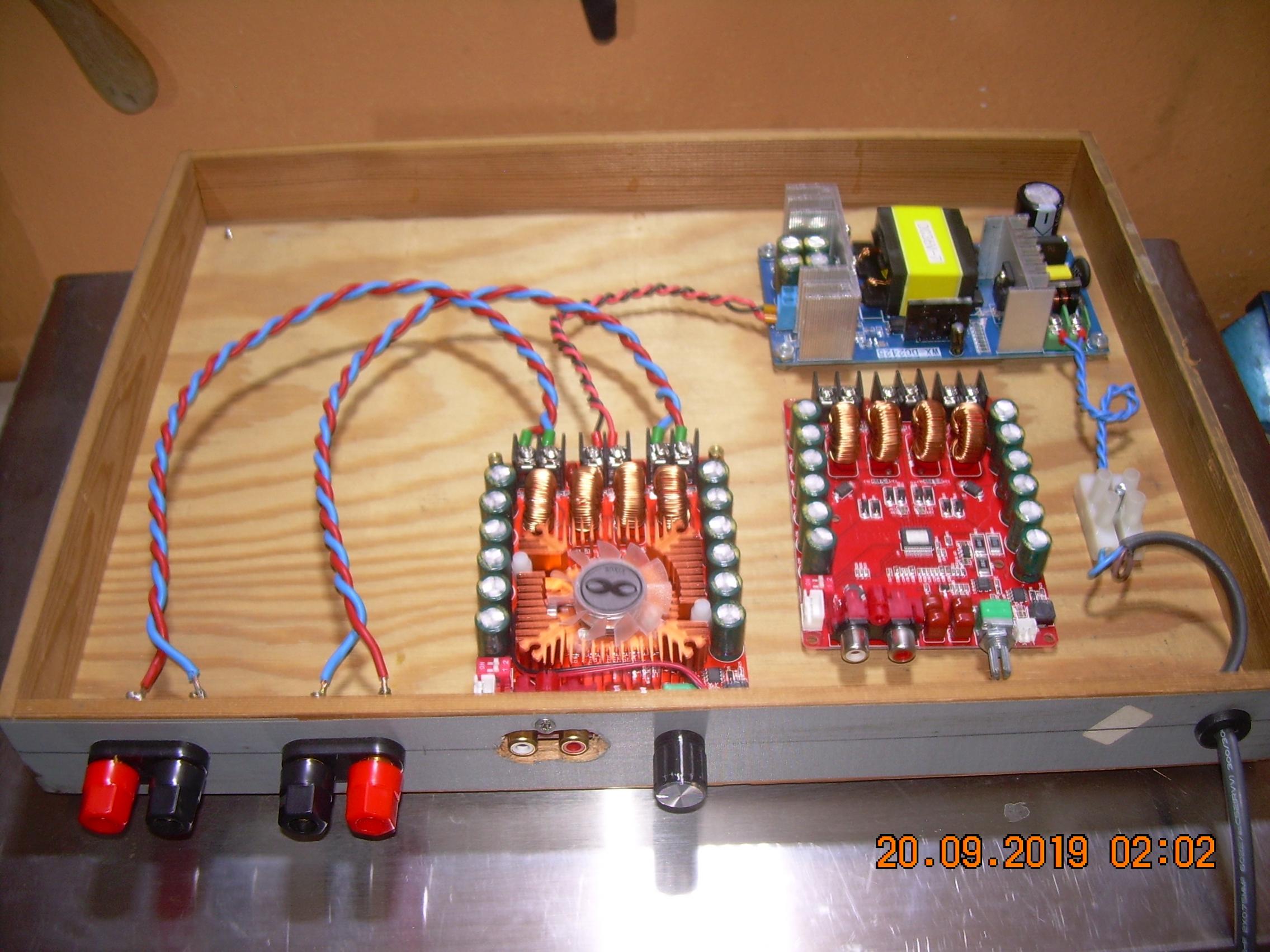

This was just for a quick test. Such an installation takes not even 10 minutes more than just connecting anything on the table, but prevents any accident.
For permanent use of a D-amp SMPS combo I use closed metal cases, as EMF radiation is punished in my part of the world.
I have no clue where the wooden tablet comes from. Maybe 50 years or older...
The second amp PCB that is not conneced is the same article, just without heat sink/ fan.

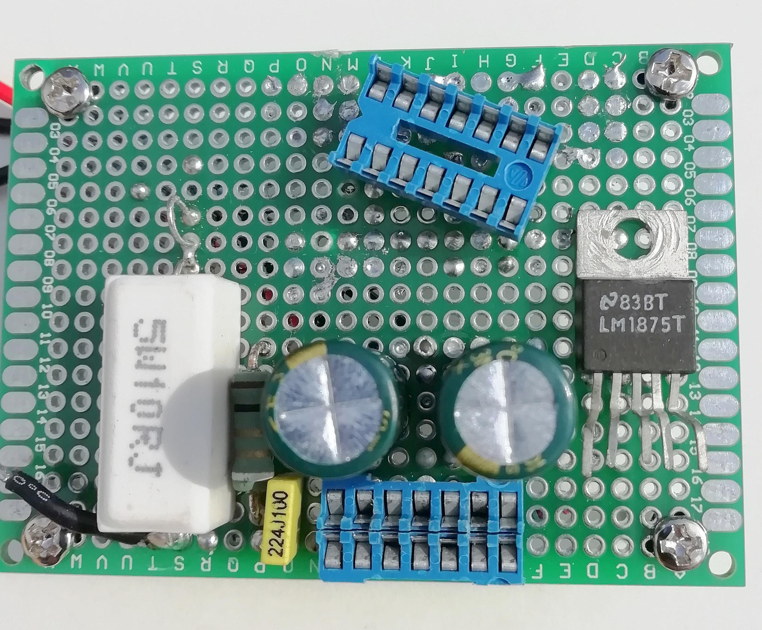

Hi
i want to change on the mono boards the chip 1875 to UTC2050. long story short i got a bad connection"in the board" dont ask me why. i know that more then once soldering the solder dots get lost but this is new for me. if i switched on the V+ or the V- alone everything is fine - but both are shorting!!
ok strange pcb material...
ok. my idea was to check the chip alone or in a separate board where i can just change the chip easily. a DIL socket is not working, the breadboards are to small.
yes i can check directly at the pins for the first check..but without changing the feddback resistor...etc..
pin 2 GND
pin 3 V-
pin 5 V+
what is your idea?
chris

Hi Chris,
A photo of my LM1875/TDA2050 test board. More components on the rear side.
The blue IC socket standing on the board is just to show you what kind of socket I used before cutting it in two pieces. You can see that I bend the LM1875 pins a bit outwards to fit in the socket.
