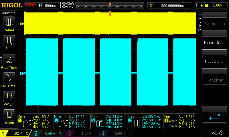

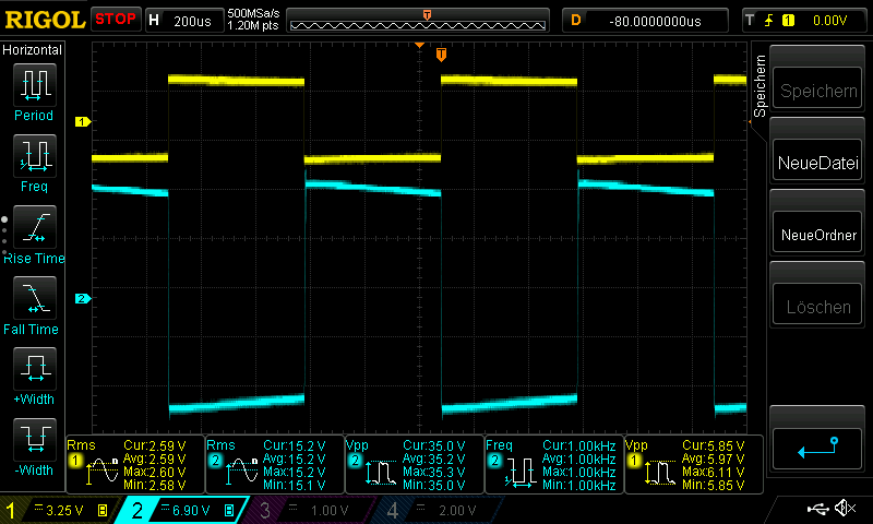

yes i have a cap at the input (green muse 10µF electrolytic). i did a check again..now and go 10mV more input the get a oscillation. output DC coupled....
pic 1 inverted amp 22V supply 8,2R_square wave 1khz 890mVrms in oscillating
Hi
The feedback cap from the non inverting version is about 100pF to avoid oscillating . now in the inverted mod i get this output signal.
About my square wave output signal at the inverted mode it looks like a integrator opamp. its very "soft" integration:

Good morning Chris,
"according to this page the 90° swap from sinus to cos is not happened". The theory you cite is German and that is no longer applicable for constructions made in English (as used on this forum) after the Brexit - no more common rules! 😕
Sorry, I adore silly jokes. 😀
Your 100pF used in the feedback of the LM1875 will only have an effect at very high frequencies. At audio frequencies, the feedback resistor determines the transfer function and there you have no phase-turn. Even increasing the input frequency will hardly let you see the 90 degree phase-turn because the LM1875 slew-rate will put a limit before that.
The OP-AMP used in the composite amplifier version runs as a real integrator (no feedback resistor) and you have the 90 degree phase-turn.🙂

Thanks FF

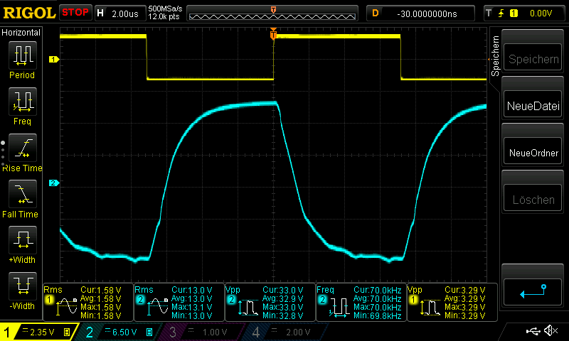

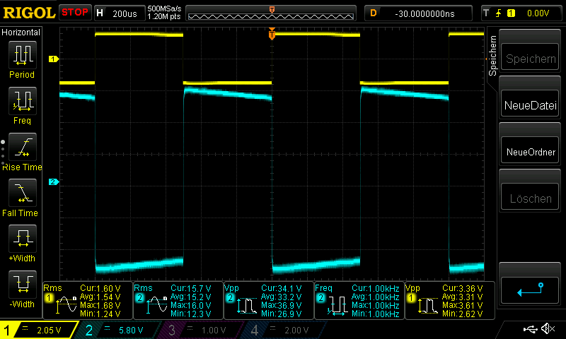

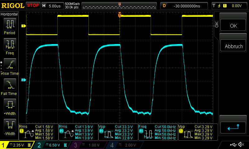

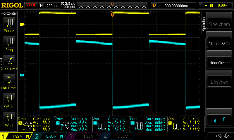

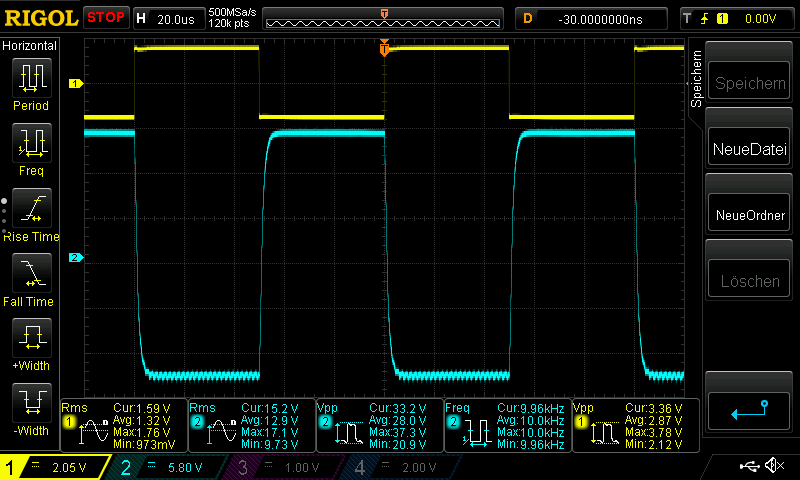

sqaure wave 4,459R + caps
Hi
i´d play around to find out which gain (10 or 6) is more stable with 4,4,59R + 440nF load:
Gain 10:
first pics without cap load - 4,459R load square wave input 1,7Vrms - about 50 Watt!!!-- fan is recommended😀
pic 1 inverted amp Gain 10 22V supply 4,459Rload_1,7Vrms in 1khz
pic 2 inverted amp Gain 10 22V supply 4,459Rload_1,7Vrms in 10khz
pic 3 inverted amp Gain 10 22V supply 4,459Rload_1,7Vrms in 20khz
pic 4 inverted amp Gain 10 22V supply 4,459Rload_1,7Vrms in 30khz
pic 5 inverted amp Gain 10 22V supply 4,459Rload_1,7Vrms in 50khz
pic 6 inverted amp Gain 10 22V supply 4,459Rload_1,7Vrms in 70khz
chris

inverted amp Gain 10 22V supply 4,459Rload_1,7Vrms in 1khz.png47.4 KB · Views: 206
inverted amp Gain 10 22V supply 4,459Rload_1,7Vrms in 10khz.png47.8 KB · Views: 206
inverted amp Gain 10 22V supply 4,459Rload_1,7Vrms in 20khz.png46.5 KB · Views: 212
inverted amp Gain 10 22V supply 4,459Rload_1,7Vrms in 30khz.png50.4 KB · Views: 221
inverted amp Gain 10 22V supply 4,459Rload_1,7Vrms in 50khz.png46.5 KB · Views: 204
inverted amp Gain 10 22V supply 4,459Rload_1,7Vrms in 70khz.png45.6 KB · Views: 77

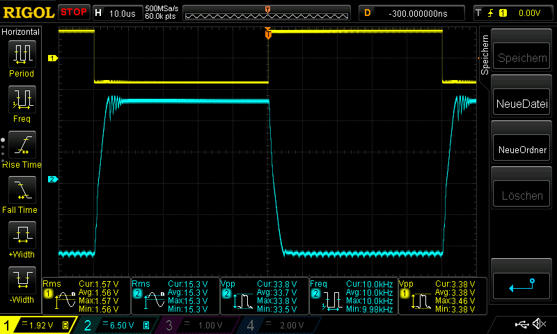

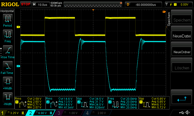

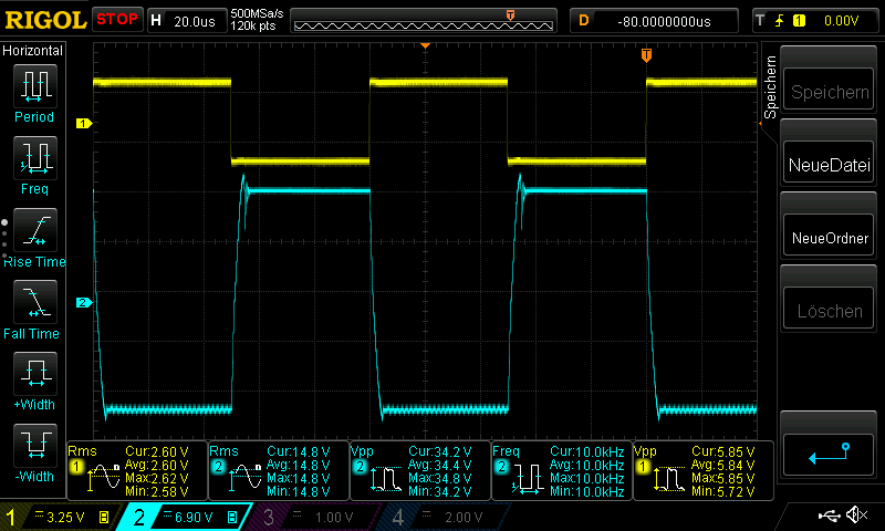

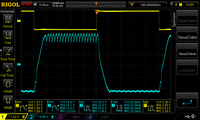

now Gain 10: with 4,459R + 440nF mkt caps
pic 1 inverted amp Gain 10 22V supply 4,459Rload_440nF cap_1,7Vrms in 1khz
pic 2 inverted amp Gain 10 22V supply 4,459Rload_440nF cap_1,7Vrms in 10khz
pic 3 inverted amp Gain 10 22V supply 4,459Rload_440nF cap_1,7Vrms in 20khz
the chip goes to its internal thermal ore current limiter
pic 4 inverted amp Gain 10 22V supply 4,459Rload_440nF cap_1,7Vrms in 20khz current limiter
chris
chris
inverted amp Gain 10 22V supply 4,459Rload_440nF cap_1,7Vrms in 20khz current limiter.png45.9 KB · Views: 81
inverted amp Gain 10 22V supply 4,459Rload_440nF cap_1,7Vrms in 20khz.png47.7 KB · Views: 81
inverted amp Gain 10 22V supply 4,459Rload_440nF cap_1,7Vrms in 10khz.png45.4 KB · Views: 81
inverted amp Gain 10 22V supply 4,459Rload_440nF cap_1,7Vrms in 1khz.png47.2 KB · Views: 77

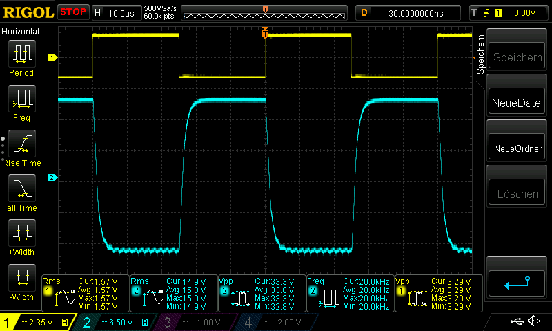

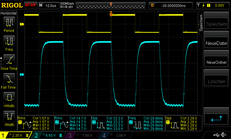

last the Gain 6 + 4,459R + 440nF:
pic 1 inverted amp Gain 6 22V supply 4,459Rload_440nFcap_2,7Vrms in 1khz
pic 2 inverted amp Gain 6 22V supply 4,459Rload_440nFcap_2,7Vrms in 10khz
pic 3 inverted amp Gain 6 22V supply 4,459Rload_440nFcap_2,7Vrms in 20khz start oscillating- you really can see at the positive rail the the chip start to oscillating during 3-4 seconds
pic 4 inverted amp Gain 6 22V supply 4,459Rload_440nFcap_2,7Vrms in 20khz start oscillating + current limiter
so for me the Gain 6 (8k1 parallel to the 22kR) is little bit more stable but not really much.
chri
chri
inverted amp Gain 6 22V supply 4,459Rload_440nFcap_2,7Vrms in 1khz.png48 KB · Views: 82
inverted amp Gain 6 22V supply 4,459Rload_440nFcap_2,7Vrms in 10khz.png48.6 KB · Views: 84
inverted amp Gain 6 22V supply 4,459Rload_440nFcap_2,7Vrms in 20khz start oscillating.png48.3 KB · Views: 93
inverted amp Gain 6 22V supply 4,459Rload_440nFcap_2,7Vrms in 20khz start oscillating + current .png53.2 KB · Views: 86
If you start using fast OP amps in front of the chip amp, be careful.
If a very fast signal is at the input, the slew rate of the OP-amp has to be matched by the next stage for it´s gain. This is impossible at some point, as no power amp can follow this multiplication.
This is a strong argument to use an input filter!
@Chris I see all kinds of power supply influence, over temperature and maybe over current limiter´s in your pictures.
If you have one thing under control, you will drive the next factor into limitation.
This has no practical value any more.
Please do not get me wrong, but this will not lead to sonic improvement. You do not find any advantages from this over driving.
If the aim was to build an amp (I still see it as an educational experiment!), you would now build some prototypes and measure them, but only with reasonable test´s!
Just because your advanced equipment can produce such tests, the real amp does not have to deal with them.
Like your SUV can be driven on a Formula 1 race track, but will tilt over if you try to reach F1 cornering speed.
There are limit´s with any amp in this world. You only need a load resistor large enough and an input signal high enough and you can find points where the amp gives up.
Like driven into clipping at 20.000 Hz. This is something that never ever happens with music! If it does, the tweeter burns, the amp does not care.
If it was an idiot proof commercial product, you would find a limiter in the input that would prevent any of your extreme tests and the same at the output. So the amp never
sees your input and never goes unstable.
This is what you see in some pictures, where the amp simply cut´s out.
So, please, stay realistic, take into account Ohm´s law and don´t fall into the old trap: "Wer viel misst, misst viel Mist".
