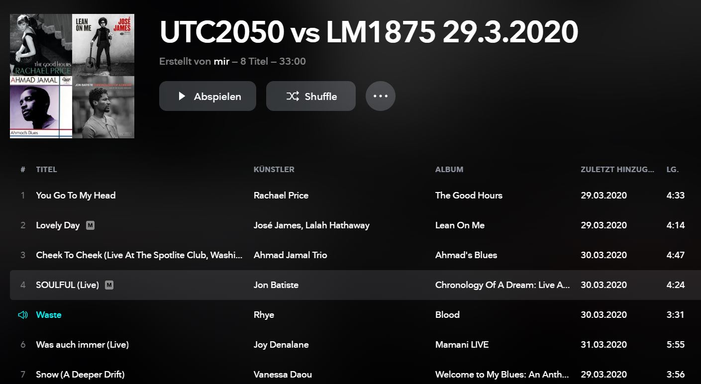

first sound impression of the UTC2050 chip amp i built. after running it 6 hours a notice no strange sound or something else. no on pop but a small off pop is noticed. sound is good - actually i find it a bit "hard in highs" and bloated in the bass area.... but will hear after some days on/off hours..
speakers are open baffle 12/5 8R because one of the two 12" sub is off.

After every evening listening session i can´t say there is a different between my mock up amp LM1875 25V supply and the UTC amp ind the housing with 22V supply. both amp give me nice interpretation of different songs the last days.
so the UTC is a good chip🙂

Many thanks for the test, Chris.
Both Fred and you have now given the UTC-TDA2050 a good listening test and both concluded that if there is a sound difference to the LM1875, it is marginal.
For European DIYers, genuine LM1875 is difficult to buy unless an importation procedure from the US is used with the costs that may add. The UTC-2050 is available from Reichelt.de at a considerably lower price than the LM1875, with less shipping costs and no extra importation fees.

For me the sound in daily use is also excellent and i did some simple blind tests with friends (and my grandson..) to confirm my own impression.
No question the amp is delivering really good quality sound and (although there are some very minor nuances) the LM1875 and UTC 2050 are performing equally nice. For practical reasons i used the UTC 2050, because i had difficulties finding genuine LM1875 chips.
I also appreciate its total silence even with the ear on the speaker .

Yes the amps are very similar. i slightly prefer the UTC.Why? i dont know. maybe the lower gain helped him the have less fog in the middle of the presentation! maybe the real alu housing helped for better "interference blocking" - in the very high vocals and high hats the LM875 can do a very small bit better.
Did you try the amps with lower gain- as i have e.g. RF=15k = 20gain??
