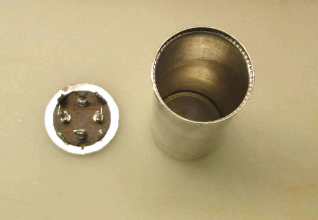

I want the ability to stuff a can cap with whatever modern caps I want and retain the vintage appearance. Also, the ability to recap it again to put in new ones and/or change the values at will, which is possible with a restuffed can without spending a fortune.
I picked up a couple of "NOS" quad caps on Flea-Pay to see if I am able to empty out the cans neatly. There are a number of different techniques online for doing it. I'd like to be able to open them up again later for servicing and/or adjustment. We will see how it goes. Step 1: Empty the can without ruining the appearance. Step 2: Find a use for them, which I am sure will be no problem in the future. How many of us ever have trouble coming up with a new project?

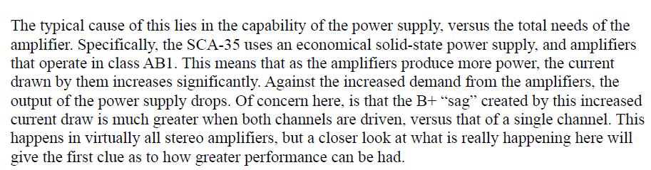

However, I notice that the Tronola article about the SCA-35 states clearly that it is class AB1 (excerpt below). Is it different from the ST-35 in that respect?
SCA-35 article: http://tronola.com/html/a_new_look.html

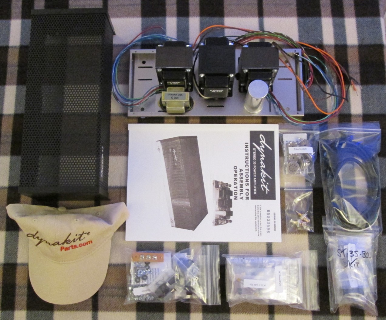

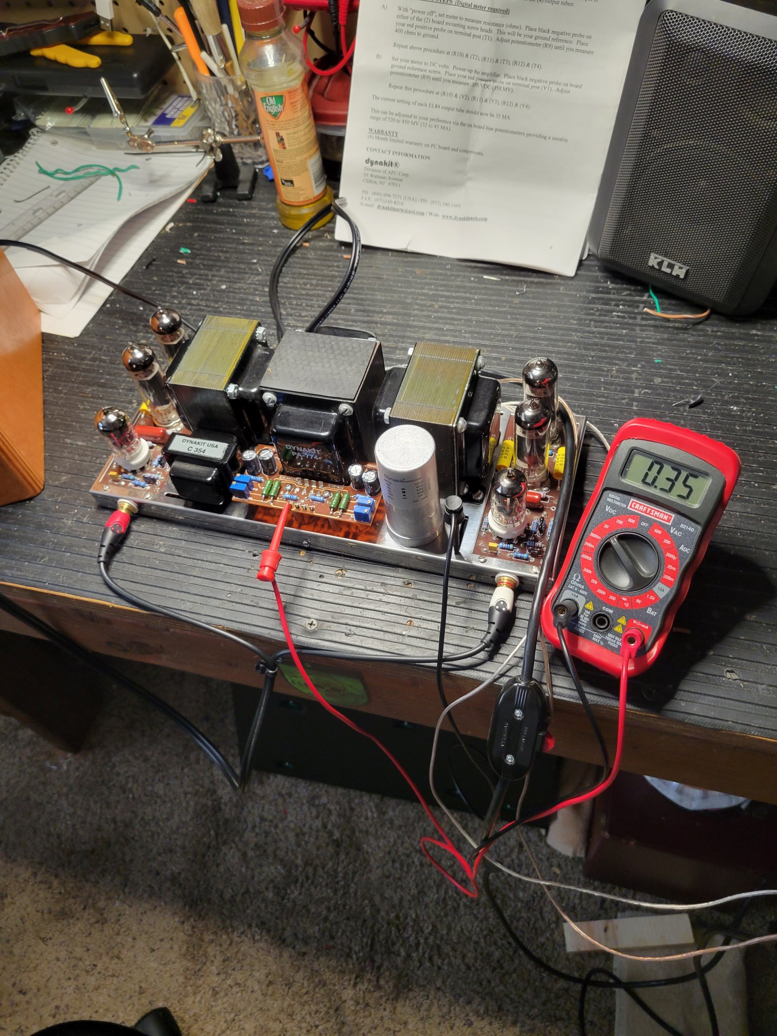

Well, it is now started. Everything for a new DynaKitParts ST-35 has been purchased except the tubes.

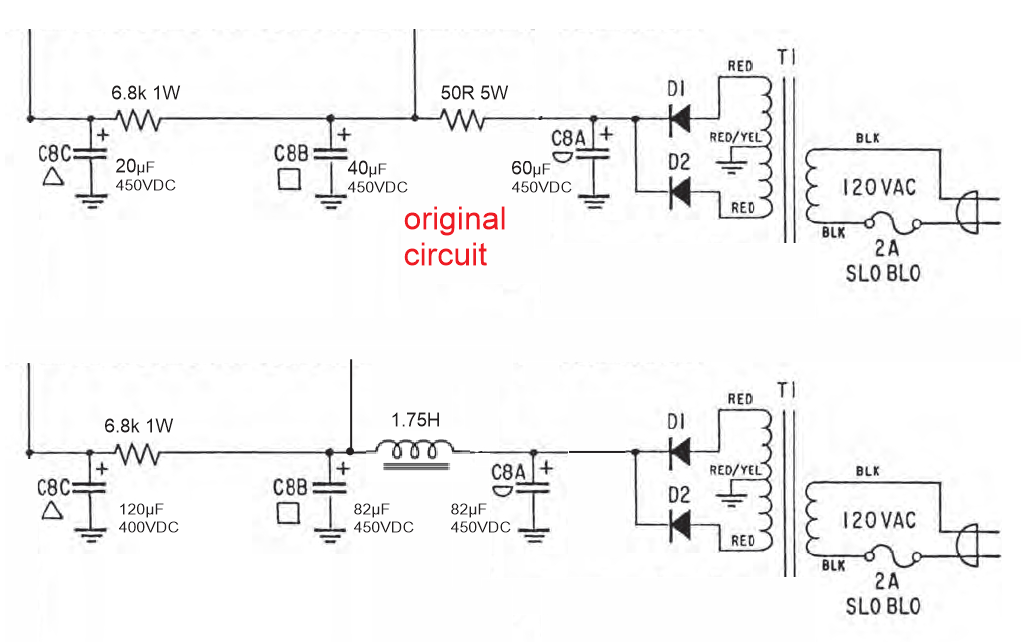

Now I have to make some decisions on the power supply. I did order the optional choke, so I'll be using that. I also ordered the bias adjustment add-on kit with the four trim pots, one for each tube.
The kit comes with a 60/40/20 uF 450VDC can cap. However, I may use this to make my own cap instead:
It's a mint condition quad cap can that I cleaned out perfectly, leaving all of the terminals intact. I can now stuff whatever values I want inside and change them relatively easily in the future since I'm not going to crimp the can shut again.
The largest values that will fit would be this arrangement:
Any thoughts on these capacitor values? I haven't made a decision yet. I may insert a series 50Ω 5W resistor between the diodes and C8A as discussed previously, to drop about 25 volts, but I haven't made that decision either.
I'll be using 6P14P-EV output tubes. so the voltage and dissipation is not a large concern. They are built to handle it. Also, tube life in this amp never has been a large concern for me. There are no complaints about it with the amplifier as-is with no changes, just theoretical discussions of what might affect tube life with no actual data and no first-hand experience to back up those ideas.

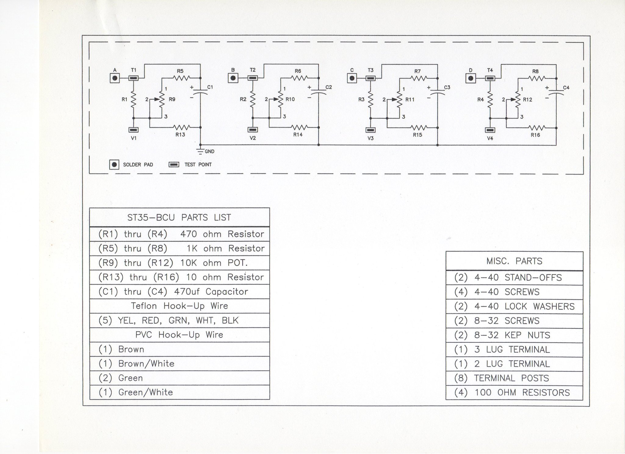

I have opted for the bias board that allows individually tweaking the bias of each output tube over its lifespan, but I don't want to modify the original design much farther than that.
My question now is, given the original design and me not being concerned with reducing the voltage and dissipation much if at all, what would be the optimal cap values for me to put inside the empty can for the power supply. It seems that most designers follow the "bigger is better" approach with these caps.
If I want to reduce voltage and dissipation, (and I am not sure that I do) I never have understood why reducing or removing C8A instead of just putting a series resistor between the diodes and C8A wouldn't be an excellent (and easily reversible) approach. It would allow me to jumper the resistor in and out of the system for A/B comparison also, giving me a choice of "jumped out of the circuit sounds better and/or has more power" but "un-jumped to put it in the circuit may extend tube life by an unknown amount." In PSUdesigner, reducing the value of C8A actually has little effect on the voltage. There is plenty of room for a nice resistor to be mounted on top of the chassis where it can breathe, its power consumption and heating are a non-issue, and it could be jumpered in and out if desired. The original design even uses a 50 ohm resistor, just placing it after C8A where the choke now will be rather than me (possibly) placing it before C8A.
The individual bias adjustment add-on board schematic:

The resistor before the first cap will have more dissipation than you might think, as the current there is discontinuous with high peaks. I suggest you model the circuit in PSUD and use the RMS current in the resistor to figure dissipation. It'll be considerably higher than the average current.
Consider the following:
1. The Golden days of audio (before many were even born):
Power Mains were 110V or 115V, or perhaps as high as 117V.
Vacuum tube rectifiers were used for B+ (with the plates acting as a series resistor).
The power transformer was designed to work with the above facts.
2. Todays modified designs of those Golden days audio amplifiers, and using the original old power transformers:
Power Mains are often 117V or 120V, or perhaps as high as 123V.
Vacuum tube rectifiers are being replaced with low voltage drop silicon rectifiers with less than 1 Ohm of series resistance.
The first filter capacitor is being replaced with higher capacitance than the old tube rectifier first filter capacitors.
Improvements, not without problems.
What happens to the original power transformer (or an exactly specified replacement)?
It says: Ugh! I am getting so Hot!
The old power transformers were Not designed to work with the above facts.
Just My Opinions
(and my personal experience; I run my old transformers at lower current of both B+ and filament current; I even use the much friendlier choke input filter for B+).
My transformers run cooler, not hotter.
82uF first filter cap, and 1.75H choke does not come within a Parsec of what a real choke input filter is.

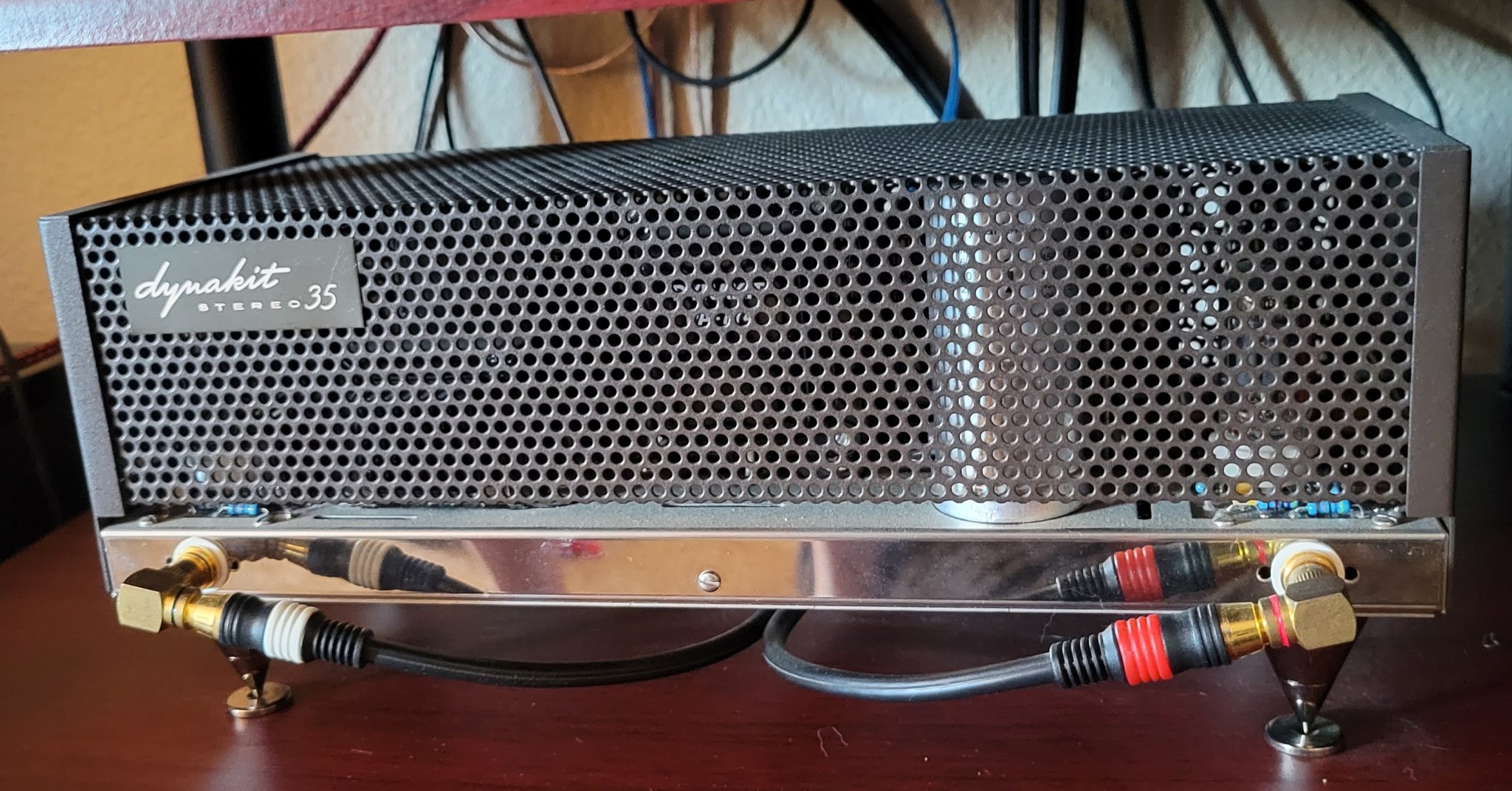

I bought and built the Dynakit ST-35 a couple years ago. The mods I made were replacing the RCA jacks, replace the 50ohm resistor with a 62 ohm choke Dynakit sells. There is an extra hole in the Dynakit chassis just for mounting the choke.
I also installed the Dynakit bias board. I used speaker spikes for feet to get some better air flow. Taller rubber feet would work. I'm using Sovtek EL-84M's and JJ driver tubes. I do have some Reflecktor 6P14P-P's I put in a single ended amp I built, and a quad I put in a modified Magnavox 9303 amp. They sound pretty good. I may try a quad of the 6P14P-EV's in my ST-35.
The ST-35 has been trouble free and sounds great.

Great! I was hoping that someone here had built one. I will be using the choke and the bias kit, just as you did. Everything has arrived, well packed, but I won't be starting the build for a while. Step 1 will be for me to paint everything satin black. I did buy the black tube cage, but I won't use it. I only bought it in case a future owner wants to use it.
I'm using Sovtek EL-84M's and JJ driver tubes. ... The ST-35 has been trouble free and sounds great.
@lavane
So you are still on your first set of tubes after a few years with no issues?
I knew the amplifier was small, but just how small it is didn't sink in until I got the chassis out of the box. It's only about 5-1/2" deep. The $950 price tag was a but more than I wanted to spend, but I wanted to try one while they are available. It's a very well done kit.
A little over 5 watts. I would use one of the power resistors that comes encased in a finned metal heatsink I guess.

Would you please elaborate on the last sentence. I’m not sure I understand and would like to know more.
Btw, Dave Gillespie stated that he decided to provide a common bias (in the EFB boards for SCA35 and ST35) for all four output tubes because “he did not want to deviate too much from the original Dyna design”. But he also added a plausible explanation of the advantages of having a common bias (in addition to the known disadvantages). The primary goal was lowering of distortion with the EFB, not preservation of tube life.
