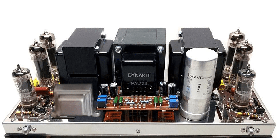

tubes run on maximum dissipation - the box is a closed type with a lot of perforations which are not enough ... tubes are cooking themselves and everything else besides.
Yes, this is why I don't plan to use the cage. My Dynaco ST70 series ii has the same cage construction with solid sheet metal sides, which just traps heat. If I could find the same perforated metal, I could use a Dremel tool to cut out the sides and then JB Weld new perforated metal squares to the inside of each side to fit the new openings. It would look perfectly normal. However, I know of no source for the perforated metal cage material. A lot of companies use it, so maybe I can find it online somewhere.
Given the two reports above from users who estimate up to 5,000 hours for the Sovtek EL84M and the Russian 6P14P-EV, I'm not too concerned about running the tubes hard. I have always changed the tubes in my Dynaco ST70 series ii about every 2,500 hours. Heat buildup, however, always is a concern with tube amps.

For last year & a half I run my amp without top & side cover ( U profile like AN closed box amps ). Were I smarter I would do it years ago.
6P14-EV from my experience last long, they were the original choice for this amp with tubes on maximum dissipation - and they for sure lasted more than 5,000 hours ( think way more but not sure since I'm not the first owner ).
