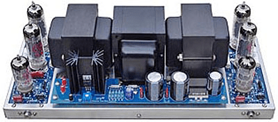

I’m curious about the reason(s) for your resolve not to use the external board Dave Gillespie designed to fit nicely in the available space. It gets all the heat-generating PS resistors and regulator outside the case to reduce heat build-up. If you don’t like the looks of it you could put your cage back on and fuggitaboutit. I like it and the results it produces, but do wish Dave had used a regulator for each output pair though.If I were smart enough to figure out how to fit EFB inside the chassis like Art Grannell did, I might do it, but I will never use the giant external EFB power supply board that is now sold, which spans the whole width of the amplifier.

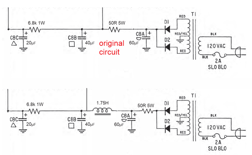

There is a downside to these attempts to make the power supply less "perfect" - voltage regulation, meaning the power supply's ability to keep a constant voltage with varying current loads, is significantly decreased. In the ST-35, biased almost into true class A (ideally zero current draw change with signal level), this doesn't matter enough to matter. In other amps, it could matter a lot, so yours is a special case.
I will be using the optional choke. There is room for it on the chassis. The kit is designed for it to be added easily, and in PSUDesigner, it makes a big difference. With the choke in the circuit, and an almost continuous load, I am wondering if my original question about increasing the capacitor sizes is even relevant. With the choke in the circuit, the stock 60/40/20 can cap produces almost no ripple in PSUDesigner. As you pointed out, the load is almost continuous, so building up a massive reserve of extra added capacitance in this particular case would seem to serve no purpose unless I am missing something.
As for the possibility of reducing the B+, I likely will just select robust output tubes like the Sovtek EL84M, which is built for this situation. There are no widespread complaints about tube life with the amplifier. However, it seems that adding a chassis-mounted 50Ω power resistor between the diodes and the first capacitor would drop the voltage just a little bit without sacificing any performance other than heat loss and the cost of the resistor, agreed? A 50Ω 10W in a nice metal housing that would attach to the chassis only costs a few dollars and it's an extremely simple addition and completely reversible, if this solution would work to reduce B+ a little bit. Not sure if I'd need to change the value of that 6.8kΩ but that's easy enough if needed. The 50Ω as shown in the bottom diagram should make the job of the power transformer a little easier too, correct?
Looks like you've nailed it down pretty tight. You might explore exchanging the 40uF and 60uF caps in positions C8A and C8B in PSUD to see if you can live with the slightly reduced B+ or not. More C8B is more better, but given the givens, not crucial. Have fun! It'll sound great.
Yes, I did try that swap, and it did make a little bit of difference, but really not very much, only a few volts. Various values of new quad caps are now available, including the option of "restuffing" a metal can salvaged from a bad quad cap, but since a nice new 60/40/20 comes in the kit, I figure I might as well just use that. Note: Given that modern 450VDC caps have gotten relatively small, it's easy to strap an additional one or two underneath the quad cap to add value to C8B or C8C if there is any room for improvement there. I'm wondering if there is any real improvement to be had there though.

B+ is not present on the individual bias board, only minor voltages (less than 15 volts). The few leads on the PCBs that have over 100 volts will be protected with teflon insulation and/or heat shrink to reduce risk, and the heat of the tubes is a tremendous deterent to keep fingers out of there on top of that. The board from Tronola appears to expose the full voltage from the power transformer and diodes right up front on the amplifier. I had a friend poke a soft dome tweeter one time to see what it felt like before I could stop him. Don't try that with that power supply board.
That board also prevents the use of the choke since it blocks the whole front of the amp. I will be using the choke.
If you are not interested in the performance enhancement provided by EFB, perhaps you should take a look at this new single PCB offering with individual output tube cathode bias-adjust built into the circuit. The seller also offers a nice stainless steel top plate at a reasonable price.
