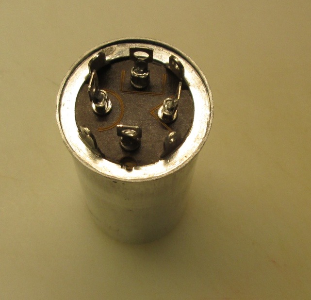

Nice work on the extraction- any Dentist would be impressed... Either you have very big claws, or some type of mechanism.However, I may use this to make my own cap instead:
It's a mint condition quad cap can that I cleaned out perfectly, leaving all of the terminals intact. I can now stuff whatever values I want inside and change them relatively easily in the future since I'm not going to crimp the can shut again.

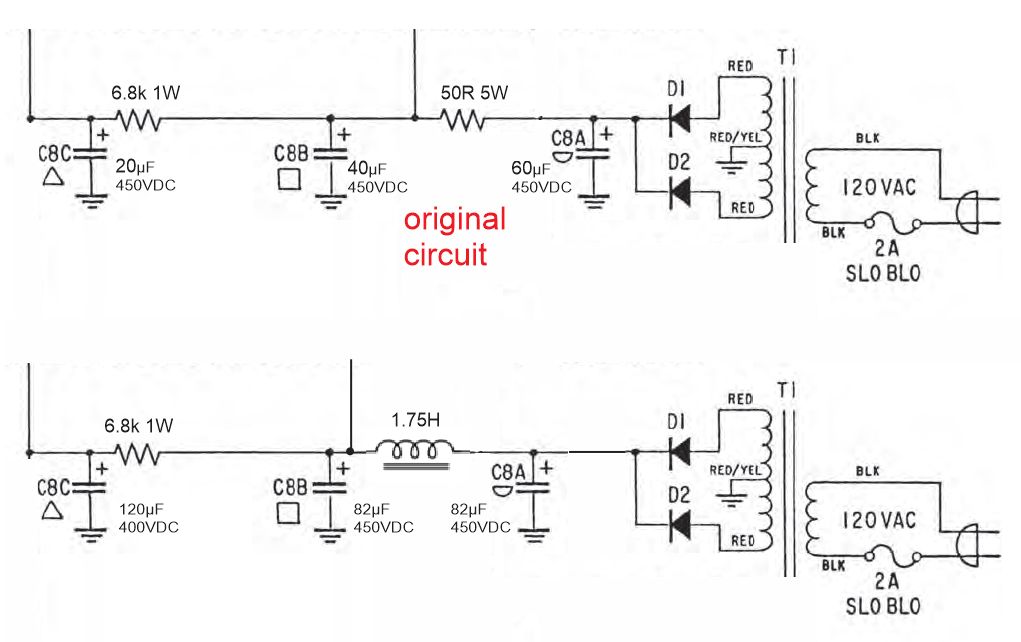

Any thoughts on these capacitor values? I haven't made a decision yet. I may insert a series 50Ω 5W resistor between the diodes and C8A as discussed previously, to drop about 25 volts, but I haven't made that decision either.
I cheated by cleaning out my cans w/ a Bridgeport. Ordered Rubycon TWX skinnies to fill. Now wondering what to use as filler- and how to provide terminals. Current idea is RTV silicone to fill the body. Once cured, 2 part hi temp epoxy surrounding each section (+) male spade lugs. (-) combined as single point lug, since can't solder to AL
Jim

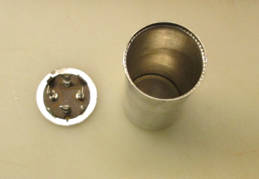

I solved the problem of good, solid terminals by retaining all of the originals, including the twist tabs that hold the entire cap in place. I did this by slowly grinding away the crimped edge of the can with a Dremel tool sanding drum attachment instead of trying to pry it open or cut it open. Once the crimped edge is ground away, the whole guts including the terminals and base can be pulled out of the can in one piece. I did this by putting in the oven to melt the tar. I think it was 20 minutes at 200 degrees, maybe 225. Then I unrolled the cap and trimmed off the internal electrodes flush with the bottom piece. This left the bottom piece 100% undamaged. Slowly grinding away the crimp instead of prying it open left a very clean, perfect edge on the can and no damage to the terminals or twist tabs so the bottom piece is still in new condition and ready to use.
There was a lot of tar inside the can, but it's easily removed I discovered. Simply fill the can with mineral spirits and let it sit for 12 hours. Dump it out, wipe with paper towels, and repeat once or twice until all of the tar is gone. Mine came totally clean.
I don't plan to fill the inside of the cap can. I want it to be removable so I can change caps if I ever need to. You never know when disaster might strike. I'll use the twist tabs to attach the cap base and terminals, with the new caps attached to that. Then I'll slip the original can over it and secure it to the base with something that is relatively easy to break loose like a thin film of RTV silicone.
Good point about not filling-
My can had bulged out the bottom, ESR tested bad all sections. Also- didn't have bottom bakelite- circa 1948... Still admire your tenacity.

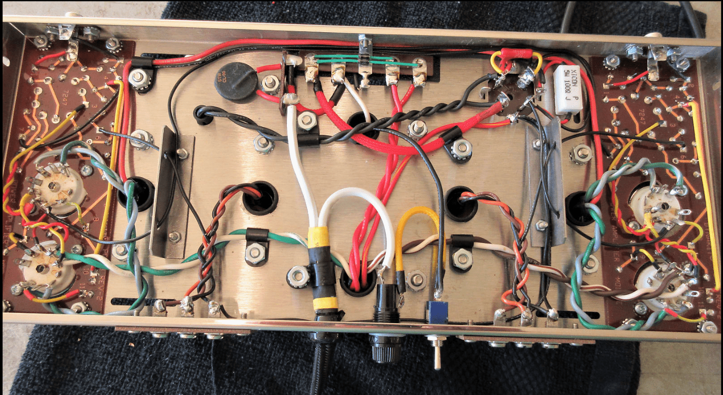

I knew the amplifier was small, but just how small it is didn't sink in until I got the chassis out of the box. It's only about 5-1/2" deep. The $950 price tag was a but more than I wanted to spend, but I wanted to try one while they are available. It's a very well done kit.
At first I bought some 3/4" rubber feet for it, then I saw a picture of these amps posted on another forum with the spikes. Personally I thought the spikes looked good on it, so I bought a set from Madisound. You have to use the flatter pan head screws though so nothing gets shorted out inside the amp.

I'd like to add a power switch on the chassis instead of the inline version included. I'll have to find a suitable small switch. It seems like the least bad option for placement is on the back as the person in the picture below did. I could put it on the front I guess. I wish there was a tiny rocker switch that could be used instead of a toggle.
I'm not sure why this person chose to use a 2-wire power cord instead of a modern 3-wire cord with safety ground. I suppose I'll use 3-wire with a star grounding pattern. I'm told that the isolated input jacks have to be connected to a ground.
I'll probably fabricate speaker binding posts properly spaced for dual banana plugs. I'll just connect the 8 ohm output and leave the 4 ohm output wire coiled inside in case anyone ever wants it, but I highly doubt it. On both of my amps, the 4 ohm output sounds terrible.
An inrush current limiter can be be incorporated to soften the power on process and thus reduce the potential damage of sudden full voltage being applied to the cold vacuum tubes.
Thoughts on this anyone? Would this (CL-90) be the correct item as this ST-35 owner did in the photo? https://www.mouser.com/ProductDetail/Amphenol-Advanced-Sensors/CL-90?qs=K5ta8V%2bWhtYTYrFAkIfaLQ==
I have to wonder if putting this device inline with the supply of a power amplifier would cause more harm than good? A lot of people seem to do it though.

CL-90's are what I usually use. As for the switch, there isn't much room in that chassis. I bought a Bluetooth remote controlled outlet and use it for my ST-35. It works great. I'm not a fan if the wifi power strips though.
I had one flip out and turn two stereo tube amps and a pair of mono blocks on at the same time when I selected one if the amps. It fried the power strip. I've had zero issues using Bluetooth outlets on various amps. I don't like having to reach behind hot amps to turn them off.
Inrush current limiter. Completed - well less faceplate - a ST35 build a few weeks ago. Dynakitparts transformer set in one of their SCA35 chassis for extra space. Dave G’s boards including the EFB one - I’m pleased with it but to each your own of course. Used a CL-90 in it although I believe a CL-80 would be fine also. Just seemed like a sound idea, had the room for a 2 position barrier terminal strip and had seen them in a number of Pass clone builds.
CL-90 ... not sure if this does any good for the tubes since the filaments are going to take 15-30 seconds to heat up, long after the inrush. Seems like this would only be of value to (perhaps) protect large power supply capacitors. Not sure how this works.
