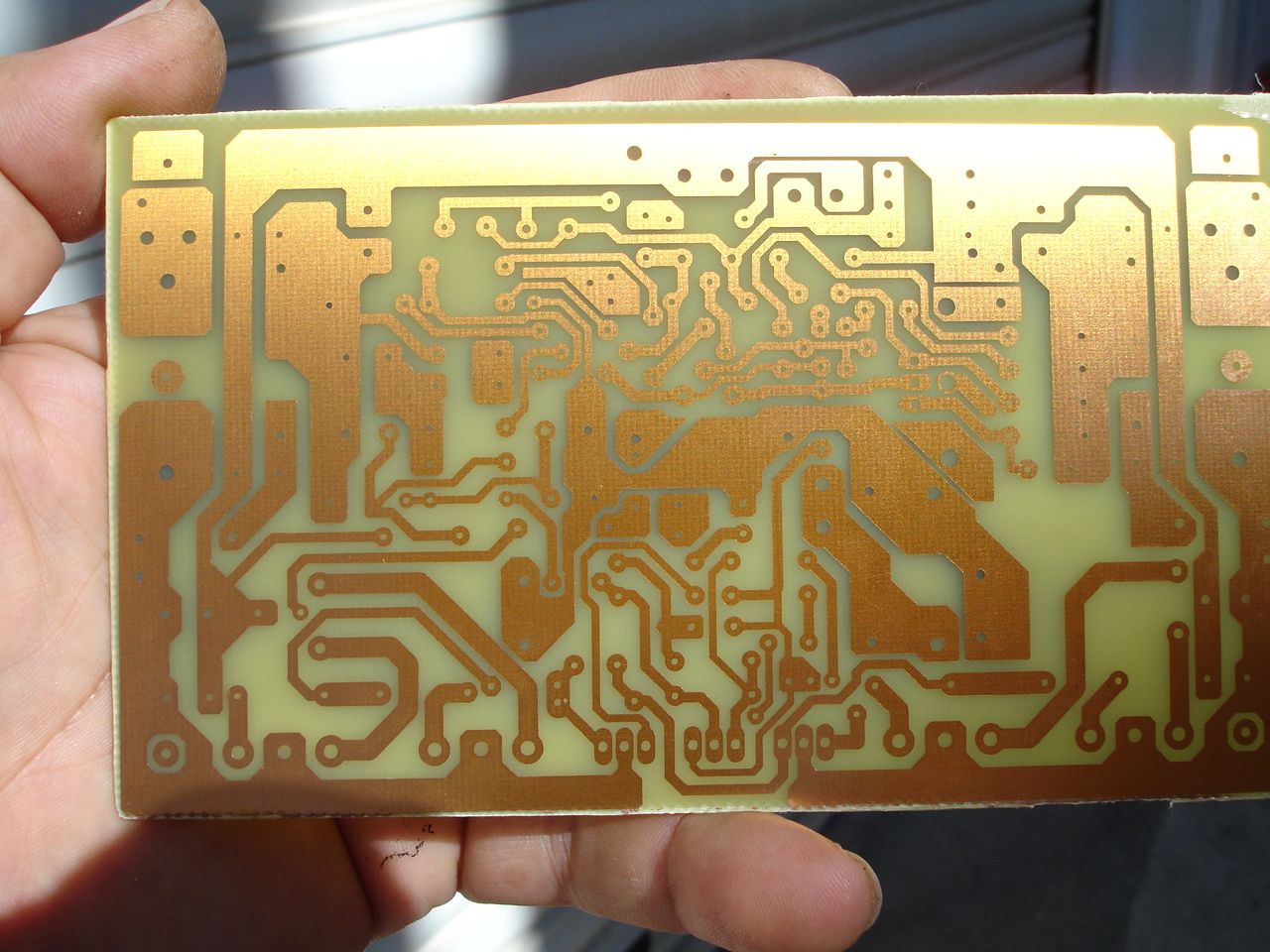

Thank you for your design Juan!nice etching mister thimios looks really good 🙂

Thank you very much Sir.
I have spent many hours and much money in handmade pcb.
Now i'm expert in handmade.
May I ask what technique you use for the etching? I would love to find a good method. I tried iron transfer but my Brother laser jet doesn't work well for that.
Thanks. Terry
Thanks. Terry
Looks to me like he uses my preferred method, the photographic method, assuming my eyes don't deceive me. Best results possible at home as far as I'm concerned. Correct me if I'm wrong.

Hi friends...yes i use the photographic method and i take special boards.I can give more details soon.
Best regards.

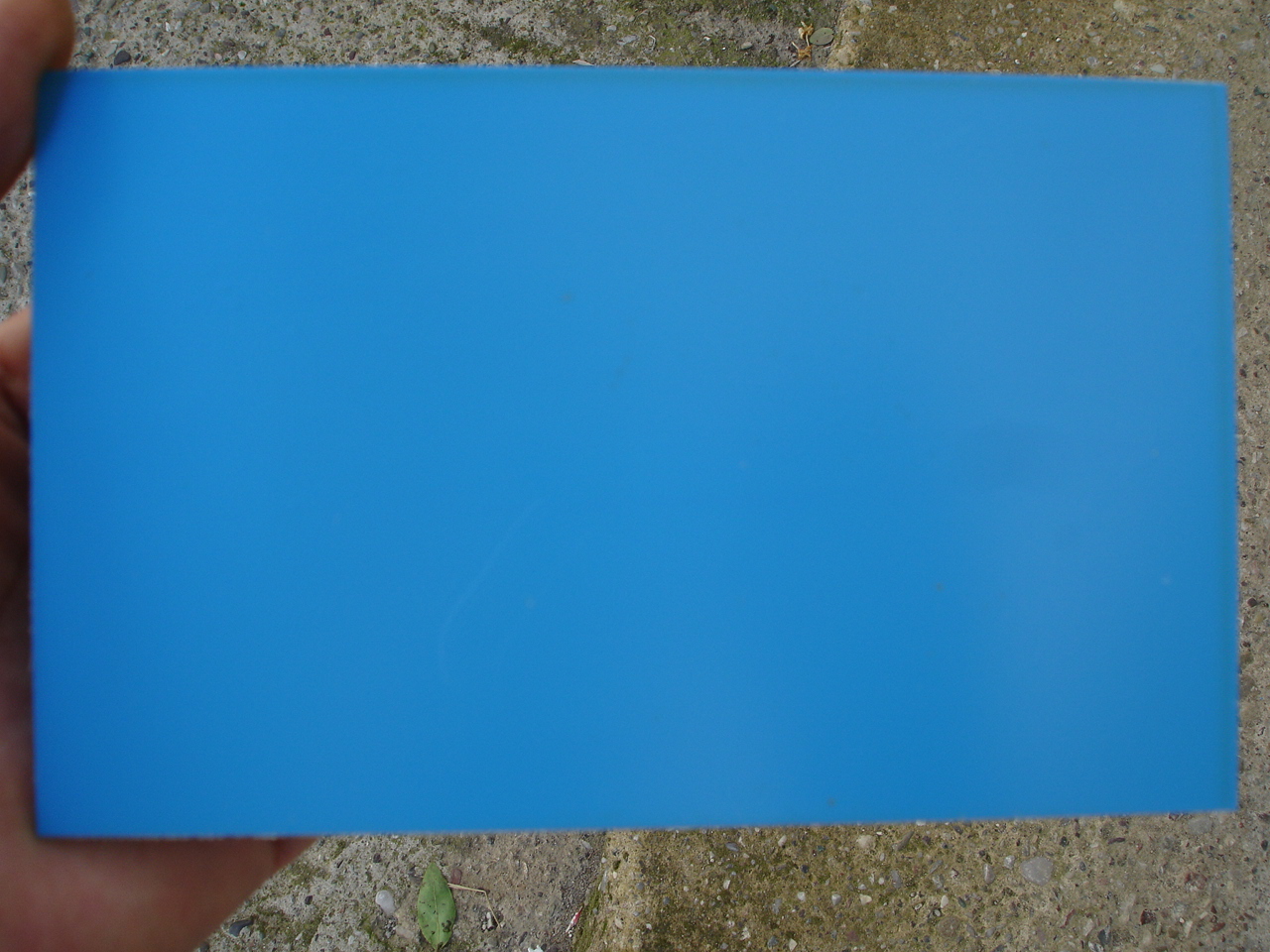

Let's go to explain this.
Firt of all ... special material.Bungard photoresist board.
Second step.A high contrast film (high contrast black printed areas).
This is the most critical and difficult to make.3 options available.
1 photographic film ....difficult
2 photocopies in transparent film ...easier ....but this method give good results if transparents are high quality .We must use color transparents and color photomachine but we must print in black&white.
3 The easier and most cheep method. We must print on non-extended rice paper with a laser printer.With this method black isn't so black but we have the way to resolve this.
We must spray this non-extented rice paper with White Spirit.Now it's time to dry it with a hair dryer.
Now we have a high contrast Black&Withe film.

Exposure time is critical.In my case withe rice paper is 4 minuites
After the exposure it's time for development.
We need 9 gram. of caustic soda in 1 litre water.
Development time isn't so critical.If exposure is right we must see photoresist go out about 3 or 4 seconds after .
Attention......all photoresist must go out,3 or 4 minuites is ok.
Now wash pcb with plenty of water.
The final step is pcb etching.
There are many materials .I use Ferric chloride from bangurd.
Tryk .Put pcb in 45 angle and wetting with chloride continuasly.
When all is ok wash with plenty of water.
Attention. You must use gloves and glasses.
Good luck,
