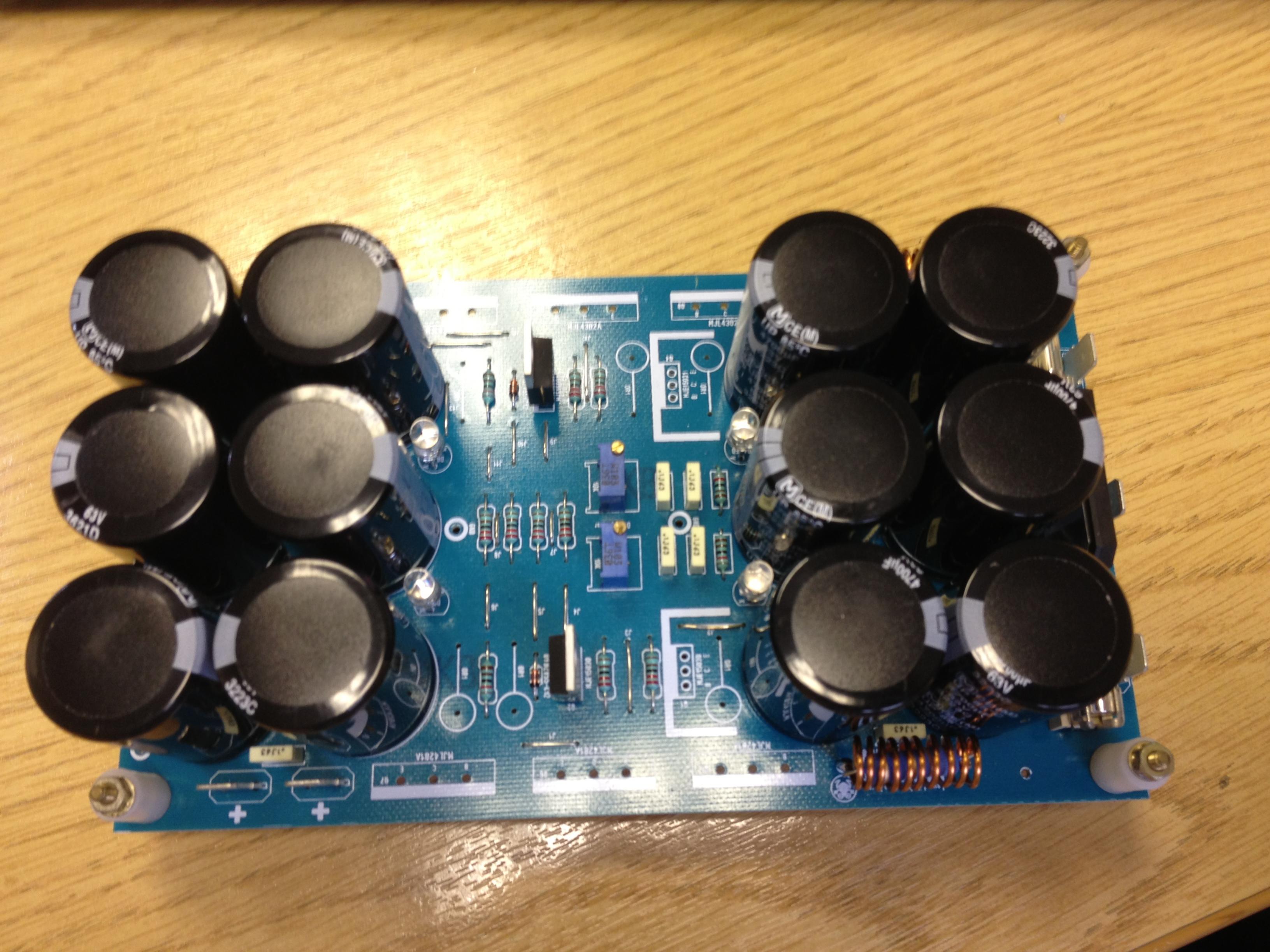

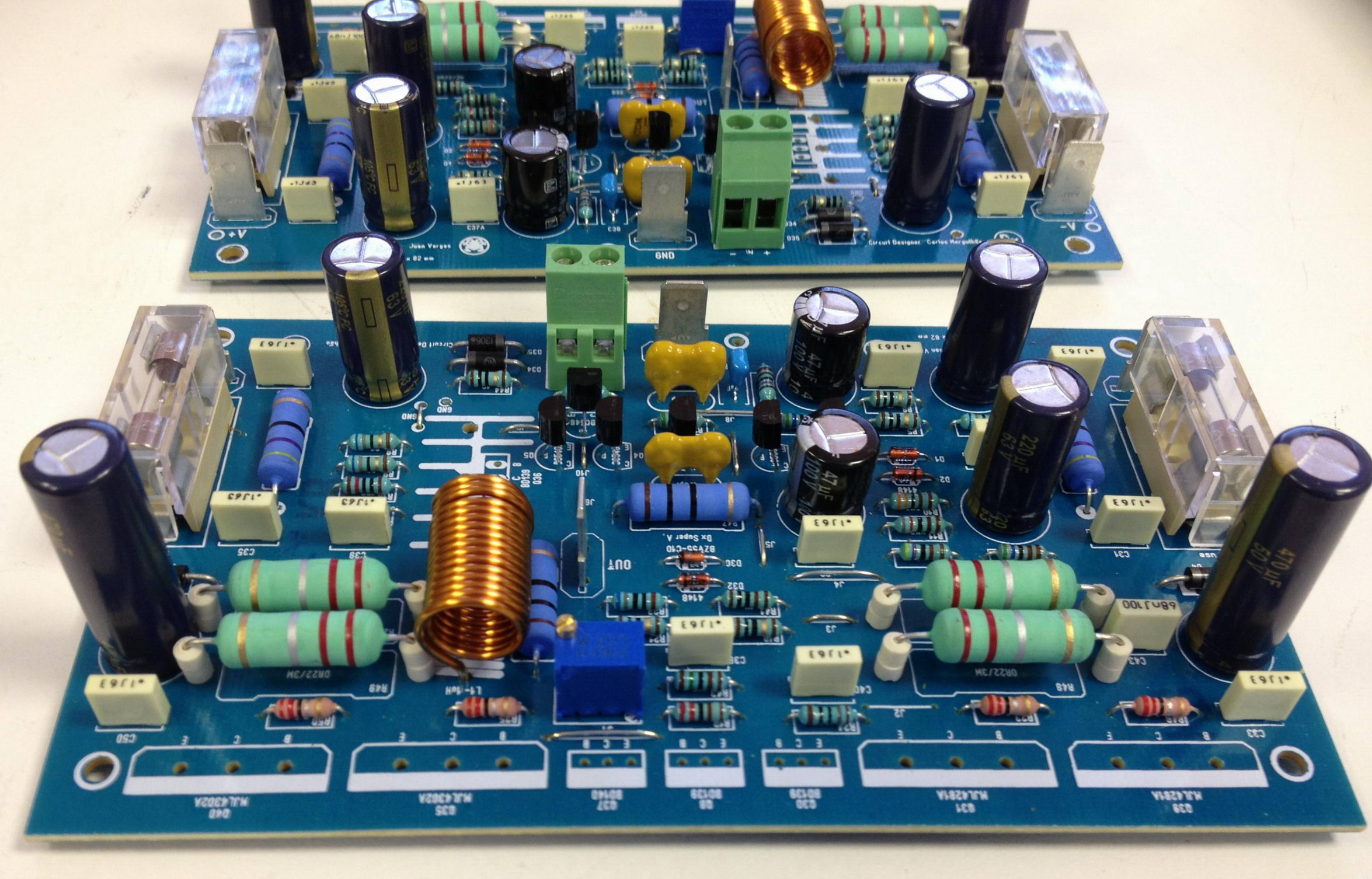

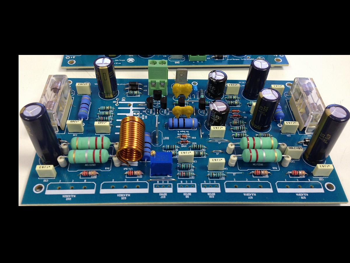

Hi Juan yes I used the same seller that's why I'm still looking for a supplier here in the UK I have all PCB's fully assembled apart from the VAS transistors and output devises on the amps and the series pass, driver transistors and emitter resistors on the PSU now there made I want to see if they work. 🙂

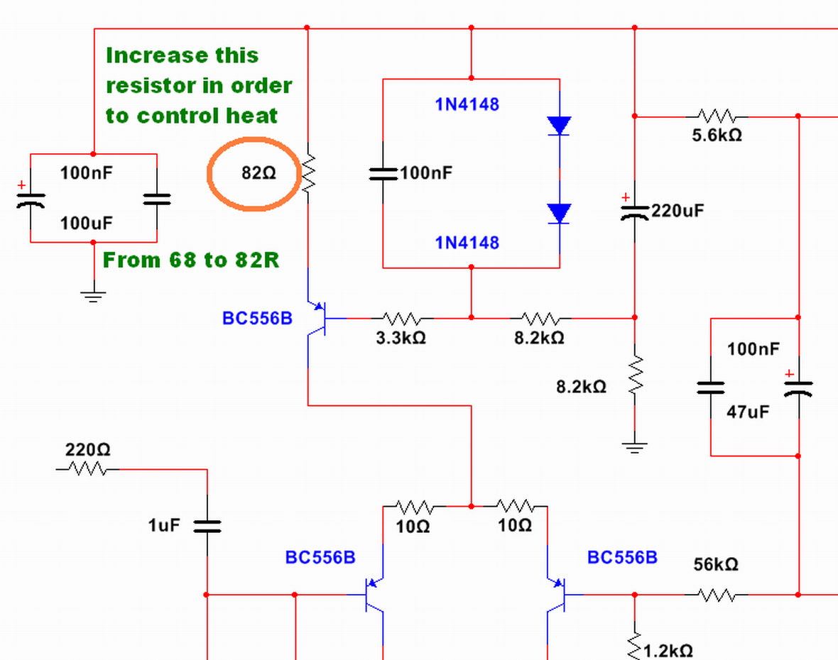

I was simulating and you can reduce heat replacing a resistor
The one controls the CCS current.
This gonna be more effective..then you can keep BC556 because it is 500 mW unit (twice the power it is dissipating) and the advantage to 2N is not that big.
I have watched datasheet from 12 manufacturers and i found 2 of them that can hold 650 mW..others are 500 mW.
regards,
Carlos

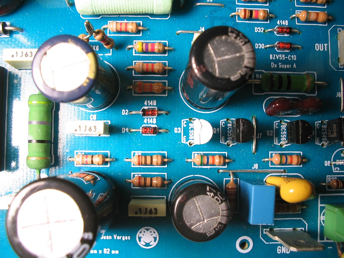

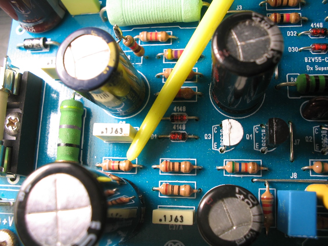

OK so I went back and installed the way it was a before a new BC556
and I change R4 to 82R as you can see in this images the transistor with the white paint on top just to remind I did change it, and I pointed to the resistor too 🙂.
Here is my part number BC556ABU 500mW of dissipation
Regards
Juan

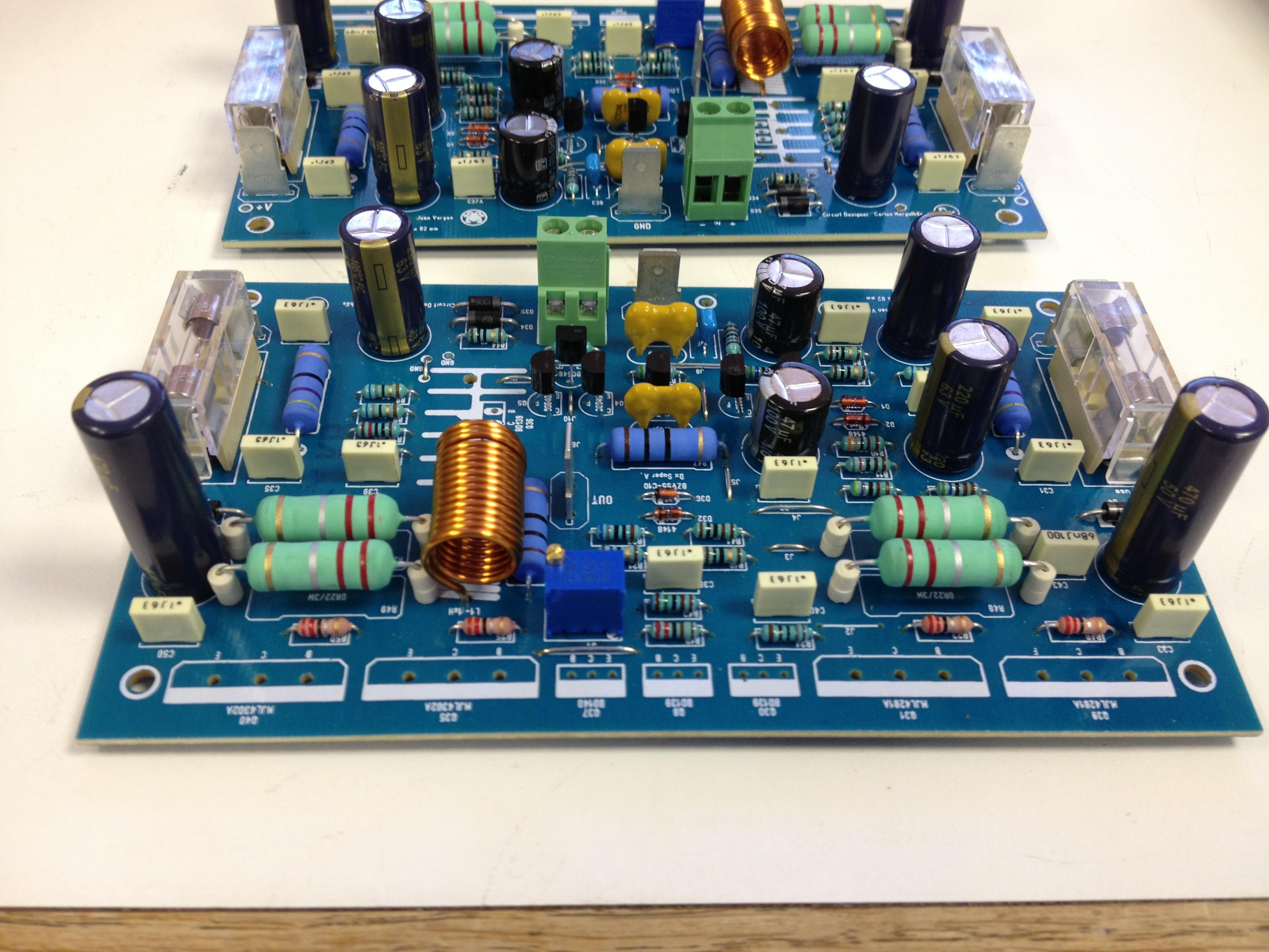

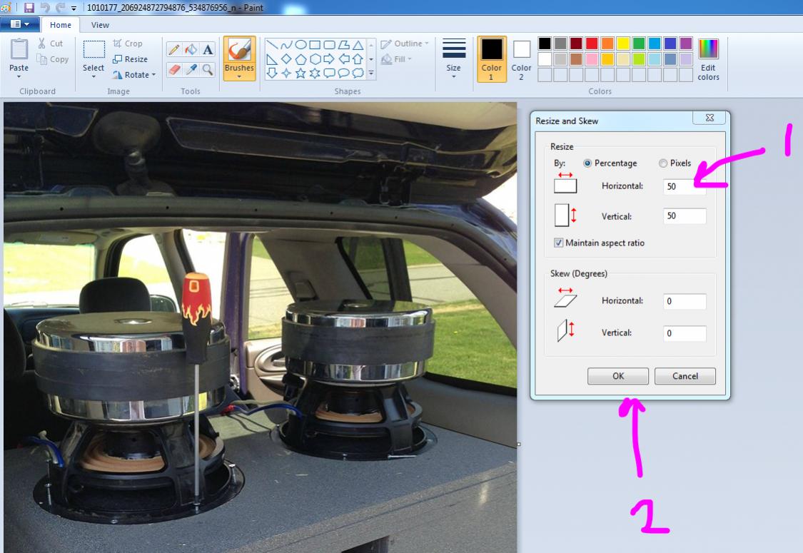

Hopefully you can now see my amp PCB's but I still need help on how to make files smaller??
Hi Earthquake 🙂
I usually when I take pictures I open them with paint then reduce to 50% so the file can be upload faster and also have just the right size but wow my man Earthquake you did a magnificent job amazing build 😀 all look good neat
Regards
Juan

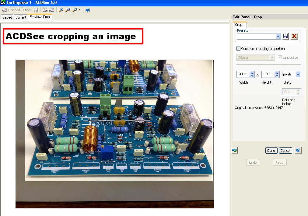

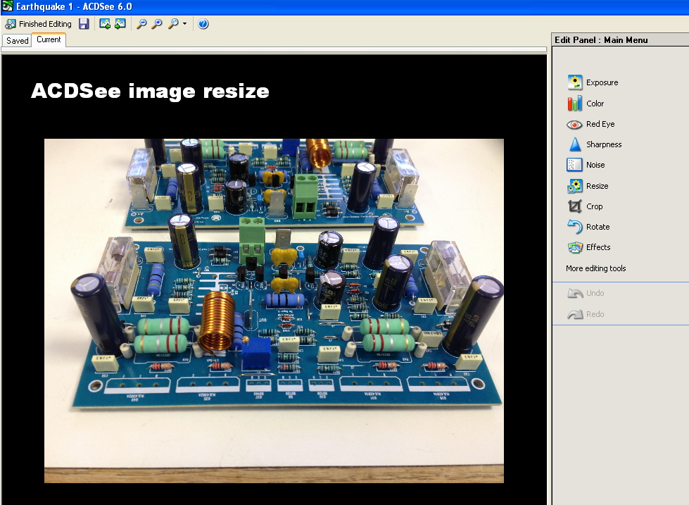

I do appreciate the ACDSee software.
using it these last 10 years..... i have tried others but this one is really good.
Here you have one image while cropping, one image while resizing and one image as the final processed work.
regards,
Carlos
