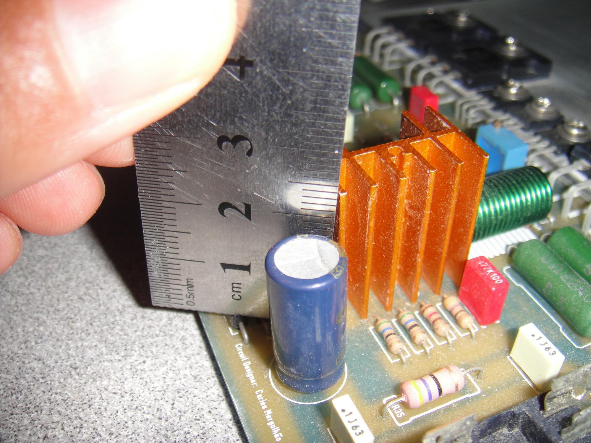

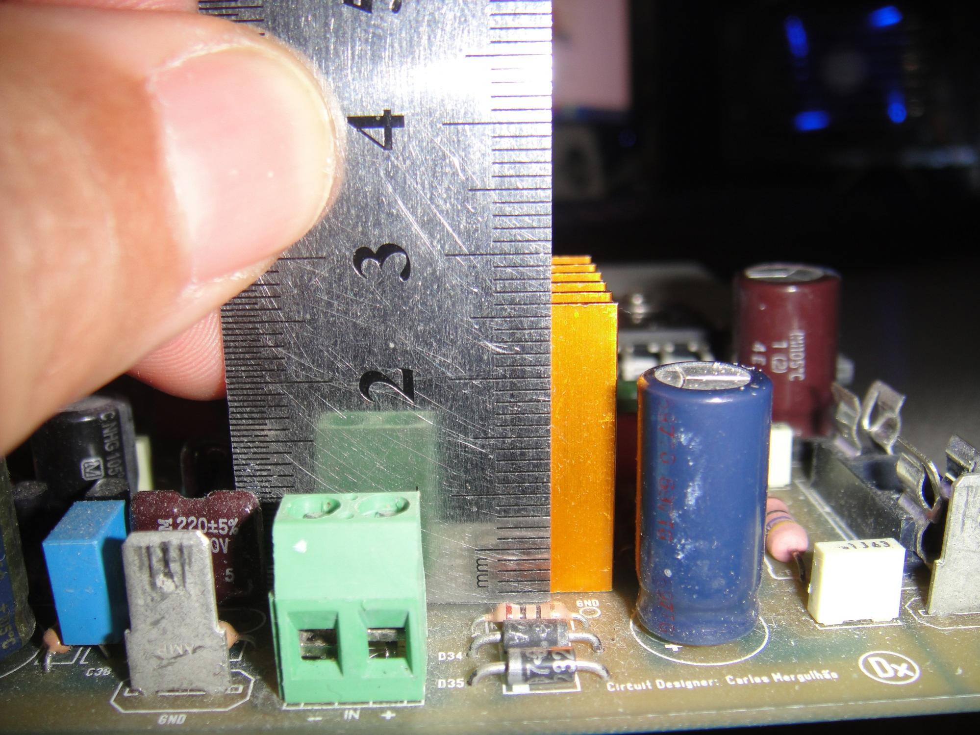

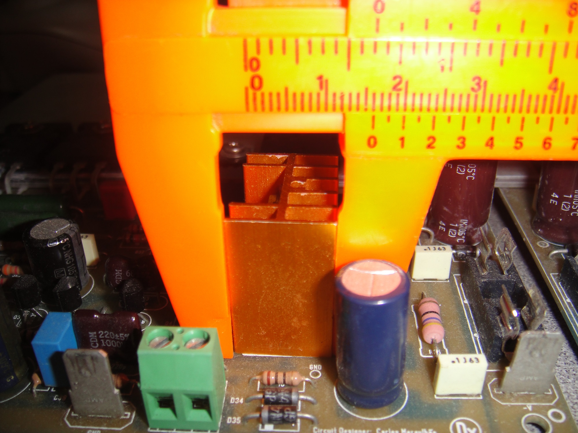

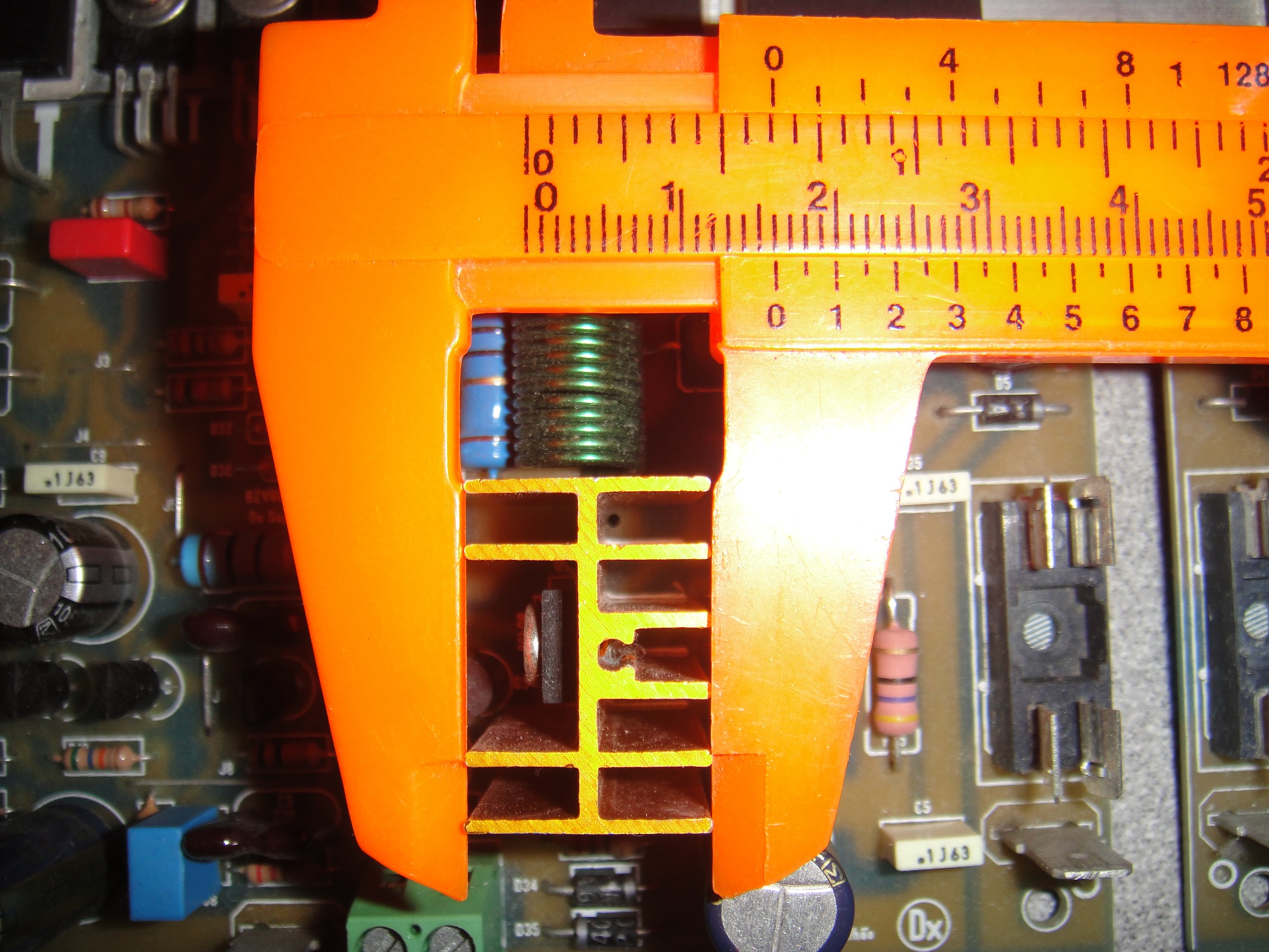

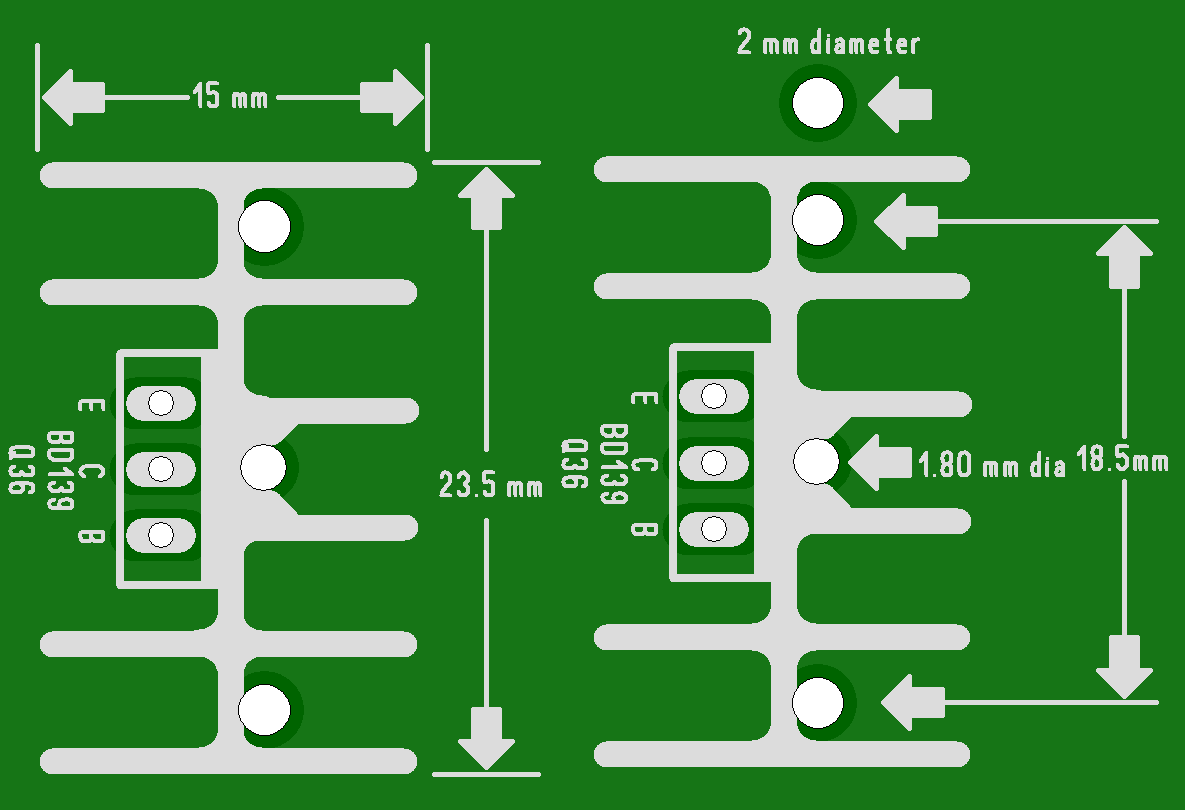

here are some images so you can see measurements I rather have the ones with the leads on both sides of the heat sinks it will be a better mechanical connection into the PCB 🙂
sorry about the dust my room is really dusty "Puerto Rico dust" jejejeje
Regards
Juan

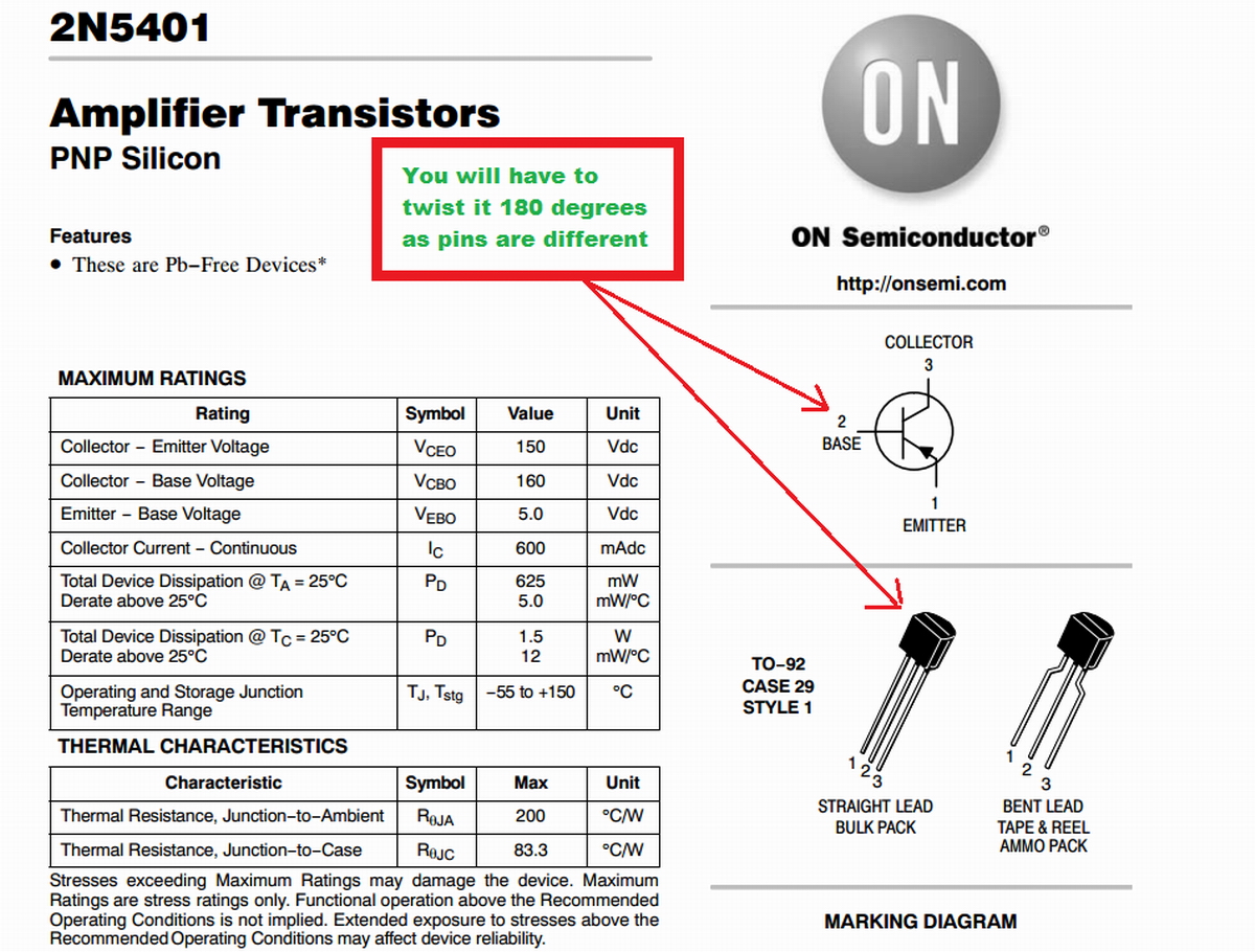

I found the CCS transistor hot.
It is a BC556 and can hold 300 mW, but it is dissipating 240 mW..... so, if you use a fake one may not hold the job.
Having problems, then replace it with a better one, the 2N5401 can face 625 mW...so it can do the job in a much more easy way.
The problem is that pins are 180 degrées out of position, so, you have to turn your transistor 180 degrees clockwise or even counterclockwise and insert them this way while watching the reference on the circuit board.
Thanks to Terry that made me watch this transistor once again.
Sorry folks...BC556 is now wrong there...but it is too much into the limit...so, if you hold a fake one..then it may become damaged because of heat there.
Other option is BC640, the one has a BD140 semiconductor inside the small plastic case...so..it is a BD140 in another dressing and can face 1A...but pins are much more crazy.

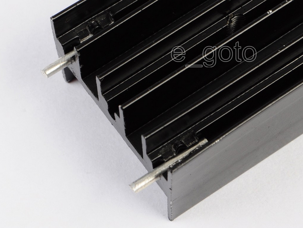

The ones I bought are almost identical but with two less fins. Search ebay for
"5pcs Heat Sink 23x17x30mm for L298N ZIP good"

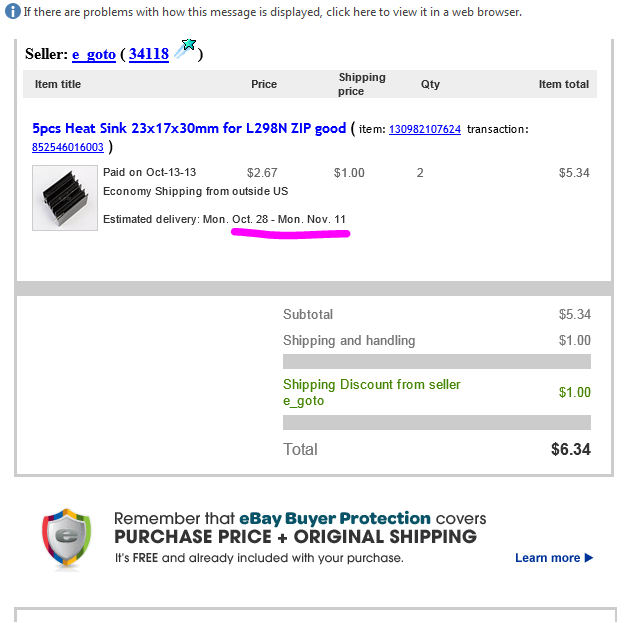

Thanks Terry/guys I have just ordered some as well but I will also try and find a supplier here in the UK because I don't want to wait 3 weeks for them to arrive from China I only have to fit the VAS and output transistors and the boards are ready to test.
Most BC556 manufacturers specify 625mW. Fairchild specify 500mW.
The 2n5401 is basically the same @ 625mW (as stated by Dx).
Swapping to 2n5401 achieves nothing, except a slower and lower gain transistor.
Yes dear Earthquake I already made that mistake I order them from China it will take for ever to get here in Puerto Rico :bawling: ahahahahahahahah !
