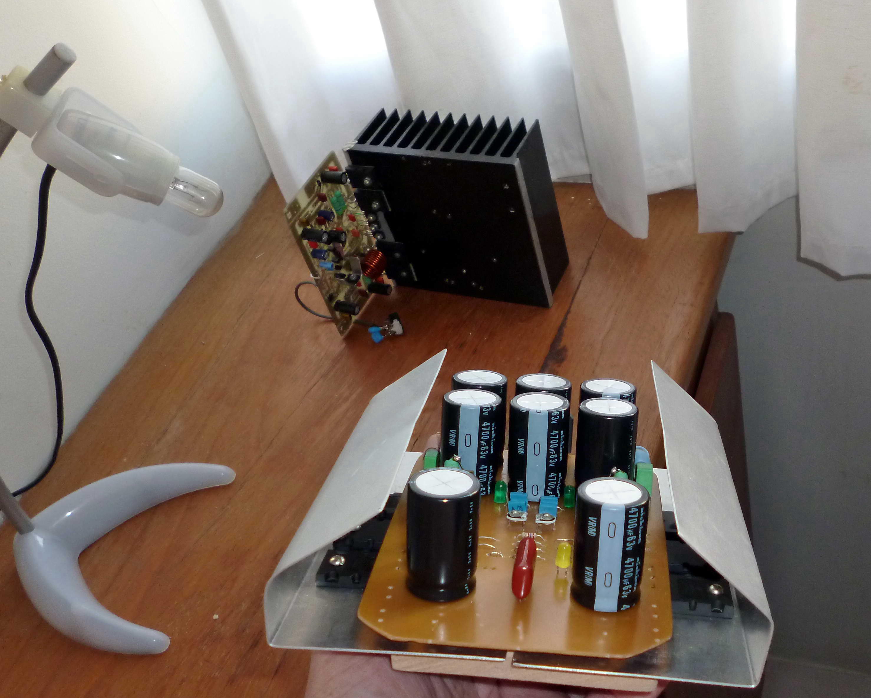

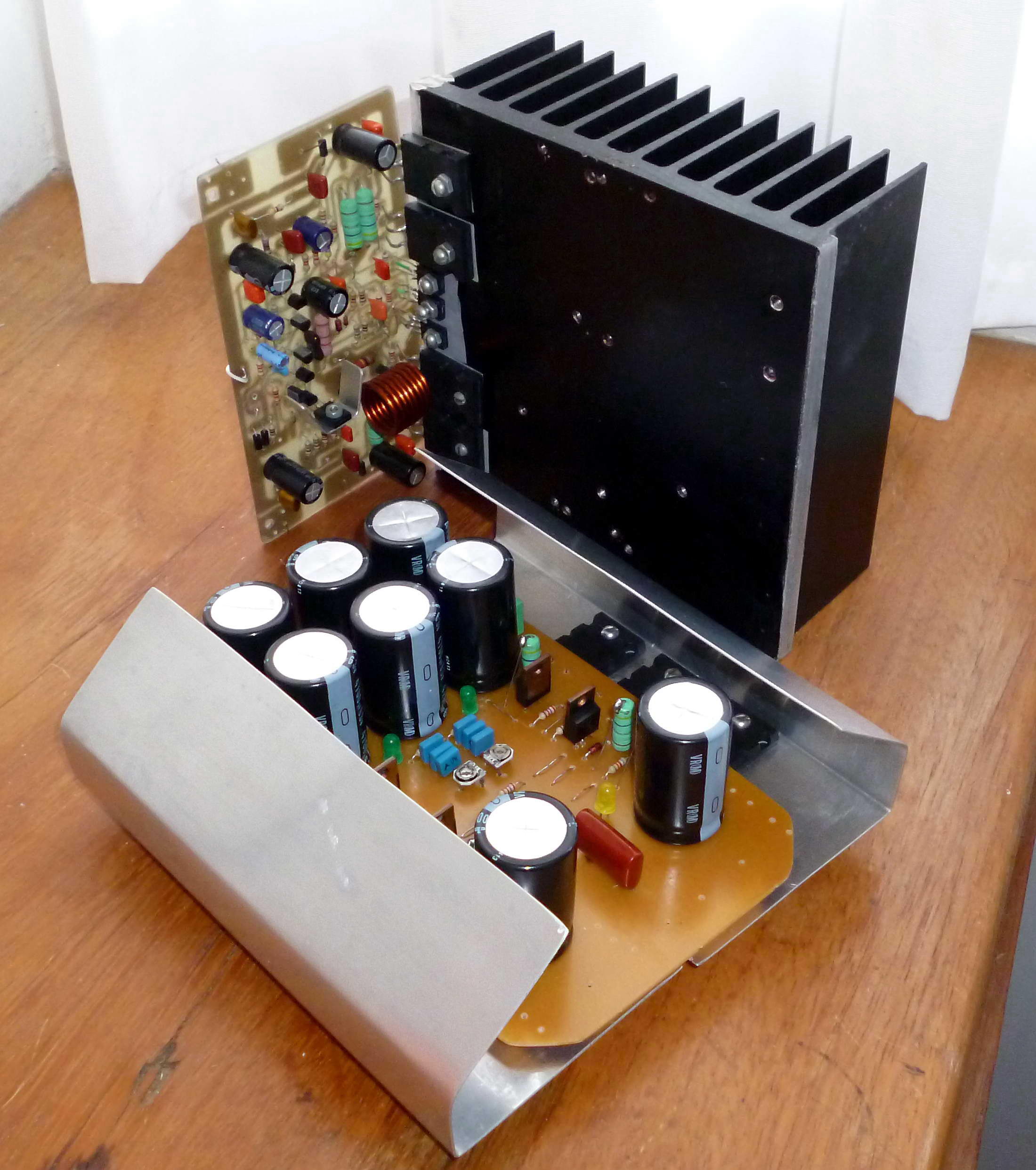

Here you have some more...but all mine own prototypes
I really work hard...when i see the many times i have assembled for test purposes i can see how obsessive i am to check the stuff.
My god....i see i am a little bit sick!
The one with wooden base, the MDF with dark brown cover surface, is good in size to feed two channels at 2 ohms...half of that size to 4 ohms and 1/4 of that size to 8 ohms.
But this is when you have 5 volts from colector to emitter...if voltage is different than that (input voltage), then the heatsink demand increase a lot.
The biggest one was tested with 65 volts in the input...but you see that is too much big...this way, with wrong voltage in the input, you gonna need a dedicated enclosure to the power supply...an overkill.
We are developing a Switching Power Supply....it gonna be available after December (I hope) when we gonna release the Armagedon..then the size will reduce.
SMPS is a problem...we are trying to shield and to filter the way we need..also to increase frequency in order to avoid the amplifier to be interfered by the oscilator frequency.... i hope we suceed...but this is a big challenge for us.
regards,
Carlos

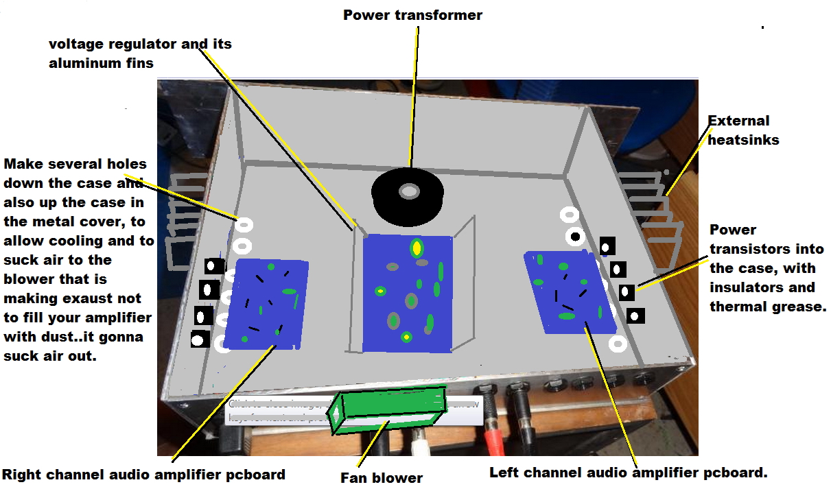

No, they are small....you can use your aluminum enclosure
As heatsink...install pcboards in the sides..internally naturally, and use a fan blower inside or outside the case to suck air from the internal to external.
To do that you must open holes with your drill bits down the heatsink to force an air current or convection too...also holes upper the case or heatsink.
This heatsink i can see is really small..not good to 8 ohms and one channel.... many times no good for one channel at 4 ohms and extreme small to operate 2 ohms.
Attach this one and other one if you have, outside the aluminum case, as side heatsinks..external side heatsinks..and use thermal grease where you join them with the aluminum enclosure..the same way you use white (yellow in states) wooden glue to attach wooden panels.
With a fan blower sucking air.... with power transistors at the enclosure sides..with holes down the power transistors and up the power transistor..and with the heatsink or heatsinks externally, then you may face your transformer power.... the 500 watts transformer can put out maybe 350 watts rms of audio.... 180 to each channel aproximatelly.
Man!..you imagine a strong amplifier.....you gonna felt down from your chair...this machine is really powerfull.
If not result powerfull, then come to me and we gonna adjust the gain resistor for you to produce an earthquake in your home.

Here you have an idea Terry...but you should do it your own way
This is what give us pleasure..to create our own stuff.
