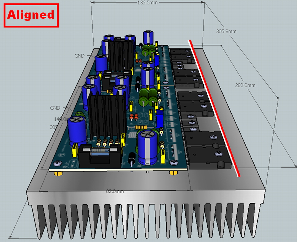

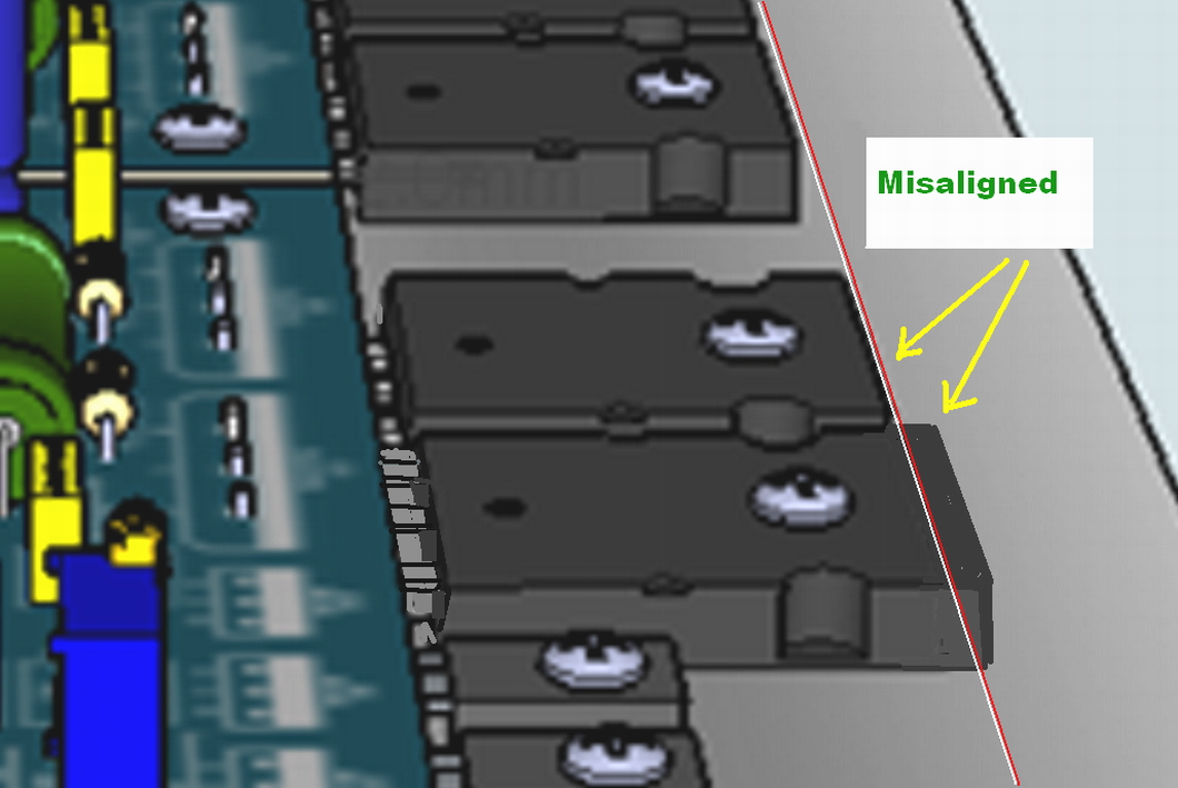

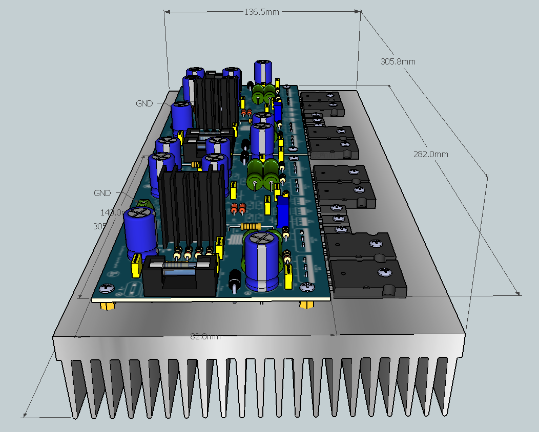

This is how you need to mount the boards to the heatsink. No "L" bracket otherwise you won't have enough room to fit everything in the case!

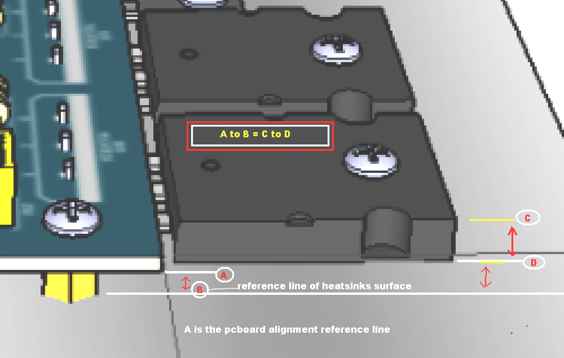

This looks good... i like it....but, we are not using double side pcboards
you have to solder below the pcboard....so...you have to align the leads to do it.... often these lead's high become misaligned...or small the distance or big the distance..then when you attach the pcboard support, stand or feet, you will force and detach the copper tracks.
The way you have is to put power transistor without solder it..and then attach the pcboard to the heatsink and also the power transistors...now..aligned..you twist the power transistor leads, inserted from below and appearing in the top as an excess of leads to be cutted out..... then you twist it in 90 degrees to have a reference to dismount the whole stuff and solder.
You see.... the problem is to solder when we cannot introduce soldering iron below the pcboard...maybe hot air or other method must be used.
Yes, you can use transistor dimensions as reference touching it below the pcboard..and soldering this way...but board feet (spacers) must be precise or you will force the copper to detach...if you solder transistor first and attach the whole thing to the heatsink you will face troubles....if you do not solder transistor you also gonna face problems.
Well... hard to explain using words when my native language is not the english...maybe i will have to make a video to explaiin what i mean IF you face troubles to understand me...please..let me know if you understood the trouble and if you have some clever solution...i really do not have the clever solution.
the problem is that you cannot solder power transistors before you fix the pcboard to the heatsink..because they gonna be misaligned...also you cannot left unsoldered...this is the problem.

Hello Carlos,
Suggestions:
1. Make a piece of aluminum plate (6mm or so), drilled with the same mounting pattern with a cutout area for access to the transistor soldering area. Solder in place and then transfer to heat sink. (You could also use this for troubleshooting)
2. Mount the parts in place and glue the transistor leads that stick up through the top side of the board. Then when they are fixed in place, remove and solder, then remount.

Not sure if you misunderstood me or I am misunderstanding your reply.
By plate I meant substitute plate for soldering only.
Picture is worth lots of words.
(or at least a drawing in MS paint is)
Should not be too hard to make...same drilling pattern as heatsink.

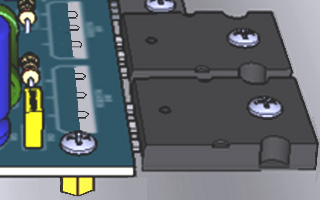

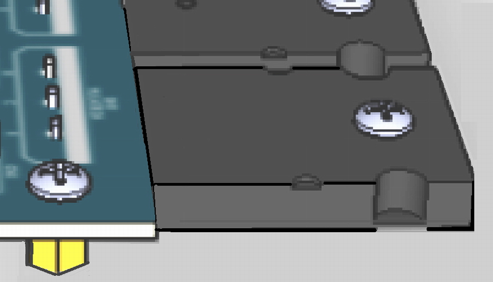

Yes...i got what you meant..... it is good

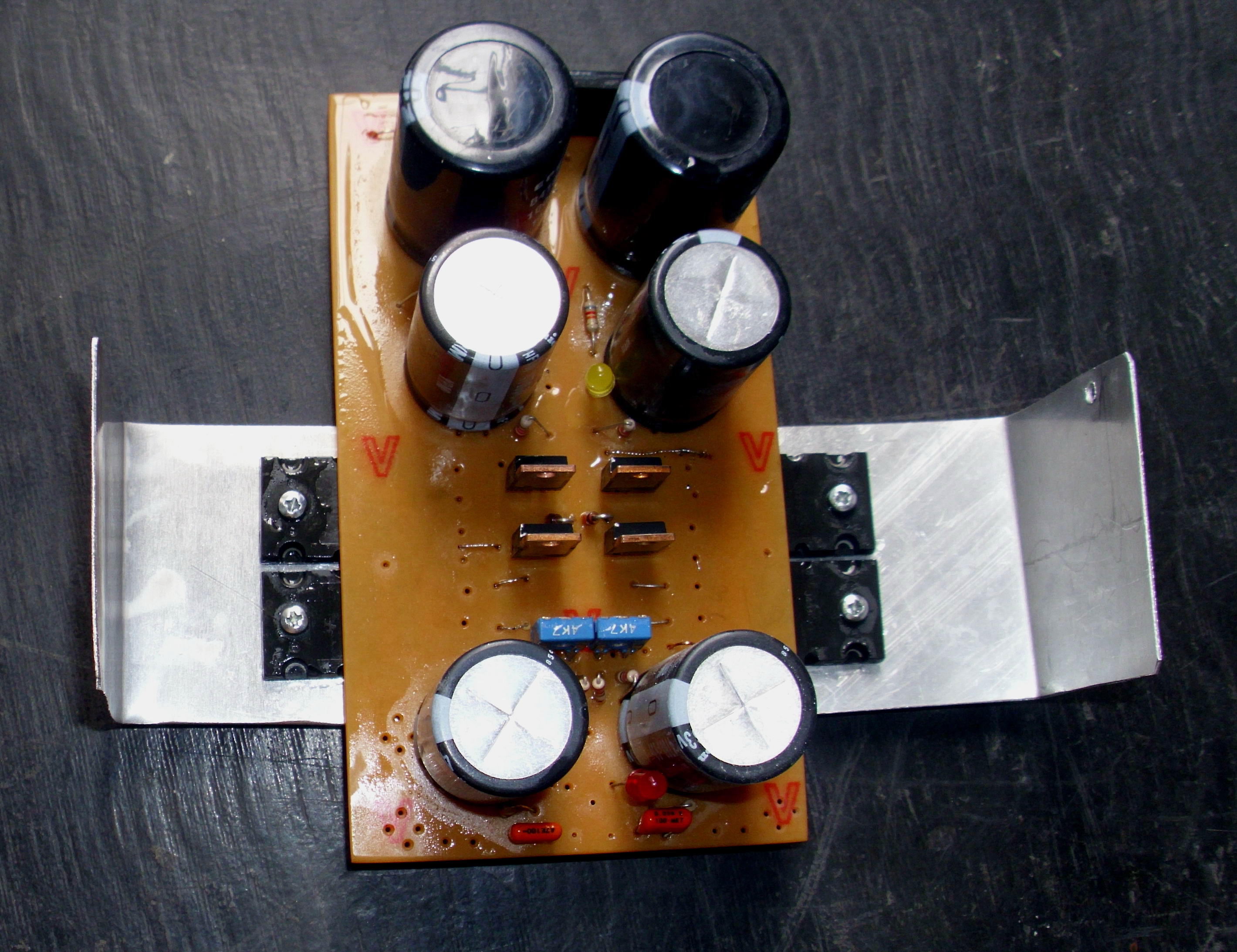

But i was thinking to put transistor below the pcboard..this way the transistor case gonna be the reference for the spacers we use to attach the pcboard into the heatsink...the yellow ones connected to the screw.
See the image...transistor goes inserted below the pcboard..this way you can solder then we cut the feet, the support, the tube that supports the pcboard and receive the screw inside, the same length as the the transistor high.
Got it?.... man.... i have no words....my english is really poor.

Pictures explain very well.
I have done something similar, but not quite that close.
Idea:
On that edge of the board, don't use standoffs. Just let the transistors support the board.
Then there will not be a conflict in height.
You will still have to clamp the transistors to something to get them aligned. This will be more critical now that they don't have the lead flex that they did before.

I usually mock up the whole setup without soldering power transistors,
just bend legs to fit them perfectly.
legs end up with z bend, first 90 deg forward, then once i got distance, bend flat onto pcb surface.
Then remove pcb from heatsink with power transistors and solder power transistors with pcb removed from heatsink, but perfect bends so they fit right.
Now with power transistors soldered to pcb, I now put heatsink paste and insulators below transistors and fix them to heatsink, after that i just tighten screws to hold pcb to stand-offs.

Yep... this method works good too...i use to bend
the same way you do.... we have to adjust a little after soldering..but works fine...but if we do mistakes..then the copper track will detach from the fiberglass.
Same way Vostro...this is what i use to do....but not so perfect... sometimes if fails in my home.
I will use the transistor below and will not use supporting feet...it gonna be lift by the transistor leads...maybe a rubber glued to help to stabilize the pcboard.... one single rubber support inserted into the screw hole and below the pcboard...this is what i gonna do myself.... but now, becasue your suggestions.... yours and from Dug, people has more ideas to decide...this helps a lot...thank you very much Vostro..even in the other side of the fence you helped a lot.

If i understood correctly..this is the way Vostro suggest
This way is good..but sometimes you have to adjust bending the transistor...leads must be long to allow you to adjust..also you must insert the same length not to have transistors misaligned.

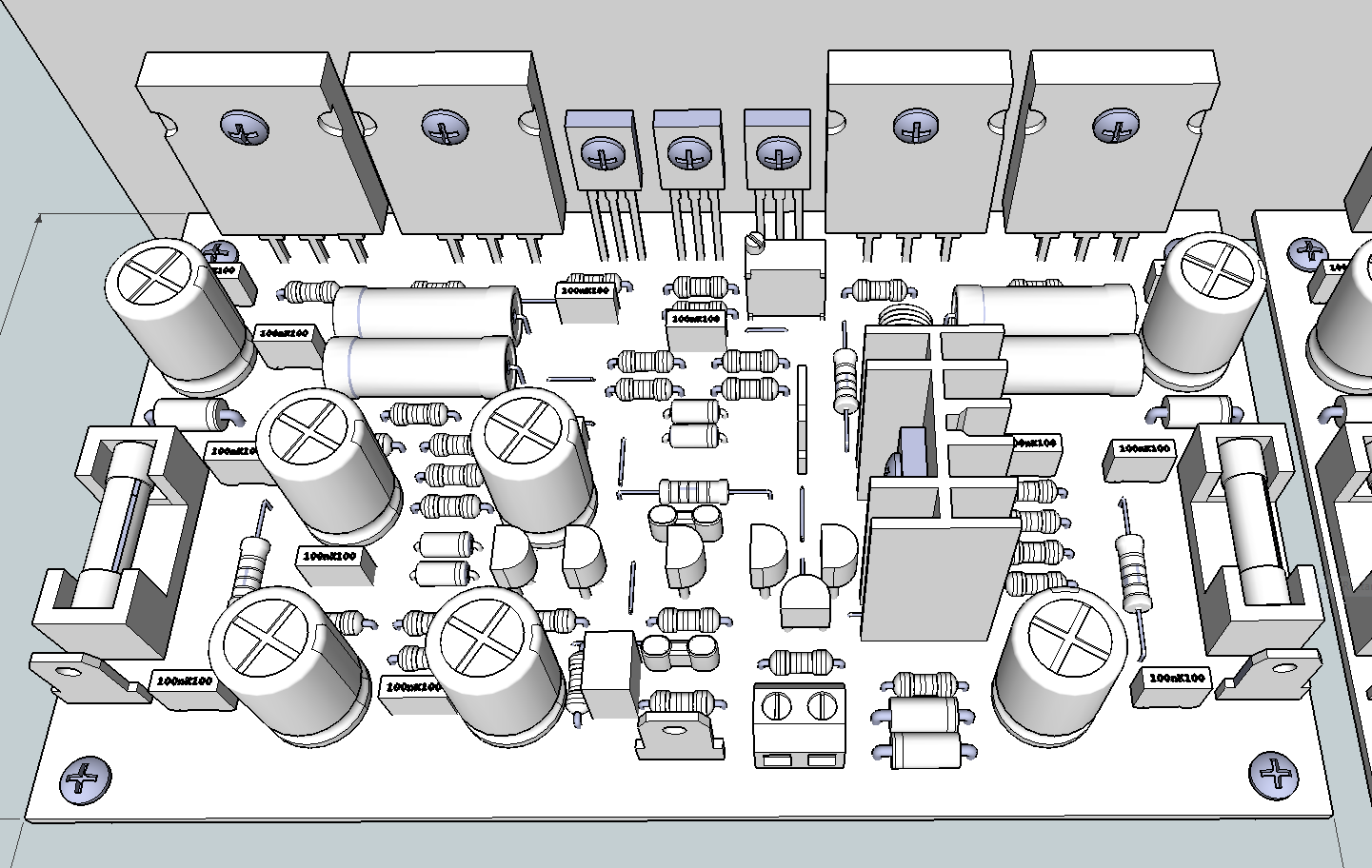

Hello guys
I was comparing my simulation to the real thing it was almost as I thought how will look like and I feel really happy with the results, (...)

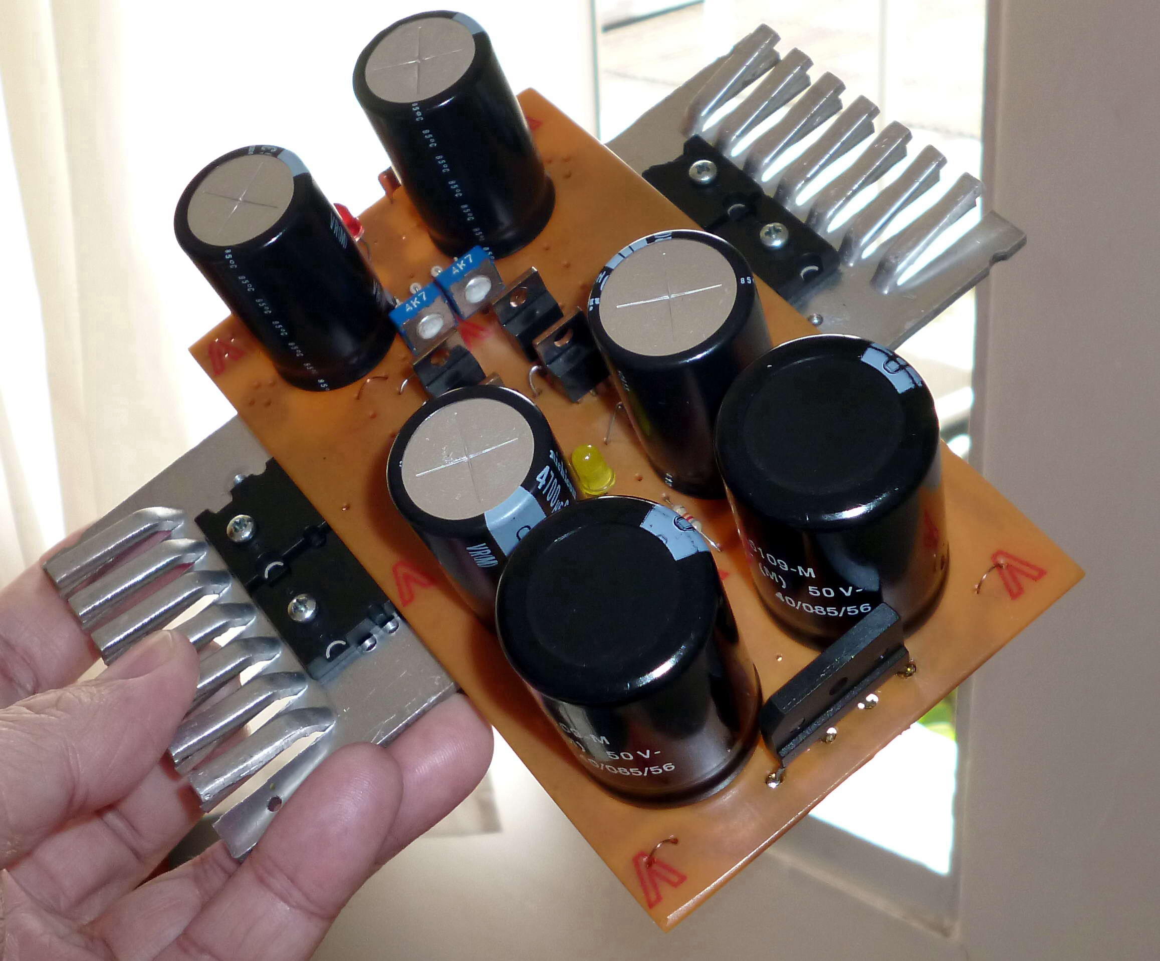

Here you have one that i have saved.... a rarity, because cell phone...very bad picture...you can see at the bottom the aluminum in U shape.
These boards are the first batch made to Brazil...the new ones are different and better compared to these ones you see..... even Juan has two models..one with transistors to use "L" shape adapter and other without the "L" shape adaptor
