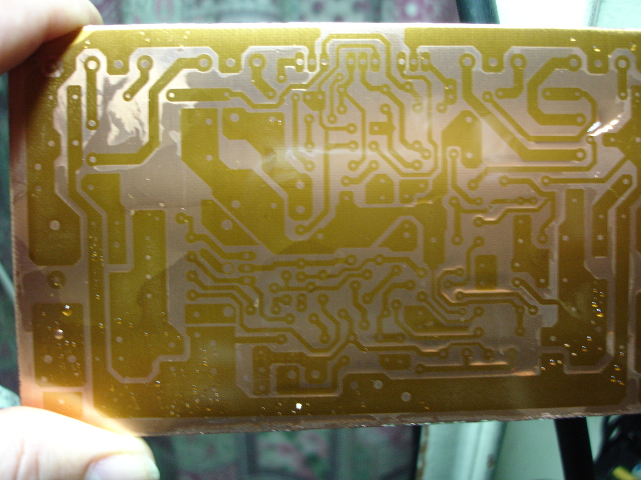

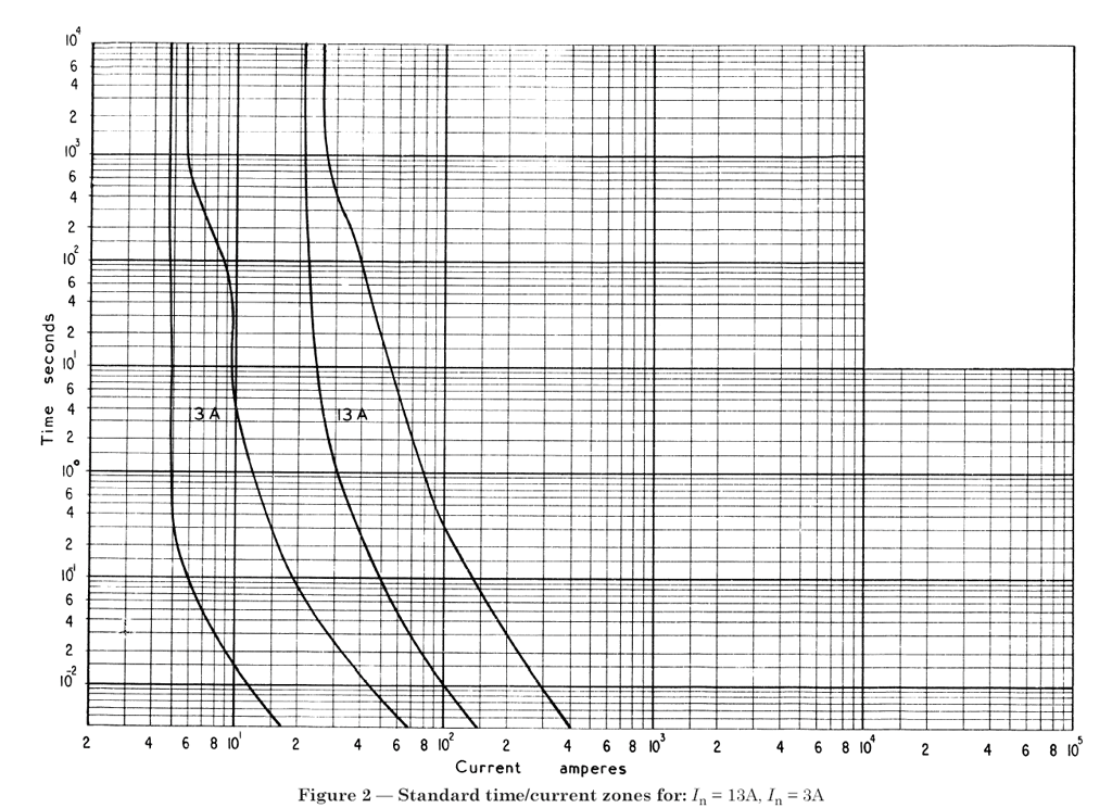

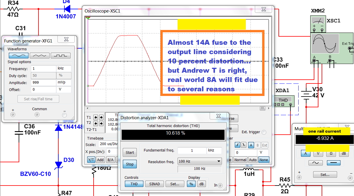

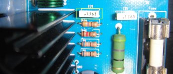

If we assume 42V rail and 6Ω speaker Re there will be 7A current over the fuse during a maximum DC output fault. 10A fuse will never blow during such conditions.
Much better to fuse the rails as fuse current rating could be halved. Rail fuses only take half period but the whole DC fault current.

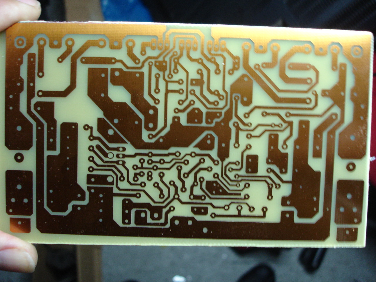

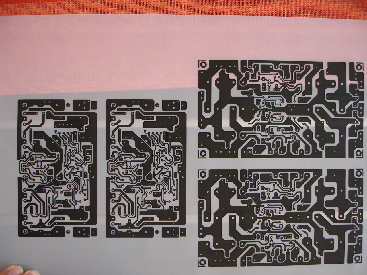

Very nice thimios...hand made is very good
The real DIY spirit.
Your home etching resulted very precise..... congratulations...mine ones are worse.

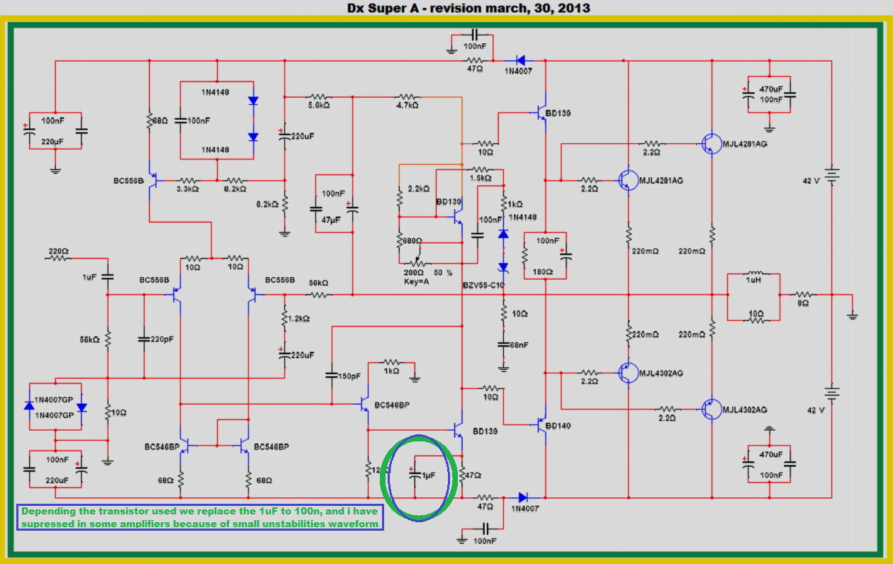

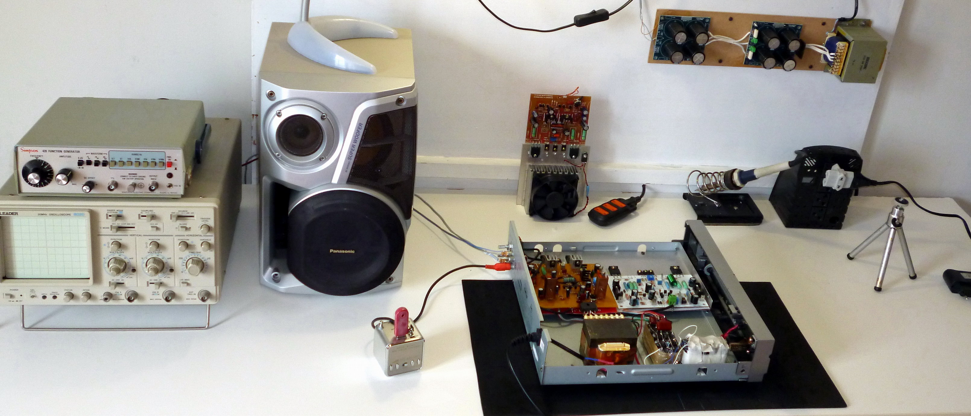

I was observing, there's a modification in my circuit...while testing the Biamp i found that....i do think i have posted something about...cannot remember.... memory no good anymore.
Dx Bi amplified mono system and much more! - YouTube
regards,
Carlos

Thank you very much Sir.
I have spent many hours and much money in handmade pcb.
Now i'm expert in handmade.
