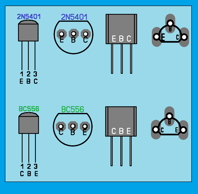

I have found that BC546/556 results better in sonics
It seems to me they are more linear to be used in audio amplifiers powered with 35 volts supplies.
I do suggest you to try, but be aware that some boards where made for 2N5401/5551 (Supercharger blue boards) and the transistor lead identification is different.... to install a different transistor, or switch from 2N to BC transistor you should twist 180 degrées related the silk screen reference drawing.
See the image and be carefull about that....i am sure you will like the result..but this should be made only with 35 volts supplies (Dx Blame ES and Dx Blame ST and MKII (low impedance one that uses 35 volts)).
Thank you Vargas Mongo, as you provided the image for us.

Might want to use the BC550C/560C pair, they're the low-noise variant of the 55x/56x series, they have a Vceo of 30V if I remember correctly, which you can reduce by applying a series zener to help dissipate and get Vce voltage in a suitable range. The 546/556 are the higher Vceo variants at cost of a bit more noise.
More noise maybe only on paper. I am sure your ears would never pick up. I would recommend building dx's amplifiers exactly as is shown on his schematics. Carlos is famous for producing the best bang for the buck amplifiers out there. Using readilly available components you may have lying around such as the bc556. I am certain the results will blow away many more higher cost amps which house boutique components inside them. You can all go buying hugely expensive and hard to procure caps, resistors and transisters etc but you will be the one embarrassed at having to spend more money then average Joe next door whose amplifier will sound the same to "human" ears.

The sound differences experienced between components is easily explained,, it has nothing to do with magic, religion or transistor physics. It has all to do with engineering decisions. Carlos you miss the point a bit by stating they are more linear, this is not neccesarily so, here its a simple matter of correct or ideal part for the application.
Ive already explained the theory regarding the LTP transistors in another thread. See here http://www.diyaudio.com/forums/solid-state/206801-hfe-question-2.html
Posts 11, 15 ,19 ,20, thats the reason the BCs are better that the 2n devices (this applies to LTPs only) and you can read the sound improvements the builder experienced if you read the rest of the thread.
As for the BDs the main reason they work so well is again easily explained according to theory. They are fast, very fast for a part that can handle the current they can. As drivers they excel as they have very low Cob and Ceb capacitances. These parts are basically BC639 TO92 parts put in bigger package for higher dissipation, take a look at that datasheet and you get all the info the BD datasheets lack. Carlos is right about using the BDs as drivers, they might be long in the tooth but long live the BDs.
In the vas position they are also no slouch for the reasons already explained although here you could do better with specialized video transistor parts like 2sa1360, 2sa1380 ect.
