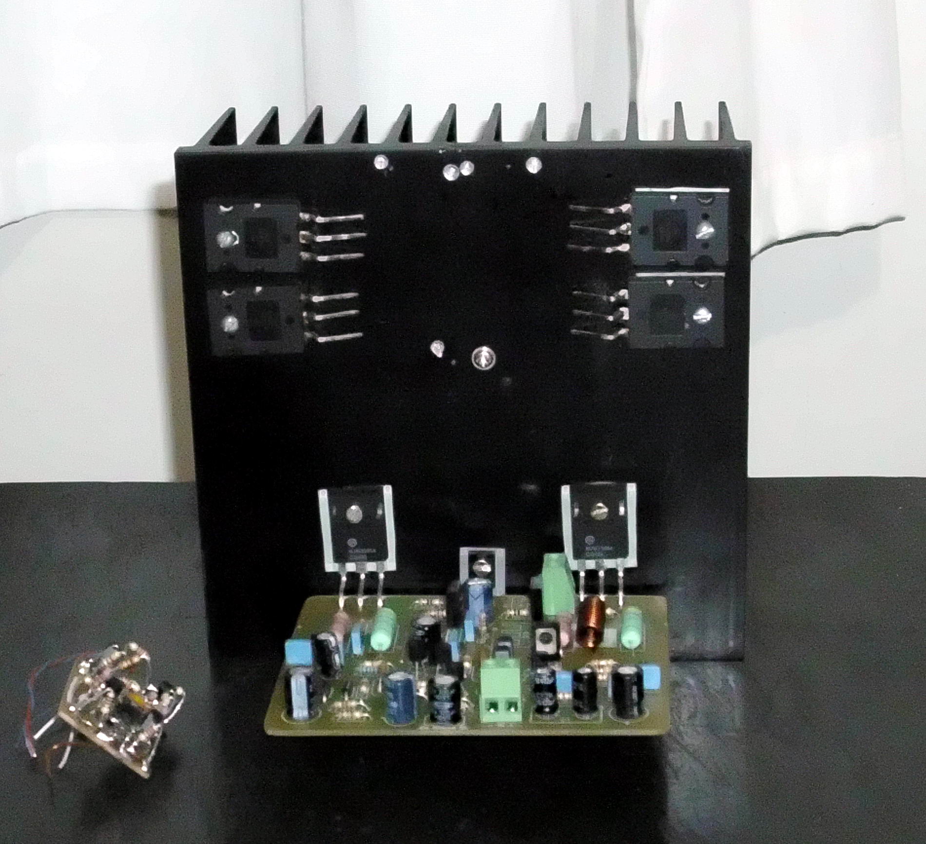

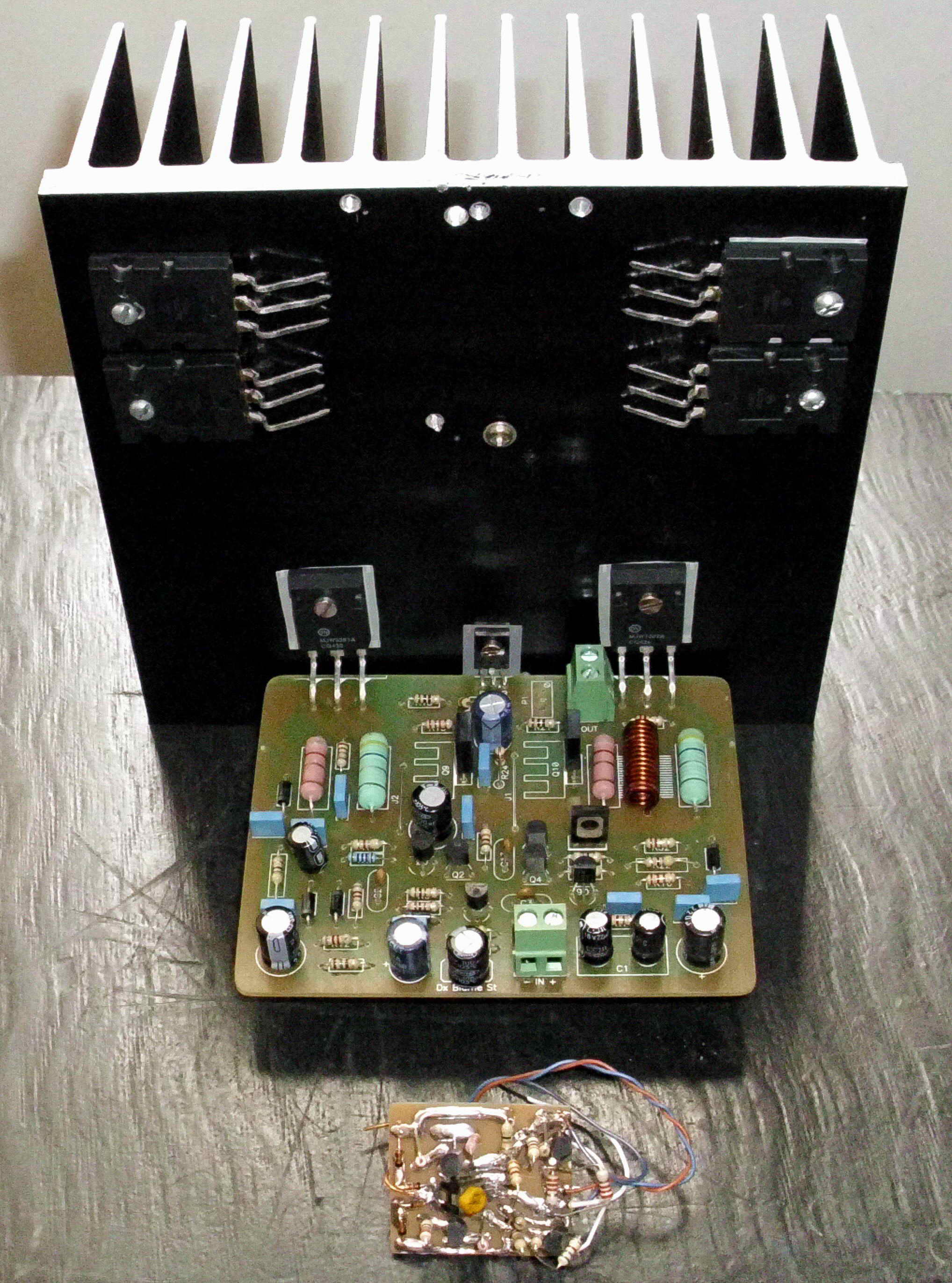

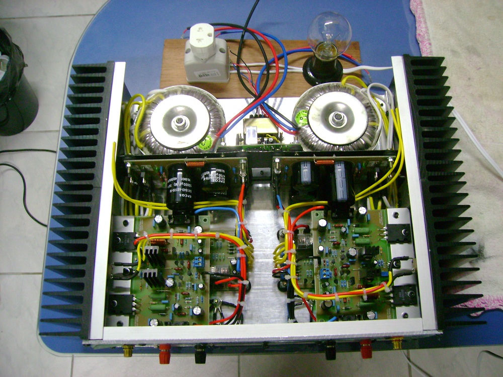

Approved the module Super A to go together the Dx Blame ST
Stand by current was set to 350 miliamperes....i am using 20 plus 20 volts supplies....here you have a video about:
Dx Blame ST, Super A approved! - YouTube
regards,
Carlos
regards,
Carlos

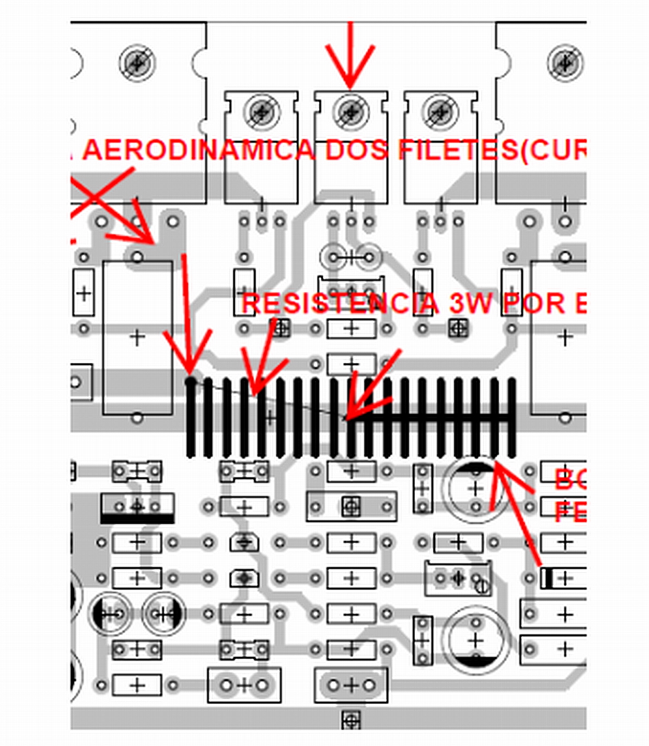

Thank you Simon .... i am preparing together Herman a much better pcboard
That gonna be used to the new Dx Turbo (new Edition to July 2013).
It may be released earlier because the DxXs (Excess Amplifier) ....based in the Dx Blame ST but hard to kill .... almost undestructable.
I am working on it right now.... 8 months developing a pcboard to be perfect.
I cannot show the entire pcboard....super symmetrical layout.
Ahahahhaha!...Herman is delirant about copper tracks aerodinamics profile.... we talk about weight distribution and how this thing would float on watter ... unsinkable alike Titanic

I'm sure that does not inspire confidence in your boards😛... unsinkable alike Titanic
-Byron
Titanic had sink..... undestructable amplifier can be destroyed
Yes, for sure there's no unsinkable or undestructable things..... someone can use a sledge hammer on it... same way titanic crashed an iceberg.
But board will be nice... very nice... at least will be a result of many good guys development, that started with Todd Johnson, and then Mitchel, and now a days Herman..... these are step by step progress.
Simple rules that i was trying to be the north to Dx amplifier layout designers was:
- Try to make as square as possible.... avoiding long strips, or rectangular
- Do not worry about wire jumpers, better to have jumper than long tracks
- Thick or large tracks only to power transistor colector and emitter
- Parts not touching one each other, good clearance in between them
- Total symmetry, even having non symmetrical circuit topology
- At least an inch clearance in between output coil and sensitive circuits
- All letters same size, discreet, small, elegant in such way parts wil cover
- All lettering horizontal
- Components values printed instead or together part identification number
- Parts distributed in order not to have empty, unused spots on board
- Output picked in between the output power emitter (people's beliefs)
- The smallest possible power output emitter resistors, to save room
- Lettering exposed in a discreete way, not to look advertisement outdoor
- Several holes to input capacitor in order to builders apply preferences
- Ground copper track surrounding a fixing screw hole for optional ground
- Avoid to use transistor leads as a support for the board.
- "L" shape adaptor to 100 watts amplifiers, and room beneath transistor to fix it in between the fiberglass board and the power transistor back plate using bolt and nut.
- If possible place ground lower, or down the board (reading position)
- If possible place positive to the right and negative to the left
- If possible place the output atop, nearby the power transistors.
- big distance, or clearance in between copper tracks avoiding the creation of capacitors because two plates (or piece of copper tracks) creates a capacitor when nearby... air gap capacitor, one of the best capacitors.
- Avoid one resistor mounted vertically and others horizontally...starting vertically go to the end same way.
- If you face the need for a long track length, then give prefeence to use a jumper instead that long track because they are inductors we must avoid.
- Be aware of magnetic coupling in between parts avoiding them
- Ground plane represents small capacitors all around the circuit interconnecting every component lead to ground... avoid ground plane
- Never use bigger capacitors than the value needed mounted into the circuit board.
- Avoid to install power supply in the same audio amplifier pcboard..this looks cheap...looks the factory is trying to save money...looks messy.
- Install power supply into the pcboard to fill the gaps of empty sites that
happens in long strip rectangular pcboards.
These are the basic demands i always had.... as i am too much lazy to learn how to use layout design software (I do not like them too) i use to ask people (that loves to do the stuff) to apply their skills and to join the Corporation (Audiophile Union) .... but was always a struggle to make them to follow my own demands as they are their own personal thoughts and demands...now a days, after years of slow progress, i am reaching my pcboard Nirvana, as the present day layout designer is tune with my ideas and always listen my suggestions and follow my rules.
Also Mitchel was following my ideas too... also Todd Johnson.... but Alex use to make his way and that's the end of the story..... because he is a professional, then Alex use to make great pcboards, not tuned to my personnal taste sometimes...but always very good.
regards,
Carlos

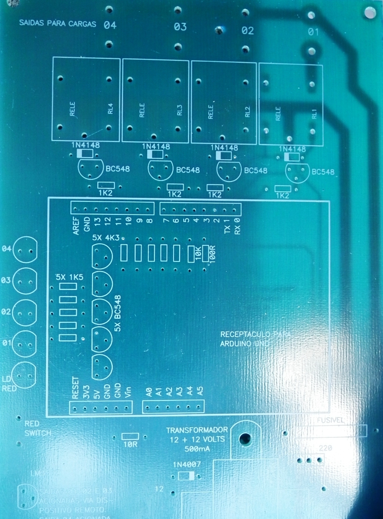

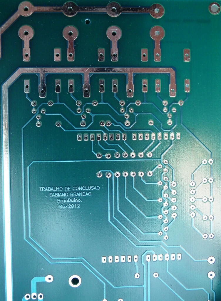

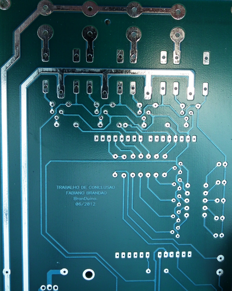

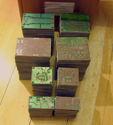

BOARDS
Who wants boards, write to me, my english is bad, but i can understand...
I'm getting some prototype boards, i will photograph and post here for people to see the product.
Regards.
Zimmer or Kraut... hehehehehehe
Regards.
BOARDS
These are the images of the boards, so for the DX.
Contact: imap.eletro@gmail.com
Regards.
Zimmer.
Regards.
Zimmer.
Yep, this was made inside a Brazilian forum.... a group buy style
Was distributed a long time ago.
Now a days these pcboards are playing nice music inside Brazilian homes.
We had another huge group buy that was fine too...the Blue board used into the Supercharged.
I had one complain only... first VAS burned, then i suggest the guy to increase resistor and no more troubles.
Mitchel (Miguel Nabuco) was the one put the group buy to run...he was an old and traditional seller of Gainclones inside that forum...this way people get into this new group buy..... was mainly because of his fame there.
