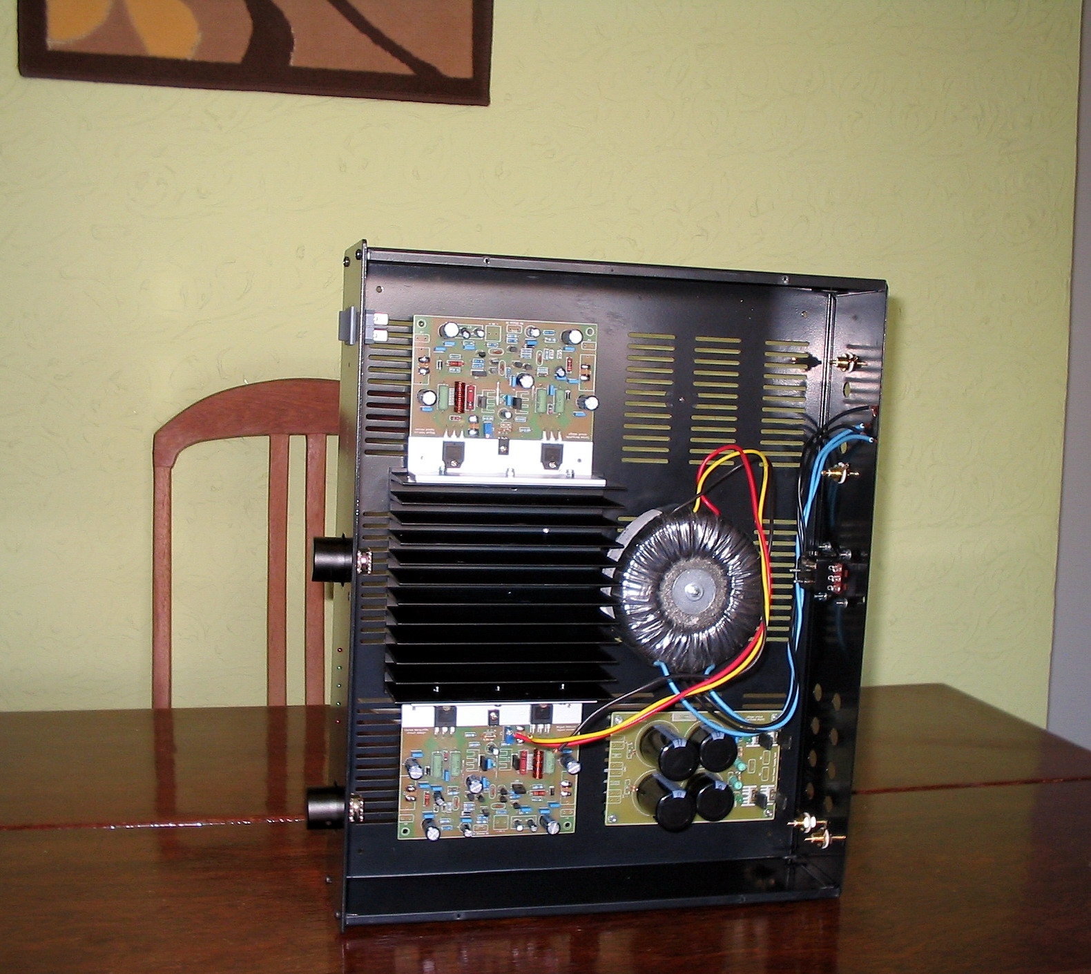

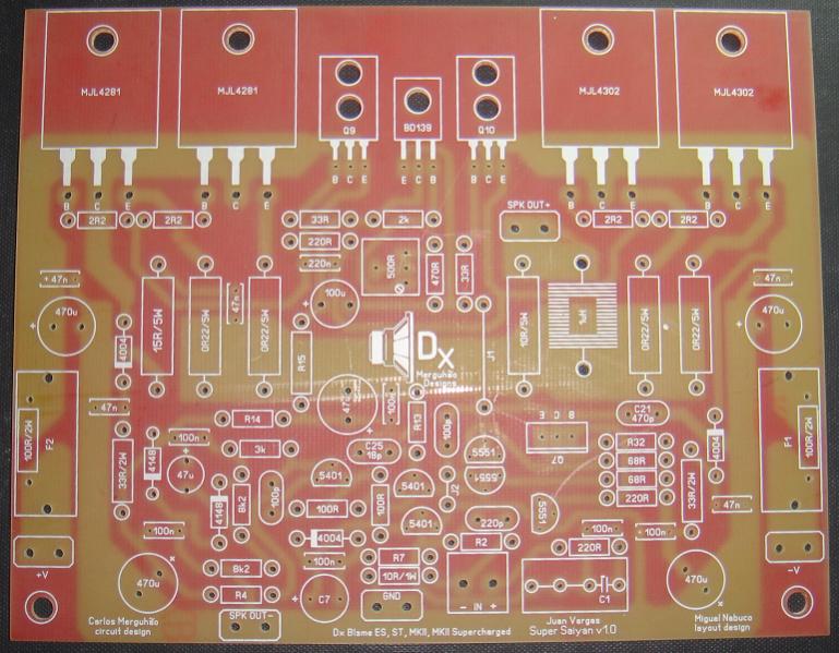

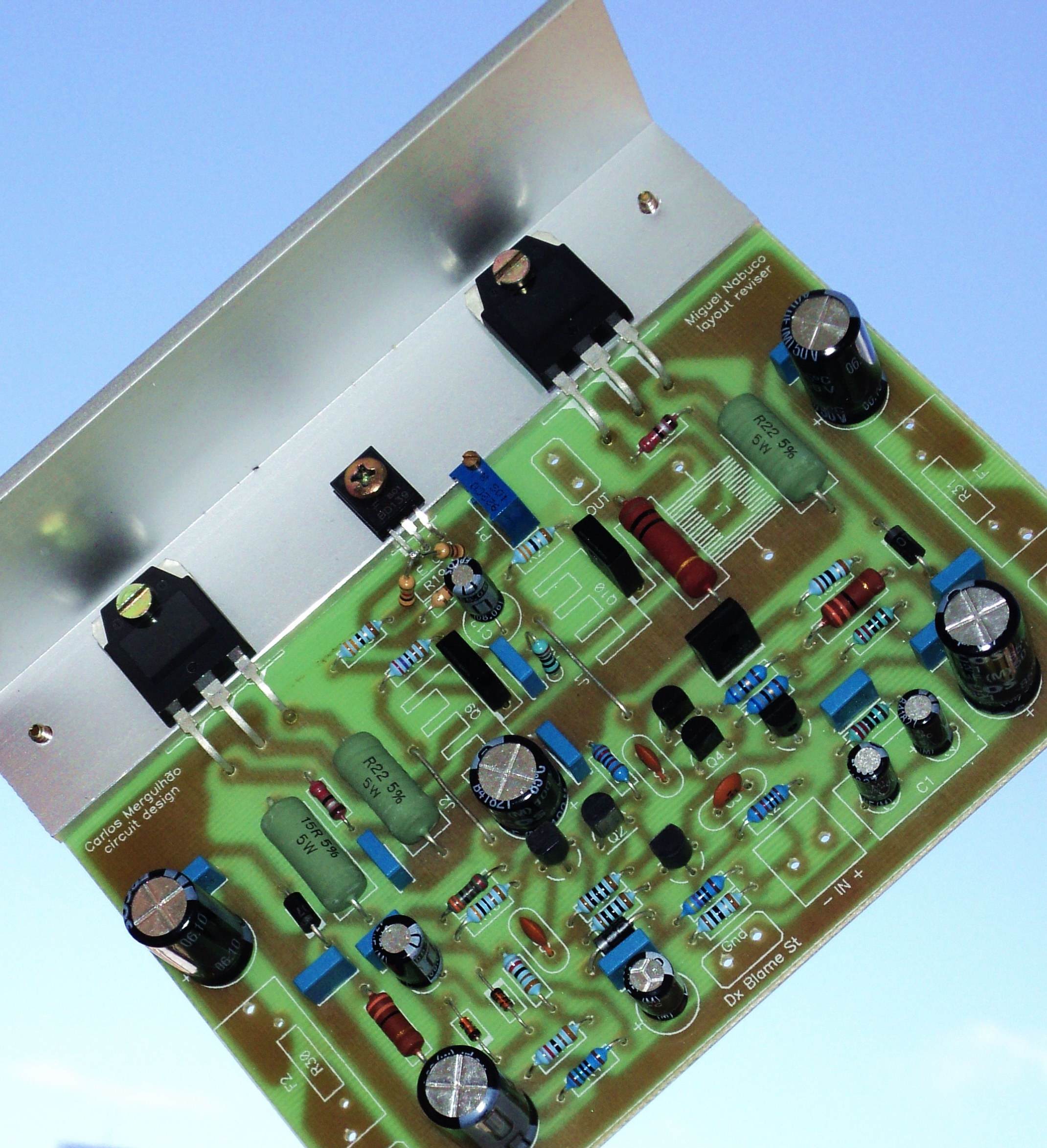

One amplifier, from my Dx amplifiers colection, sounds much better
It is a Dx Blame ST made using original Todd Johnson pcboards...he made the layout for us.
The unit reproduces a little bit more clear sound...more treble, less distortion and more dinamics...also a nice deep bass.....there is some difference in performance compared to other models.... but it has slightly more noise.... with your ears into the tweeter you perceive something even with the input shorted.
I do think the reason why is the use of BC546/556 transistors, also BD139 for VAS and the pair BD139/140 for drivers.
The circuit is almost the same...the input condenser is constituted by 2 units of 22uf/16 volts...i do think the small insulating voltage also play a roll in that stuff too (search for theories about electrolitic condensers operational voltage).

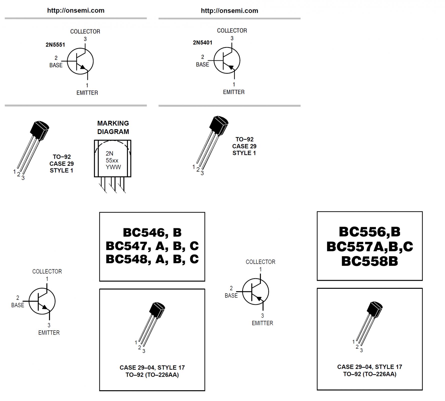

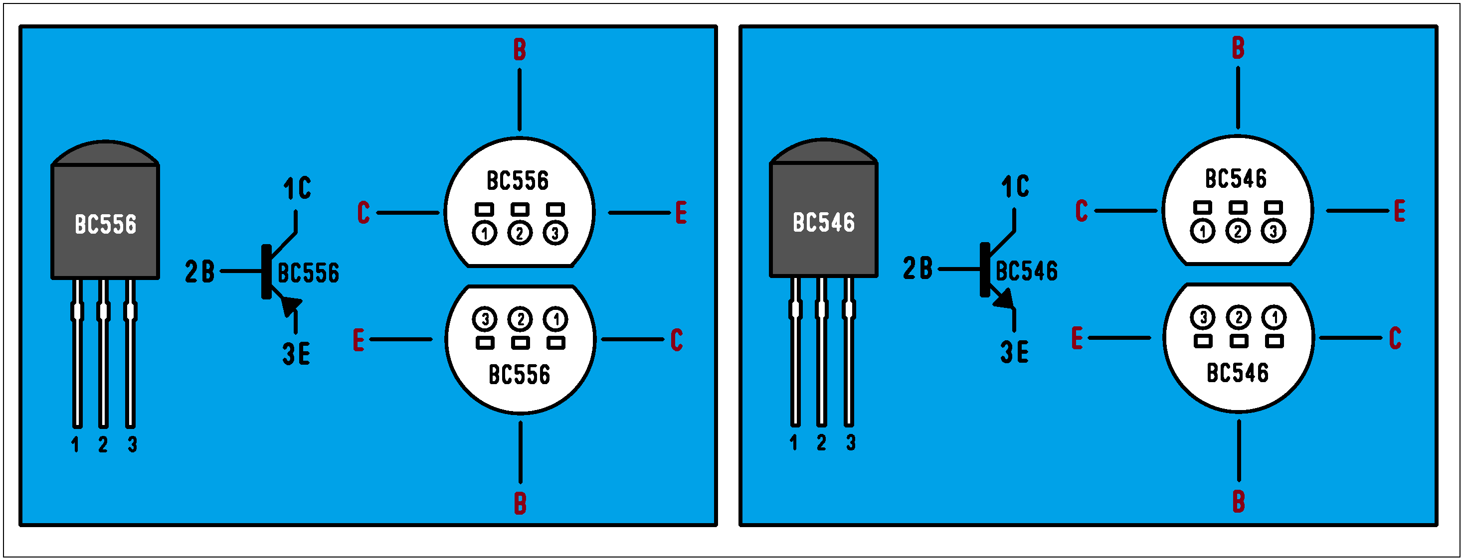

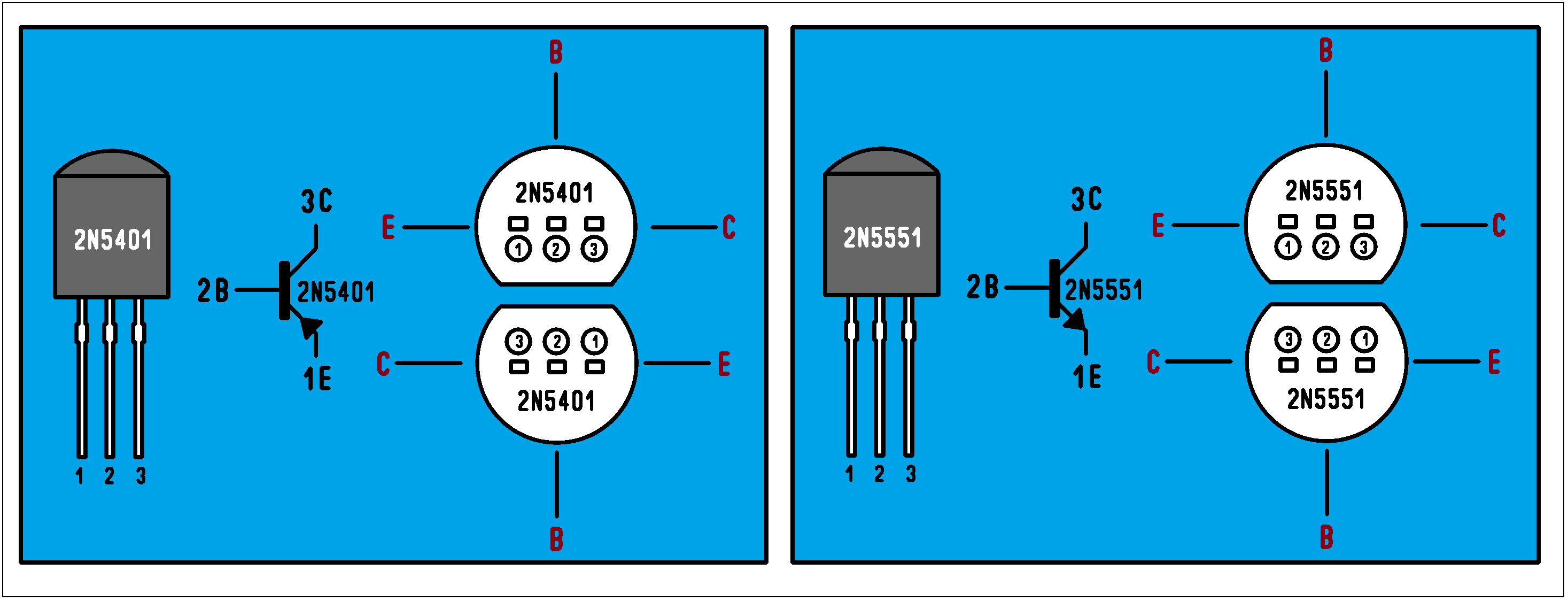

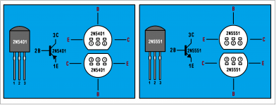

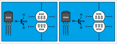

Found and error on my drawings
I was checking the orientation of the 2N5401 and BC556 and in my first drawings I made a mistake, so I use the data base information website of the components and fix it here are the illustrations "my bad" I didn't see it but after you turn the components 180 degree you don't realize things so I made a drawings to see how they look from top view of the PCB board here is.

Good Juan!.....be aware folks.... these transistors
have different lead position.... the substitution must be made doing the transistor rotation... a 180 degrées....base continues in the center, but emitter and colector are in different position and should be rotated.
So, if you already have 2N5401 and 2N5551 in your circuit, then when replacing by BCs you should rotate considering the previous position.... substitutions from BCs to 2Ns or from 2Ns to BCs must have this rotation.
The active components (input differential and first VAS transistor) should be the ones to replace, the others are auxiliary and will not make any difference in sonics if you replace them.
Second VAS transistor is BD139 and drivers are also BD139/140...matched within 20 percent in gain.... try the output units shown in the video too.... my units gain are around 200 measured using these cheap chinese digital multimeters.... so, it is the gain using the internal meter current and voltage...not exactly the gain you will have with 35 volts and the working current..it is just a reference to you..not the real thing...if you measure with these cheap multimeters, then you should measure around 200 of gain. (plus 20 percent or minus 20 percent as everything in analogue electronics and electricity)
This amplifier (shown in the video) was always better in sonics..... and the difference in quality you can perceive if you listen one and other..... if you never made the comparison..then you will never know the difference.

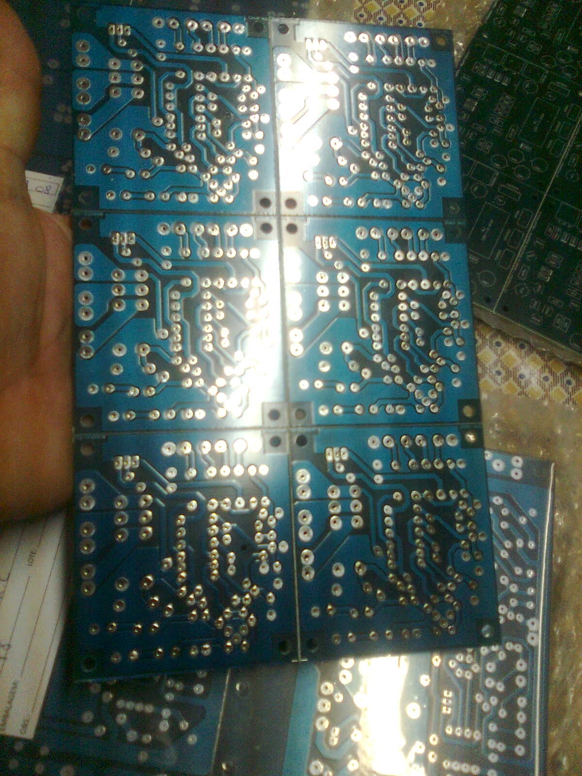

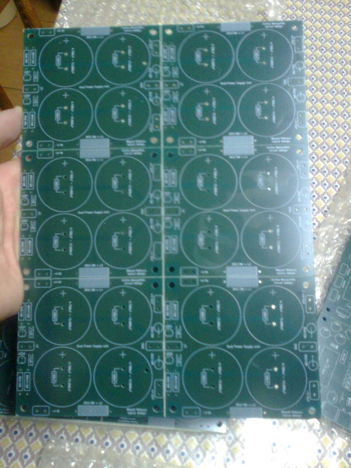

The third brazilian group buy orders are now being shipped
126 kits produced, including Audio amplifier pcboard, Supply pcboard, Speaker protector pcboard and delayed insertion pcboard (surge protection).
Zimmer had started because his will to try the Dx Super A without the need to make modifications in his already built amplifier, then he decided to make an entire new one including the Dx Super A circuit (JVC Super A modified by Brazilian Gradiente and adapted by uncle charlie)*
I am glad people are still interested in this amplifier, the most sucessfull Dr. Self project (my opinion considering the units he made, the ones i could listen and test) tuned by ears by myself... some minor modifications that for sure sounded very good.... some modifications would not be entirelly approved by Dr. Self, as i have forced some parts nearby the limit, a non standard solution....Almost all ammount of credit must go to Dr. Self, at the end he created the Blameless design, i have just tweaked.... so, if you understand the amplifier alike a lovely Rolls Royce, uncle charlie made a polish with some wax on it.... and it continues to be a Rolls Royce.
So, now a days, almost 350 kits provided (not 100% sure about this quantity), the majority in Brazil, and some more 70 kits made by home etching by folks that belong to our diyaudio forum.
There are several pirate's producers in Brazil, USA, UK and China....so, i cannot have account of these ones because they are not under my control but i could detect their presence in Ebay and in some other equivalent sites.

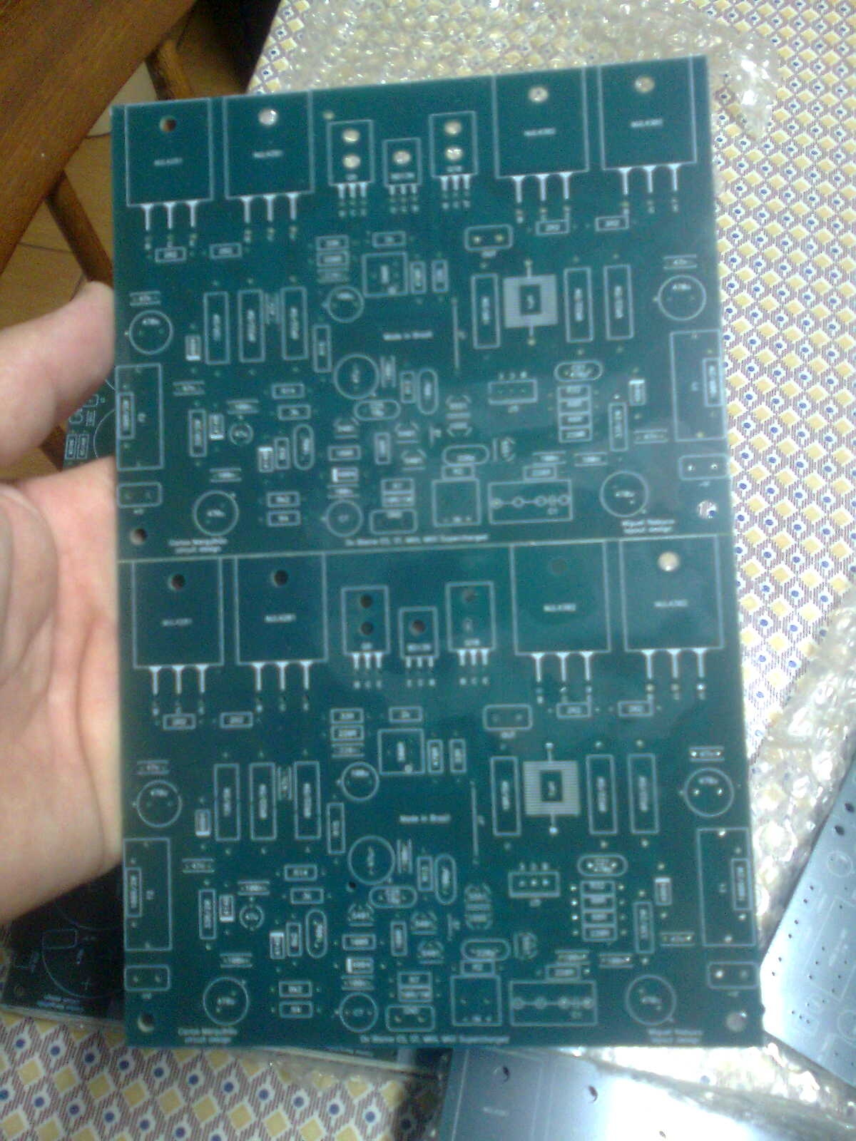

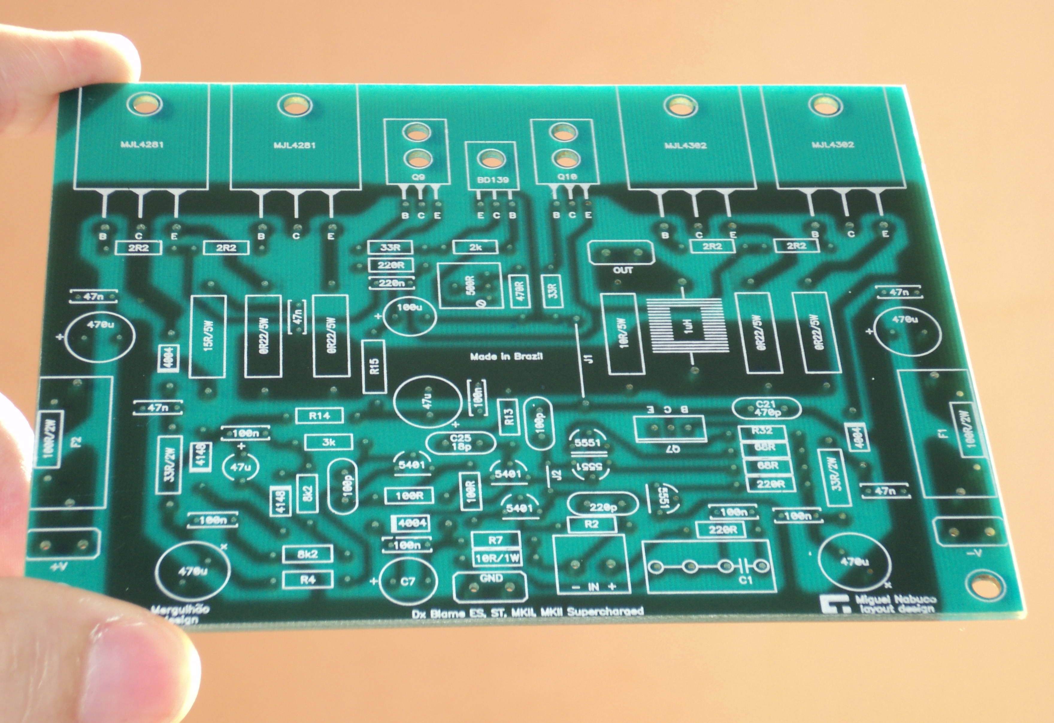

The one made the first pcboard layout that referenced all sequence
Was Todd Johnson (TAJ)...he made the design, next units produced where developments, small modifications made with the intention to improve..some resulted good, others not that good.
Brazilian green board was made by Miguel Nabuco (Mitchel), also the Supercharged blue boards, the multimodel pcboard.
The credit to be the one have created the pcboard goes to Todd Johnson, and my sincere thanks goes to several other guys that improved (Metal, Rudi,Juan Vargas, Mitchel and some others)

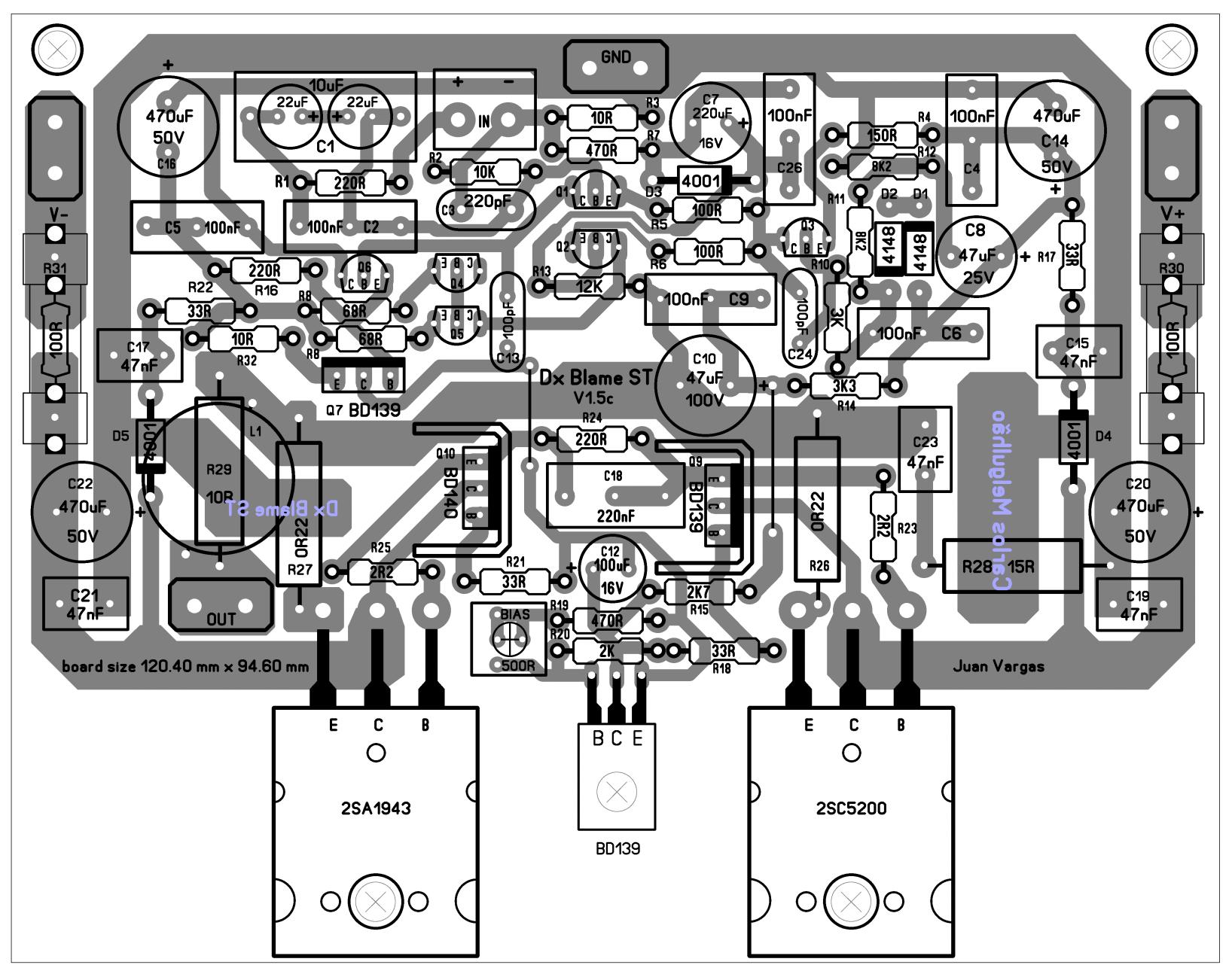

Dx Blame ST Juan Vargas Style
I was bored to death a decide to make a layout from Dx Blame ST and I'm not sure if I got errors but I will check a couple of times. still waiting on parts so I don't have anything else to do, my car is almost done doing body work and it is a really boring Saturday lol well take care guys!
