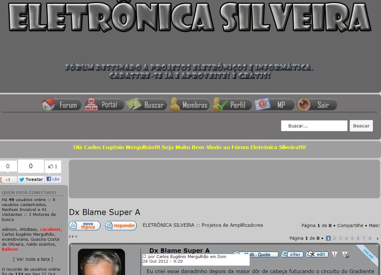

People, in a Brazilian forum, received uncle charlie alike a king.
The Military band of Music for celebration and the "keys from the town"..but i was invited, in a very respectfull and educated way, to subscribe to their forum...then i am there, gladly.
So different if i compare with the HT forum where they banished me three times, where i have to ask please to enter to explain things about my amplifiers that someone have published there...so different!..this brazilian forum is a business..they sell things there..so, a real DIY man is not a good idea as people prefer to build my things, then to buy their stuff.

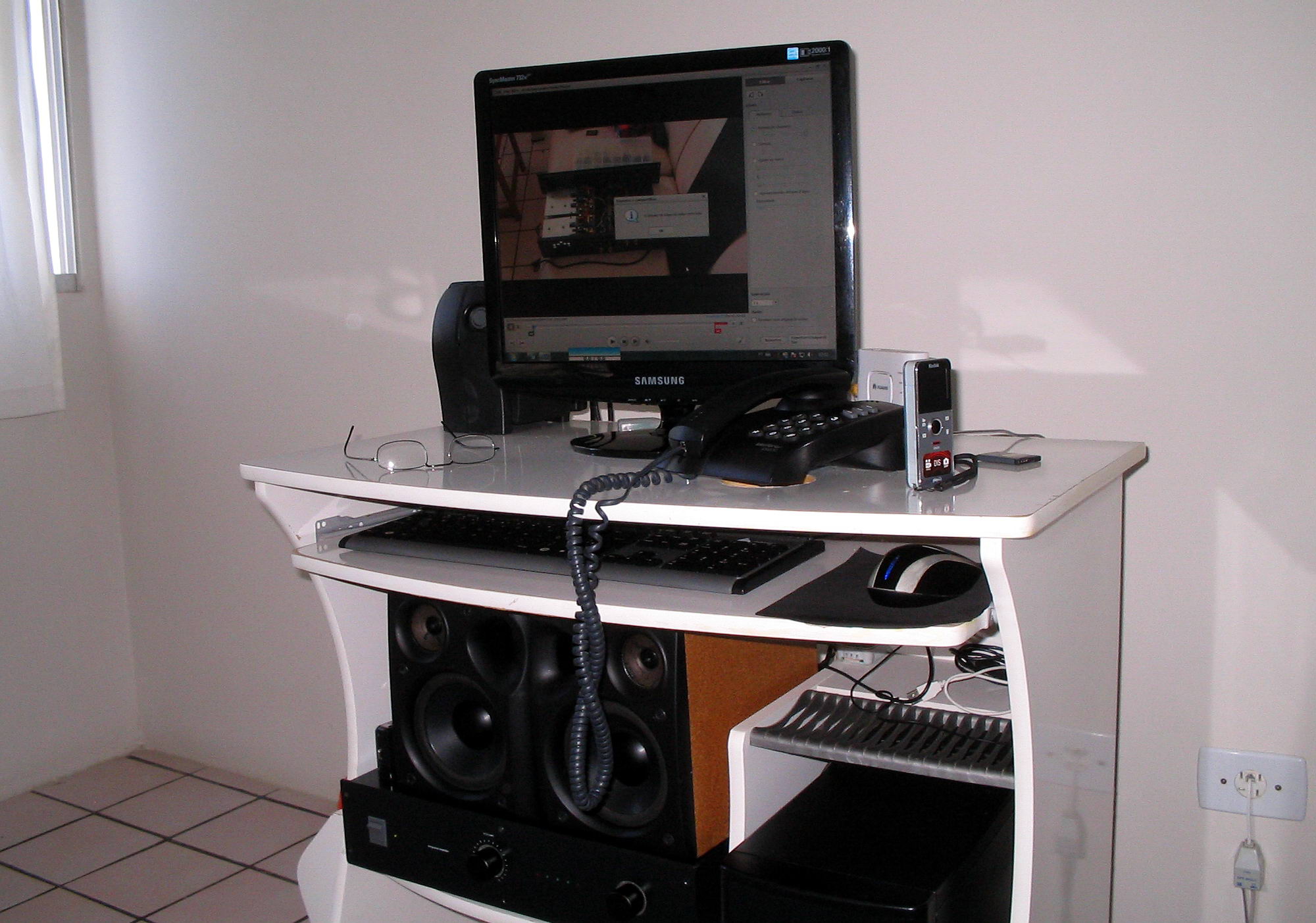

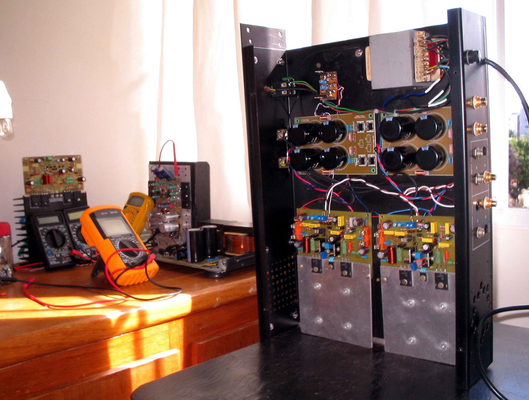

I am revisiting the Dx Blame ST, upgrading my computer monitor amplifier
and you will be informed about that.
A video is being uploaded, the part one, the introduction explaining what i gonna do...then you will see a second video in a matter of a week showing you the unit already upgraded.
regards,
Carlos
