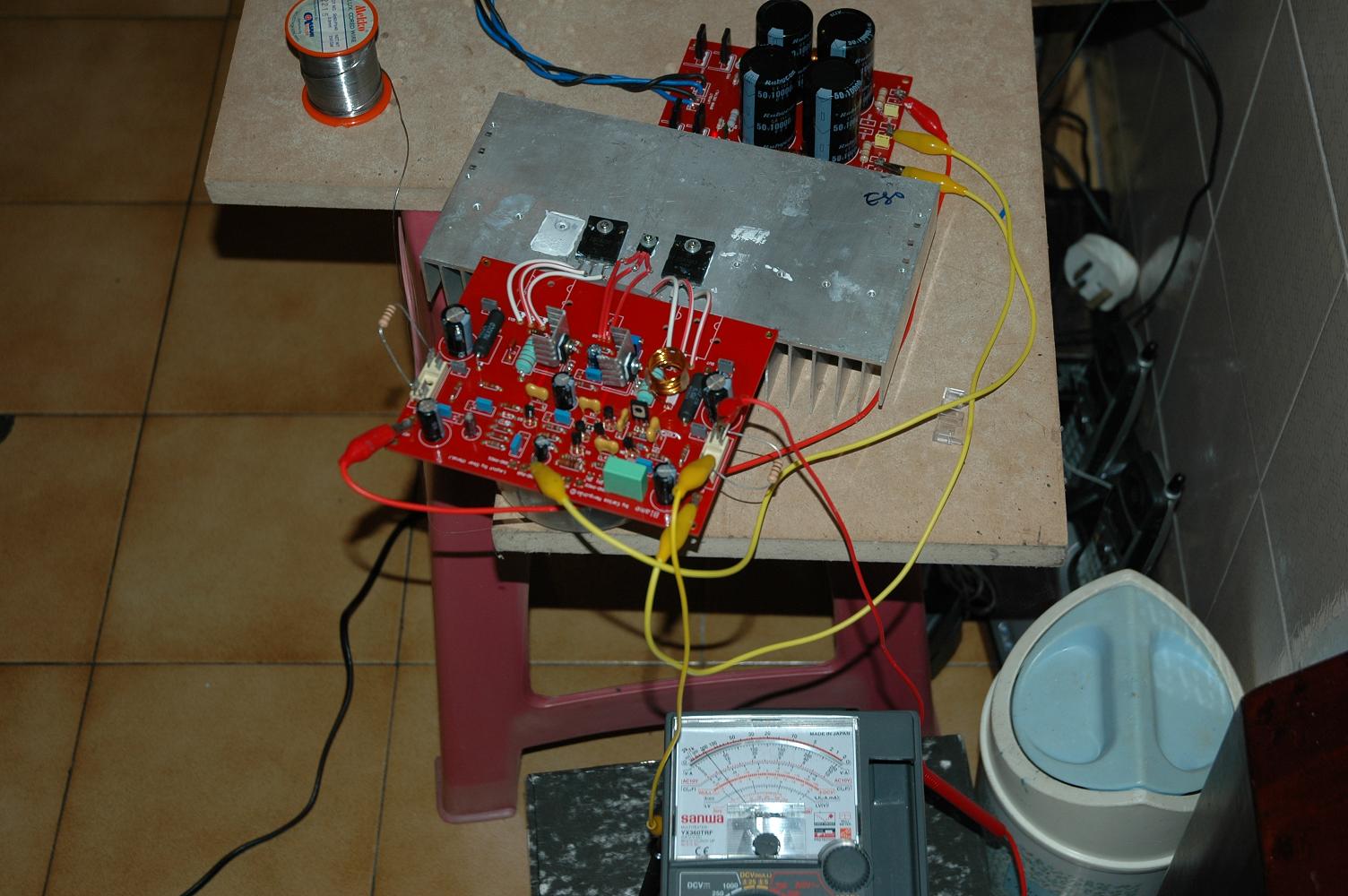

Hi all,
I have wired up the PS and one amp module.
Rails measured to be +/- 32V DC (from a 2X 25V 160W EI tranny).
I installed a 1W 100R resistor in place of the fuses and managed to achieve
4.7V by adjusting the pot. The other rail was also checked and it also showed 4.7V.
DC offset measured to be -5mV which is great. Transistors were checked to make sure they weren't shorting to the heatsink.
I tested with my 82dB 8Ohm 3.5'' vifa fullrange driver. Even when music was playing softly, there is a distorted sound coming through. The full spectrum of music is there; bass, midrange and highs but the midrange distorts first.
On musical peaks there is a "thsskkk" or "thzz" sound.
Power transistors used are : 2SC5200 and 2SA1943
Diode used in the PS PCB are 8A 200V, "damper diodes".
Could the fake transistors or damper diodes cause such distortion?

This is not normal...check your board till you find something wrong
There's no "tshcc" sound or anything but wonderfull music....amplifier sounds great as several folks reported.
Check everything, first capacitor values, in special the Miller one.
Fake transistor?
Reduce wire length to the transistors...use adaptor

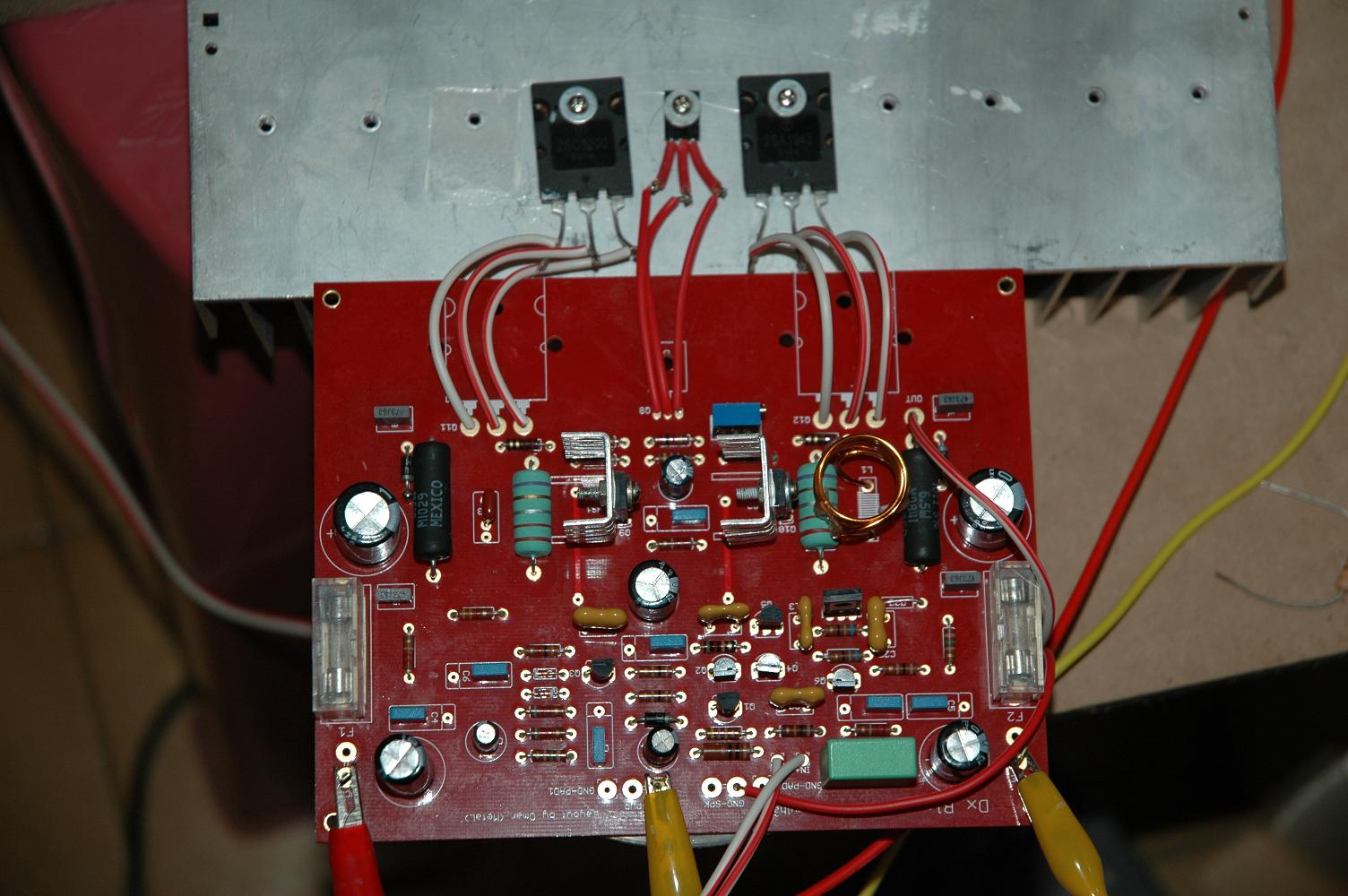

Is R3 a resistor?
Are you sure R3 is a resistor, not an inductor (bobbin, coil)? Maybe a silly question, but it strongly looks like inductors we find here in Brazil.I tested with my 82dB 8Ohm 3.5'' vifa fullrange driver. Even when music was playing softly, there is a distorted sound coming through. The full spectrum of music is there; bass, midrange and highs but the midrange distorts first.
R3 on the amp board is a 0.5W carbon composite resistor from Multicomp.
I will complete the second channel with some original Sankens and see if the problem can be resolved. Most of the wiring is soldered so there are no loose contacts and all resistors were checked with multimeter before being soldered in place.

For sure there's something wrong...this amplifier does not produce strange sound
So, check it all till you find something wrong.

The test wires you're using are too thin ain't they getting hot?
I think the rail voltage is too low check your power-supply.Read my posts about the rail voltage
It works fine while using 32 volts

The test wires are rated at 7A 250V and they're not hot. The power transistors are barely warm(2 degrees over ambient) as my heatsink is large. So you mean the amp will not work with +/- 32V DC ? Will be reading up your posts in the mean time.

omg. The second channel with the Sankens are playing like magic. Massive sound, detail retrieval of the highest level. No distortions whatsoever. Didn't realise the tiny 3.5'' could produce such precise bass. Transient attack wow...
To conclude that the first channel transistors were the problem, I have to remove them and add in the Sankens. Tomorrow.

I replaced the first channel with the Sankens. All problems are gone. At last I can sleep peacefully hahahha..
Will let the amp be tested on the small speakers for 24 hours before hooking them up to my large speakers.
Thanks for the help and encouragement.
