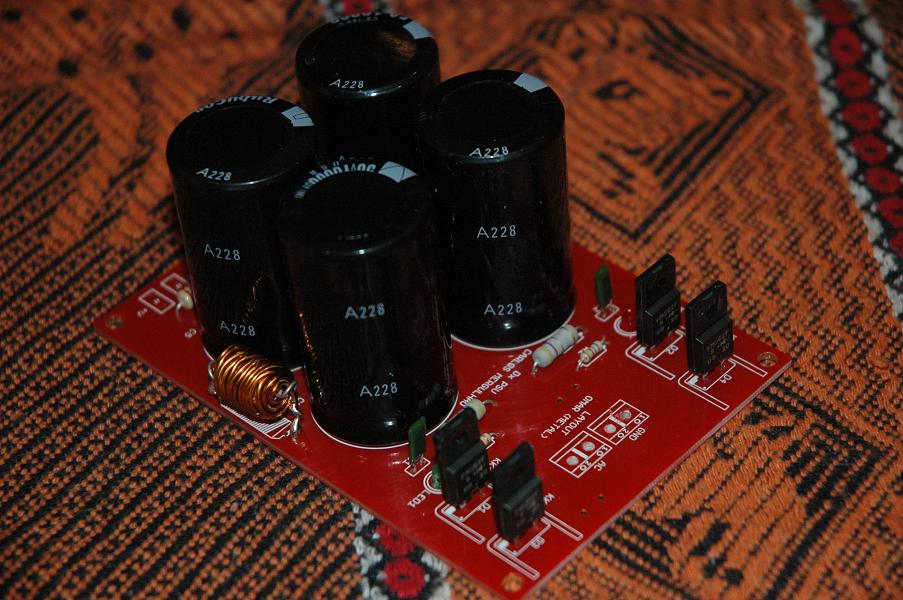

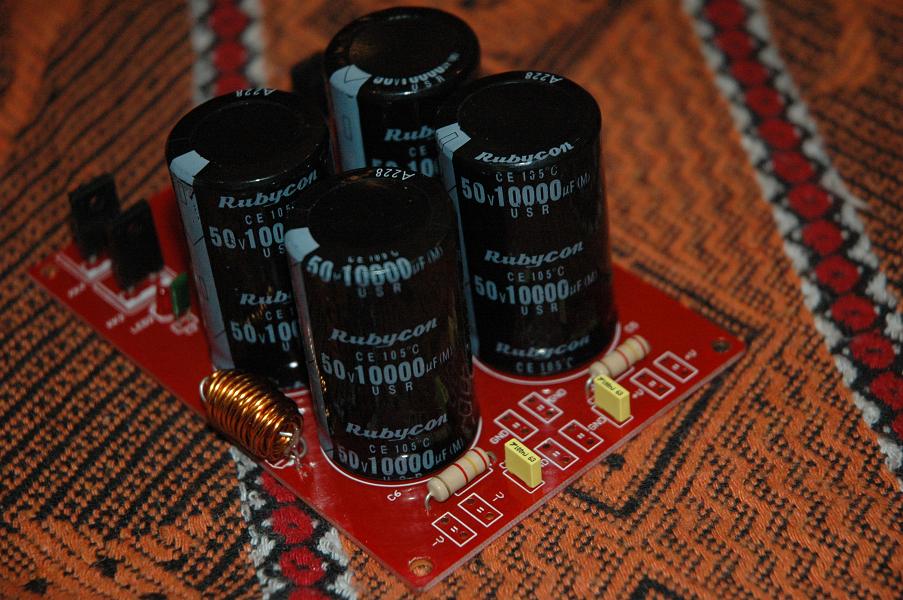

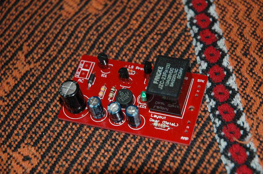

Blame ST power supply and speaker protection PCB's (beautiful red/gold german boards)
Tested and fully working.
Next up : amp module
The coil was wound using 1mm coil. (ripped out from an old crossover inductor). 40 turns, triple layer deck.

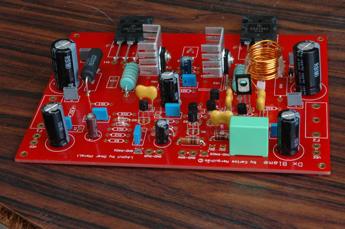

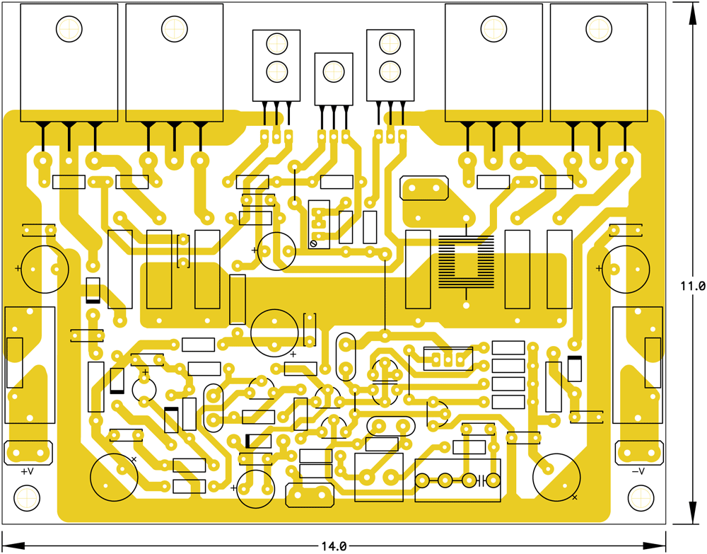

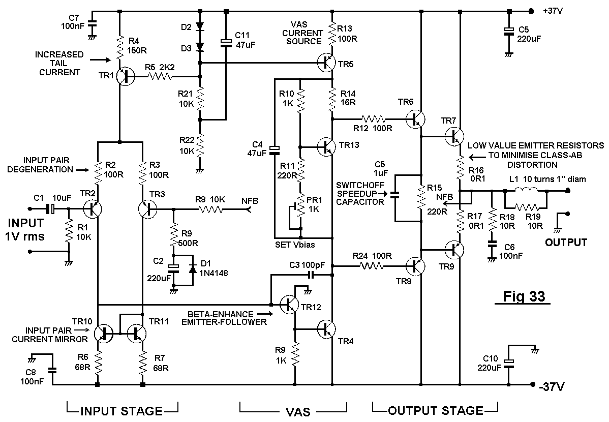

The Dx Blame ST was inspired, or almost copied, or cloned from Blameless design made
by Doctor Douglas Self.
Dr. Self have made research trying to find the most pure amplifier possible..something that would never include distortions into the audio amplified...his main target was THD..then he made an amplifier circuit that would distort less the 0.002% THD (Total Harmonic Distortion).
The idea behind the name is that no one would Blame the amplifier..if something sounds wrong or bad...people should blame speakers, audio source, room acoustics, pre amplifiers or the owner ears... the amplifier would not include strange harmonics or distortions...it would be the most pure amplifier ever made.
I have made modifications, as i perceive it can have some "sonic signature" that only a bootstrap circuit can give..but basically, this one is the Blameless design made by Doctor Self..started from it..was copied, assembled and tweaked.
I hope i could explain you..if you need anything more, then please, let me know.
Build the Blame..it is the best you can have.....i have build more than 5000 amplifiers, and i have listened to hundreds commercial units...no one can beat Doctor Self Blameless design...i have made nice make up into the circuit and i could achieve some kind of sound I BELIEVE AND FEEL as unbeatable.
Down you can see schematics attached.... the basic Blameless idea and the Dx Blame ST schematic.

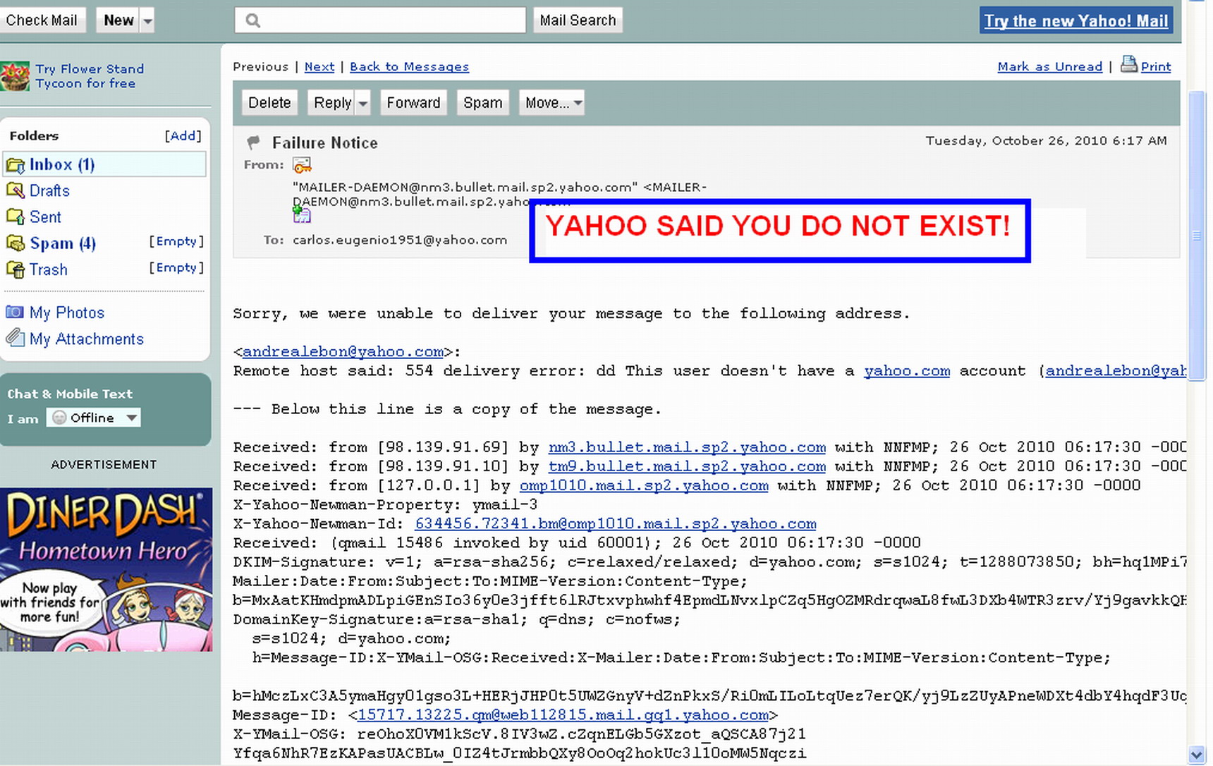

Strange things happening dear Andrea Lebon
Yahoo has informed me you do not exist!...ahahahahaha!🙂
Funny thing Yahoo does....you know... competition is sending viruses to Yahoo...sometimes Yahoo becomes slow.
I suggest you to try another adress...to make registration in another one..do you have MSN adress... these Hotmail adress?
Mine is nanabrother@hotmail.com....but you should inform me using forum PM, as i do not use to visit MSN, or Skype, or Facebook.
