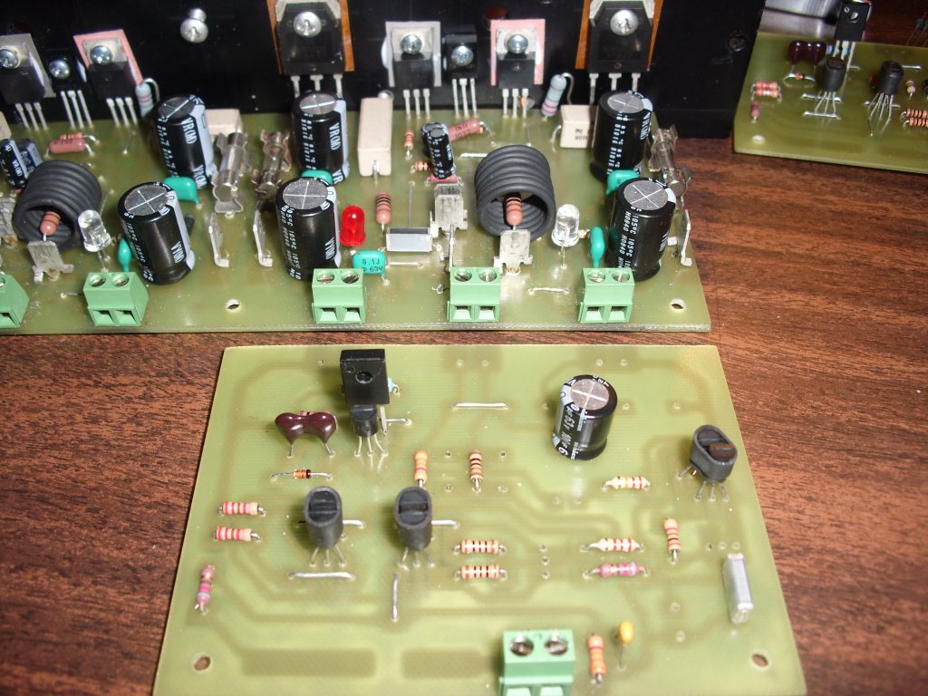

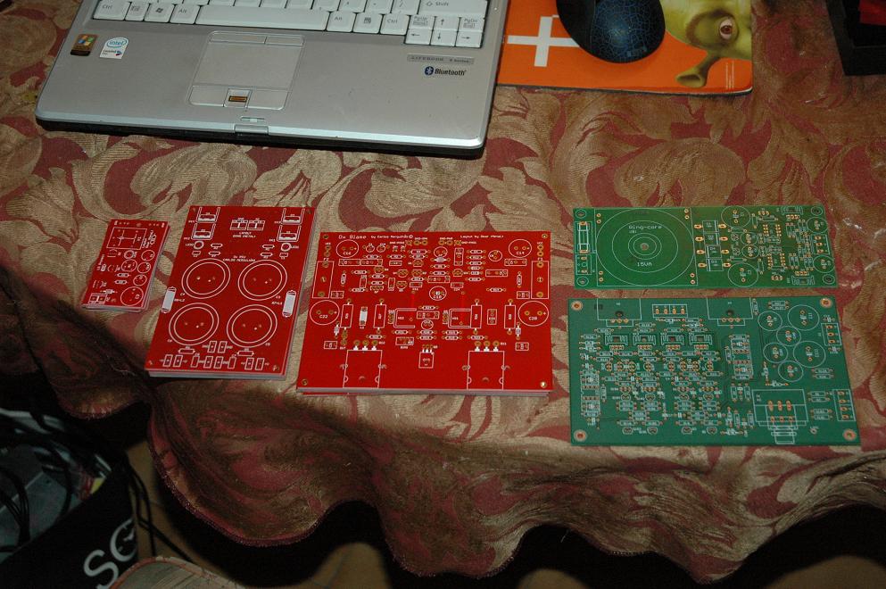

That is "BX" (blame style).. real close to yours. Just uses fairchild trannies (ksa/c's) and can use 40-80v rails with simple change in bootstrap resistor values. It plugs into 3 power levels , 60/120/ 250 watt output stage boards.(60w below)
The "blameless bootstrap" gives AKSA like sound but is very accurate/reliable like the original "blameless". Oh, BX is "flipped around"... NPN input pairs. NPN's are easier/cheaper to match (better manufacturing - cheaper to buy a 100 in N. america).
Plugin board is nice for R and D. Can see if new designs do "strong emotions" or "trash bin" VERY quick. 😀 Very good design , Carlos. 🙂

From left to right : Speaker protection board, Blame ST PS pcb, Blame ST amplifier module, optional preamp and it's power supply PCB.

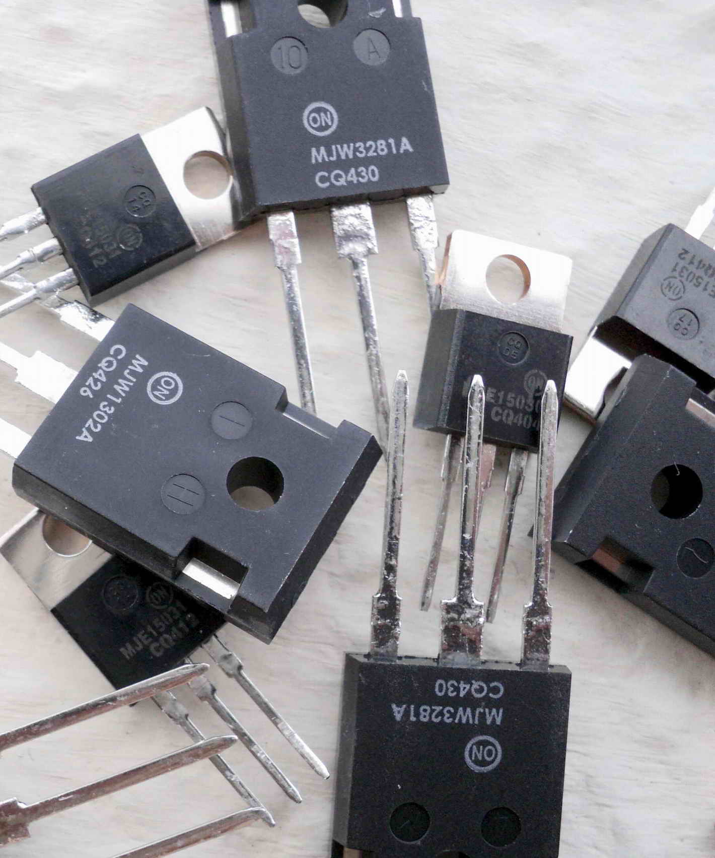

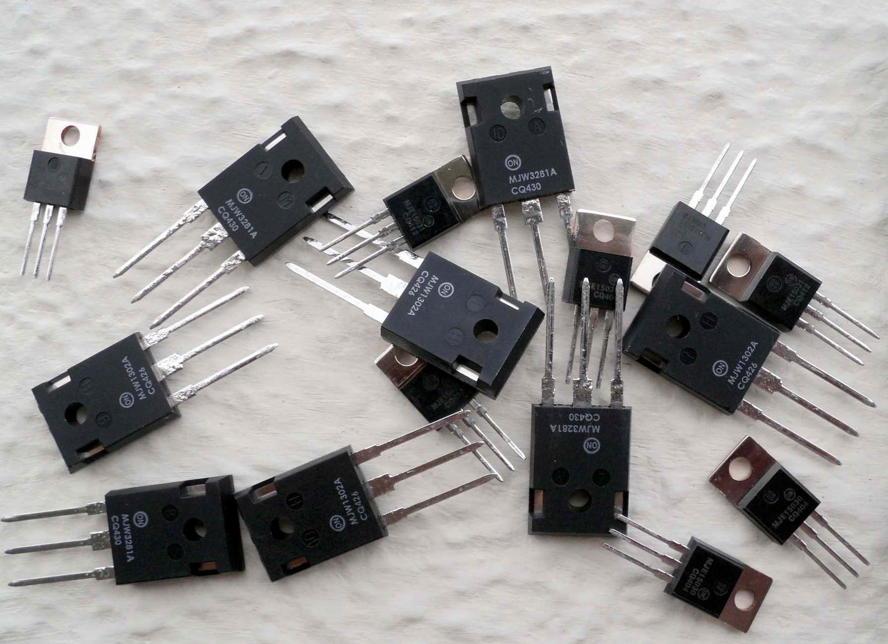

I have received, as gift, some transistors from Evette...a good friend from French Canada.... nice transistors...i am impressed they have reduced the size, and even this way the power dissipation remains big... the picture show the transistors i am talking about.

Small and powerfull....nice ones!
regards,
Carlos
Those and the NJW0281/0302 are ALL I use. I get those MJL for 2$ and NJW for $1.40USD. Cheap and durable enough to put amps EVERYWHERE. I use the NJW's now as I get lots of 25 for $26 ($1.04 each). cheaper than the MJE drivers ($1.50 ea). 😱 I did burn some , smashed with hammer , they have 6.5mm square die. fake toshiba's from china have 3-4mm die.

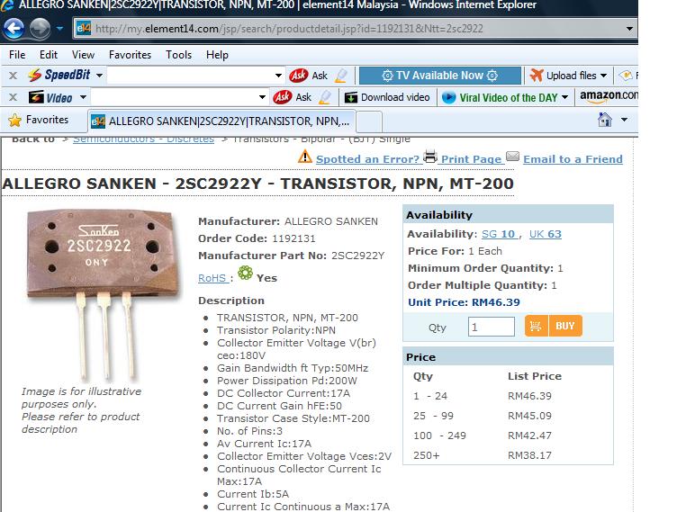

Beware of fake 2SC2922/2SA1216

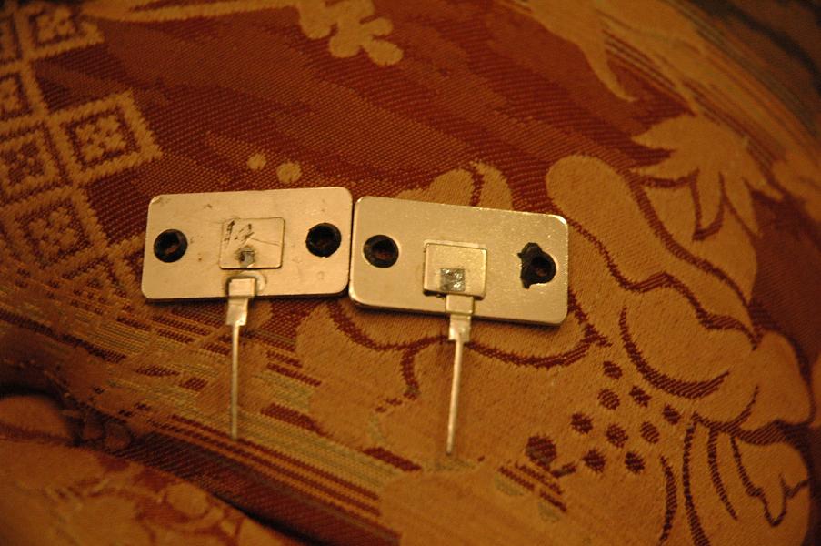

I went down to the local electronics store to get some 2sc2922's for testing.
Each cost $3, and are obviously fakes. Here are some images when I smashed them open. The die size is tiny.😱 Look here for differences. The fakes have a tiny die size.
I have the real parts from Farnell coming soon. These fakes will be used for low level testing.
Don't use the 2sc2922/2sa1216 unless absolutely sure they are originals.
(excellent advice from Rudi).
I have all the parts for the Blame ST PS board and DC speaker protector...construction pics to come...
EDIT: The die size is 10mmX8mm

Thanks Dennis Hui, from checking the transistor part #'s, Mouser appears to have them all except for 2sc2922 2sa1216 alternate choices. Digikey also have some. I would hope that these parts will be genuine Fairchild, Toshiba as indicated. Also there seems to be a few different versions of the same part #, have to look at the data sheets to compare.
