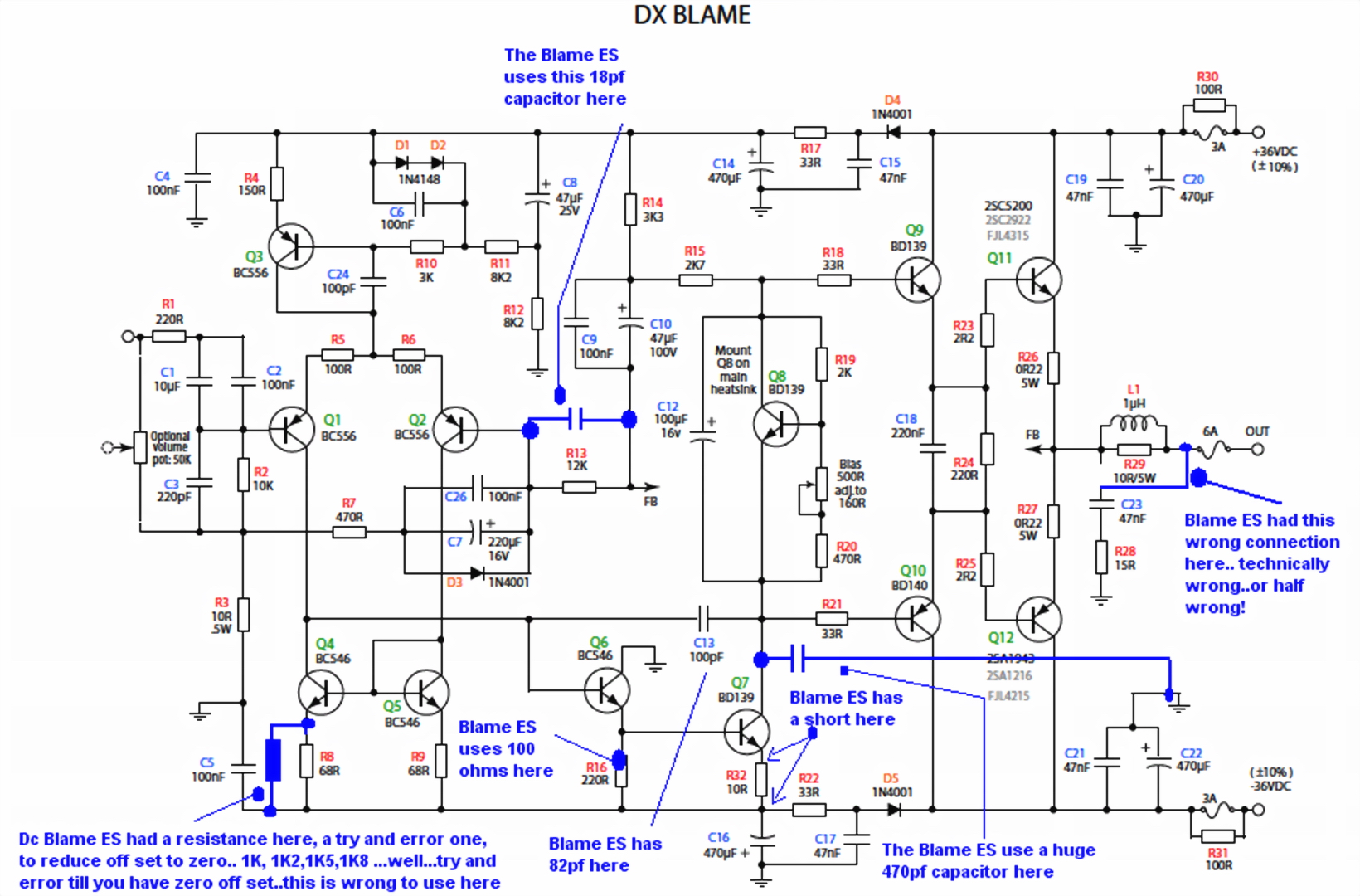

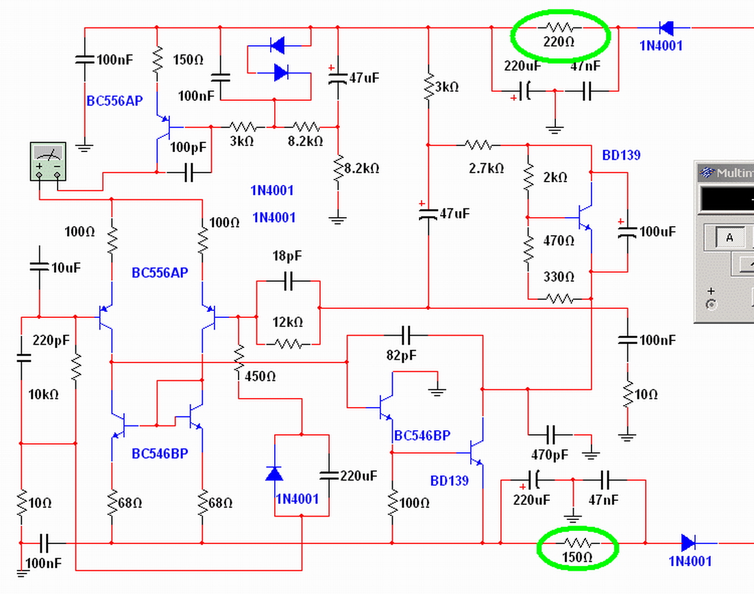

Another thing about the Dx Blame ES... something i would ask you, brazilians, not
to comment in the brazilian forum..because i use to receive a lot of PM daily, with people asking for power... it seems my people is powerholic...so.... things that may reduce power is not something interesting to publish there..they will perceive the power losses and this is not positive.
The modification here suggested, was first installed in the Dx Blame ES, and created as an defect/effect, another distribution of harmonics during the clipping...this made the amplifier sounds "louder"...in the reality more distorted and showing some interesting types of distortions..... theory addicted folks will never understand that..unless they try by themselves and perceive the defect/effect.
It is a defect that causes an effect..an interesting effect during clipping.
These power rail series resistances, are assymetrical in value... so.... during clipping you have assymetrical clipping and also some loss of power...the assymetrical clipping because different resistances, created another harmonic distribution during clipping...so.... that second , third and fourth harmonic resulted different in quality, in numbers and in sonic effect.
These resistances where reduced to 33 or 39 ohms...this killed the defect/effect, but also have removed part of the "magic" in the sound.... only during clipping folks.... that magic "louder" sound have almost disappeared when the rail resistances where reduced.
I am not interested, politicaly speaking, to have brazilians producing such kind of modifications, i would like to have them finishing their ST models and soon starting to build the MKII and the Supercharged...so..... will not be friendly with me, if a brazilian spread this message...for sure the one will be removed from my friend's list immediatelly.... majority of my people appreciates sonic qualities as also they love power...this modification reduces real power... say...the electrical power..but the perceived power increases (perception of power is fooled by distortions, in special assymetrical distortions).
