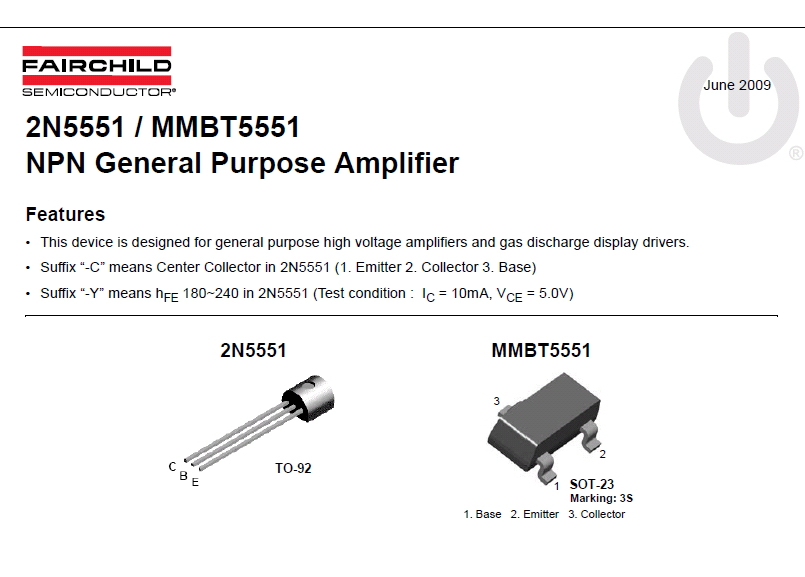

Try 2N5551 instead of BC546...maybe your BC is a generic fake one....but ATTENTION!... the 2N5551 has emiter and colector inverted..so..you must install it turning 180 degrees related the BC546 insertion position...leads are not the same!

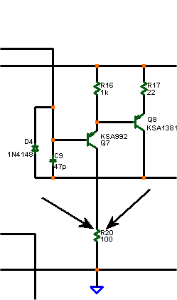

Q6 will be damaged if the amp is overloaded.
Q6 needs the protection of a resistor between Collector and Power Ground.
The value of R16 determines the quiescent current through Q6. It has almost no effect on the fault power when 35V potential is driving current through Q6.
The value of R16 determines the quiescent current through Q6. It has almost no effect on a fault power when 35V potential is driving current through Q6.
This was brought up many posts ago and DX refused to take in the information and went HIS OWN way saying I and others have nothing to contribute.
NO effect on the sound , but can "save the day" (below) ,It is easy to add .. worst case scratch a trace in half , add it. Don't feel bad , I missed it on early amps , will add at least the pads (for resistor) , on future ones. It is hard for me to clip at 75V.
