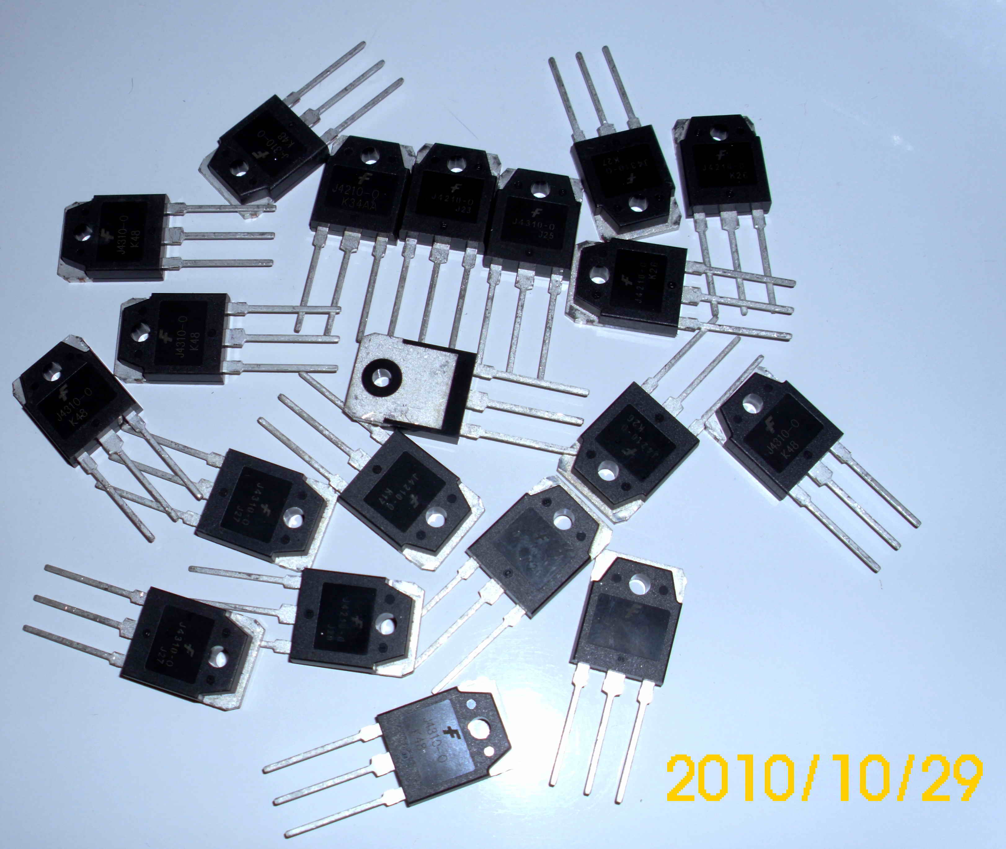

Very sad right now.Was listening to music on my vintage B&W DM14 speakers.Everthing OK increased volume a lot overload and DC protection of the speakers kicks in lower the volume protection turns off only of one speaker the other one stay on.This could mean only one thing DC at the output.Used a multimeter there was a short at the output trannies.Disasampled the pcb and toke my transistor tester and they were OK.With this tester I could test trannies on board but to be shure soldered them out and also then OK and no more shorts between the legs.Soldered the trannies back in and the amp stays dead.Again shorts between the legs disasampled the board toke my trannie tester OK.Is it possible that when the trannies are cold they are OK and when they are warm are bad?
Carlos are there other trannies to use for testing like the TIP142-147?
I do have spare 5200-1943 but to not want to use them if isn't necessary.
Really a very sad thing...i am very sorry by that
i ensure i have tested the amplifier deeply, suffered torture and several guys assembled..no one reported damage.... i also have tested and anything wrong happened.
Well... something is wrong dear Meanman...there is a component or some parts wrong in value...maybe written one value and the reality the value can be other...you have assembled several of our amplifiers and you could see they use to be very reliable.
Do not try other output transistors if you had troubles...i had troubles with a toroidal transformer if you remember...i could not even discover why.... there are things uncle charlie does not know.
Better to check the amplifier...both channels damaged?... if both channels then speaker cable and speaker is the one to have suspection....one channel damaged?, then the board should be checked observing the other one..using the other one as reference.
I cannot be with you..if i could..for sure i would be to fix your amplifier by myself...i feel very, very, very, very sad to be YOU to face these troubles because you are with me for a very long time..always building my amplifiers..so..you are Dx Corporation from the feet nails to the extreme point of your hairs.
Be calm.... relax and go checking ....if you want, send me the damaged board and uncle charlie gonna check it and fix it to you for free.

Heatsinks are very important.... in stand by mode, the output goes cold...really cold..almost the same environment temperature.... playing loud it became hot..around 42 degrees celsius (high human fever) to average, non distorted levels..of course if you force the amplifier to operate into distortions, then you will have it hot..almost 52 degrées celsius in the heatsink.... the transistor should have, the top of the transistor, almost the same temperature you have in the heatsink..if you have it too much hot at the top, two things may be happening...first the bad thermal transference to heatsink or transistor loosen (screw loosen) or heatsink too much small or oscilations..and oscilations in this amplifier can happens if you have, from your DVD, CD player or other audio source having spurious signal from the internal oscilators, clock and so on.... Ipod, the MP3 and MP4 players, these hell things uses to have these spurious signal that are filtered by the earphones (coil)..but when people plug the output jack to amplifiers usually send spurious signals.
Make pictures..let uncle charlie see your system..your heatsink size..your source.... measure your speaker to see if the resistance to DC is normal or if you have a semi-burned speaker coil with a very low resistance on it..... must check everything...now everything is under suspection...since the amplifier..the most obvious guilty to blame, but also audio source, supply, heatsinks and speaker itself.
