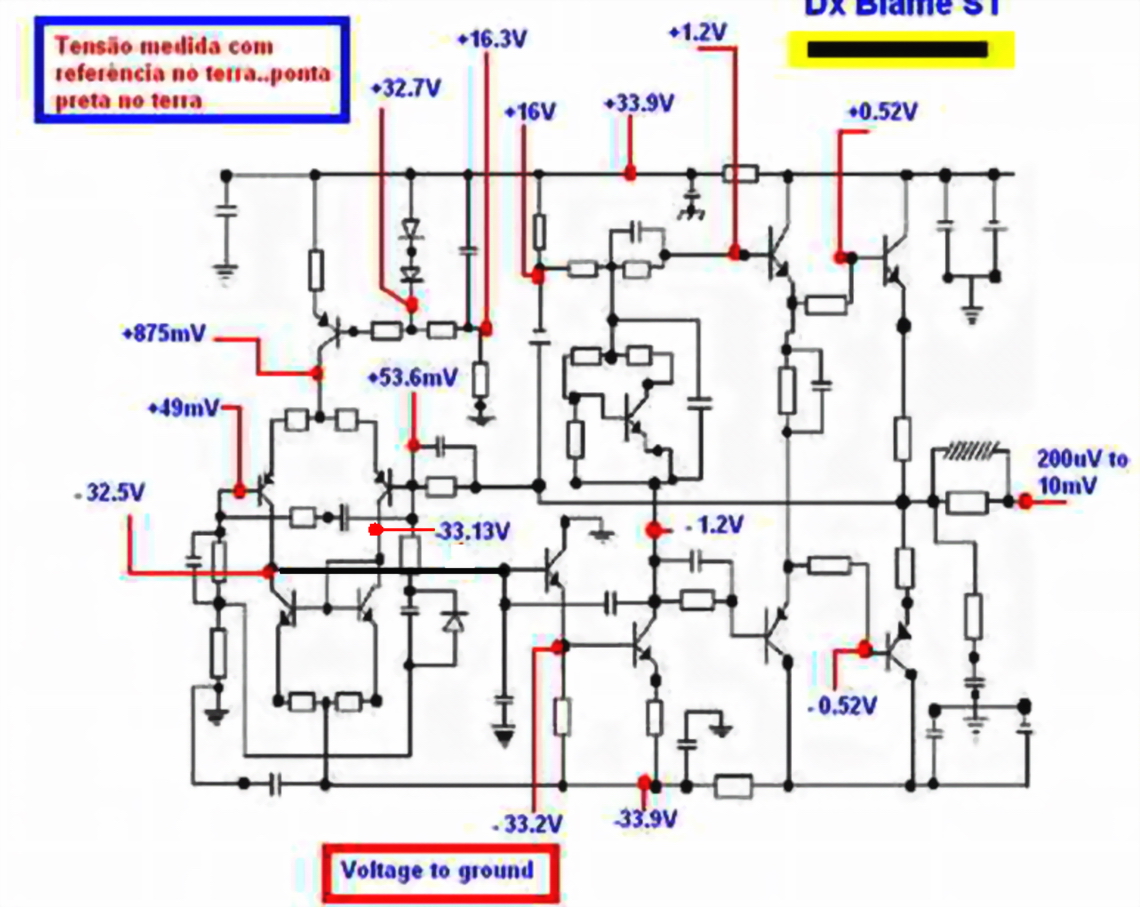

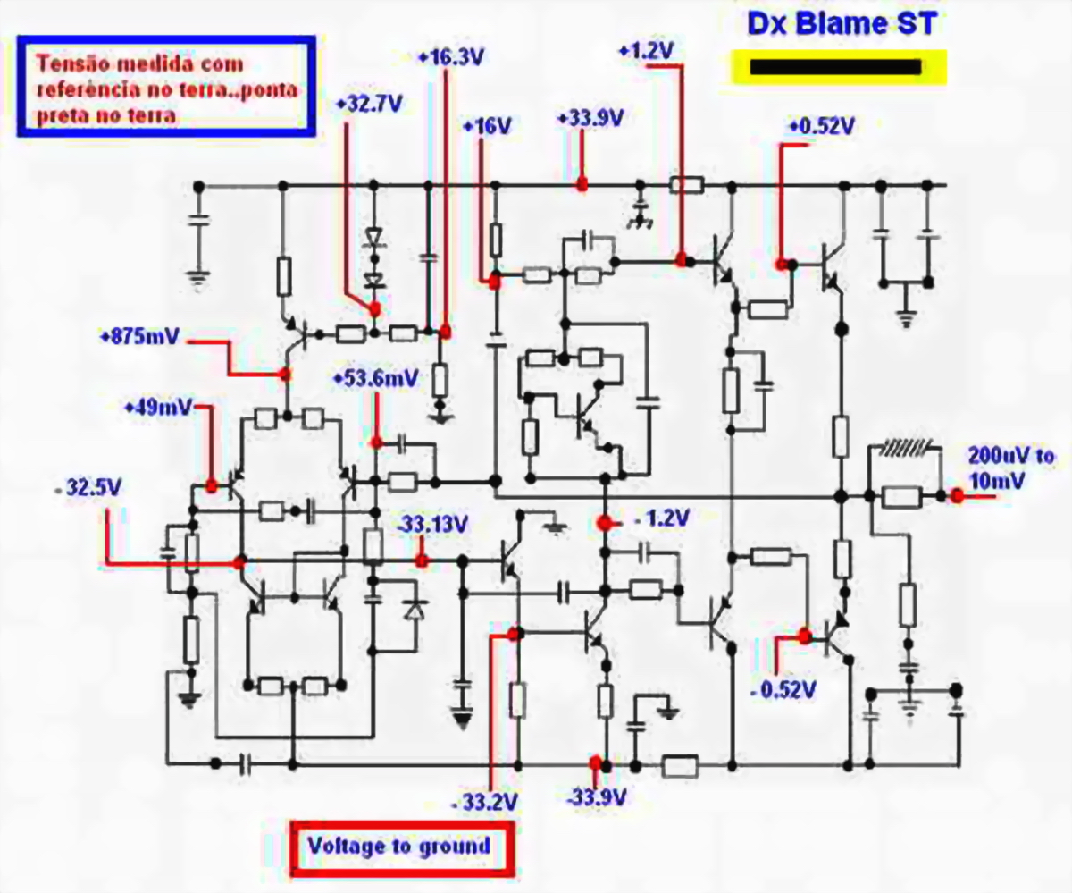

Other amp now fixed and making some find music!! Much thanks to Carlos, Rudi, and others. After all the photos and double check form some helpful folks all seem ok and the problems was with some dead/ bad parts. Make sure I buy genuine 546/556 from now on.
This is quite a learning experience, only negative is I lifted a pad from one of the 546 I was replacing while trying to clear the openings. You can't really see it after but I've slightly tarninshed the beauty of the boards so to speak. Oh well, at least it is sounding good!!
