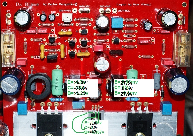

Carlos, I removed the screw and getting voltages now. Also adjusting the trim pot is working.
What is the screw doing? is it shorting it out? I tested for resistance and was not getting any from Q8 earlier.
Do you suggest that I leave it unscrewed?
Don't want to try to adjust yet to 4.7v since it is not screwed down until you give me ok.

Wendell,
I told you so!
So you have a short between the body (back) of the BD139 and the heatsink (which is grounded in your case).
Please use either a Polyamid M3 screw or an insulating bush.
I wish yoiu success - best regards - Rudi
I told you so!
Thanks you Carlos and Rudi, you did tell me so but it didn't show up on the resistance test. I'm using a 4/40 screw probably need the bushing or plastic screwdown.

Hi Rudi,
which dx is wendel using? ST or SE
Coolet
Look at my signature, the BoM.
Rudi have suggested you that dear Wendel..he asked you to measure for short
from Q8 colector to the heatsink.
Heatsink is grounded, so, if you have a short there, you put that transistor colector at ground potential that is zero...and zero appeared in your voltage informative image.
Rudi experienced this problem first...he discovered that monthes ago...i have just confirmed his thougths when you pointed zero volts in your image.
this happens from time to time..so, it is an already known problem.
This transistor can be replaced by others, if you want, try a plastic one..almost all NPN transistor will work fine in that position..the bias trimpot setting may variate a little bit but this will be the only problem you gonna face.
