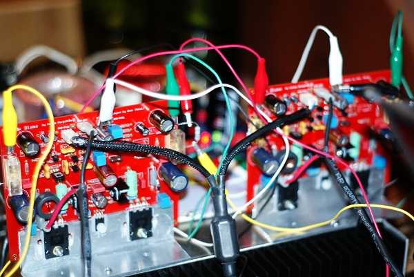

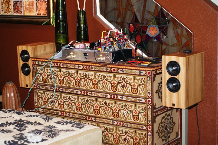

Got the Blame's playing in the living room!
Here is some pics, The 3rd photo is my 3 year old dancing and playing to the nice tunes these amps are humming😀
Meanman, they are some Omega speakers manufactured here in the states. I've had these for a while now. I use to use them as nearfield monitors for my PC but are now playing in the living room.

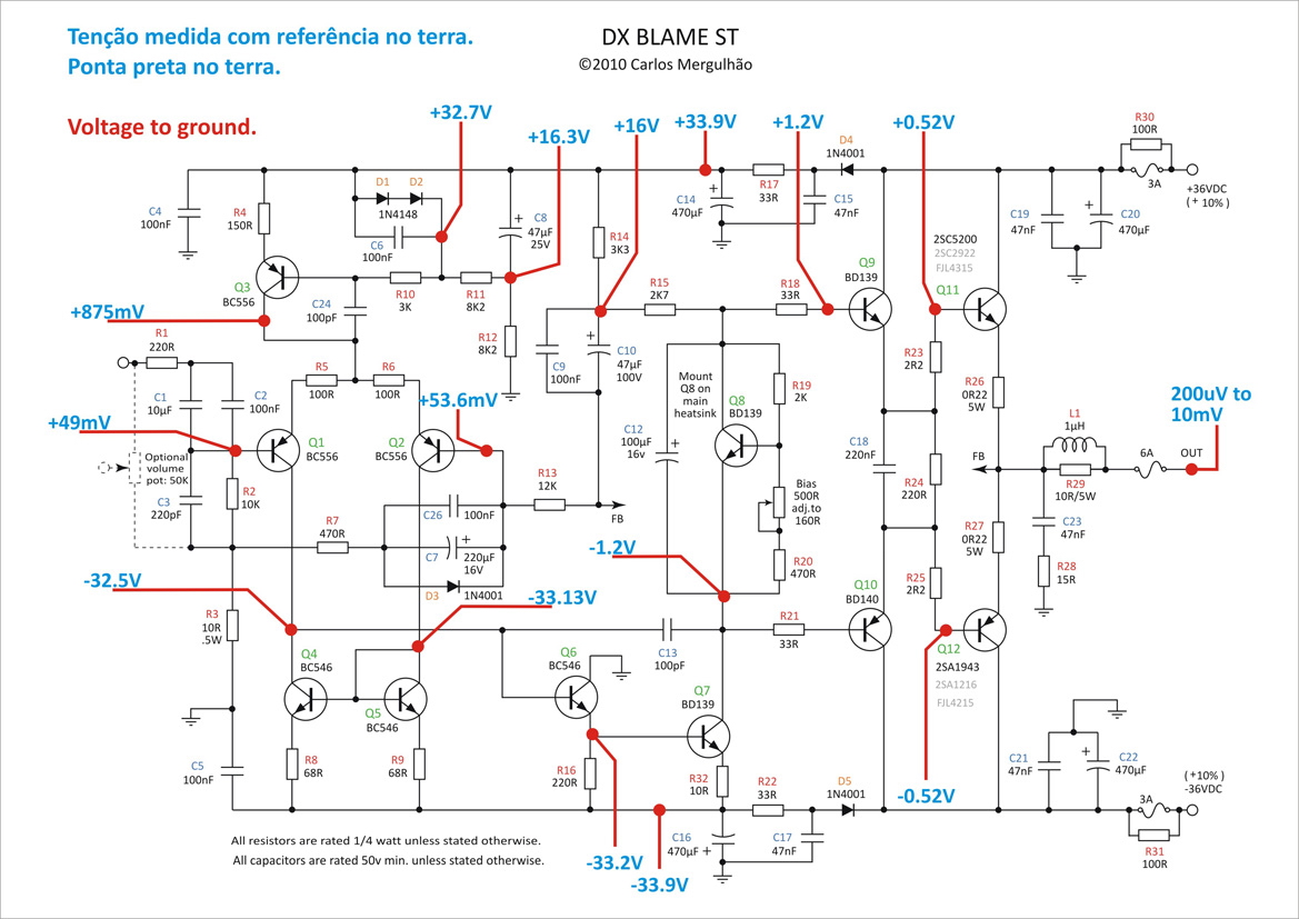

Can I take a few minutes to explain what is happening with input/output offset?
The base of +IN sits at +49mV.
The base of -IN sits at +53.6mV.
as in all feedback amplifiers, the amplifier adjusts the output through the feedback in an attempt to reduce the difference between +IN & -IN to near zero. In this case the Vdiff is -4.6mV
That's as close as this amplifier can get to zero Vdiff. This input voltage offset is multiplied by the DC voltage gain of the amplifier and the result is sent to the output.
DC gain = 1, therefore -4.6mV appears at the amplifier output.
Why do we measure those particular +IN & -IN voltages?
The voltage at these inputs is dependant on the current flowing from the base of each input transistor and the value of the effective resistance to ground for that current to flow though.
If the resistances on the two inputs are the same then the remaining input offset voltage is due to input offset current.
Input offset current is due to the difference in base currents from the two inputs.
Can we as builders of discrete amplifiers do anything about reducing input offset current?
YES, we can.
Firstly, if the two transistors are selected to have similar hFE at the operating current in the circuit then the base current is equal to Ic1/hFE and Ic2/hFE.
Secondly, we reduce the difference between Ic1 and Ic2 currents?
We do this by selecting transistors that have the same Vbe at the operating current of the amplifier.
Matching Vbe and hFE and R of base inputs results in a set up that has low input offset drift with temperature. This can be improved as well. Thermally couple the two input transistors. Now we have Tc~equal and this results in Tj~equal.
Summarising.
Select a pair of transistors that flow the same Ic when their base emitter voltages are exactly the same.
Select a pair of transistors that have +-5% hFE when Ic is flowing.
Select same resistances for the +IN and -IN.
This will reduce output offset of an AC coupled amplifier to very low levels.

Thank you Andrew T.... nice explanation, very clear and helpfull
For sure we can make this offset zero, also tweaking some resistances then the base ones.
I also suggest, to complete your explanation, to people to listen both options and to inform here how this ballance or unballance sounded.
I am using different resistances to the base not because an accident... other options where tried, first amplifier had 15K in both differential bases, other options where tried too.
The choice of values, the low input impedance, was not made that way without think about, or without real world experiences.
I do thank you, this is a very huge cooperation, as they will have the chance to make real world experiences and learn by themselves about how these small modifications sounds.
As you like engines too, alike i do, you know what happens, the differences, the power graphic, the rpm versus power, that results i you advance your ignition point in an engine to +5 degrées.... also, in this case, the modification sounds clearly in the exaust tubes... engine behaves entirelly different, noise, vibration, power, fuel consumption and so on..... we tune amplifier too, alike radio frequency analog transmitters.... sometimes we use small trimmers or padders as capacitors to compensation, to listen what happens.... your approach seems acadhemical, extremelly precise and technical, my way to do things is listening and adjusting.
Good both ways... seems to me complementary...or two different ways to result the same...two different roads to go to Rome!
