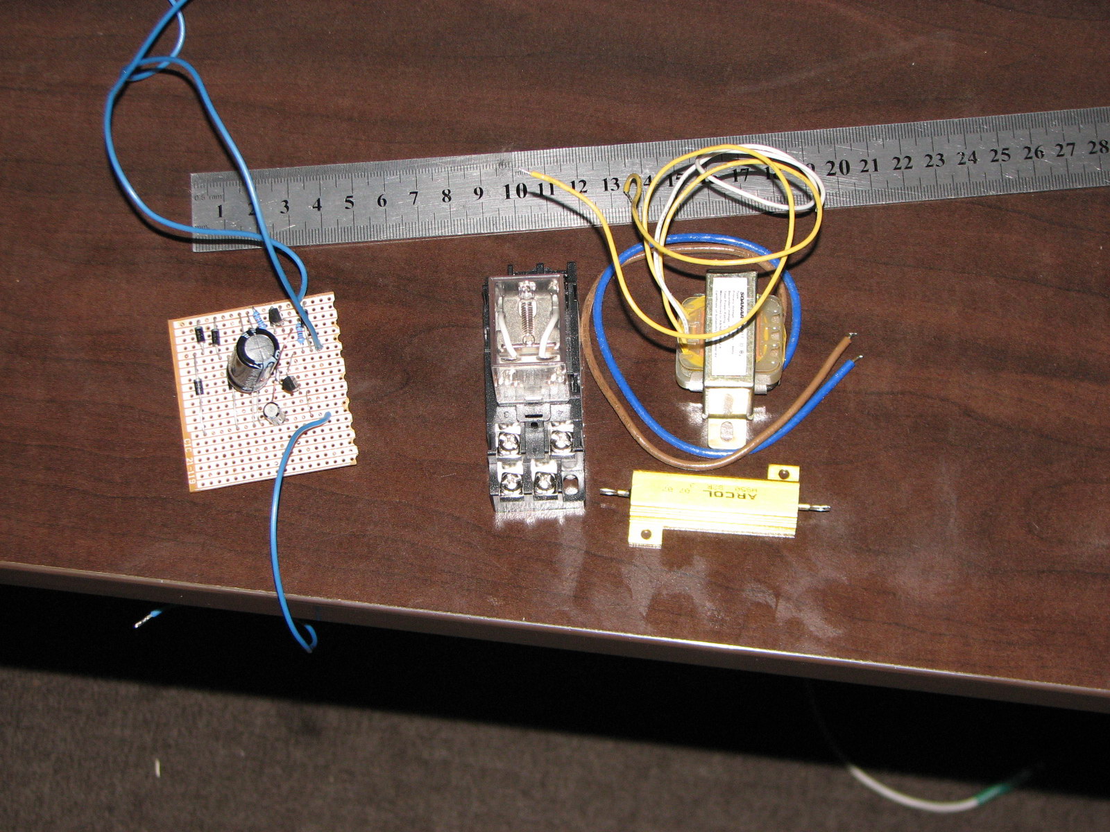

post420.
what is SPR-10n and SPR-10p?
Why are the electrolytic capacitors oriented differently in the two photographs?
These are discrete regulators positive and negative special made for amplifiers.Here's what I'm gonna do.Build the other channel build the PSU like I intend to do with all the proper wiring and get back then for the result.
Here's the soft start from elliot sound website Soft-Start Circuit For Power Amps
Control circuit has tested a ok.
