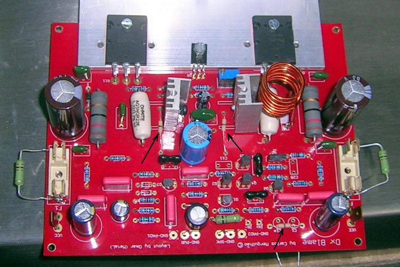

Meanman,
what for are the components indicated by the white arrows?
Best regards - Rudi_Ratlos
Hi Meanman,
you soldered 2 capacitors over / parallel to the bridges (Is this good English?).
These capacitors are not needed in this place.
They do no harm, since they are short-cut: but please: solder them out.
I do not like the way you soldered the "adjustment-resistors" (beneath, parallel to the fuse).
Please solder them on the solder side of the PCB (below the fuse) and leave them there.
They will be needed only for the adjustment-procedure and will be short-cut once you install the fuse.

Alex right these are jumpers that look like resistors.Rudi don't worry the jumper on the signal input isn't soldered.Those points can be used for soldering a MKT cap isn't it?

But these 0 Ohm resistors need not be there.
There are only 2 copper traces on the top side of the PCB - the bridges:
70µM copper traces, coated with gold-rhodium alloy.
Is a 0 Ohm resistor really needed in this place? I doubt this.
Besides: the 0 Ohm resistors do not look good at all.

BTW, I left good space for Q9 and Q10. Both I and Rudi decided that the PCB should be made double sided to use the extra space left behind the jumpers for heatsinks. Q9 and Q10 need good heatsinks. Zero Ohm resistors are not required here.
Yes, Meanman,
you need to solder the input cap C1 (if you have: MKP, MKT, back-to back electrolytes) into the location indicated.
Please do not short it!
This capacitor protects the AMP from DC input-level and acts as a high-pass filter.

If meanman is sure his audio source does not have DC in the output
in other words, his audio player having a condenser in the output...then i cannot see problems with the input shorted.
I feel this not pretty, i would be more happy watching condensers or capacitors there and the zero ohms resistance (a short circuit, a jumper that looks alike a resistance to be pretty) can be soldered in the 100N capacitor place..... this gonna short the condensers and the amplifier will continue to look nice.
The jumpers made of zero ohm resistances (jumpers) are not needed but seems will not be a problem...or i could not get the point.

I feel much more strange....look no good, one of the drivers are misaligned.

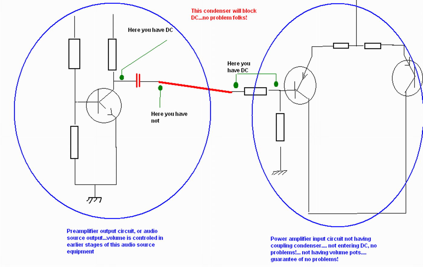

Switch your audio source on and connect your multimeter probe tips
To the output, then adjust your meter to measure DC milivolts.
If you have the coupling condensers, or your output is floating around zero (ground), then you will not measure DC voltage..... no measurement, then you can plug it to your power amplifier without the input condenser...to plug it directly to the input stage base, or it's series resistance.
If you measure some DC..then you gonna need your audio power amplifier input DC blocking condenser or capacitor.
Do not use audio....let your preamplifier in iddle, without amplification, in standby mode..no audio connected to the preamplifier input.

Your pré amplifier does not have an output coupling condenser dear Rudi,
but this does not mean you have, or will have, DC in the output.
Sometimes the integrated circuit output has output floating above and below zero volts, .... and this is safe.
You can know switching your pre amplifier on...do not plug any audio in this pre amplifier input connectors, and measure your output connectors...no DC, even milivolts, can be measure there...if you find some milivolts, then you need the input condenser to the power amplifier input and you cannot remove it.
The existance of these two condensers, one in the preamplifier output and other in the power amplifier input, will put them in series..and this will reduce capacitance and you gonna loose deep bass level.
Because of these effects i do not use, do not suggest or support preamplifiers...because power amplifier does not need them.
Each component may cause harm to your sound.... the most simple is usually better..the theory of the "wire with gain"

Isn't it so that most pre-amps have a cap on the output? And my cd player has one too.
About those 2 jumpers I'll remove them I didn't know that these were bridges my mistake.
This capacitor seems to be the zobel filter capacitor
This one should face 60 volts peak to peak if your amplifier starts to oscilate,
Check it please, if it can face this voltage, and replace it please, for safety reasons, for a 100 volts unit if needed.
If you do not have the correct value, dear Meaman, try another value, giving preference to the voltage and not the capacitance...so, 33N,47N, 56N, 68N, 100N, 150n and 220n can be used

Carlos if you mean C23 the green one I use that's a 100V type.
